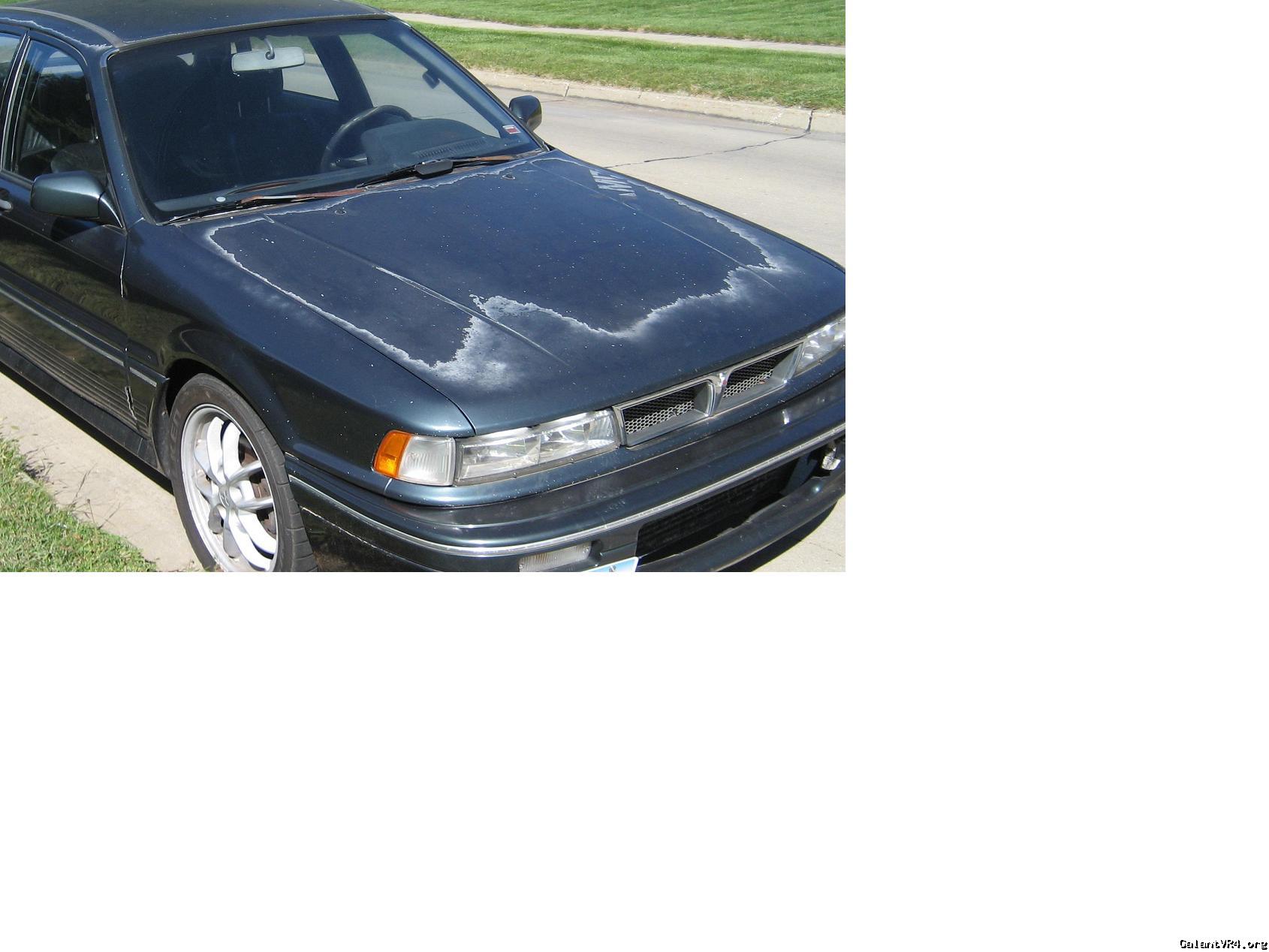

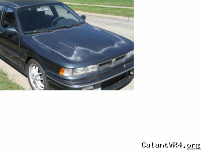

+1 for pics. Here's an example of bad issues with clear (see hood & rooflines) How does yours compare
I'll get some pics up when I can. Mine looked like that pic until I swapped the hood out and painted the roof.

I believe that's the clear coat wearing off, not oxidation. It will need to be resprayed. You can't buff clear coat that's not there.

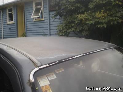

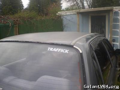

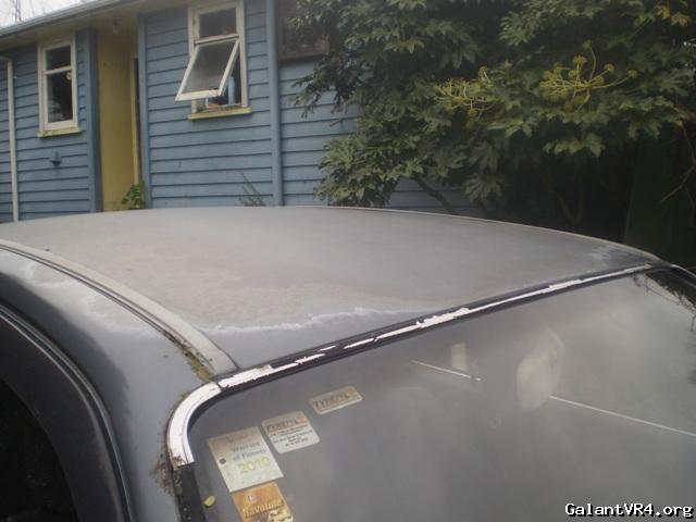

The clear has probably peeled away intirely, what is left is the base coat. I was tought that this basicaly has to be re-sprayed. However I have found that it can be fixed with care. Wet sand with about 800 grit being VERY careful not to rub through. Then try to feather the good clear sarounding the area, with the base. Where the clear has gone white needs to be rubbed away intirely. Then usual paint prep and re clear the roof or whereever.

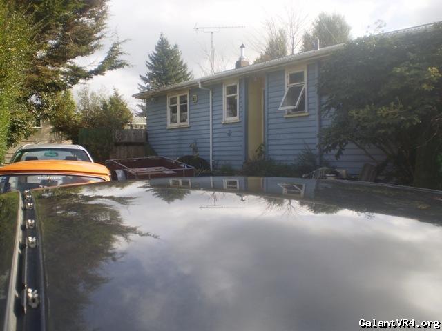

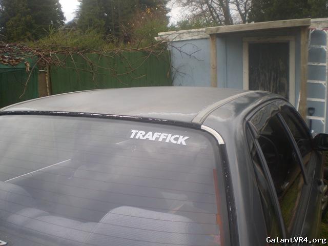

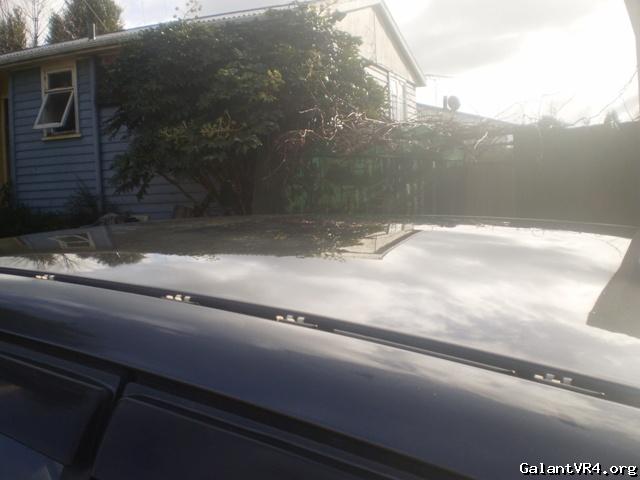

Here are some photos of a roof I saved. I put the heater on in the garage for a few hours, then wiped clean with prepsol and sprayed about 4 coats with about 10 minuts between them with duplicolour "clear plastic"(aerosol).
Hope that helps mate.
Thanks all....yes it is clear coat peel. Mine looks just like Justin's pic at the top of the passenger doors but I also painted the roof which looks great. I was thinking about going with some 800 grit and feathering the clear over. When the roof looked like that, I sanded it down with 400 grit and then put new base coat then clear coat. Seems like all that isn't necessary though. This is very strange because the clear coat peel at the top of the passenger doors happened within a few months of painting the roof. This is why I am wondering if clear coat peel "spreads".

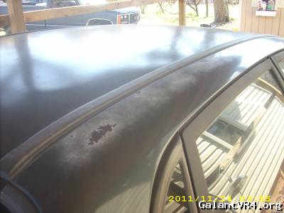

I am wondering if I was just so focused on and happy that I got the roof painted up nice that I didn't notice the tops of the doors.

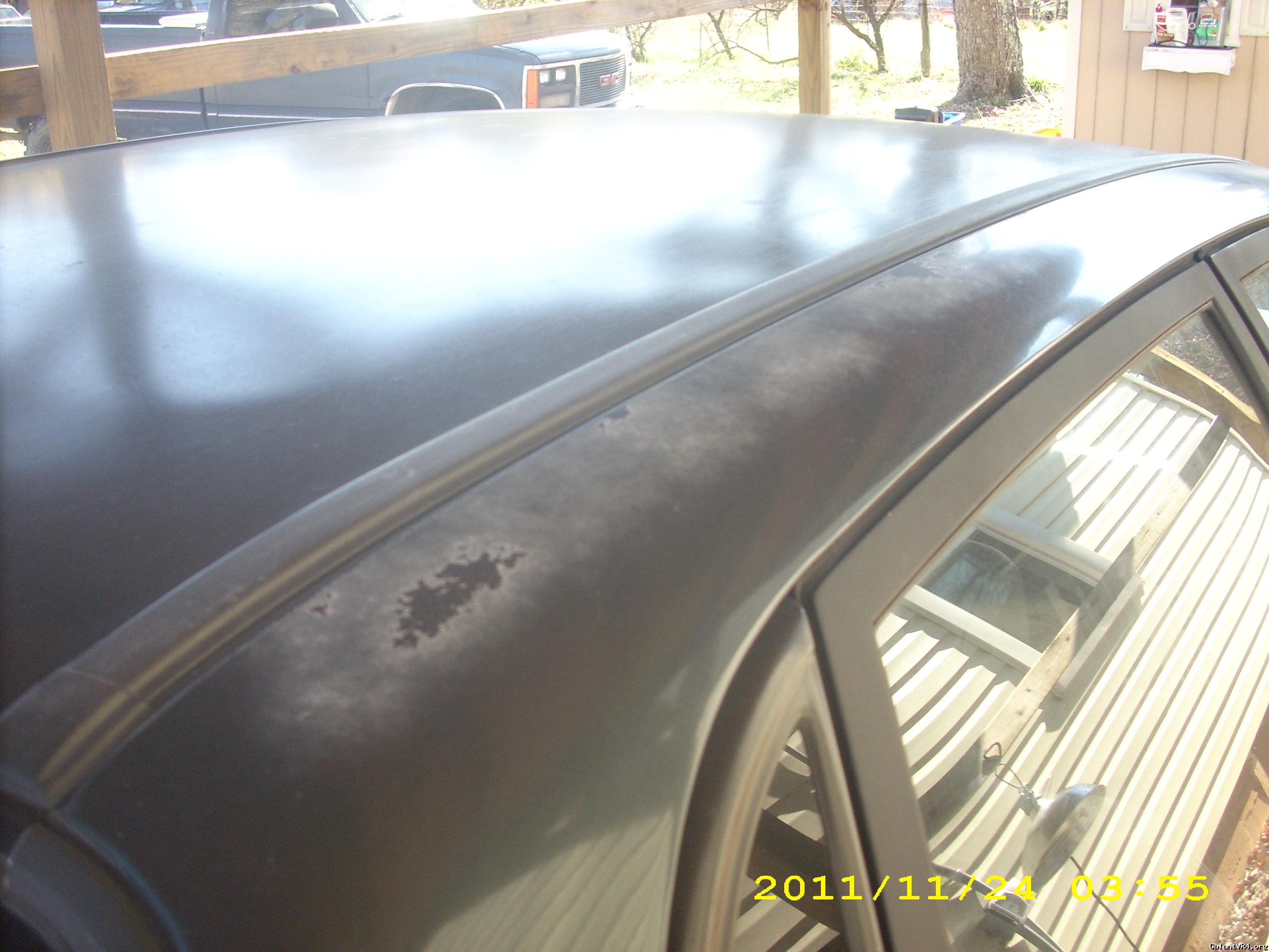

Here is a pic.

No pretty clear m8. Thanks for all of your thoughts.
Here is a pic.
Bro, you won't need to re base with that, just use whatever (probably 600 grit) sand paper you feel is right and wet rub off any white (white because it's lifting) and feather it out. If you know how to do it right I would just use a good aerosol clear. No point speending much if it's a dd. Lol if you take a look on some honda forums there are how to threads on this.
