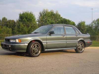

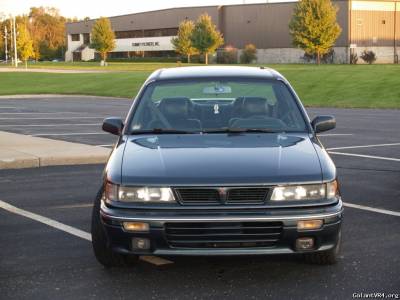

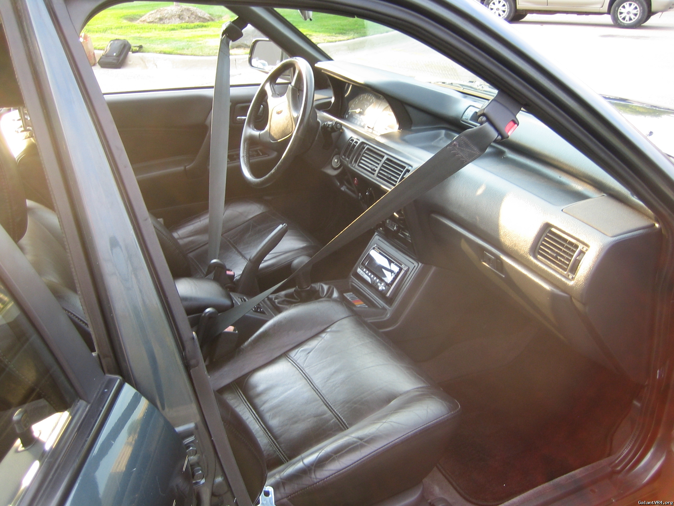

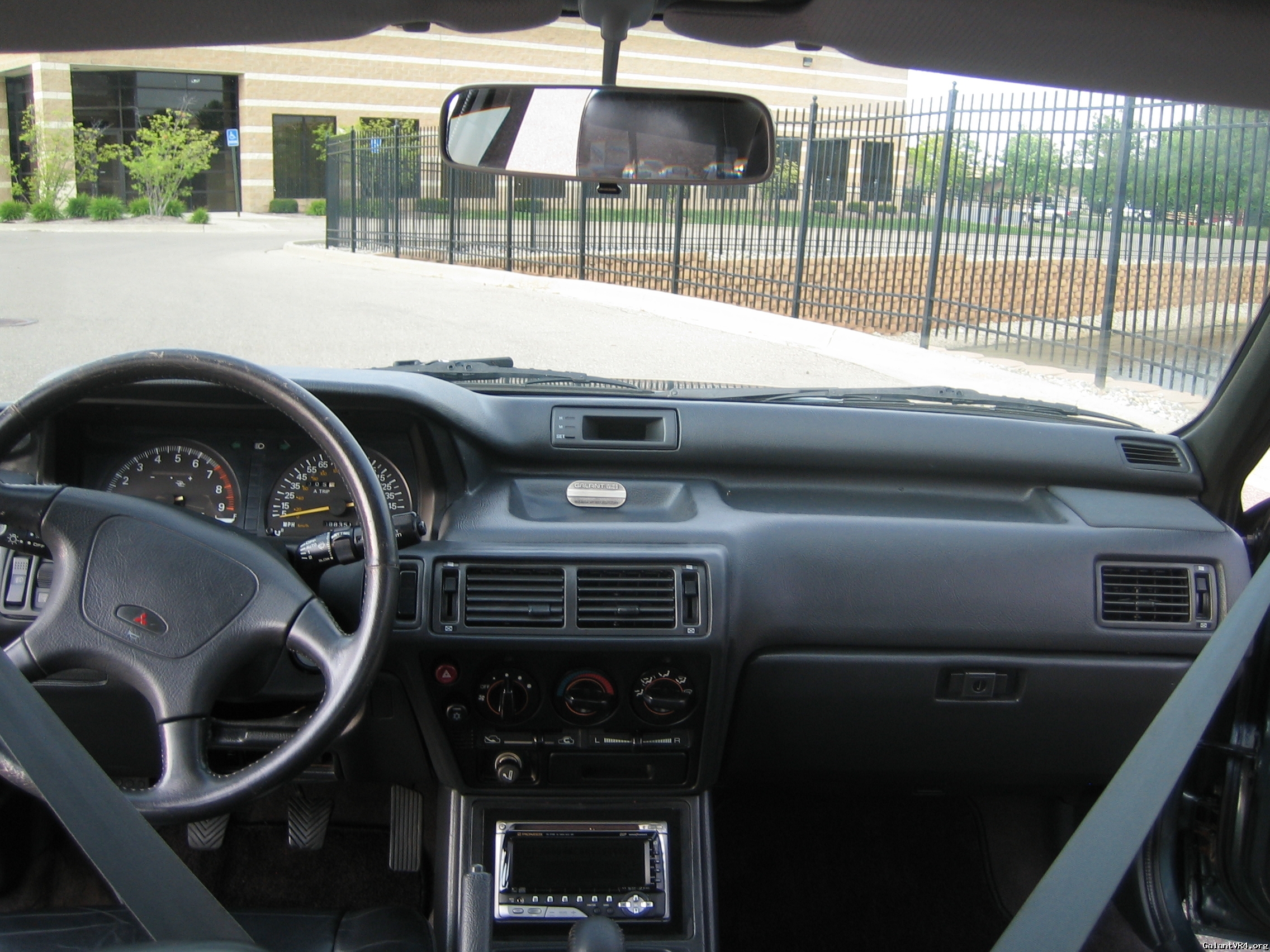

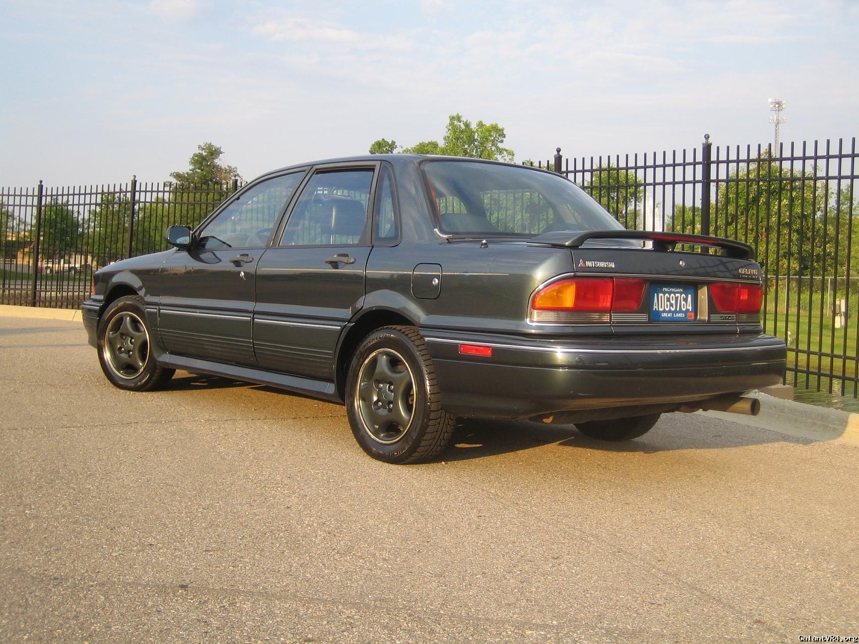

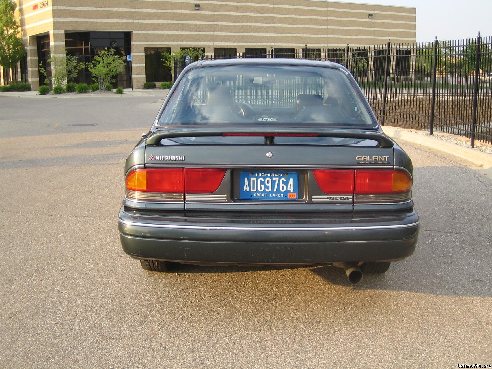

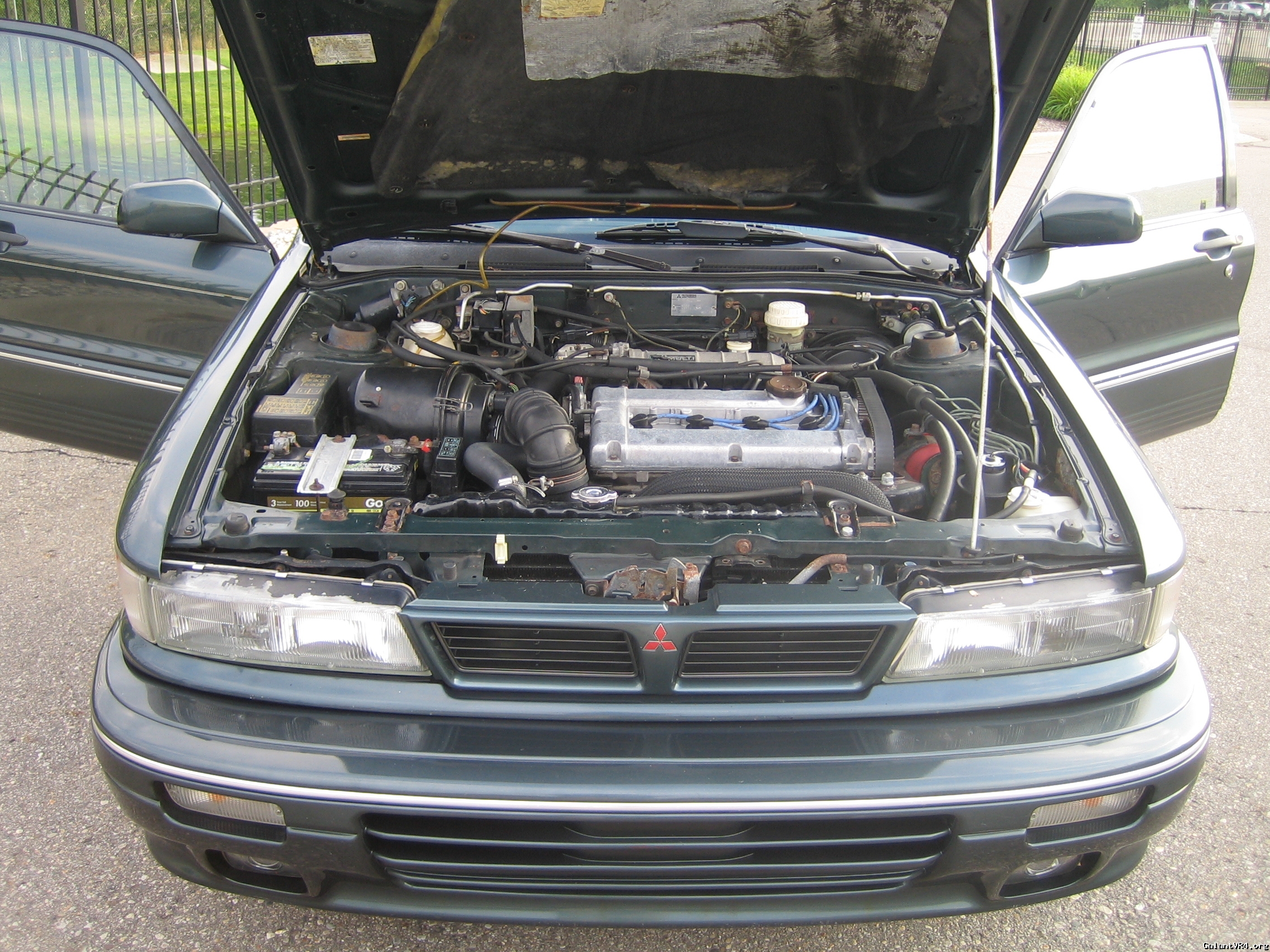

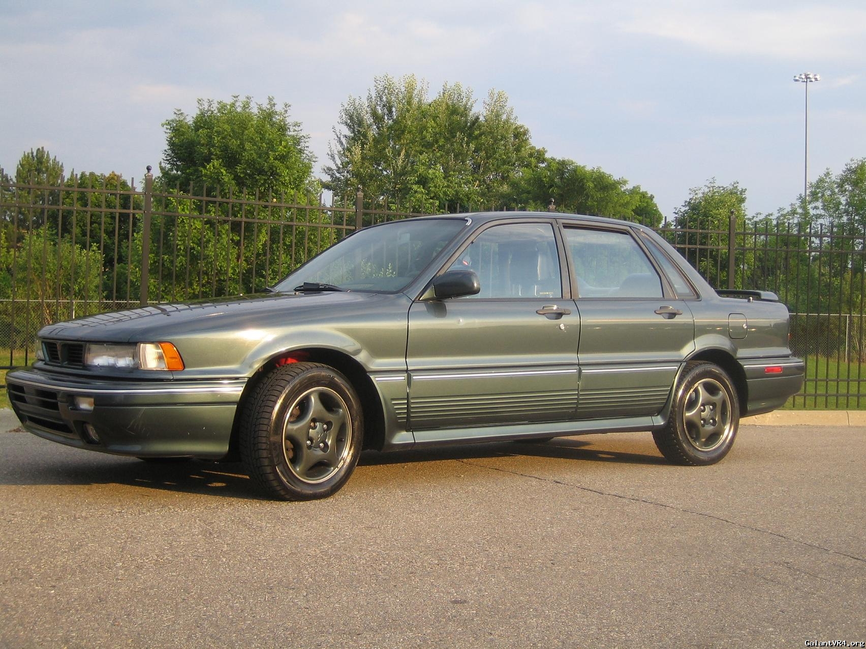

Pictures when bought November 2007.
Car was bought November 5th, 2007 with 88,351 miles.

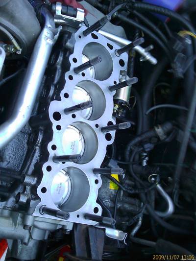

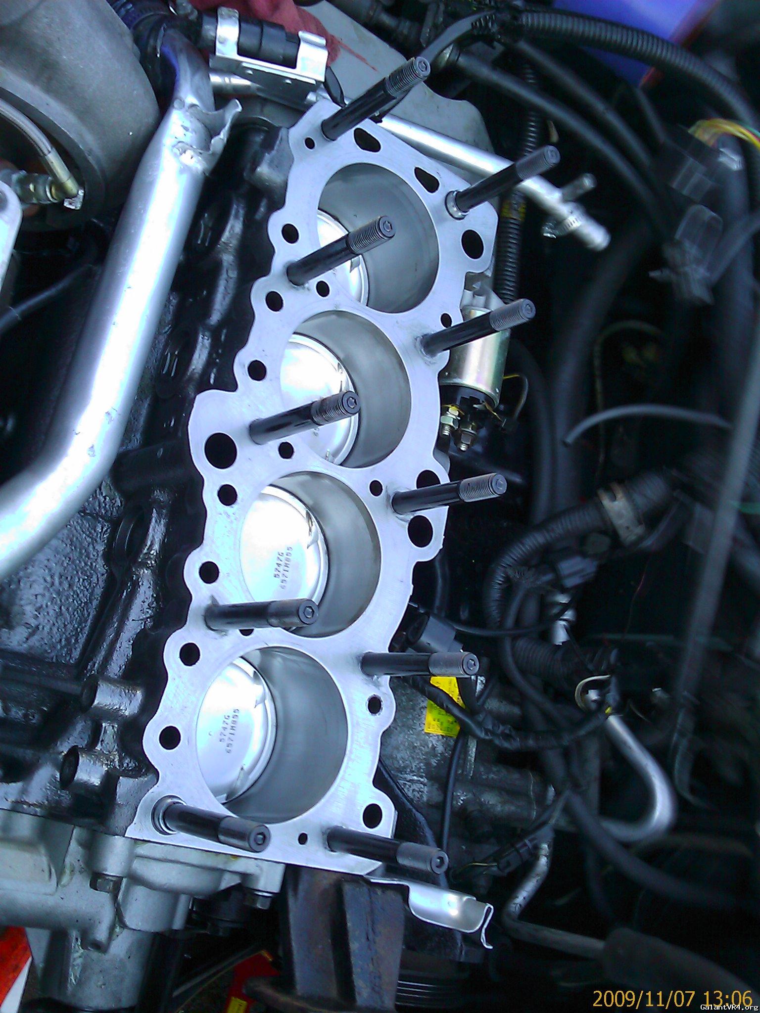

Engine: Rebuilt 99,500mi
Wiseco 9.1 Stroker Pistons .020"
Eagle Rods
OEM 100mm Crank
OEM Timing Belt
OEM Water Pump
OEM Oil Pump
ARP Main Bolts
3G Lifters
OEM MLS Head Gasket
ARP Head Studs
Prothane Engine Mounts
NGK Plug Wires
NGK BPR8ES Spark Plugs
3 Angle Valve Grind
1990 Oil Filter Housing
Kelford 272's
Manley Springs and Ti Retainers

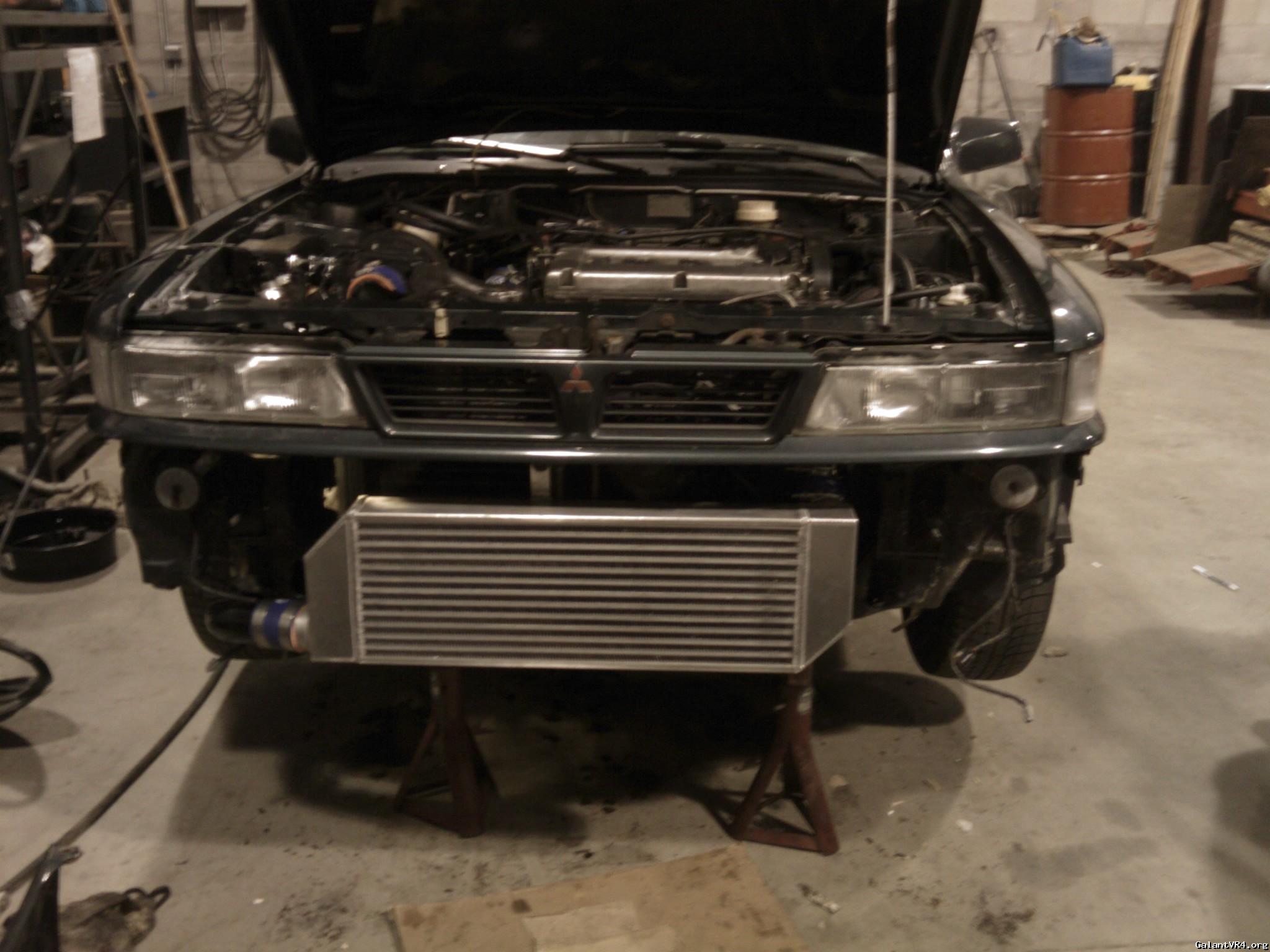

Induction / Exhaust system:
BW259ETT T4 1.00 Housing
Custom Foward Facing Twin Scroll T4 Manifold
2x 38mm MVS
Forge 1g BOV

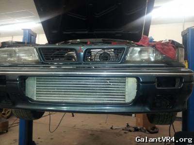

ETS FMIC
Hallman Manual Boost Controller
3" Stainless Turbo Back Exhaust with Magnaflow Muffler

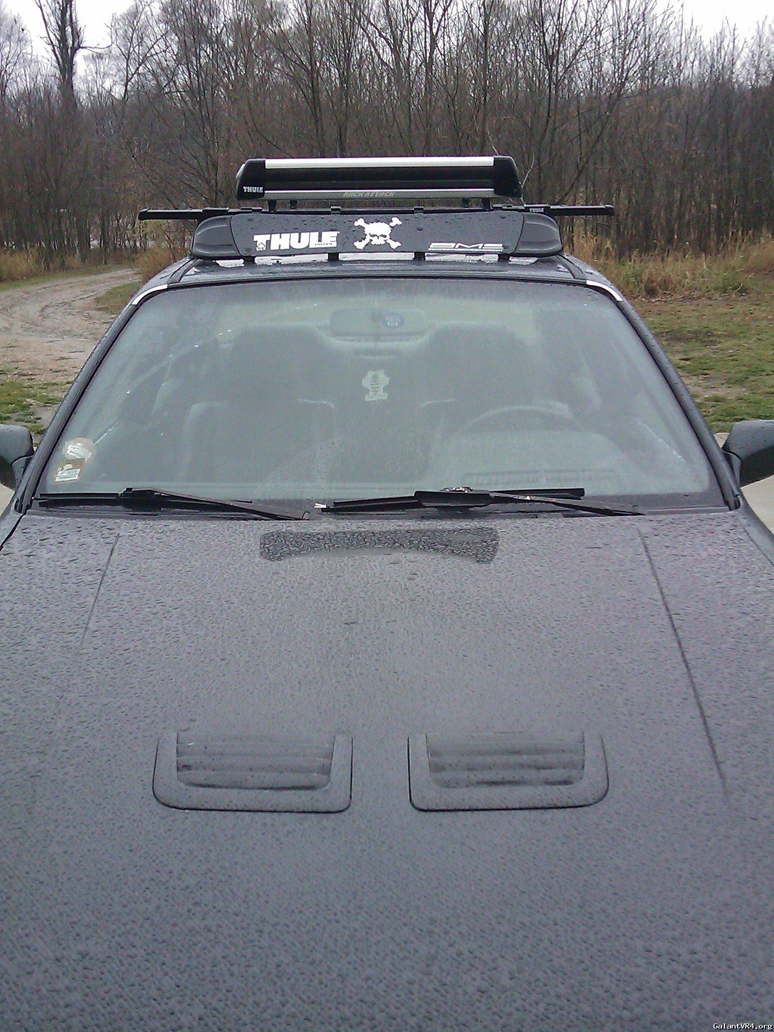

Carbon Fiber Galant VR4 EVO RS Hood

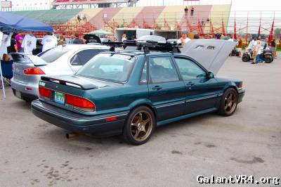

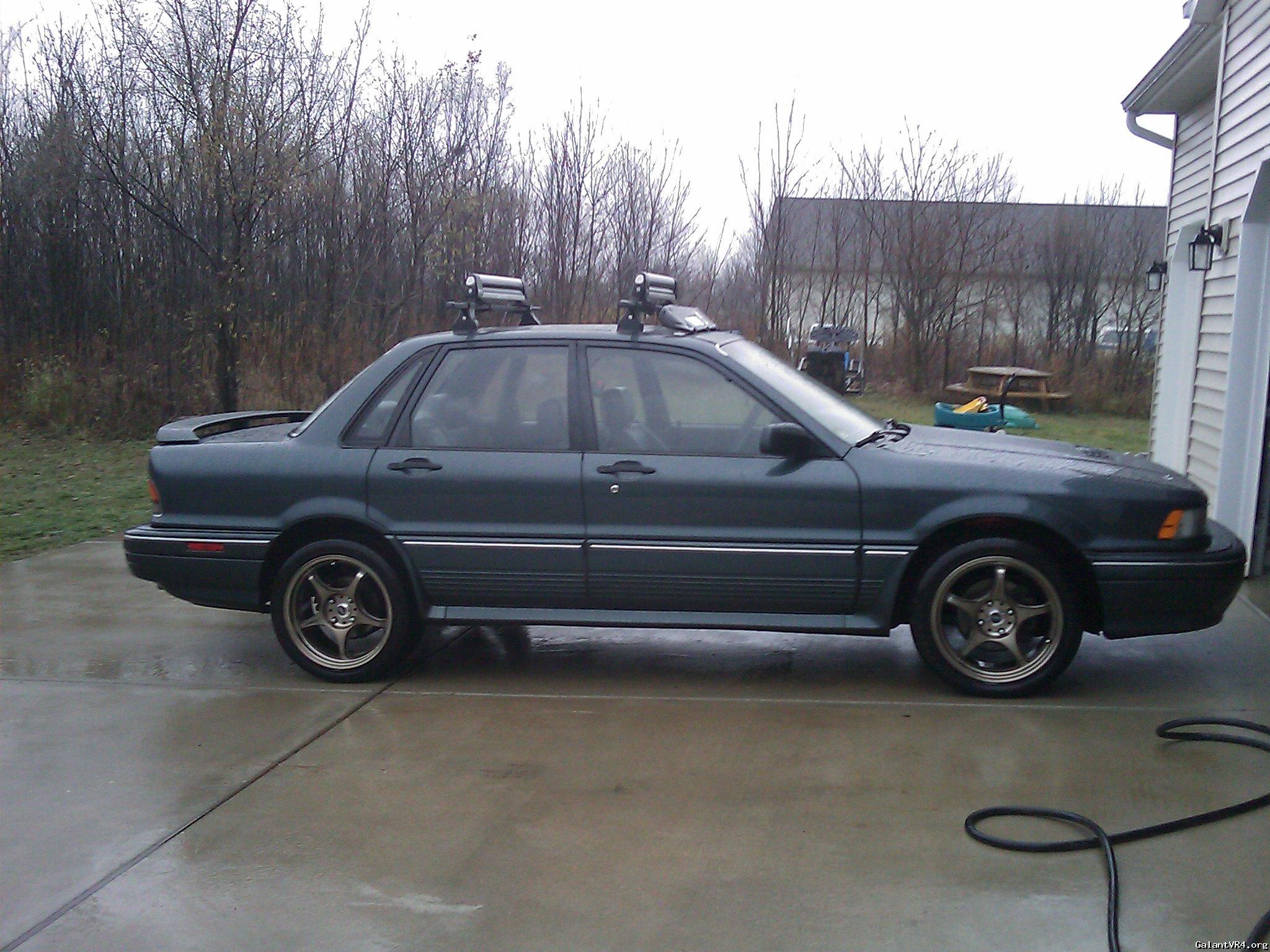

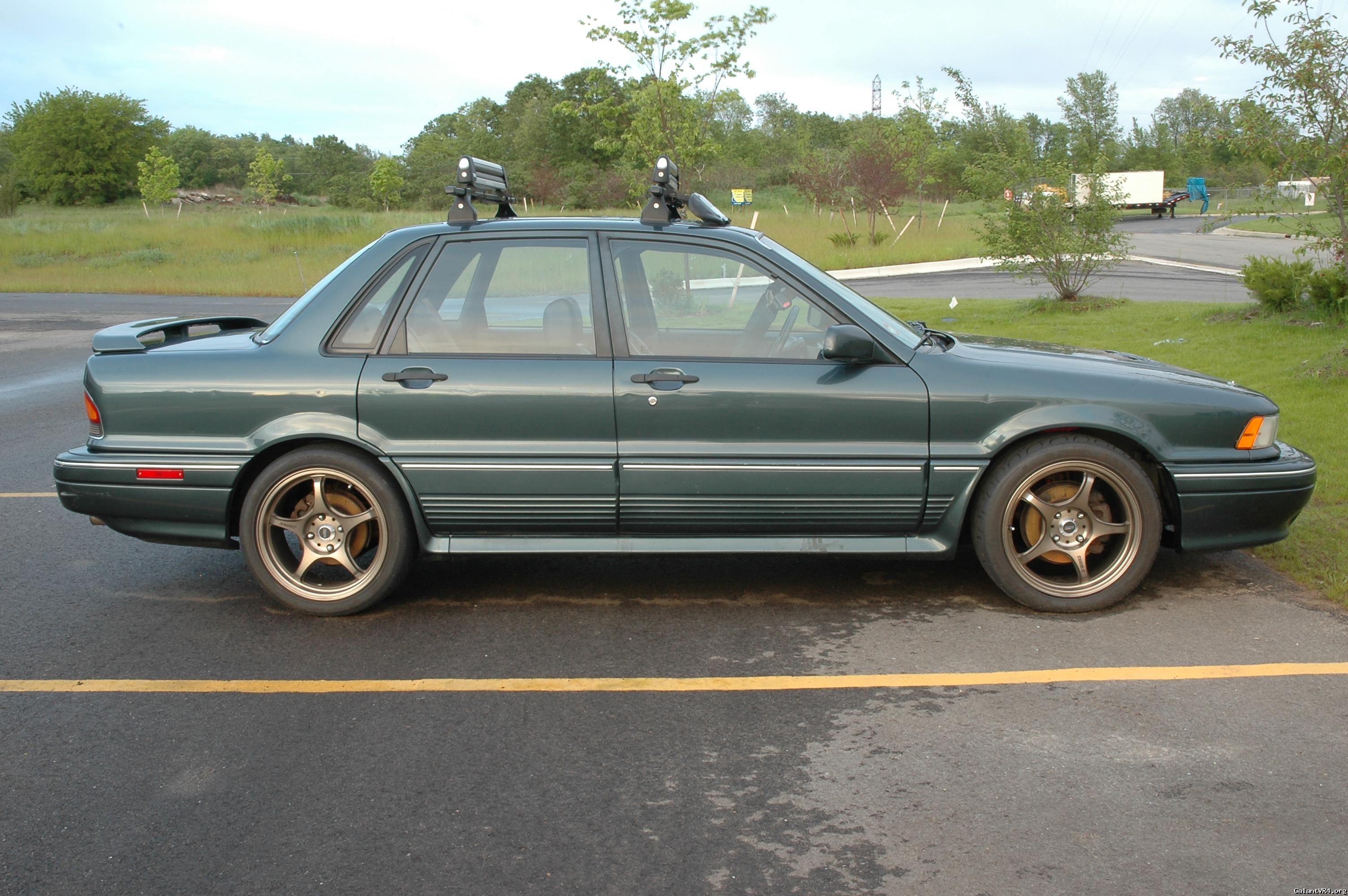

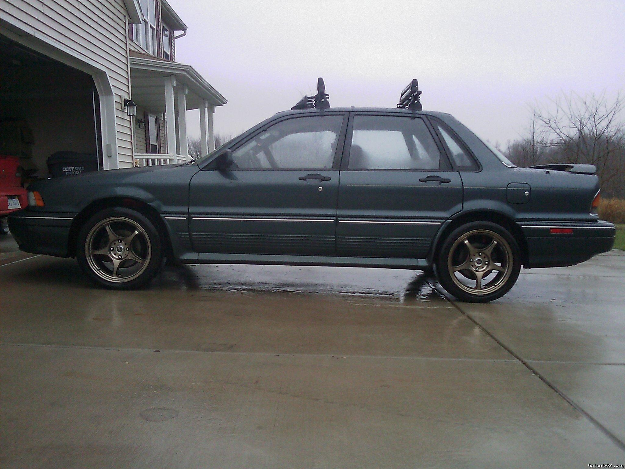

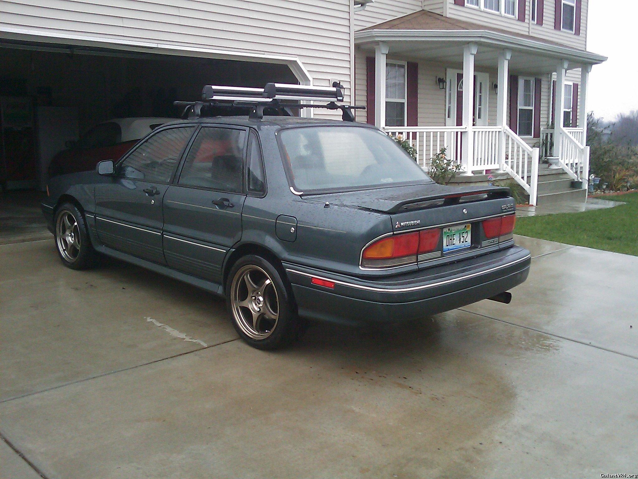

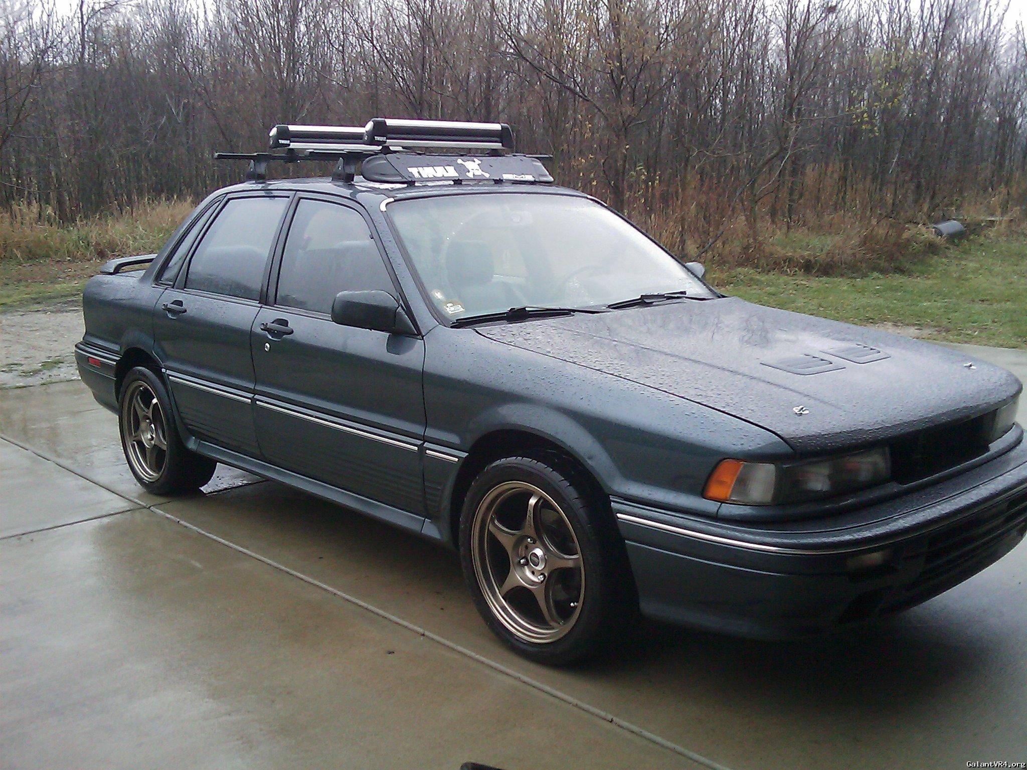

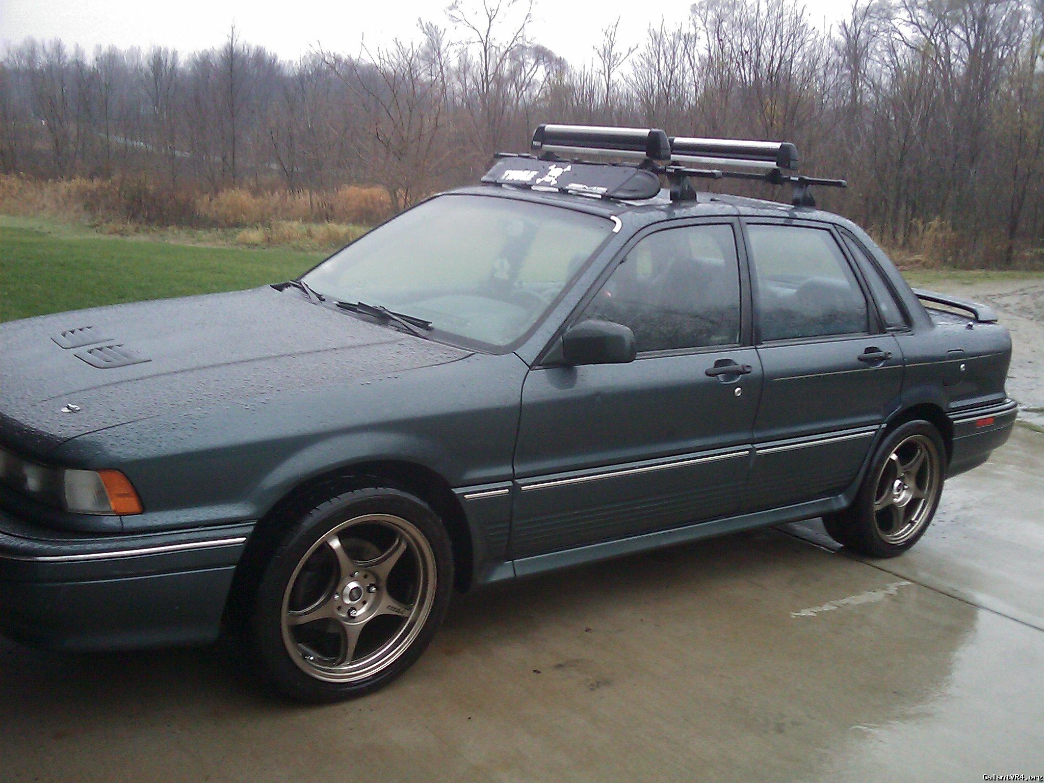

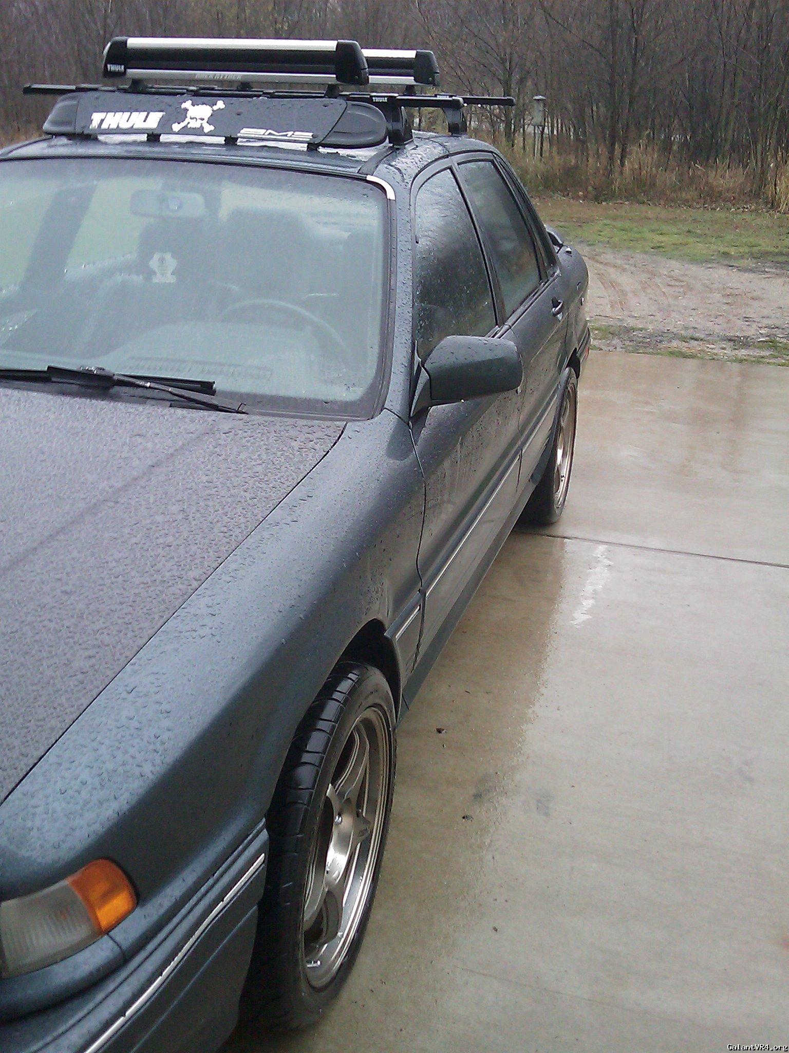

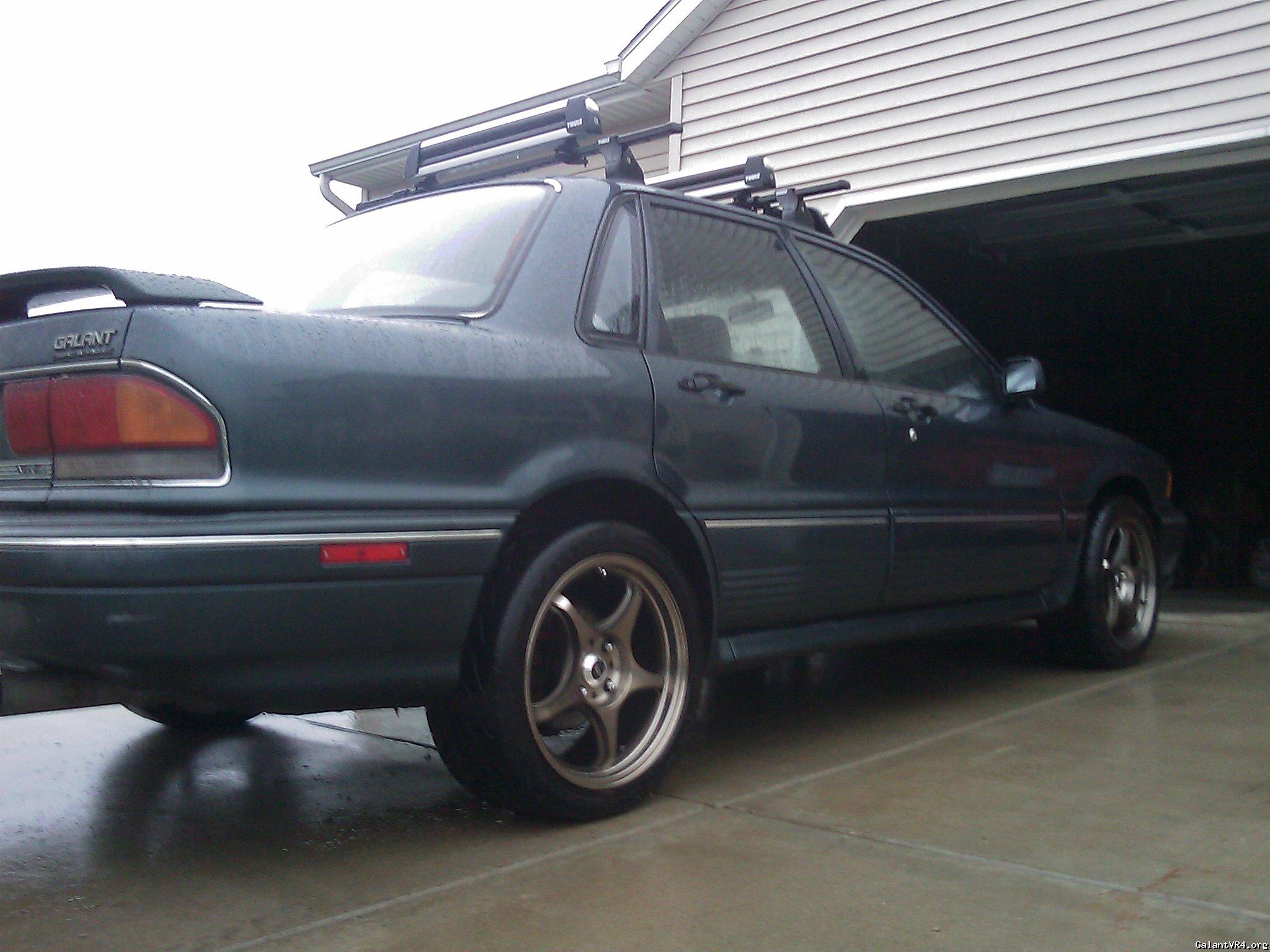

A little bit lower in Summer Spec with the Whiteline Springs Installed.

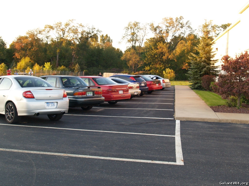

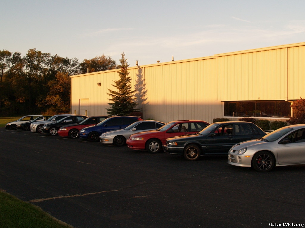

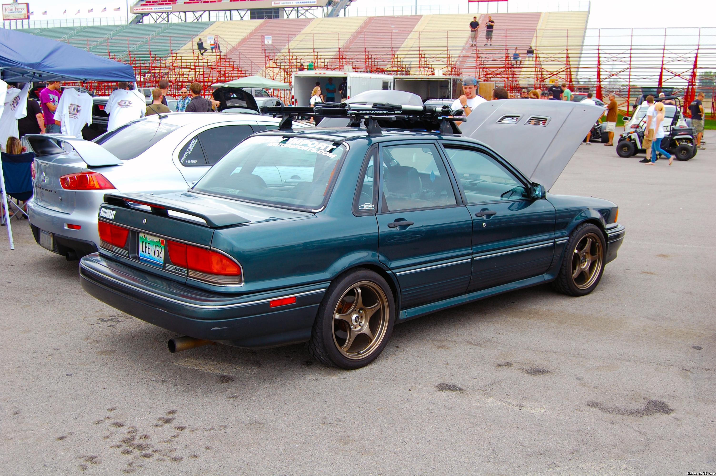

Hanging out with a car enthusiast group. Galant is on the end.

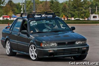

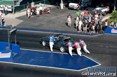

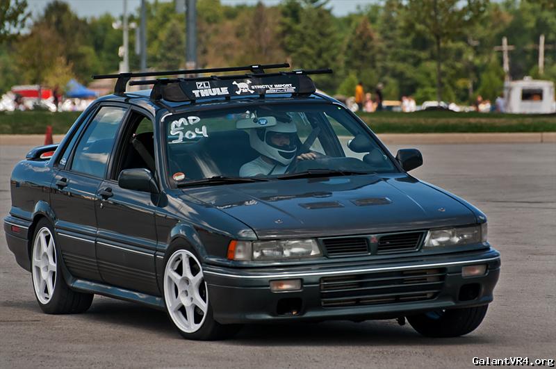

Shootout 2011
Shootout 2012

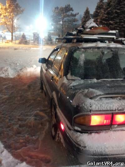

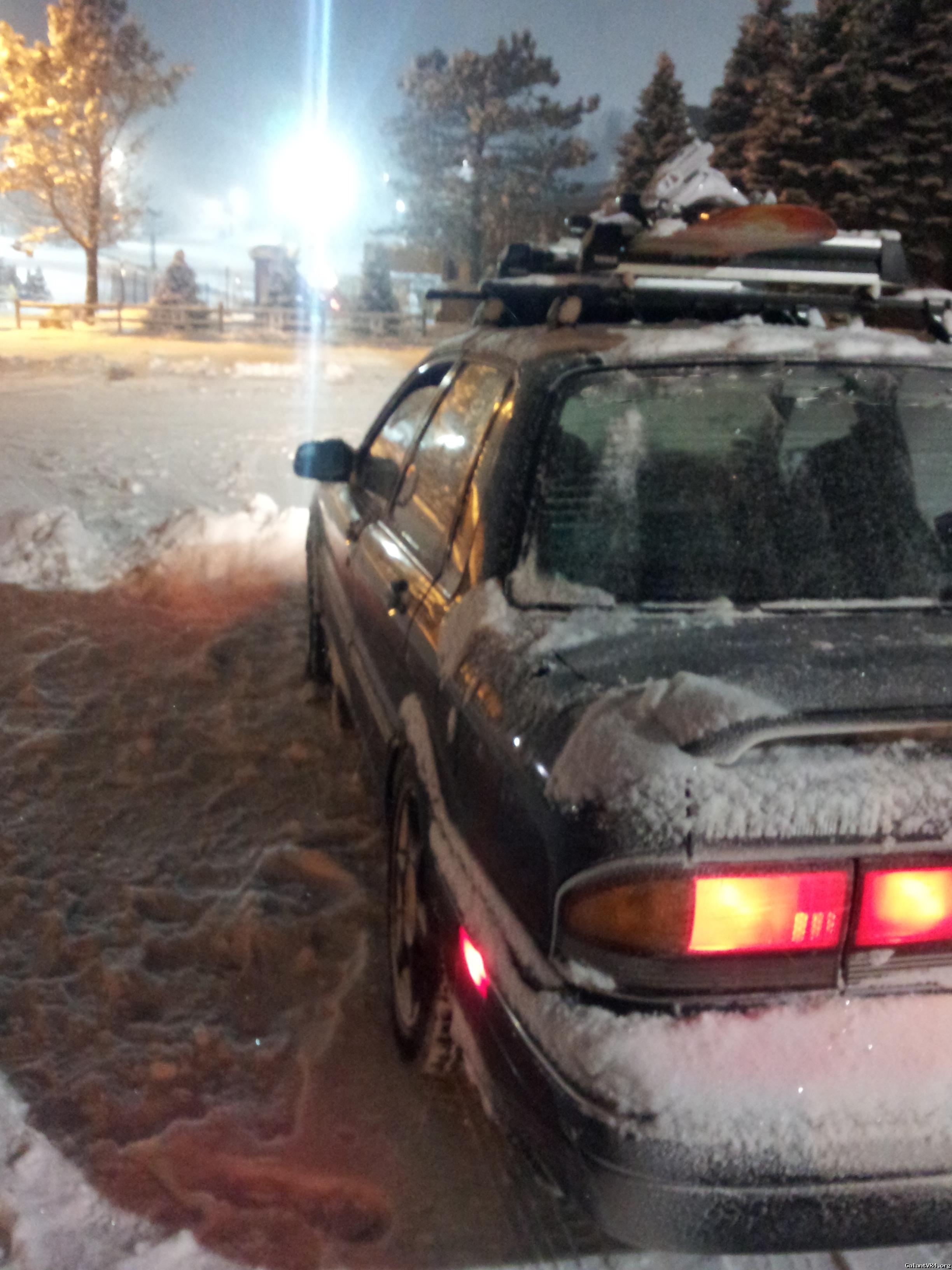

Winter 2012

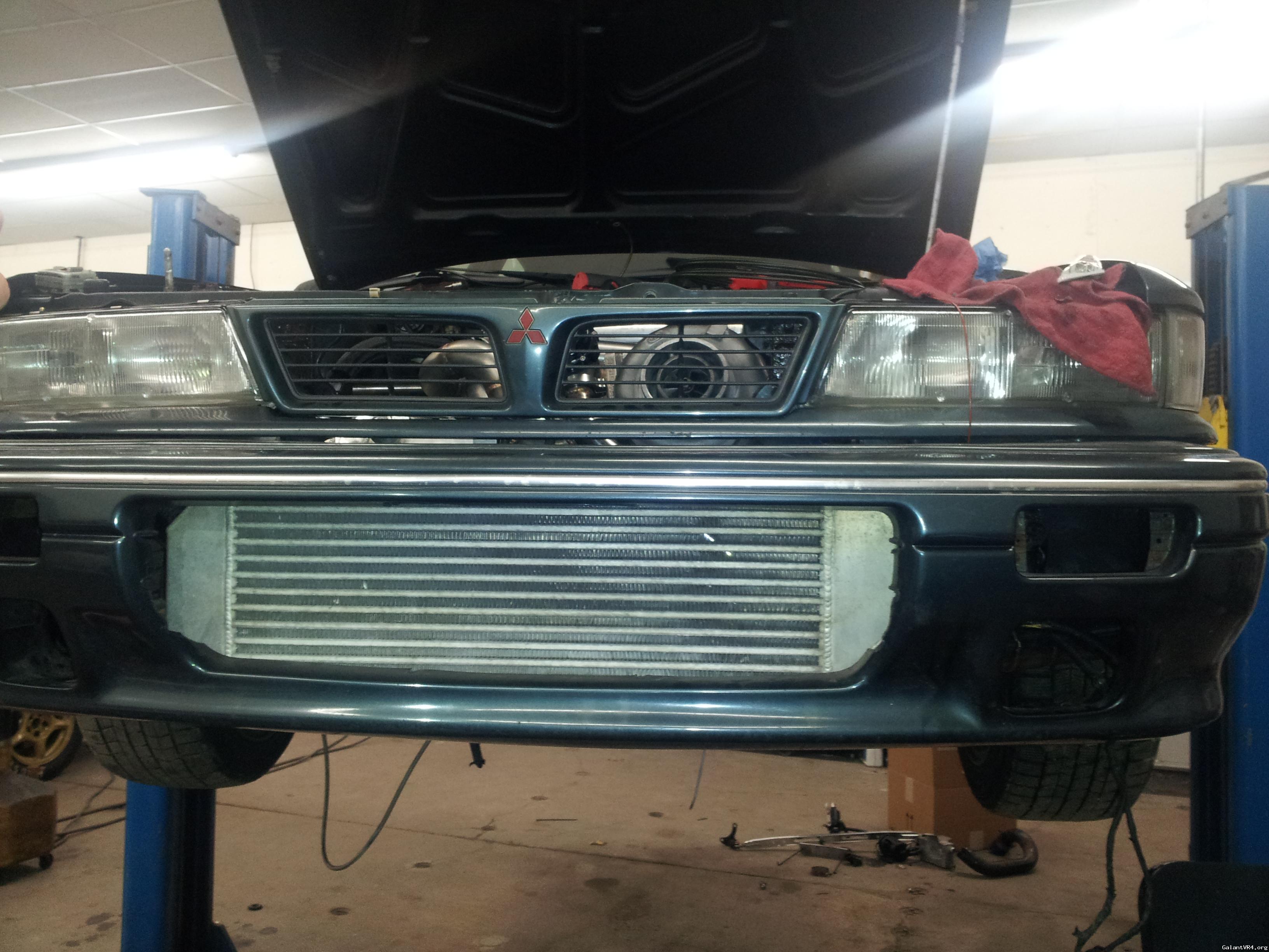

Spring Turbo Setup Change (DSM FP Race manifold/ BEP .55 AR Bolt on s259 -----> Custom Foward Facing T4 TS 1.00 AR)
