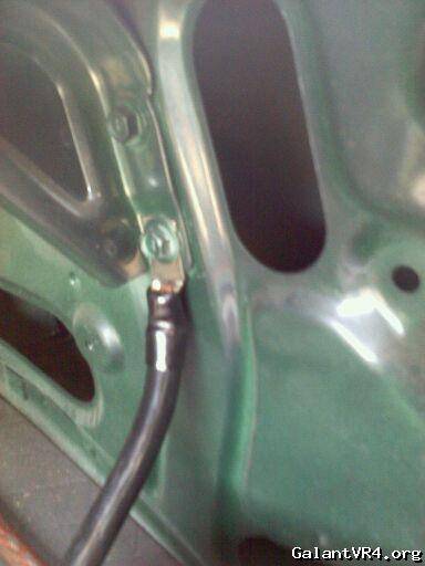

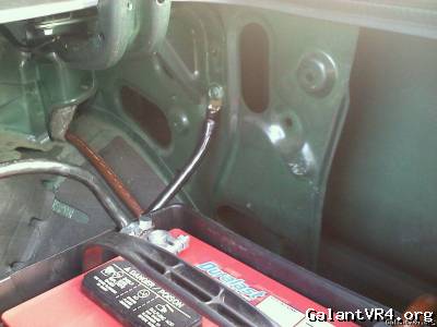

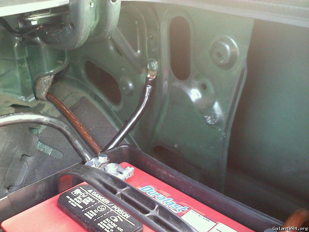

Ground strap goes from the negative terminal to the wheel well right behind the battery. Follow the negative wire to where it's bolted to the car.

ground strap located right here

On your battery ground, Is the end terminal a metal to metal contact or is there paint in between the metal and the terminal? You want it to be a metal to metal connection.

When I had my battery in the boot I used one of the strut bolts for the ground strap. Seems to have a better connection direct to the chassis with that.
