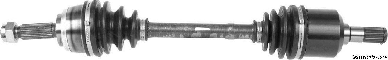

I wonder anyone have bought this axle for the front passenger side? Although most of the site states it's a direct fit I found out it is too long... can't bolt the hub to the strut after axle is in the way.
Link to the part
After I took it off I compare it to the stock one, it's about half an inch longer when both are fully compressed.

Not sure if you're familiar with, but are you sure its fully inserted in the transmission? The retaining clip on the end has to compress when installed and you will feel it "click" into place when fully inserted.

Thanks for the reply but I think this is for the driver's side, which I also have but haven't try the fitment yet. The 3102 is for the passenger side and that's what gives me problem right now.
Quoting holeshotmoe:
I'm sure it's inserted in all the way, I push the shaft in, force it a little bit than hear a click and it went all the way in. And when I look at where it mates the transmission the axle cup end is pretty much flush with the seal
And when I took both the new and old one off(passenger side) and compress them to the shortest possible length, the 3102 is definitely longer.

I'm surprised a 1/2 inch difference from fully compressed would prevent installation, considering the axle needs to be able to give (lengthwise) a little to accommodate engine-to-steering knuckle relation during flight

You might make sure the inner joint didn't separate inside the boot. Make sure it compresses easily when you push it.
