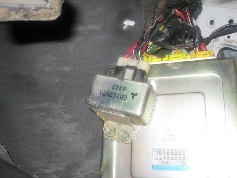

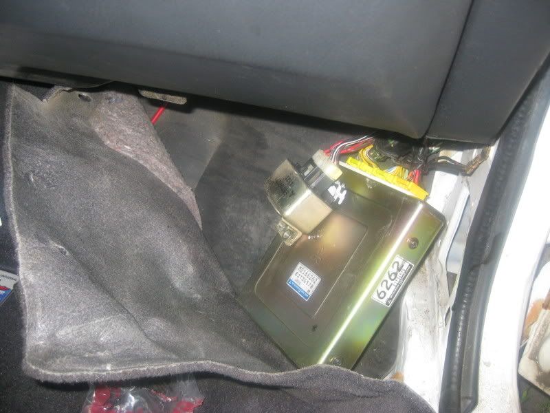

I have a galant vr4 and it has been having problems were the car won't start or will die while driving. It would start back up when ever it wants. But now the car will not start at all. I'm pretty sure the problem is the MPI relay. The relay will start clicking and buzzing when the car will die. The part number on the relay is E8T07071. The relay is found under the passenger side dashboard next to the ECU. Here is a pic.
Some people have suggested the ecu. I have 4 ecu's right not and I have tried a motoguys rebuilt ecu and it still would not start. I also have 3 MPI relays and that hasn't worked.
I did a check on the CAS wiring and I'm not getting any voltage to the plug. Also I noticed when I turn the key to the on position the check engine light does not come on at all.
I need to get this car running already. Any help would be appreciated. I did a general check on the wiring by the ecu and everything looks ok (no cut or damaged wires). Next I think I will open up the wiring some by the CAS plug and look for anything that might be bad.

Buzzing MPI is "usually" the ECU or low voltage.
Like mentioned I would install your other ECU's into another 1g AWD and see what happens.
If the alternator is shot the car will run for awhile until the battery voltage drops below 12v. Once that happens all kinds of electrical snafus will happen ( buzzing MPI, door locks open/close, stalling, idle surge, etc ).
My alt died on a road trip recently but the battery light never came on ( the ABS and fuel lights did tho ). Very lucky to make it to the next town and replace it.
Have you checked the MFI fuse under the hood? There's always a chance that one of your bad ECU's could have blown the fuse. The fact that the CE never lights is not a good sign. Either the ECU is bad or not getting power.
