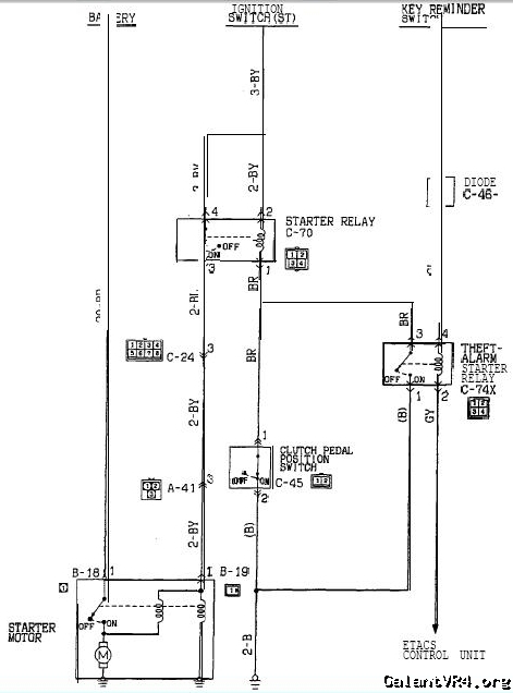

Check to make sure the starter is connected. There is a spade connector that can come off-on the starter itself.

If you are getting nothing from the starter at all (no click, slow turns, nothing) you can also disconnect the clutch switch (bottom switch), as that may be your issue as well.

Quoting toybreaker:
Disconnect it. (the switch that is activated when the clutch pedal is all the way down)
When the pedal is anything but fully down, it's a complete circuit thru the switch.
It's only when the pedal is all the way down that the contact is broken at the switch, (which allows the starter to engage)
If there's a problem with the switch, or more likely the little tab it presses against, disconnecting the switch will allow the starter to operate regardless of the position of th cluch pedal.
Please note you will now have to pay attention, as the starter will now operate independently of the clutch pedal which could result in a bad day....should you decide to try and start it in gear. (ask me how I know... )

Sorry, I missed the part where you said the car runs fine if push started. So, the only real problem is that the starter isn't functioning at all? If you have a voltmeter, you should verify that the solenoid connection on the starter is getting +12 volts when you turn the key to "START". That's the small wire on the "S" terminal. This will probably require you crawling under the car on jackstands, so make sure the car is in neutral and you have taken every precaution!
If the solenoid IS getting 12 volts when you hit START, and the large battery cable terminal is also getting 12 volts, you have a bad starter. But, while you are under there you should also verify that the problem isn't with a corroded battery terminal, and the voltage actually isn't making it into the starter. The same is true of the heavy ground strap from the battery to the chassis. What seems like a good connection, and will allow the car to run once it is started, can actually be an intermittent connection that will open up under heavy load, like the several hundred amps the starter can draw.
Oftentimes to test things I will simply use a small piece of jumper wire to connect the heavy battery cable to the starter directly to the solenoid terminal, to see if the starter then engages. This bypasses the security system, and the keyswitch.
