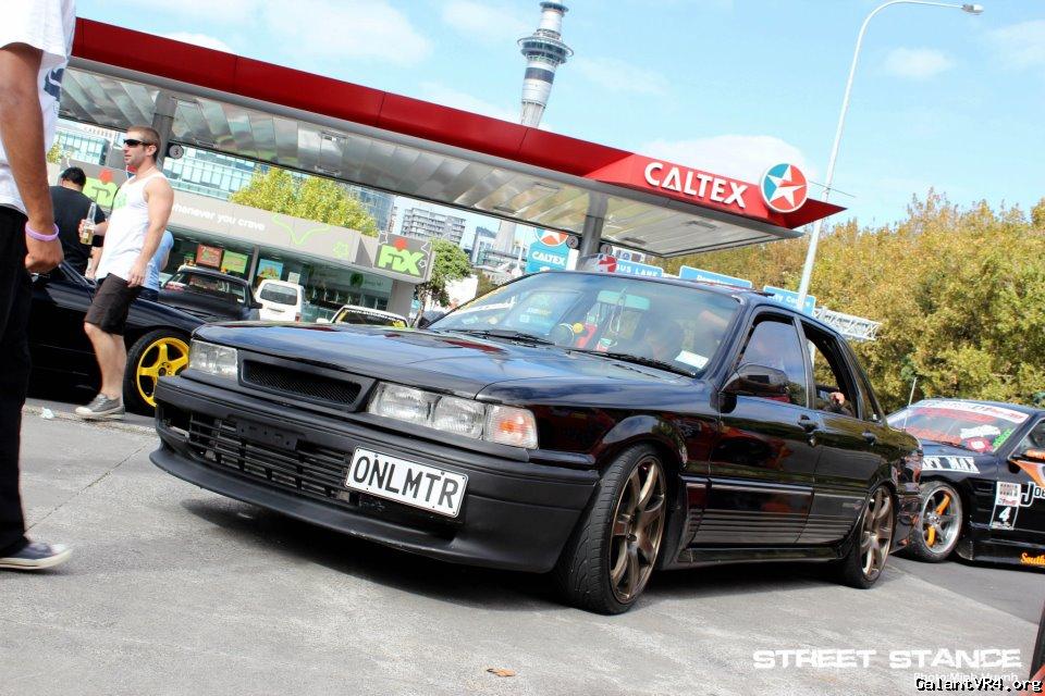

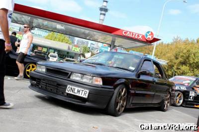

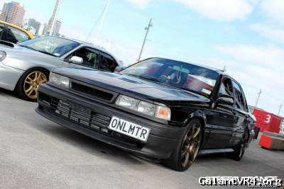

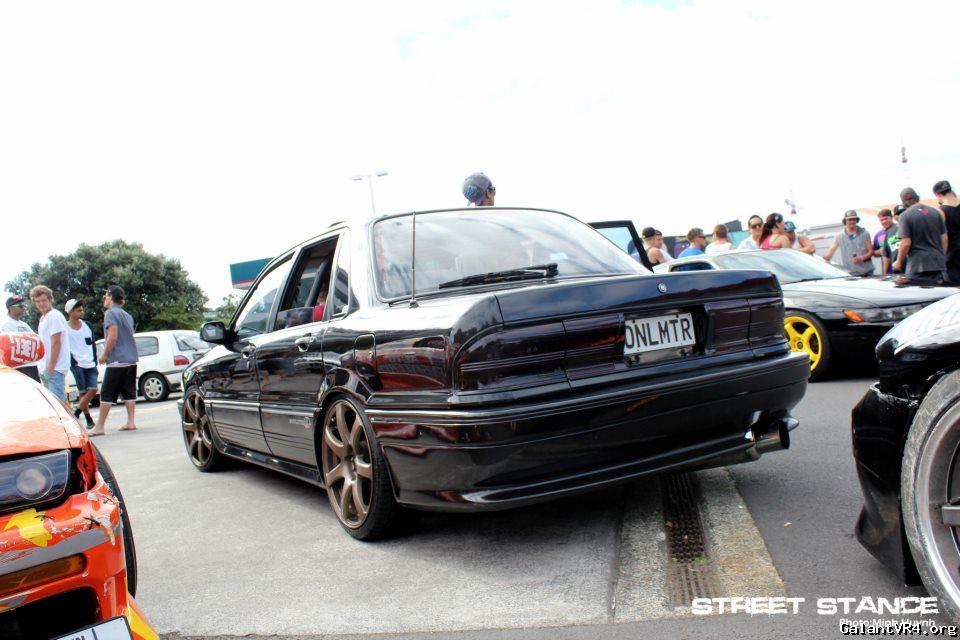

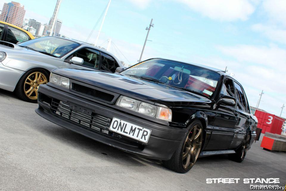

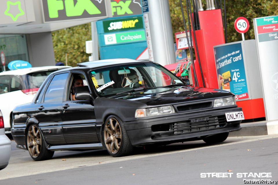

surprisingly the picture montage didn't give any insight to the problem...
