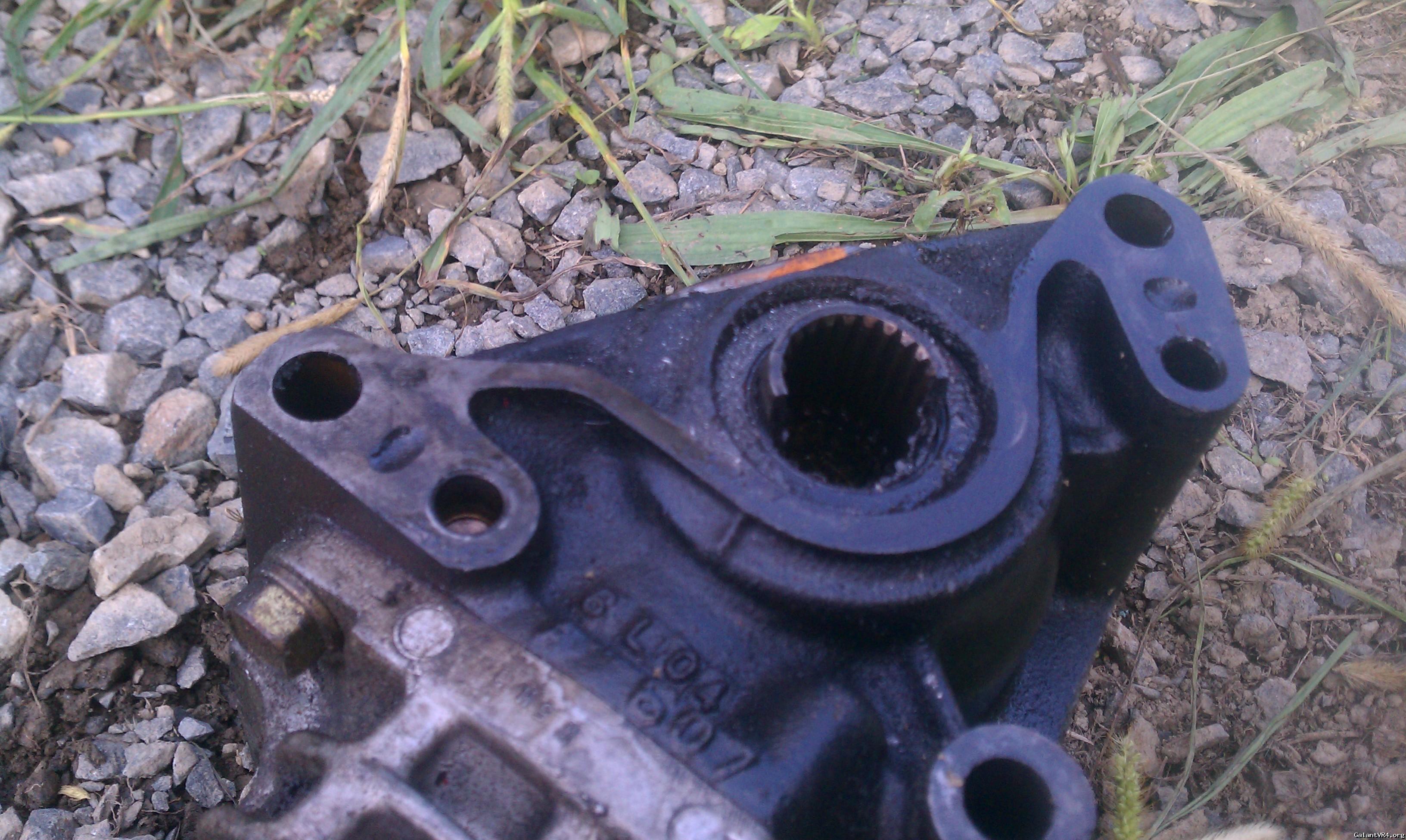

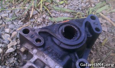

I am about to drop my trans tom. So I will update when I do that. This is what I found so far.
22 spline xcase ..can I still use it....if not does anyone have an extra one...I have a 23 spline for sale from when I had my galant vr4 tranny in. It works great. I would be willing to trade my 23 for your 22. Let me know.
not the output shaft on the tranny ...I was wondering i could replace the broked peace on the x case above ..see [pic

Quoting usethe4ce:
can i replace that spine?? whatever it's called?
you can buy that part of the t-case from jacks transmissions for about $200

Quoting usethe4ce:
If your input splines look like that then your output shaft probably isn't in very good shape either.
I tightened down the pp in a star pattern. It was fairly difficult trying to get the xcase on. It was never that difficult when I had the 23 spline on my gvr4 tranny before it blew.
So I just dropped the transmission today. I found nothing other then the broken pieces that came off the trans-axle. They where in the bell housing, could they have been causing the bad vibration. The two top bolts holding the tranny to the engine where coming loose, it seems like they vibrated out.
