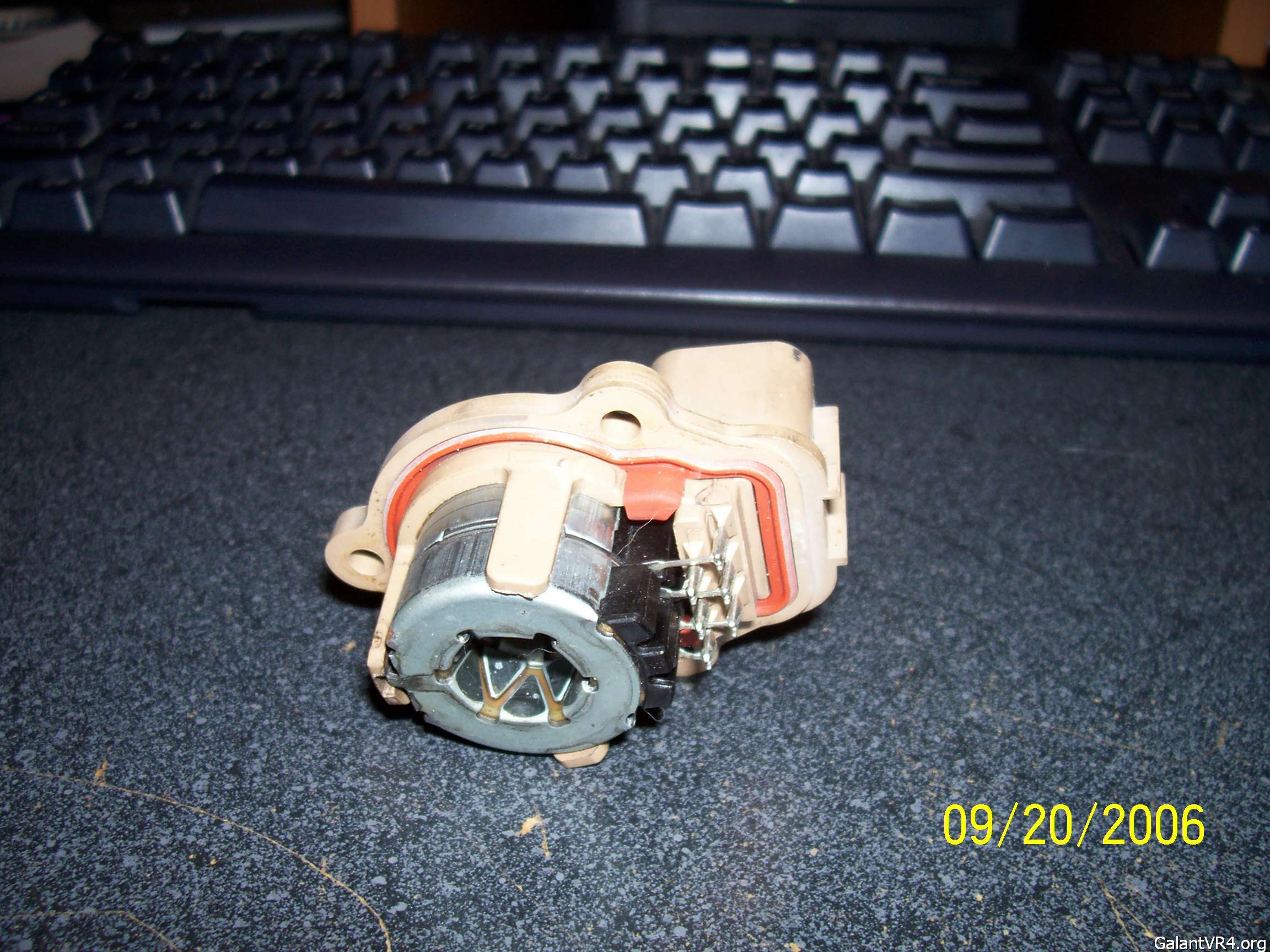

ISC coil looks like this:

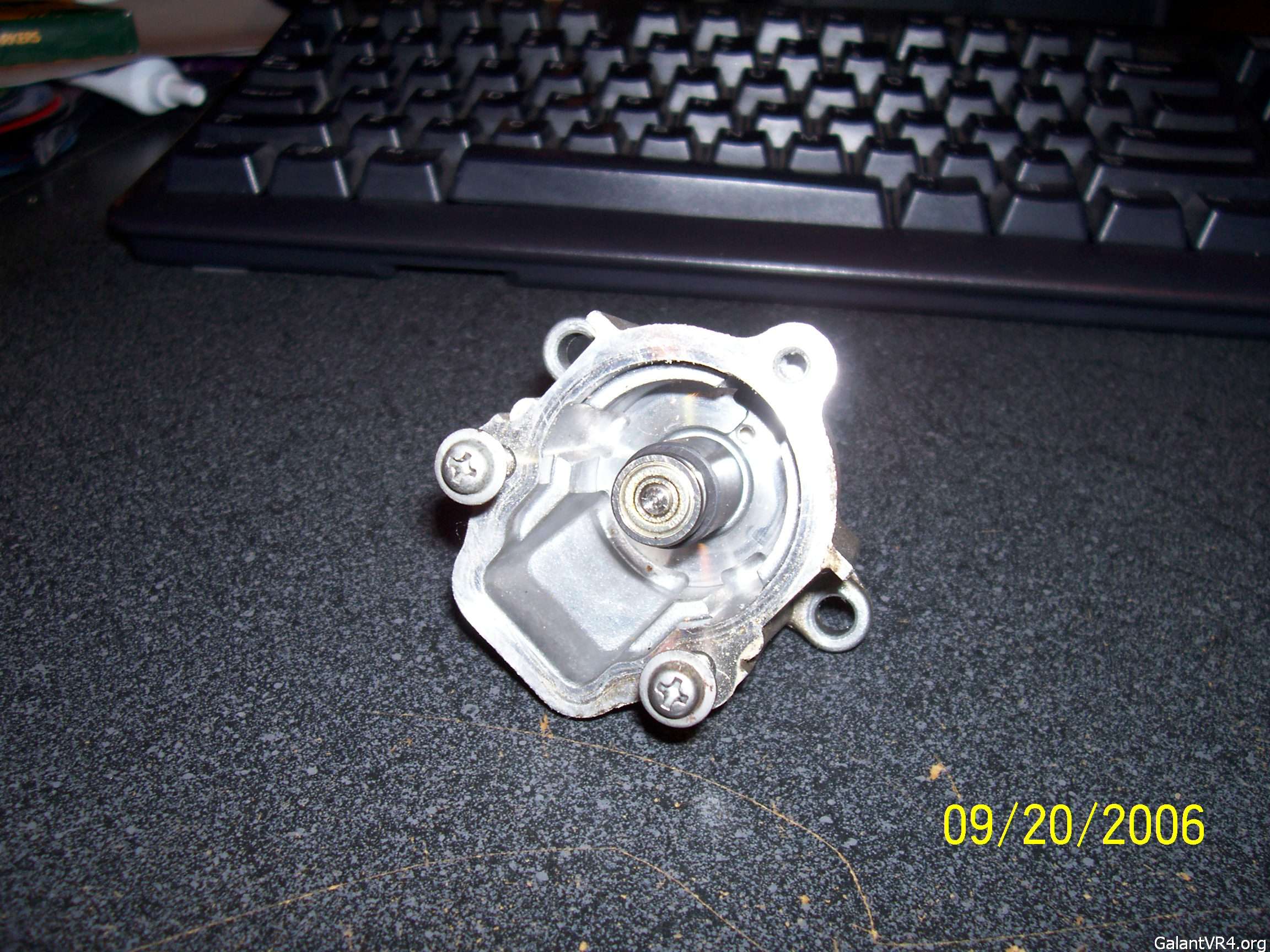

ISC base with shaft looks like this:
