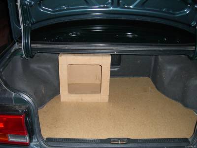

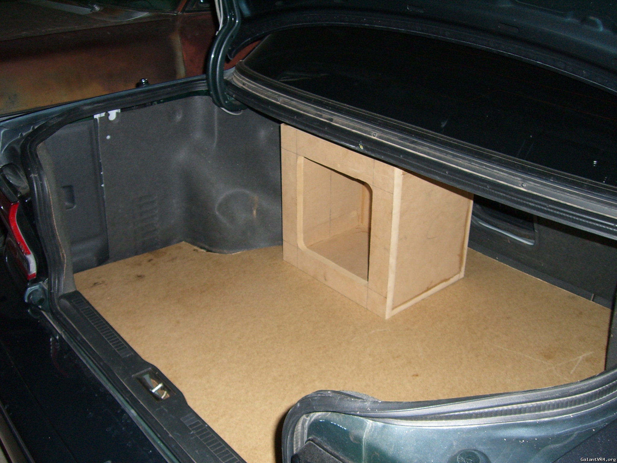

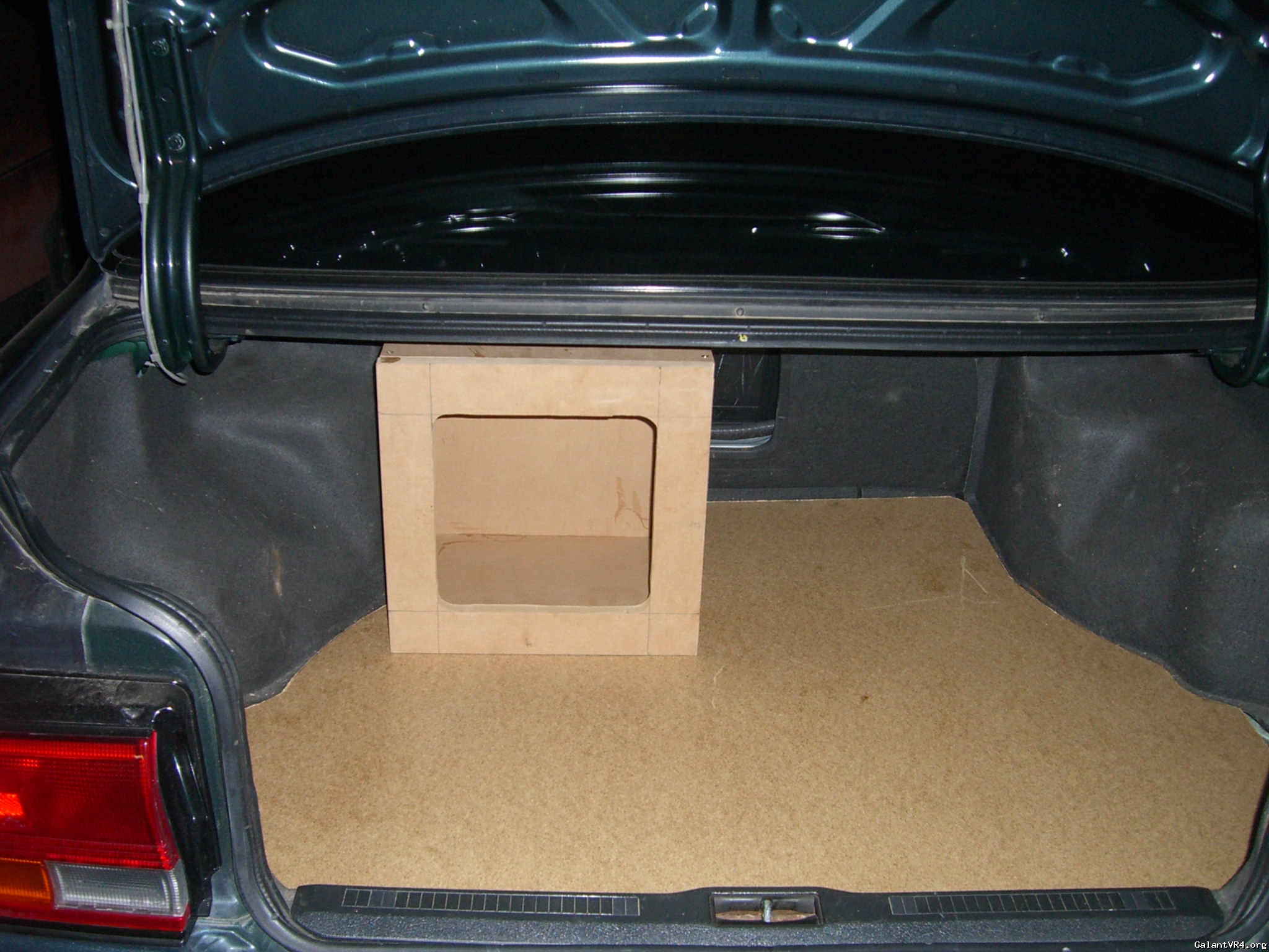

Here is what I have done so far. I am pretty excited and a bit upset at the same time. I got the box built and I decided to make the bottom of the trunk falt with a new floor piece, since I don't use the spare. I just have to seal the box with caulking, but I wanted the wood glue to dry overnight before I try and seal it. Then I just have to cover them with fabric and of course wire it all up. I am a bit upset because I over looked a simple measurement. The box it just a **** hair to tall and the torsion bars for the trunk rub ever so slightly on the top of the box. It will obviously only get worse once I add the thickness of the fabric into the mix. I will have to find a solution even if it is a box that is an inch shorter.
Here are the pics of the process.

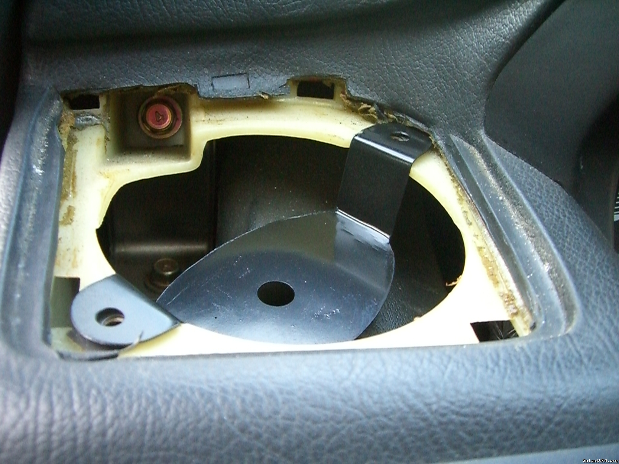

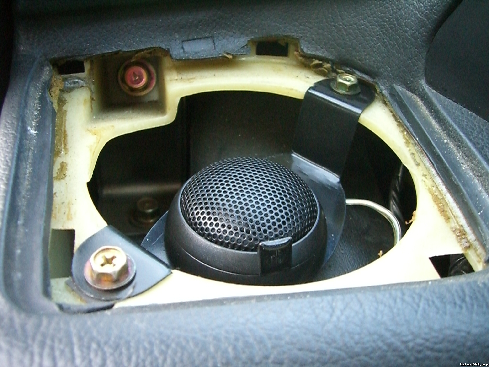

Tweeters in the stock mouting space on the dash with custom brackets. Nothing fancy.

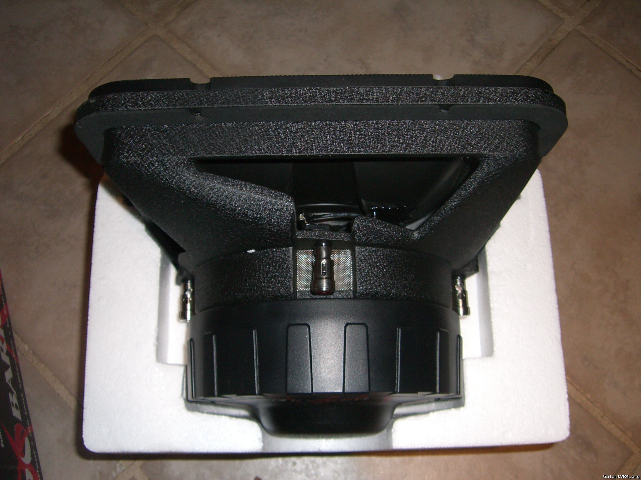

The sub I am using. It's a Kicker 10" L7.

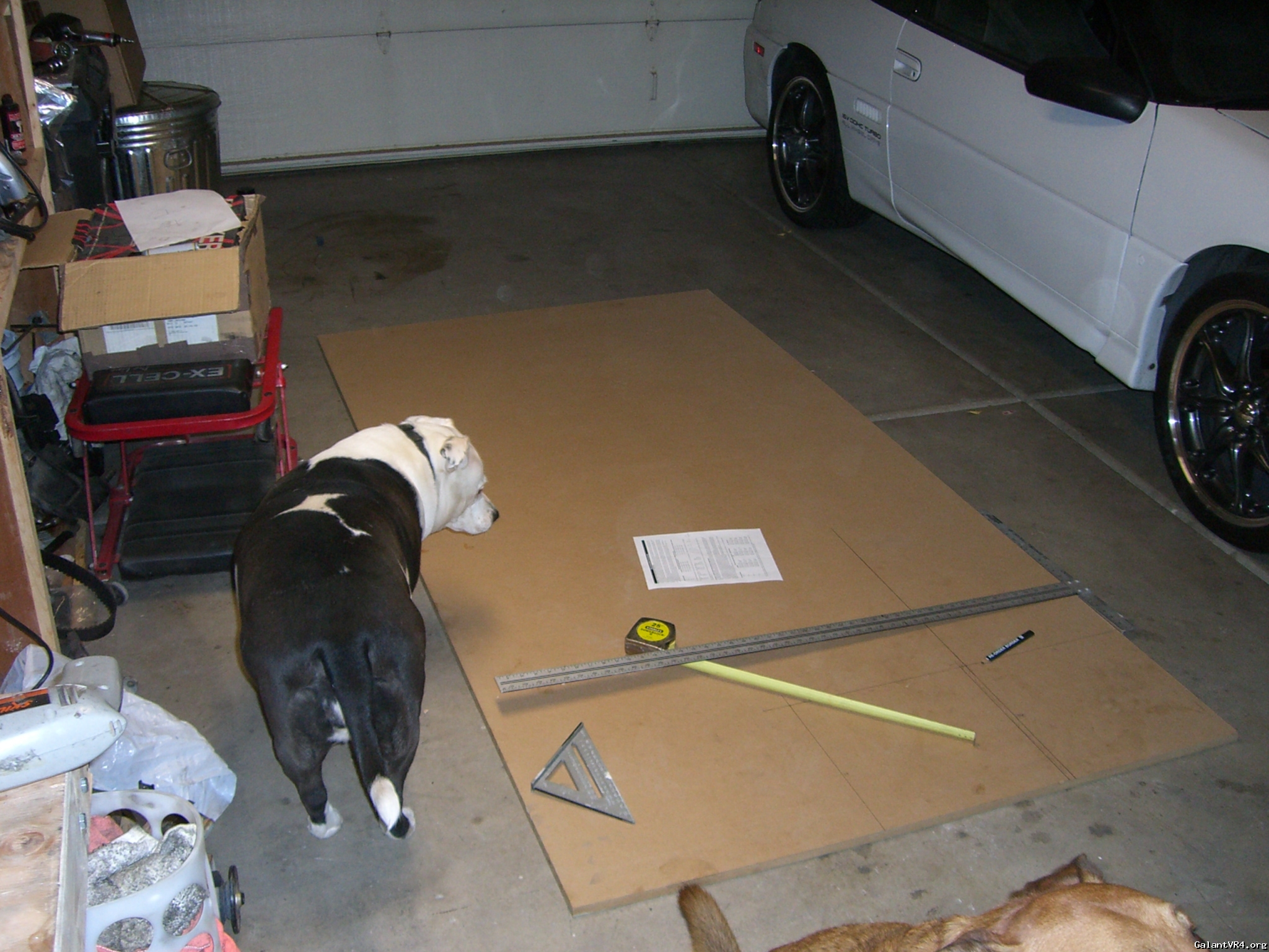

Me laying out the plans on the MDF.
The new flat flooring I made. It is till just a rough fit I need to smooth out the edges and of course cover it with fabric.
Floor with box.

If it is really that close can you sand it down to fit? You could attach it to the "new" trunk floor and not cover the bottom side with carpet...

a few tips for the box (if you haven't already.): when you go to seal it, run a few deck screws through where each panel joins, it will pull it tighter than glue/clamps. less for the sealant to actually seal.
get yourself about 1/2 lb of fiber fill, and pull it apart and stuff it in the box. you can usually find adequate fiber fill in a fabric store. they use it to make pillows and stuff. what it does is bounce the sub's sound waves around before making contact with the box walls, essentially making the sub think the box is bigger than it is (thats the best way i can explain it) allowing the sub to generate lower frequencies within the box wothout sacrificing the smaller boxes higher 'pressures'...... like so
not the most accurate description, but you get the idea. /ubbthreads/images//graemlins/grin.gif

Haven't looked at it in a while but there's two possible positions for the torsion bar. Not sure if the second position gets you more clearance or not. You need a special tool or build yourself one to get the torsion bar into the second position which is supposed to get you more trunk lift force.

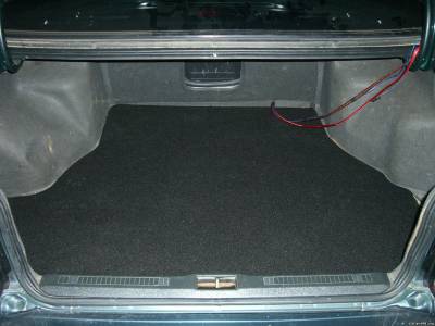

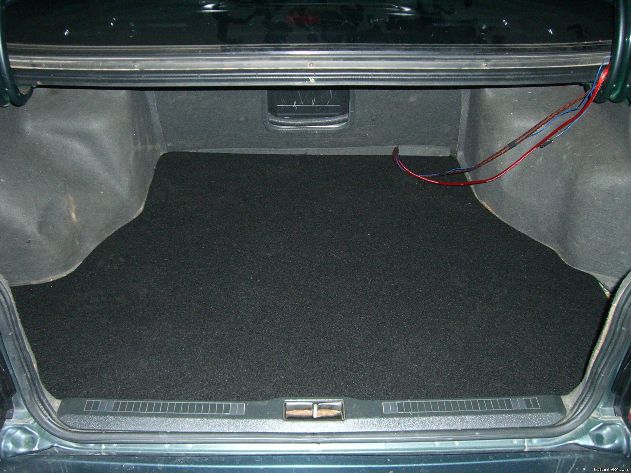

I have made some more progress, but my camera was dead for a part of it. I ran the wires for the amp, but didn't get to take pictures. I will check on them in the near future to make sure they have stayed in place and will take pics then. I also bought some fabric for my new floor and decided to do the entire trunk over in black. Tonight I started with the new floor and it came out awesome.

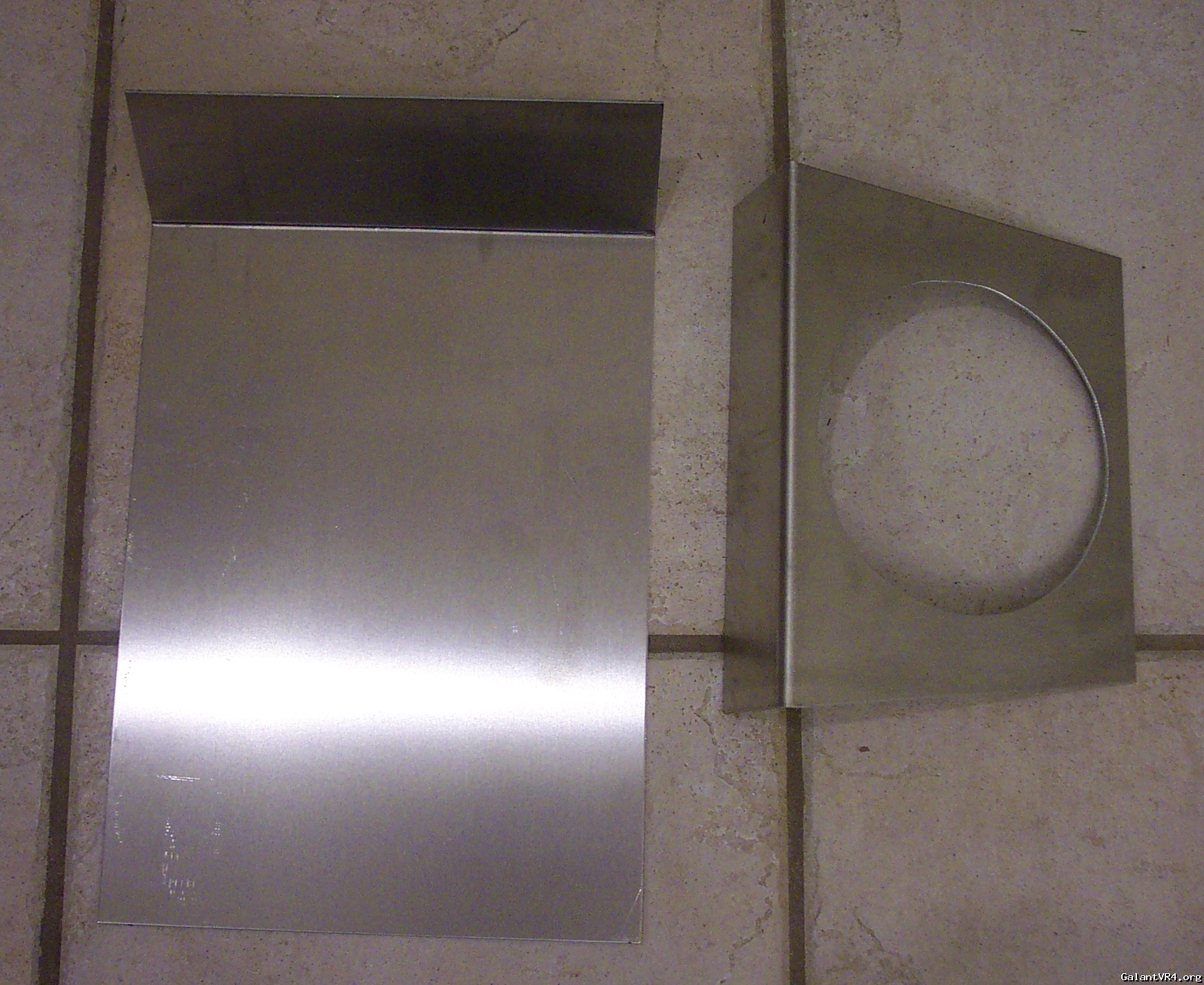

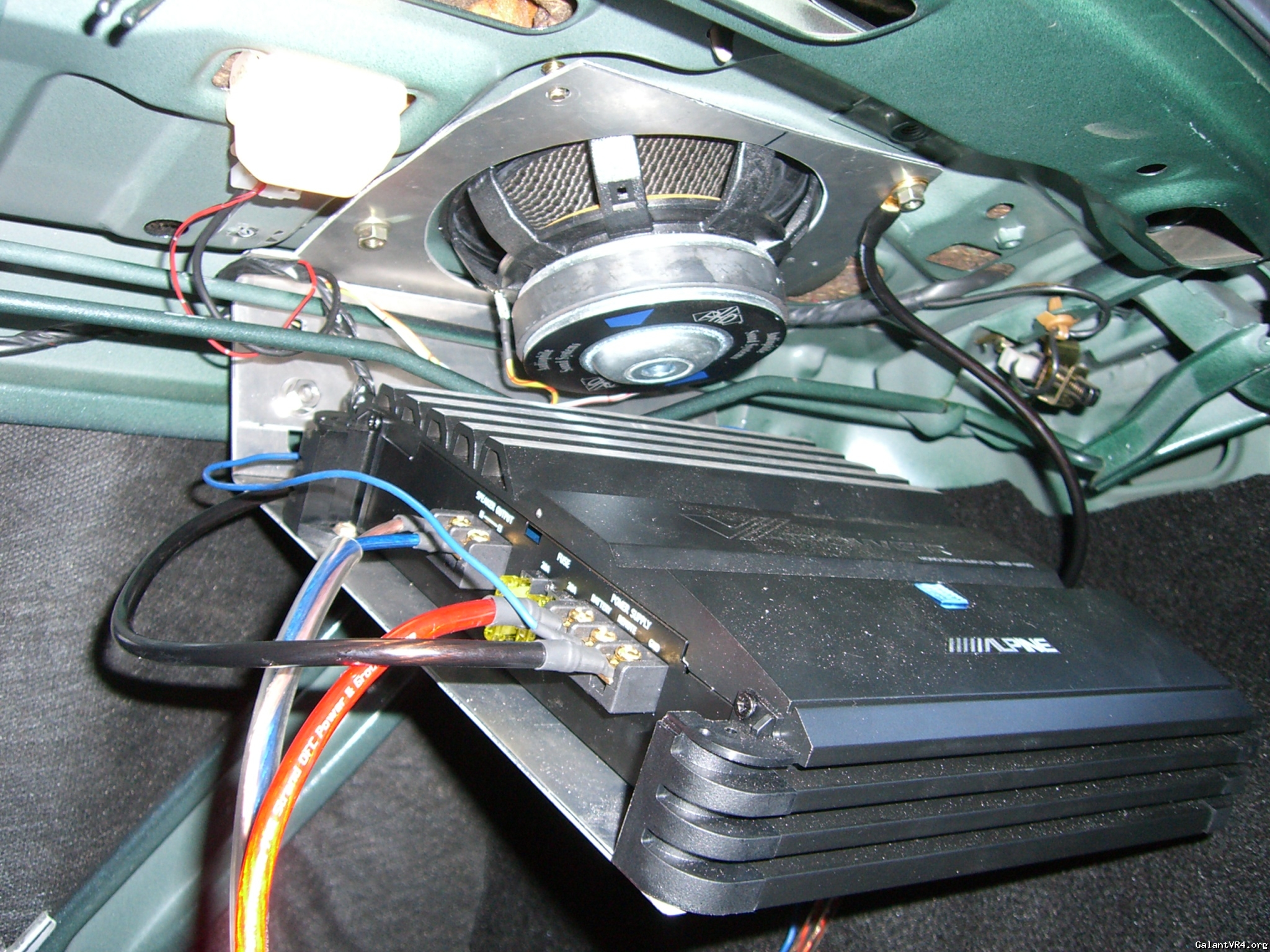

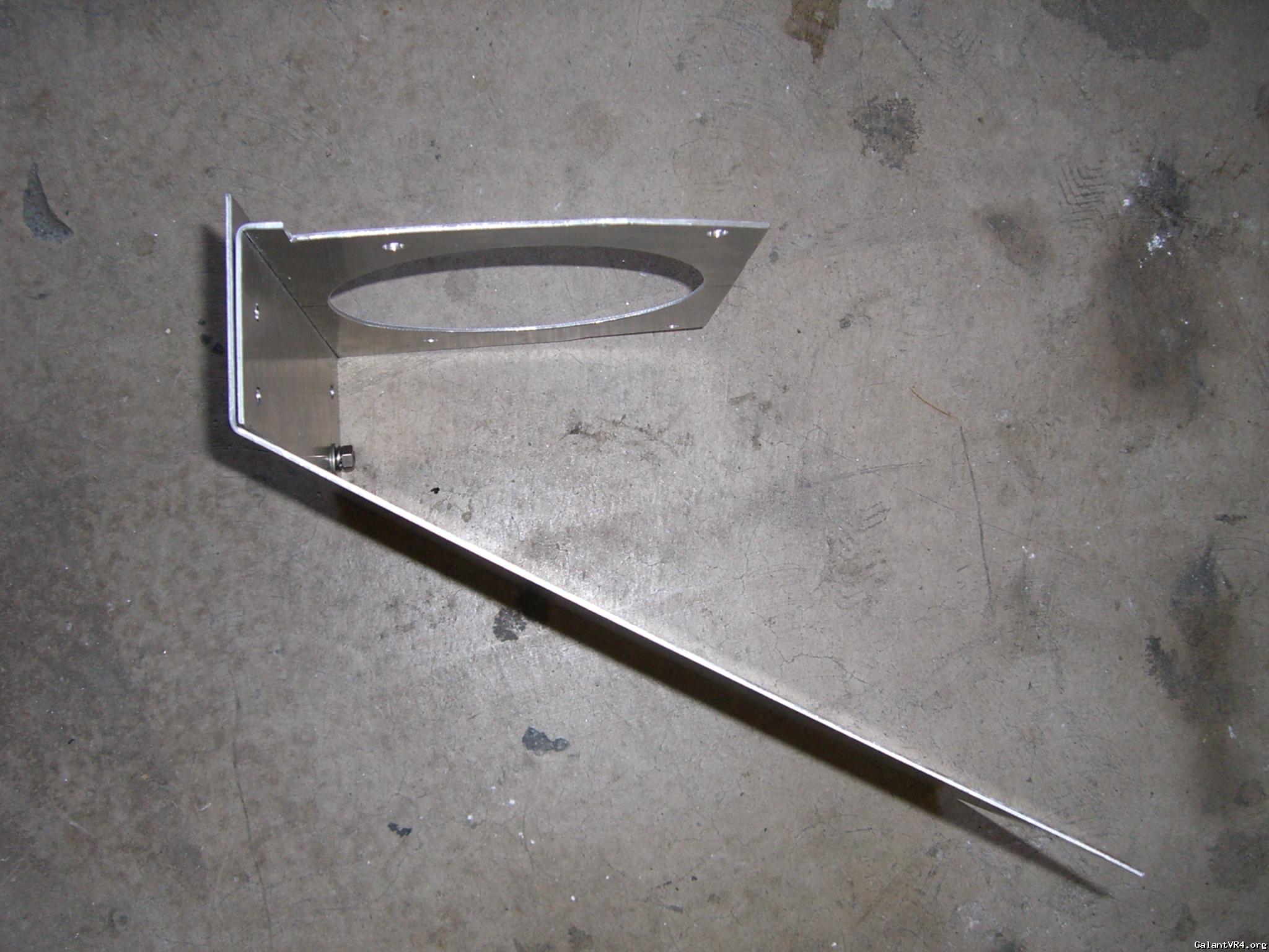

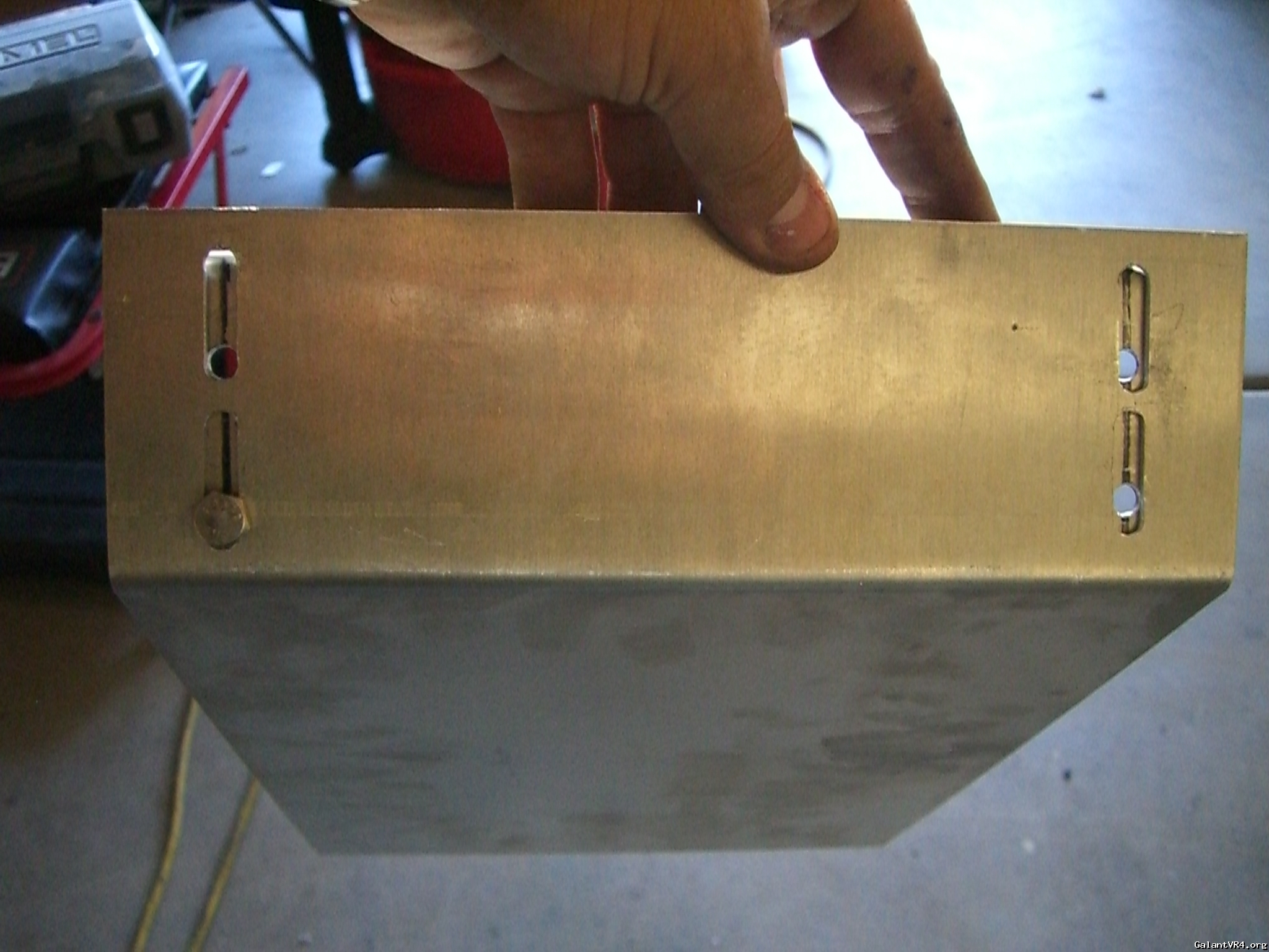

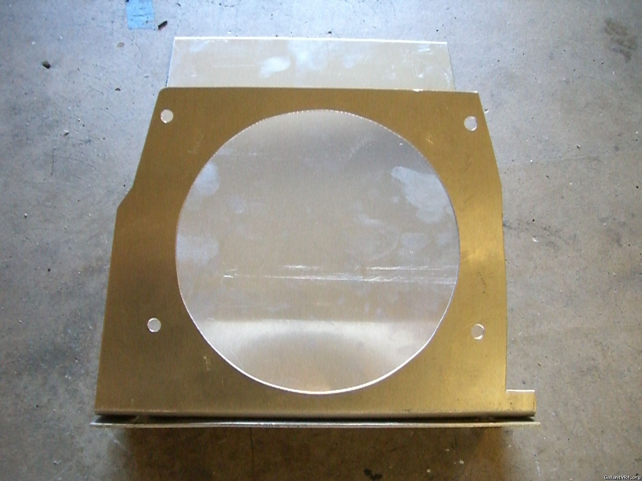

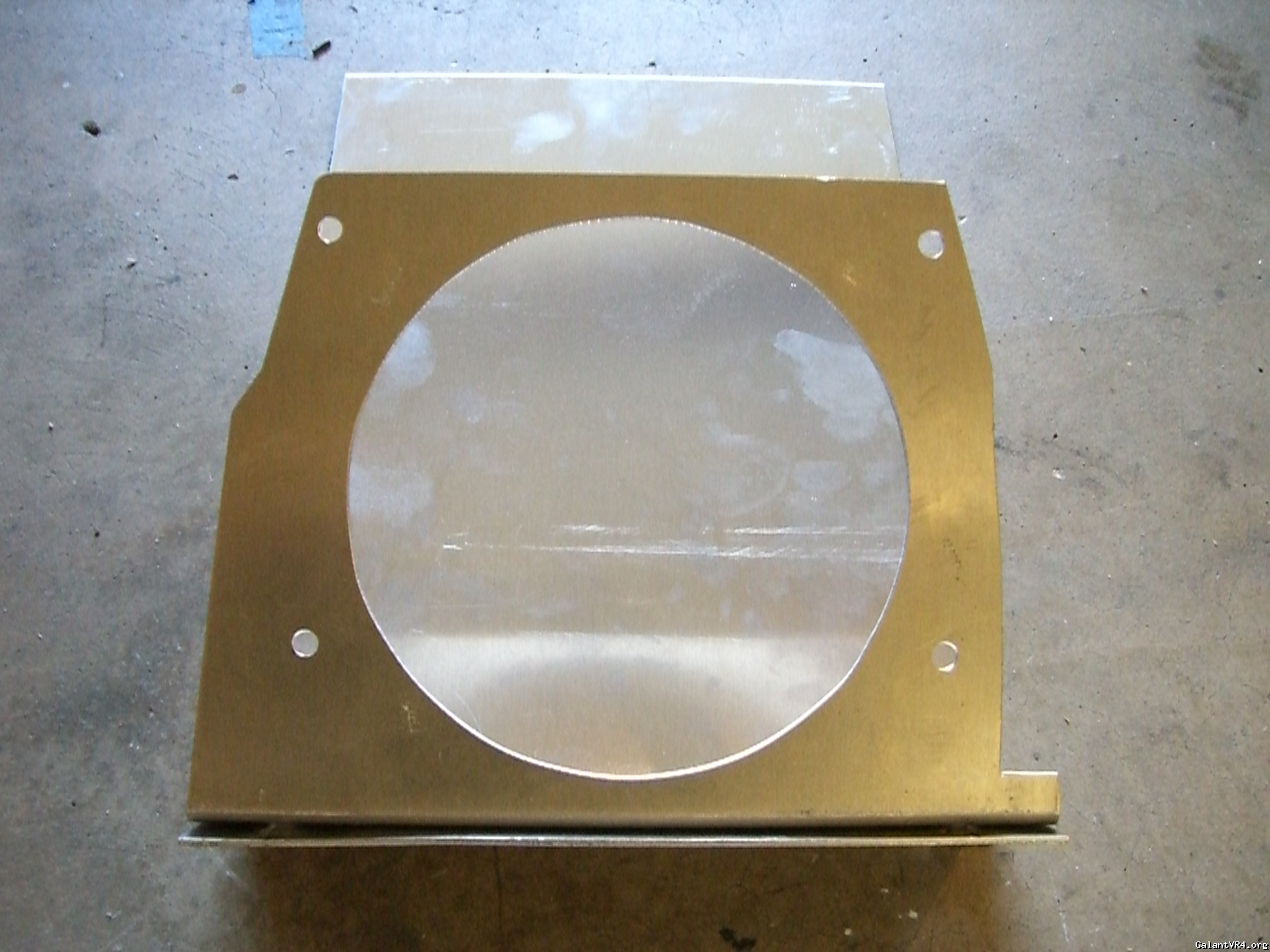

I also tried to make my amp rack and failed miserably. To my rescue came kcpaz and his amazing fab skills. The piece I was trying to make wasn't very hard, but he had the right tools and skill to get it done in a quick and precise manner. Thanks again to you Kent I really appreciate it. These are the pieces he made for me.
Those were the basic shapes I need and with some minor trimming and drilling of all the mounting holes I had a slick amp rack.

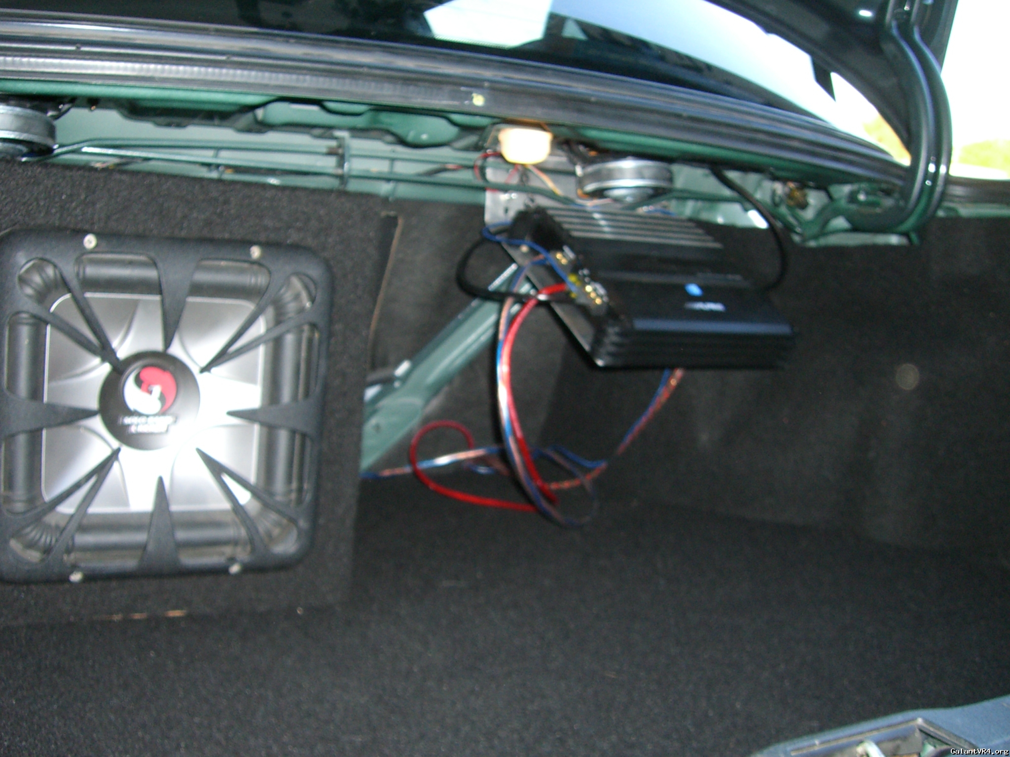

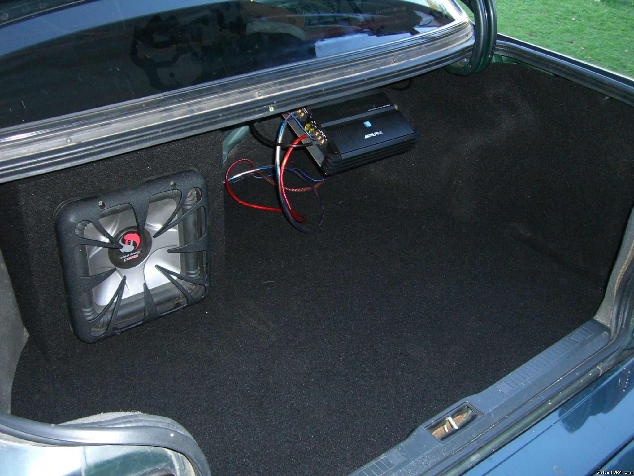

With all that done I could finally get this all installed. I also decided, because I am a bit anal, to change the trunk color to black. I couldn't find a grey cloth that matched the stock color so I was going to do the box and floor in black. It would end up bothering me if the colors weren't the same so I started another project, the color change. I ran out of fabric about half way thorugh and will need to get more, but you get the idea for now.
I think it looks really good and am pretty proud of the end result. I just have a few small things to do, like hide the wiring, and it will perfect.

wow, looks good so far. Do the trunk springs still function normally?
Another option to make it black would be to use fabric paint. It works quite well for applications like this cause of the cardboard type stock trunk lining material. It worked great for me on this type of stuff. If you don't feel like recovering it all, use the paint.
I especially liek the amp rack. The ground you have might not be the best though. I'm sure it probably works, but the bolt you have it on goes to the plastic grill. Probably won't make a difference, but if you can find a better spot closer I'd switch it.

Yeah the trunk still works perfectly. The strut only rubs the top of the box when the trunk is open and even then it is just a slight rub. I will change the ground when I put the front piece of carpet back in. I just did that one to "bump" around this weekend.
So far the weekend has been fun messing with settings and getting it to sound the way I want. It is really nice to listen to music and here the low side of it the way it was intended.
