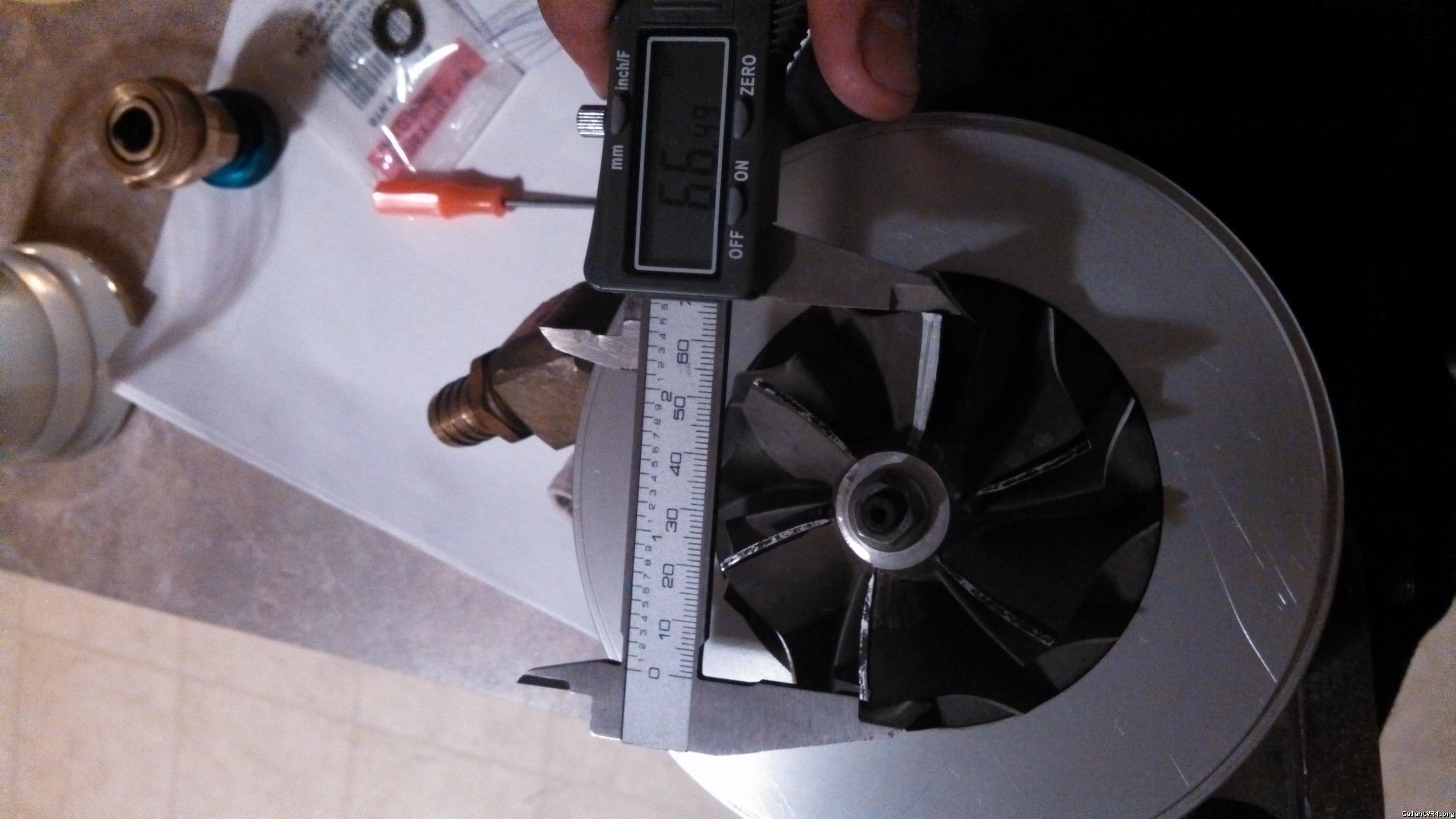

So this is the turbo pulled from 733/2000 and I'm trying to figure out what it is. I believe this is Turbonetices but I'm unsure

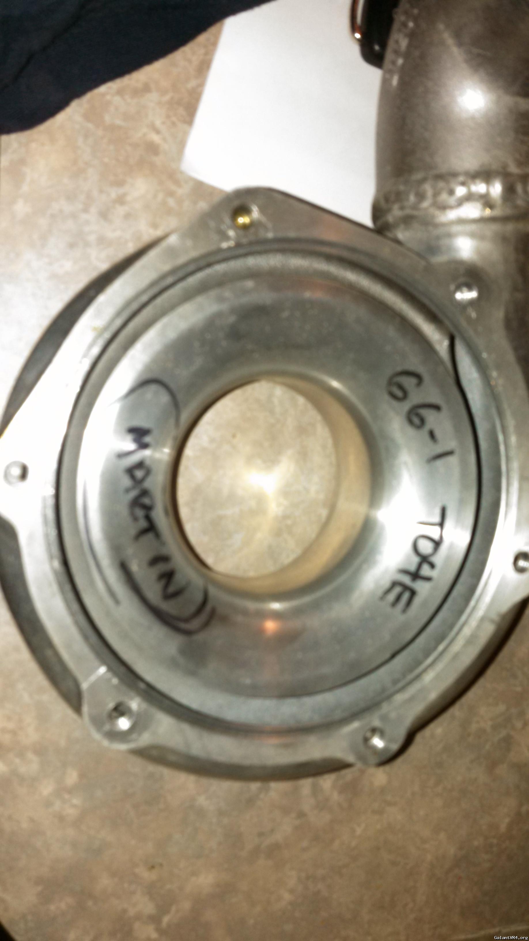

When I pulled the compressor housing it said "66-1 T04E." The turbo has a T3 inlet flange.

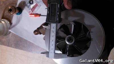

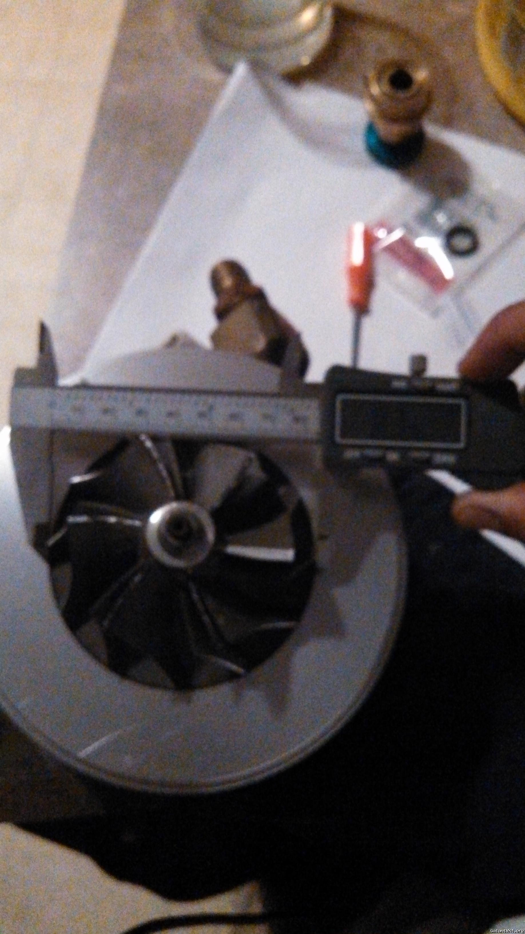

The compressor wheel measures in about Inducer diameter = 66.5mm

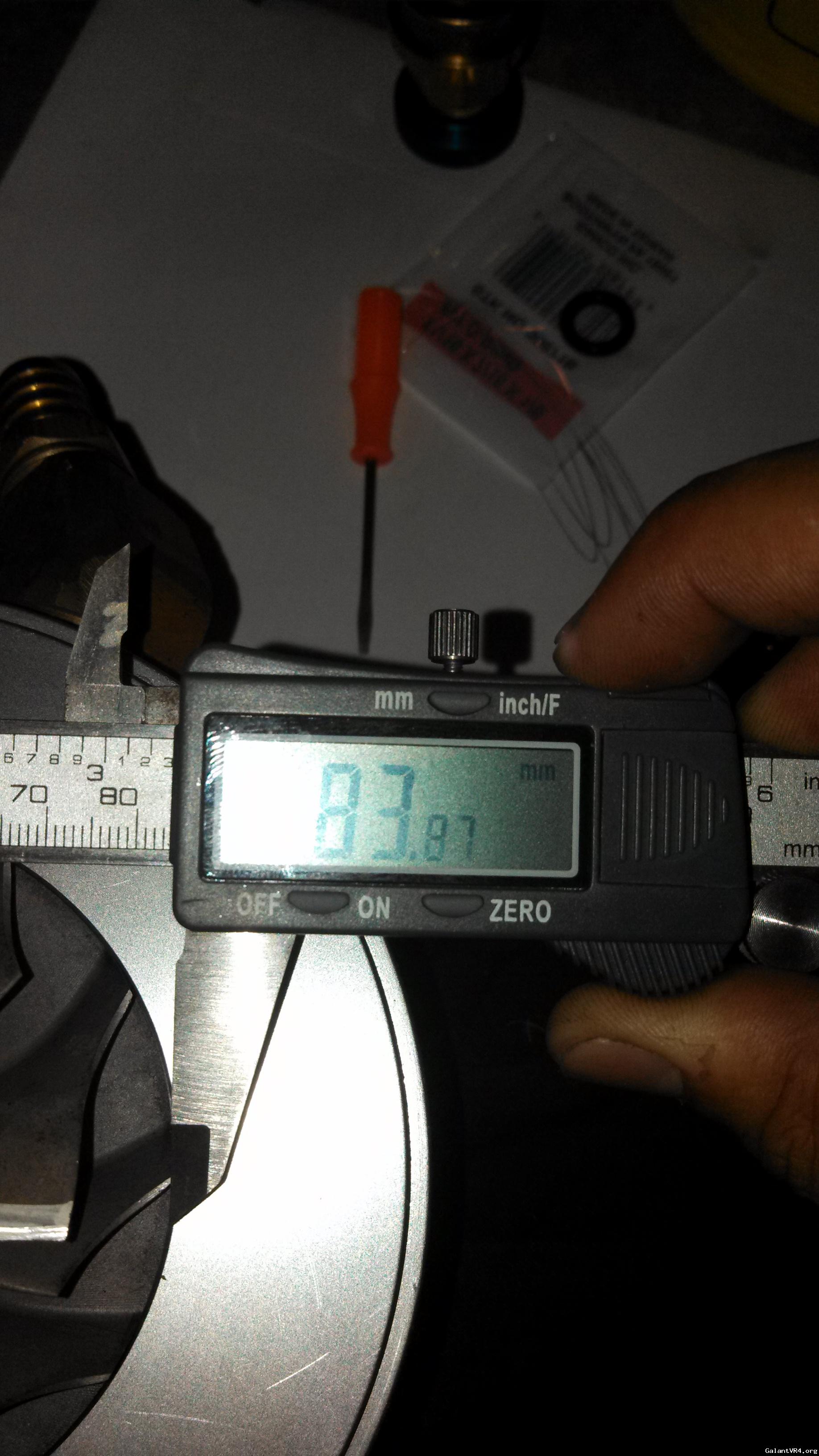

Exducer diameter = 83.8mm

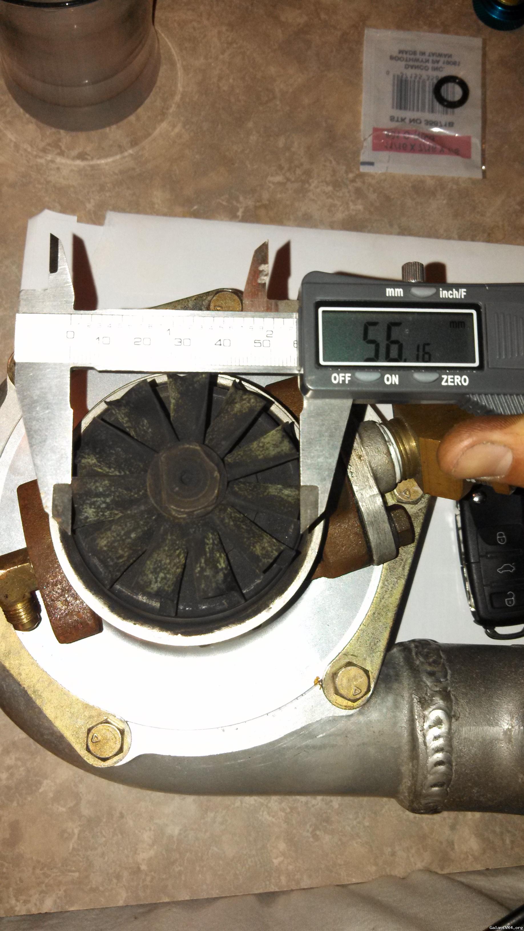

The Turbine wheel measures in about Exducer diameter = 56.25mm

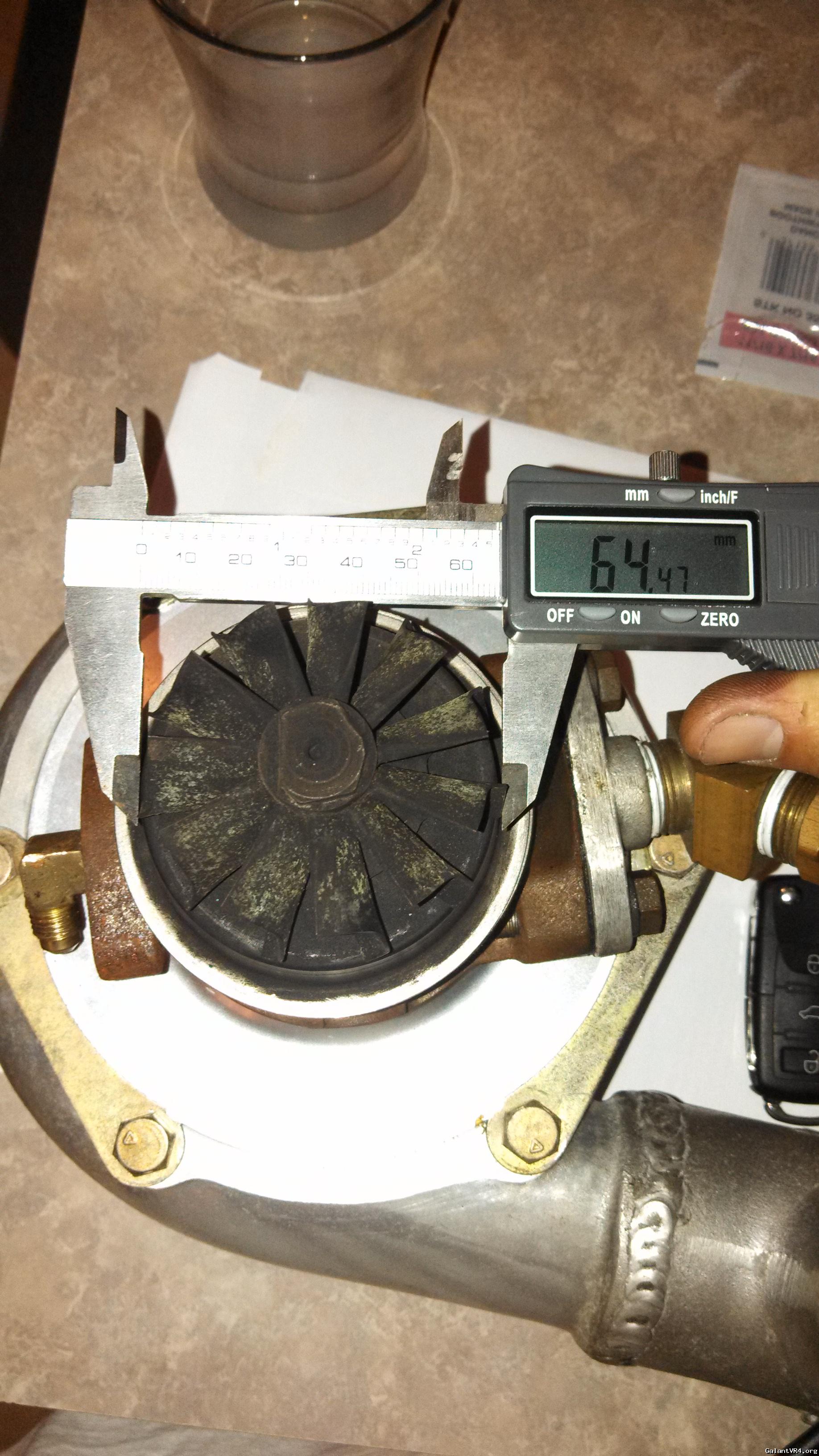

Inducer diameter = 64.00mm
EDIT: Well it looks like a "T" series turbine P/N:451314-0003 (77 trim)
