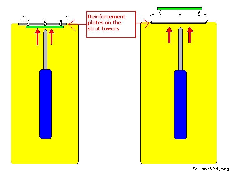

No matter how strong the bolts are, they will inevitably fail.
How do you reach this conclusion? /ubbthreads/images/graemlins/dunno.gif
My initial guess is that the bolts would not fail, but the sheet metal below the bolts. Unless you have a sufficient backing plate. However, I'd have to know the grade and size of those bolts before I could make that judgment.
I belive that it would happen because the force of the strut would be pushing against the bolts and nuts, instead of the strut tower reinforcement plates.
Barnes

Yes. I know the force would be held by the bolts. That's why you have bolts that are strong enough. You said: "No matter how strong the bolts are, they will inevitably fail."
I'm sorry. That's just flat wrong. With a reinforcing place and correctly sized Grade 8 or 10.9 bolts, I doubt you would EVER have a problem. A single 1/2" grade 8 bolt will hold over 20,000lbs axially, and about 14,000lbs in shear. This doesn't factor in fatigue, corrosion, etc etc, but you get the idea. Maybe I'm nit-picking but I'm a stickler for the facts.

What barnes and others have said is when I'm more concerned with the other issues I brought up. For the time being she waits until I can decide what to do.
You have ground controls?
They seem to poise a ridiculous amount of pressure right at the strut top.

I guess "Barrel Springs" on the GC perches helps relieve some of that side-loading, but this type of coil-over, mixed with a McPherson Strut causes crazy high loads right where you are about to use an adaptor. /ubbthreads/images/graemlins/dunno.gif
