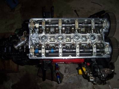

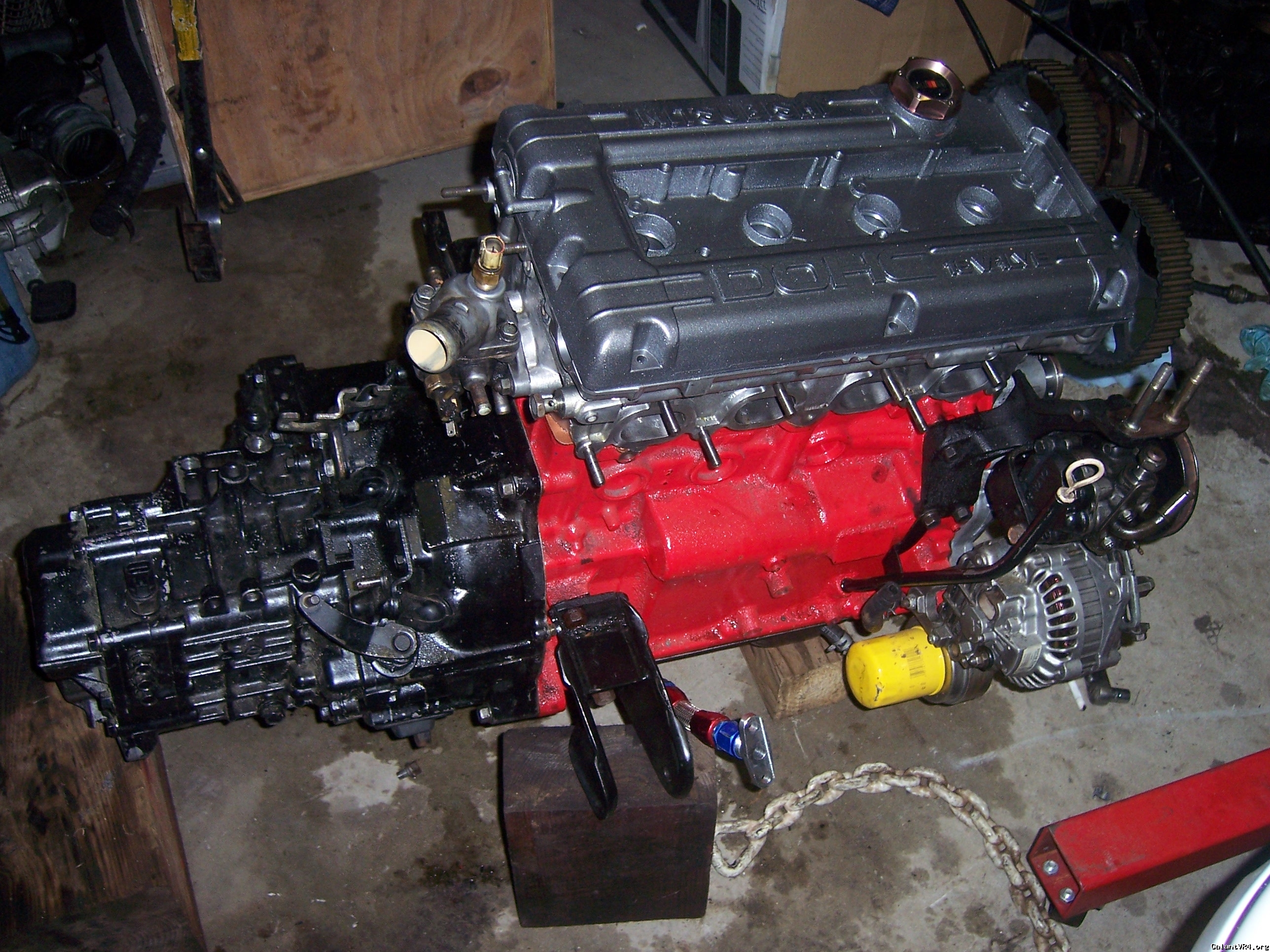

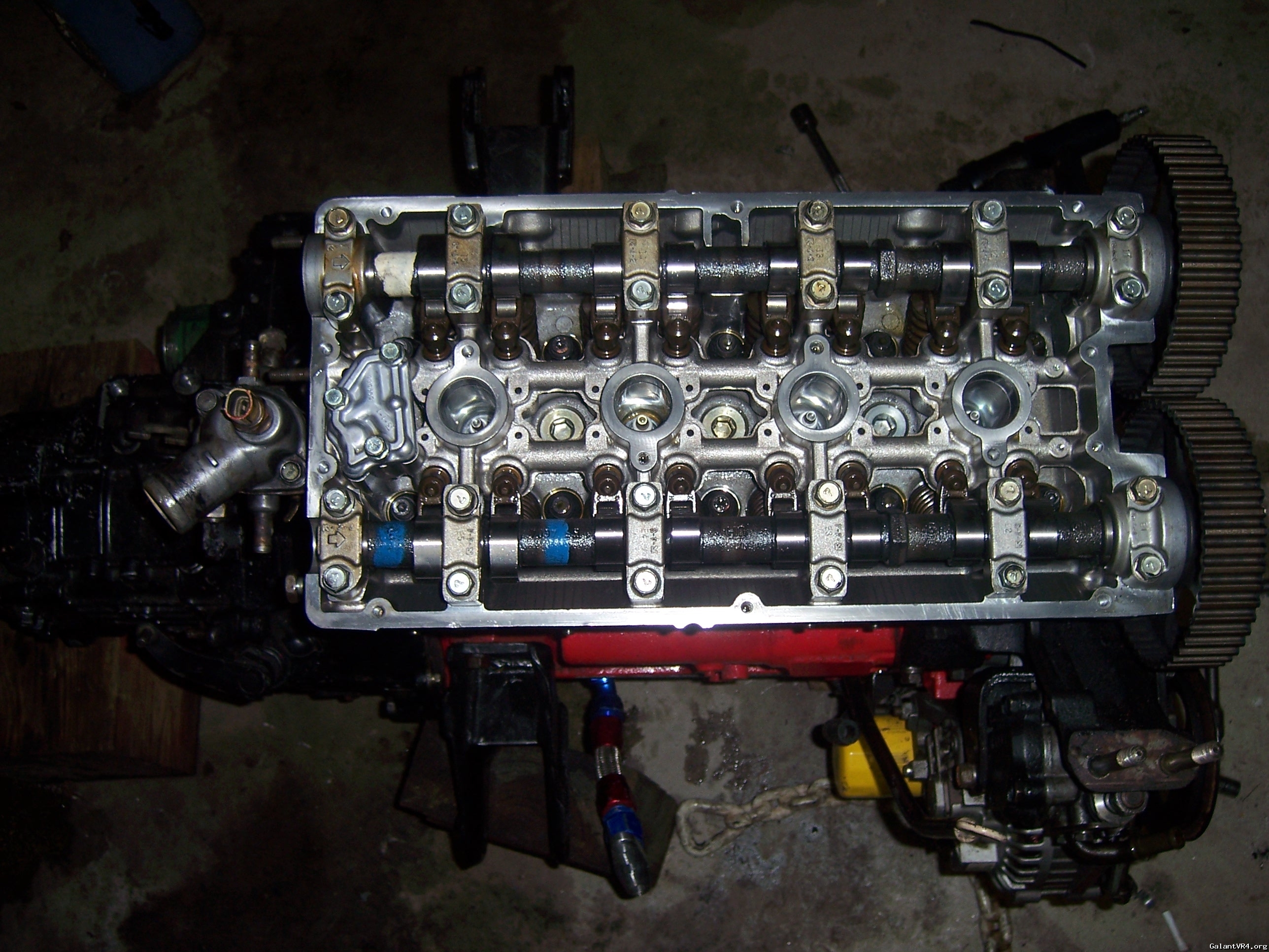

Finally got some time today work on the car.
HEres a couple pics of the motor..Im going to do the timming shortly and hopefully be out of the JSB crew next week.

Don't worry about it. It's a Galant, if you're out of the JSB crew, it'll only be temporary /ubbthreads/images/graemlins/wink.gif
Looking good, by the way!
