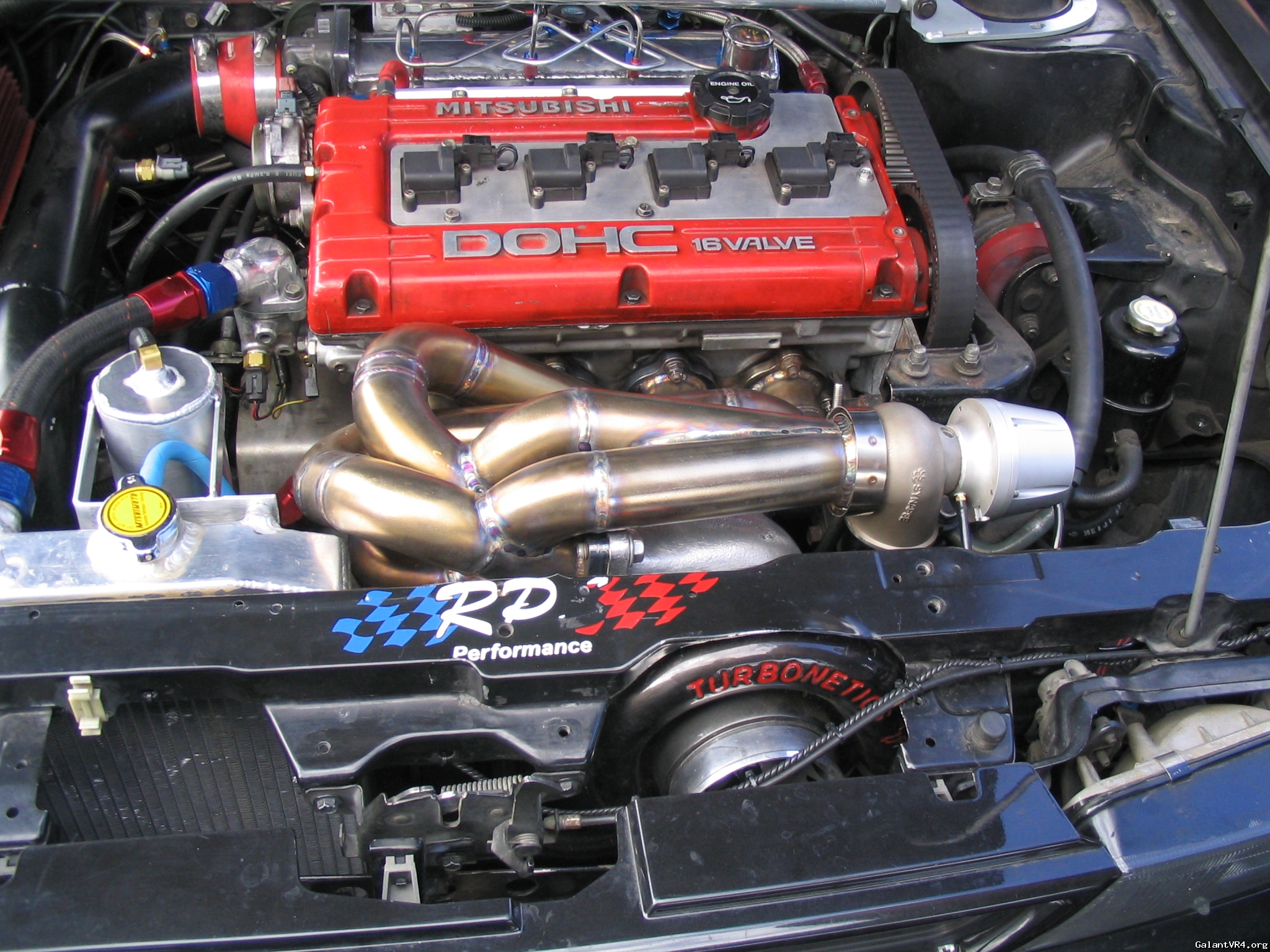

After seeing the STM manifold I have not been able to get my mind off of how cool that would look on the Galant. So finally my brother and I, got started.
Here is the Mock up.
Materials.
Custom One Off Head Flange - Brother CNC Machined it
304 SS Weld El's Sch 40.
click - acestainless.com
Here is a ghetto moch up of the pipes. We are just trying to plan everything out before we start tacking stuff together. So dont poke to much fun at the awesome blue tape /ubbthreads/images/graemlins/smile.gif.

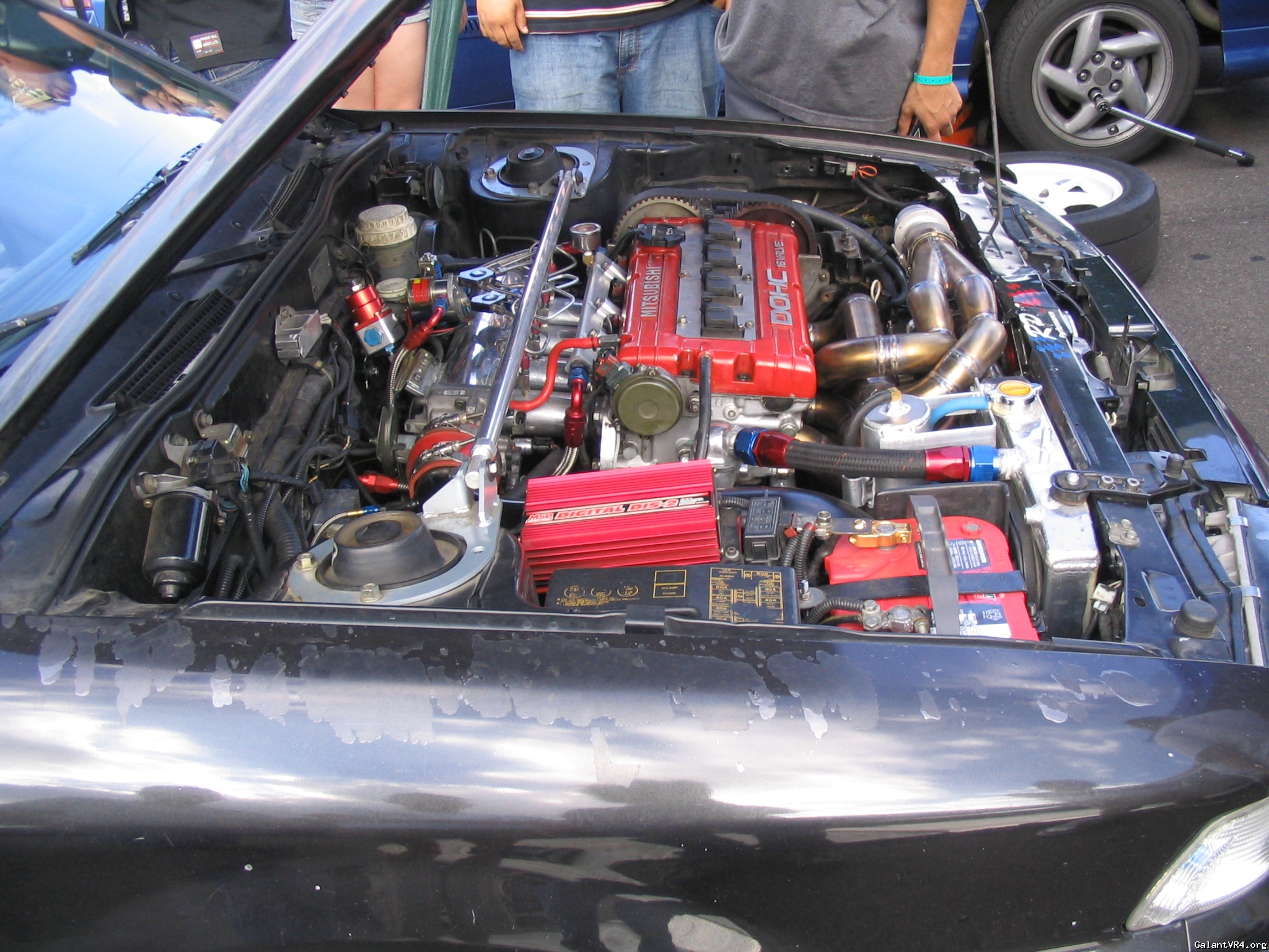

Toybreaker sent me these a while back the car ran at the Pinks event last year in Colorado.
11,983
Finally, a real reason to use a Honda radiator. That looks killer. Prison Rape? /ubbthreads/images/graemlins/rofl.gif

Quoting curtis:
And since I'm contributing to the design process I'll get you my address for a PRI flange. /ubbthreads/images/graemlins/grin.gif
I love how well that engine bay looks but the exterior paint is all messed up. people won't even give a second look at the "run down" car until you open the hood and will be like HOLY SHi.......

Yep it is an inside joke. My brother and I always try to mess around when building parts, and we figured it would be awesome for people to look at the manifold and be all "Prison Rape???" LOL.
This is our first run at building a manifold, so who know how it will turn out. I figure the material are pretty cheap, so for me it is a why not.
