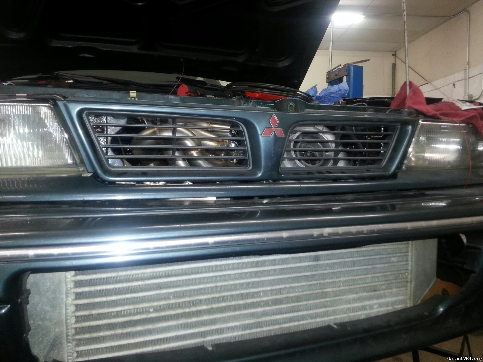

Setup Change cont.

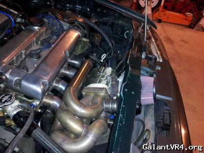

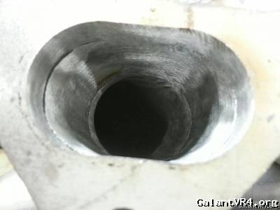

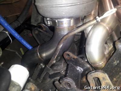

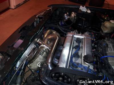

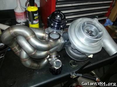

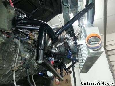

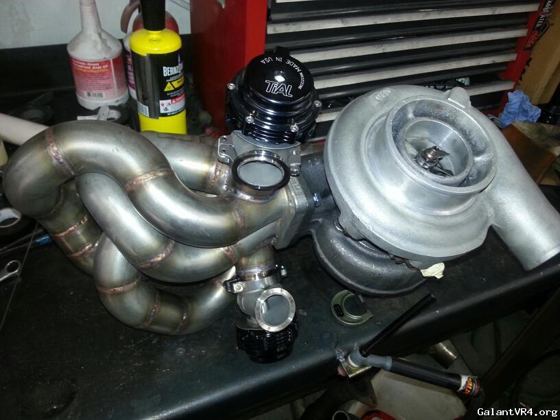

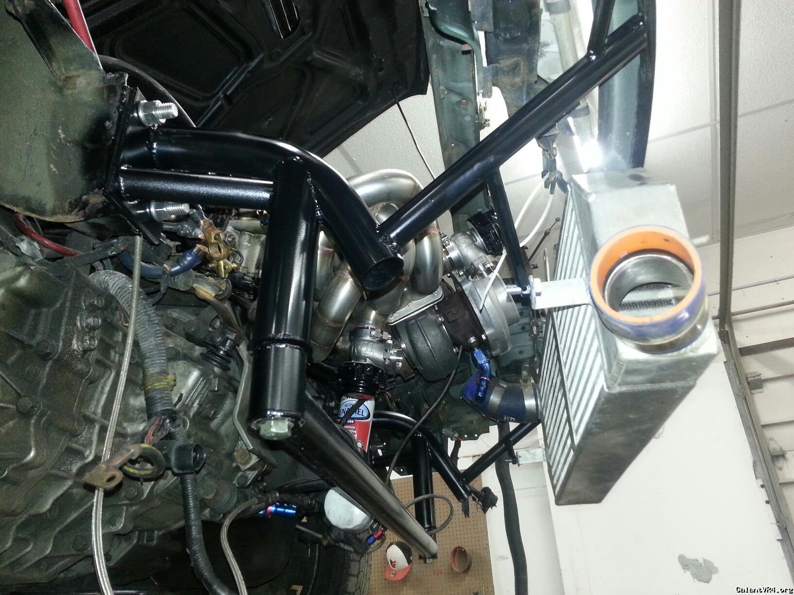

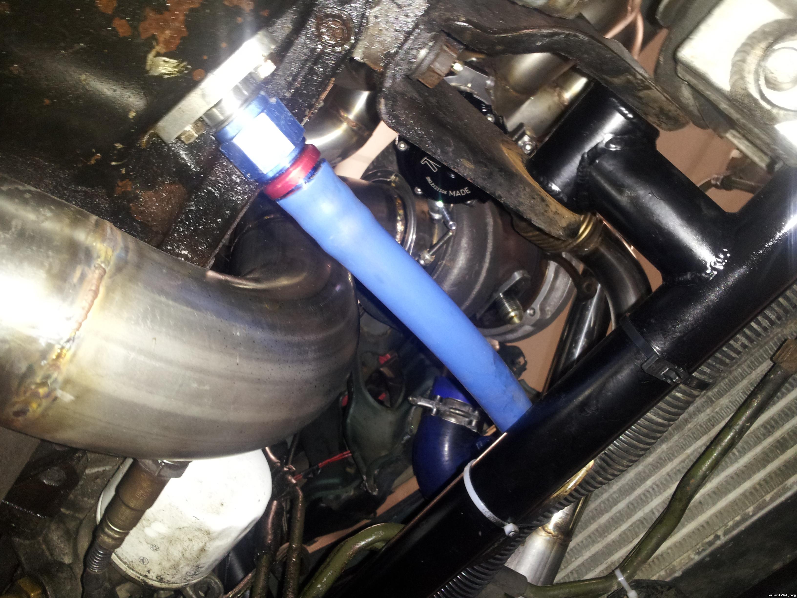

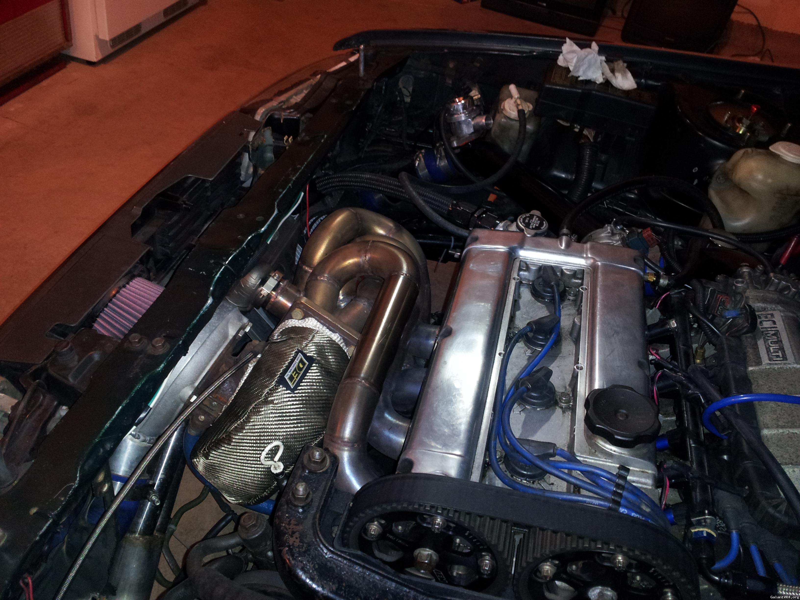

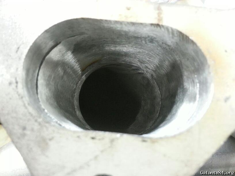

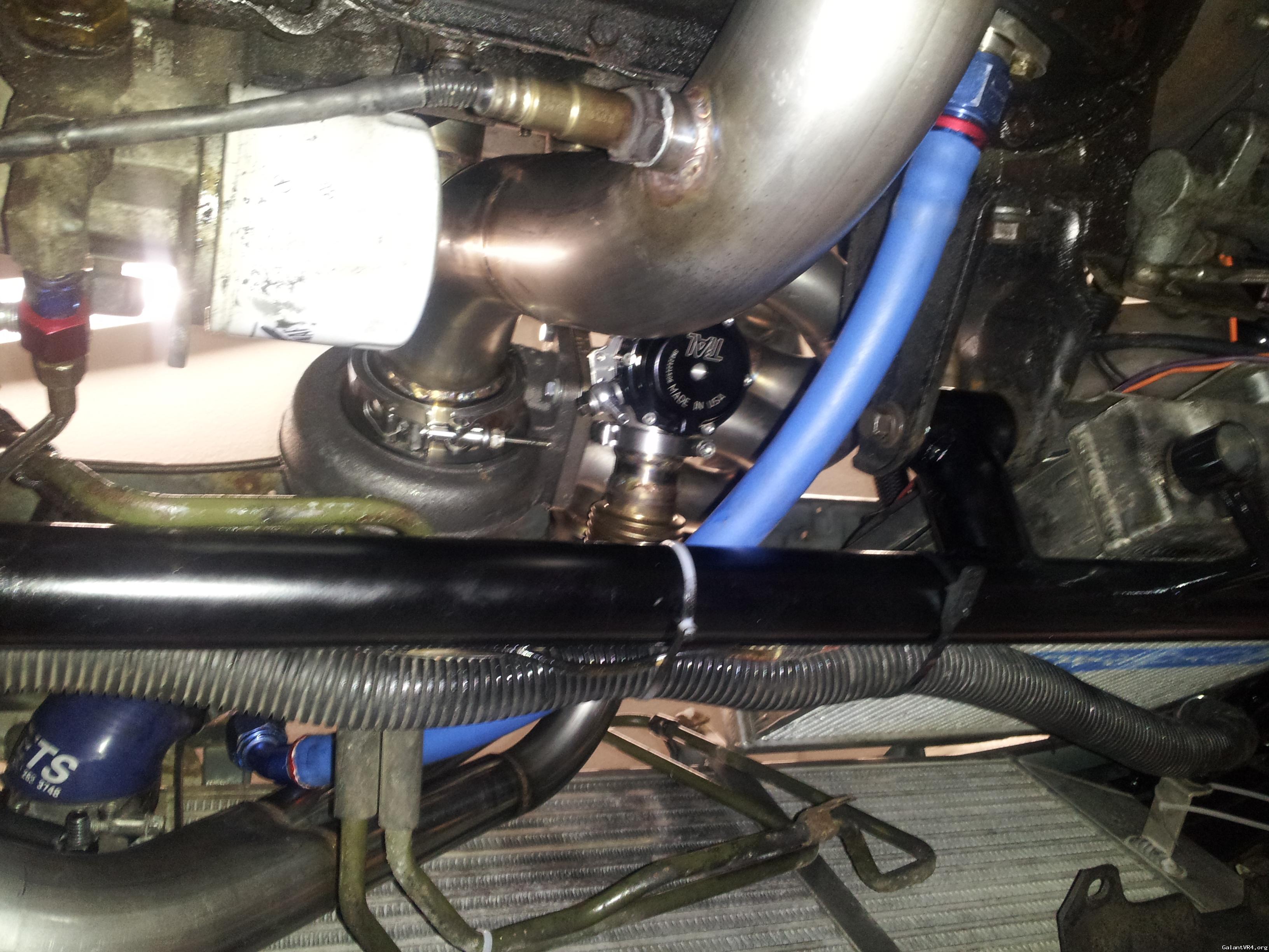

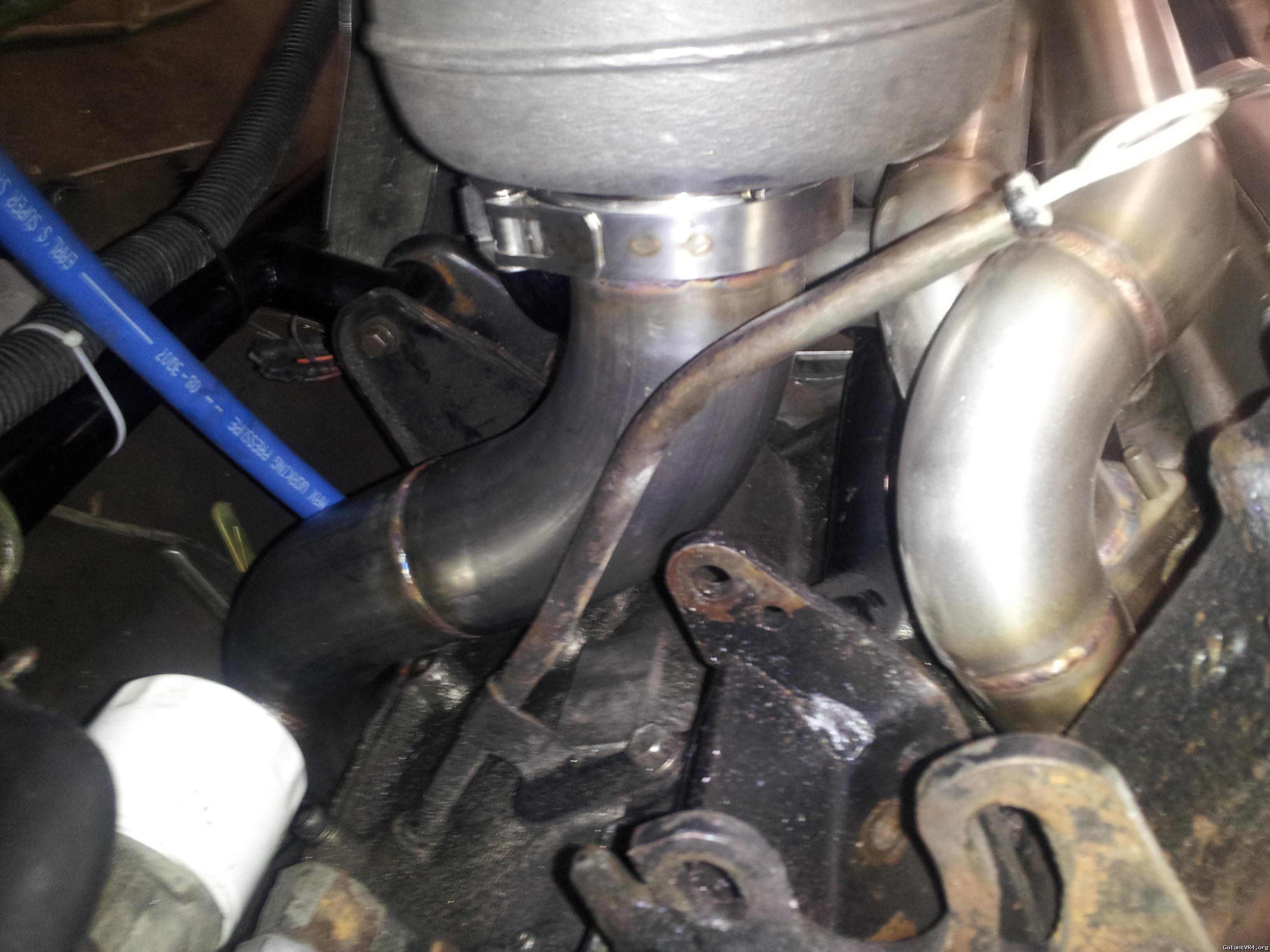

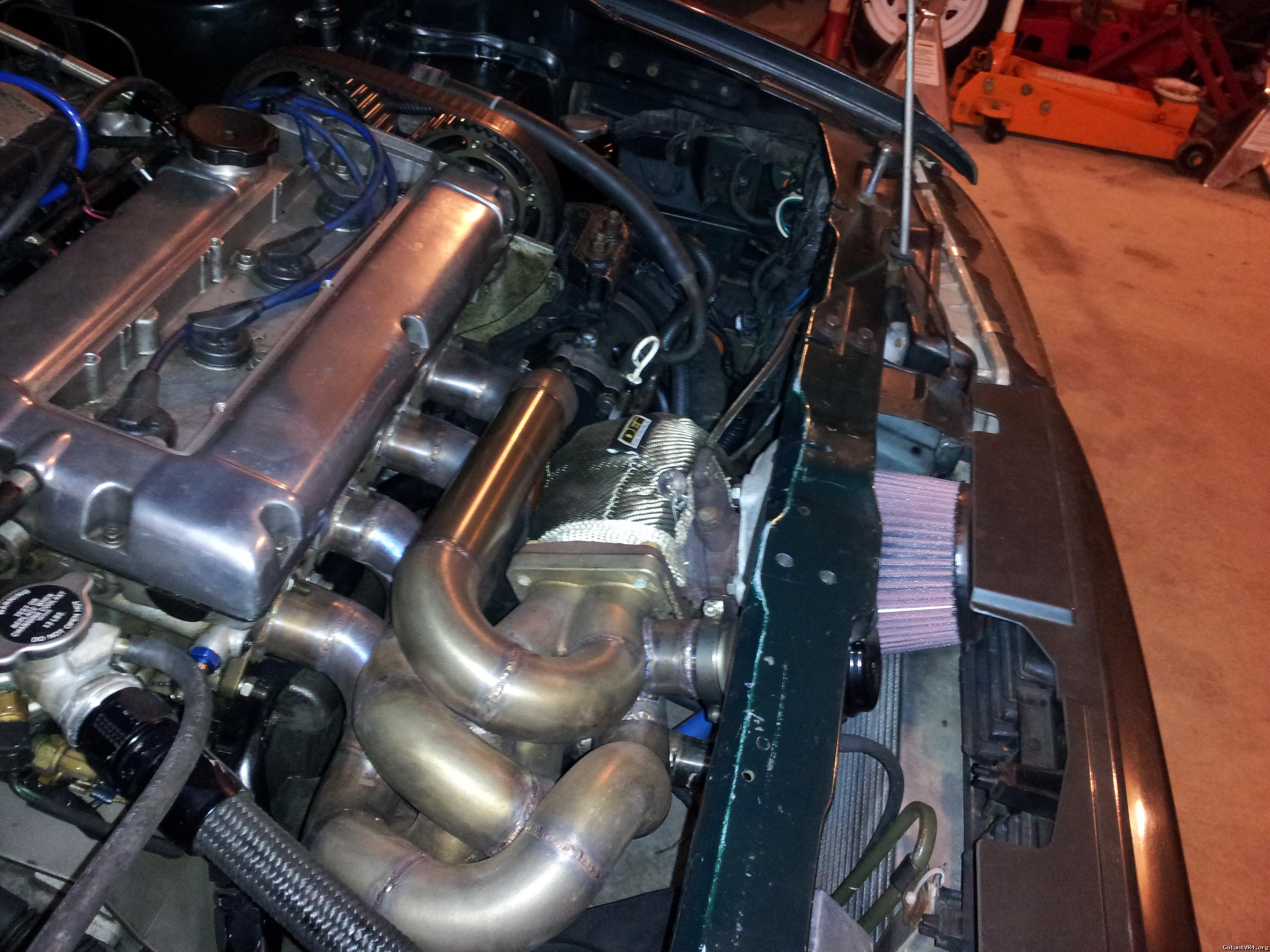

So a buddy of mine had a 1.00 Twin Scroll T4 Turbine housing for my turbo. He said it was a bolt on affair so it was more motivation for me to step out of my .55 bolt on setup. I bought the turbine housing and the slick Treadstone Cast T4 Twinscroll collector he had. I started pulling off the old setup from the car. I was thinking about a nice top mount setup similar to the JMF kit. I realized on my car that it would take quite a bit of work. I ended up settling on a foward facing setup. The turbine housing I bought from my friend ended up being to small. I had a less common larger turbine housing being a 74mm. I had to machine out the housing a little bit to make it work. With the turbo assembled I had my good buddy fab up the exhaust manifold. I ended up using 304 1.5 sch10 tubing. I was really looking into 321, but it was easily 2x cost for the parts I could find and most of the tubing had a decent wait to obtain the stuff. The head flange actually came from AMS performance. They were selling waterjet half inch stainless flanges for a heck of a price. The nice thing is the flange is the same shape as the port throughout instead of the adapter flanges made for tubular exhaust manifolds. I disliked the transition most of those flanges had.
While I had my buddy fabbing the manifold I took the time to delete the ABS pump and lines out of the front of the car. I can only say it was a miraculous weight savings and pictures and weight numbers in forums mean nothing until your face to face with that beast. I ended up cutting off some of the front of my car and fabbing some tubes for additional weight savings and space for my manifold setup.

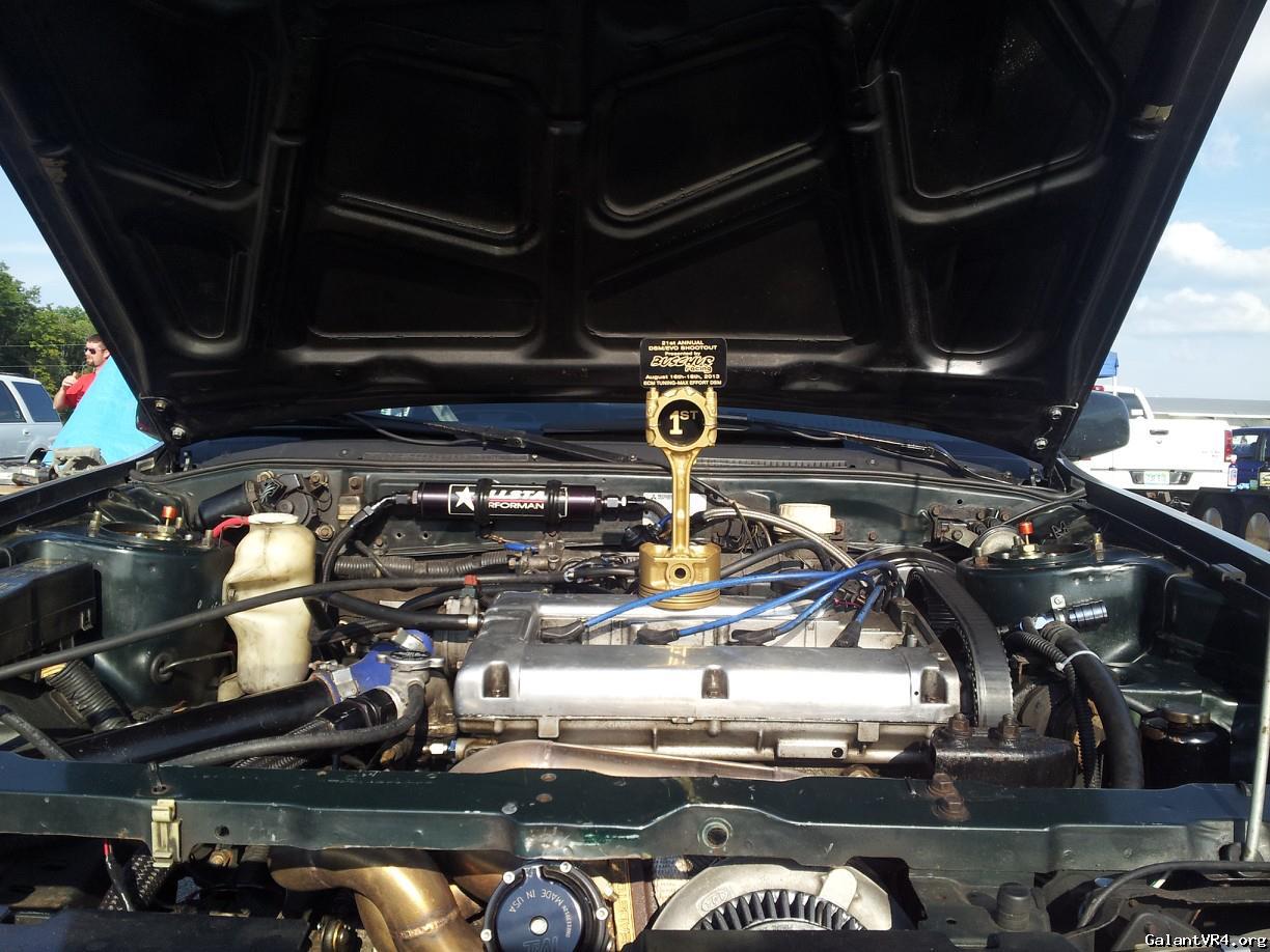

My engine bay is still awful disgusting/embarassing so please to rip on me too hard. This car gets daily driven so I haven't had the time to clean her up really. I'm trying to save up for a Magnus Cast intake manifold and at that time I'm going to change my intercooler setup and piping too, although those plans keep getting shifted back. My rack and pinion decided to finally give up the ghost so I had to order a reman. Lets just say those aren't as cheap as I was hoping they would be. It'll be nice to have a fresh rack though. I plan on doing the steering pump mod too so I can have more steering assist at high rpm.

Some quick results of the setup is around 100whp at the same boost level. I know not all of that is from the manifold and turbine housing though. I have an external dump now. I suspect my old punishment recirculating 02 housing was also choking me some too. The surprising thing is that my car spools as fast as it did with the bolt on housing and it recovers faster when shifting and what not. I can hit 35 psi by 4400rpm in third gear. This thing is an absolute monster. I need to get it back on the dyno since I've had time to build a good VE table. I'll try and post some screen shots of my logs. At 25 psi of boost I'm getting 1.5-1.6 70-90's. I should have no problems with deep 11's and maybe 10's with the boost cranking although I'll have to wait until shoot out for that since I'm missing a roll cage /ubbthreads/images/graemlins/smirk.gif .

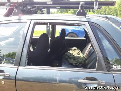

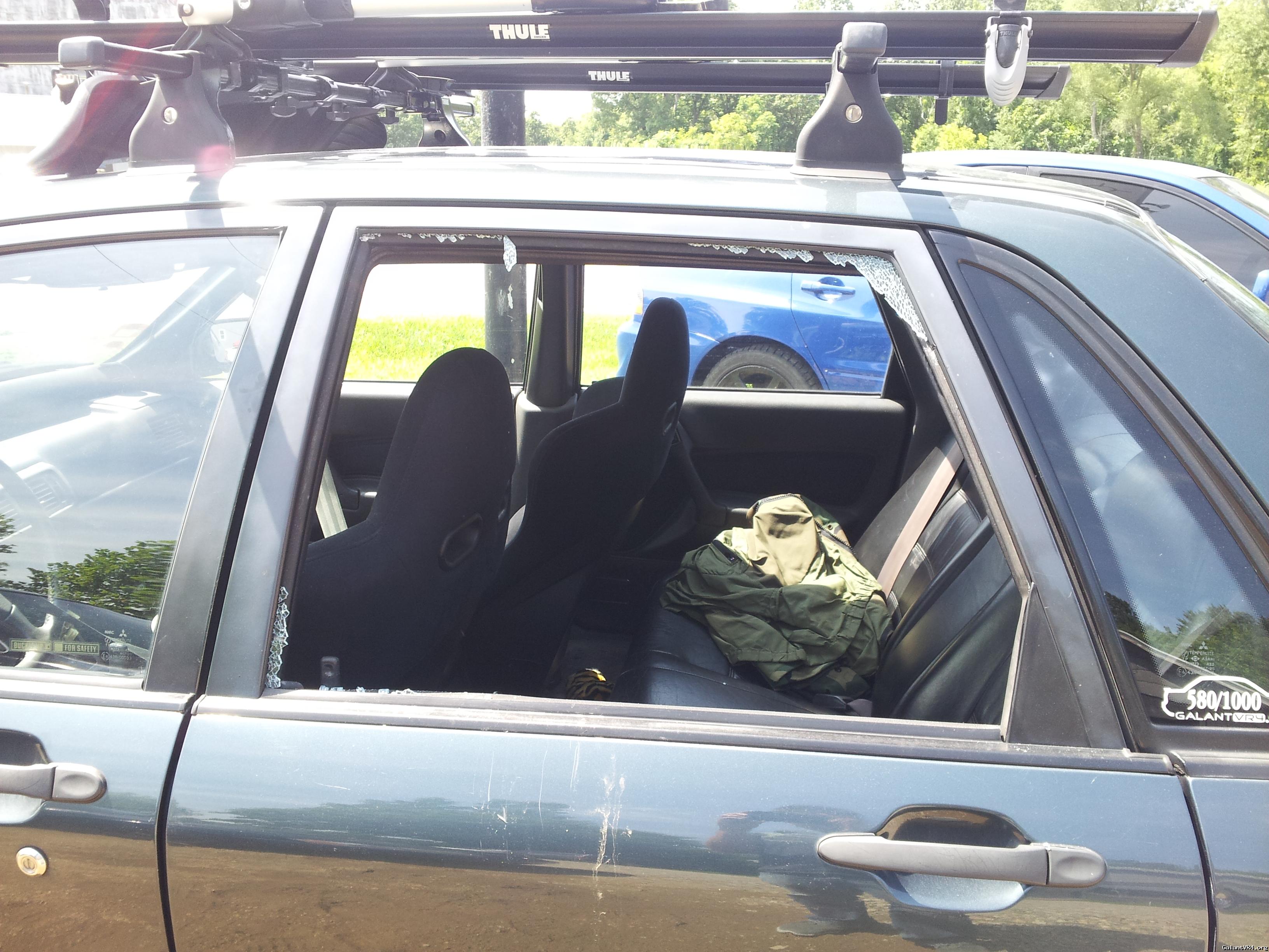

I really happy that 580 treated me well this weekend. The previous weekend someone busted into the Galant to steal my tuning laptop and radio.
Luckily I found a replacement window in a junkyard as well as a cheap radio to keep me entertained on the drive to shootout. I was going to spend some time last week dyno tuning the Galant, but between the car break in and helping my friend rebuild his engine a few days before shootout I just had to settle with my street/daily tune.
