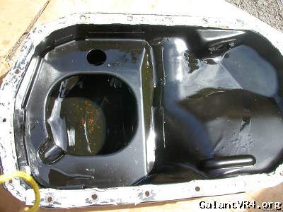

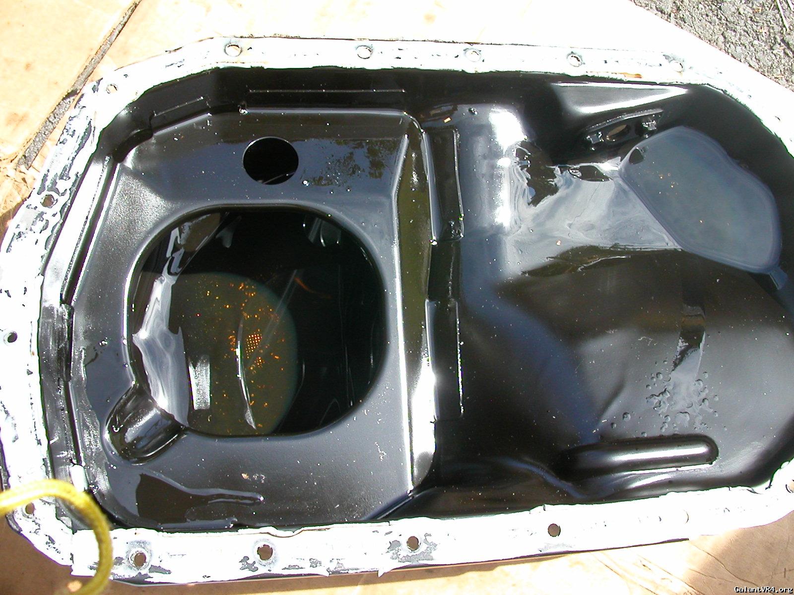

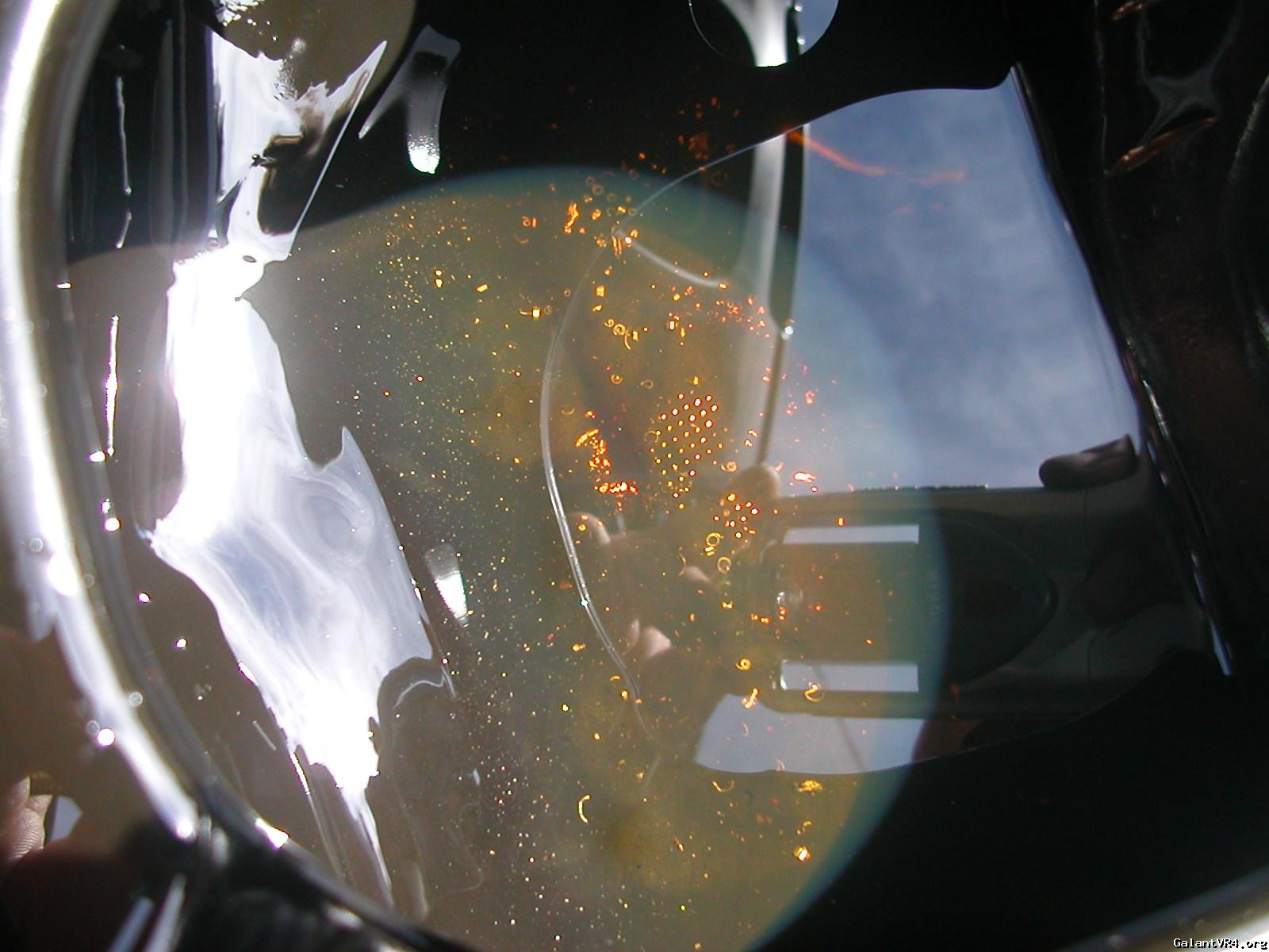

Oil will probably not be able to flush them out of the pan & yea, non ferrous so magnet no workie. You may want to bite the bullet & pull the pan to clean it all out otherwise what it may hurt will be the oil pump, doubt highly the bits can get past the filter. You could try something thinner to get them flushed out, like solvent. Dropping the pan is the only way to be sure, then shoot some brake clean down through with the pan off to get any more that may have stuck to the sides.

Quoting SouthCaliVR4:
But the RTV and the freshness of it being on there and the pain in the ass of taking it off and the scraping and the...!

Well, I spent the last three hours dropping the pan, cleaning and putting it back on. And its a good thing I did.

/ubbthreads/images/graemlins/rofl.gif SC. Aluminum isn't magenetic either....

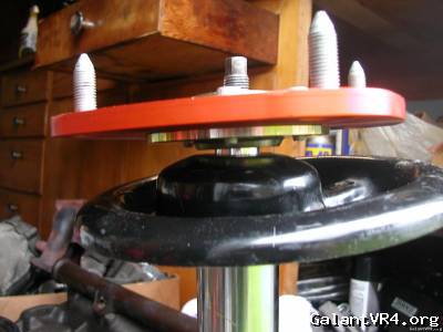

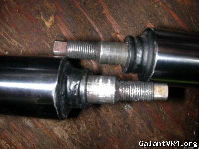

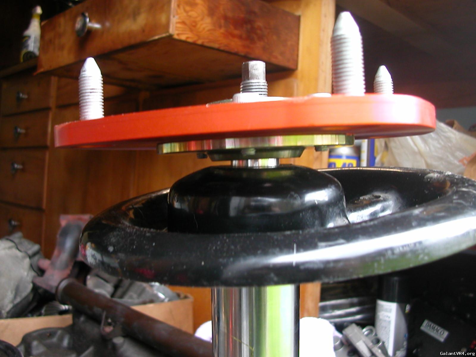

Lets hope the weather holds out for my tomorrow because I was able to get up to WWU and use their machines to get my Ksport camber plates working on the evo 8/9 front struts. The only difference between the evo X front and evo 8/9 is the shoulder right below the top threads. *Also, the evo X strut is about an inch taller than the 8/9.
evo X:
evo8/9:

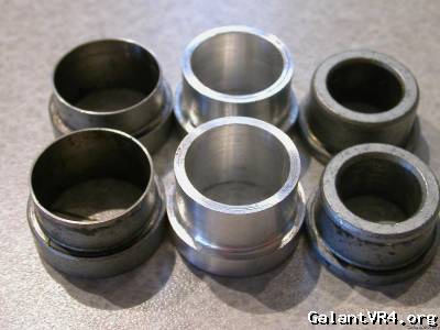

So, in order to get enough threads for the top nut to grab, I had to make new lower bushings with a smaller ID to fit over the lower shoulder and take off some steel from the spring perch. If its not raining, there should be evo suspension all round by days end tomorrow.

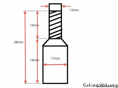

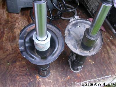

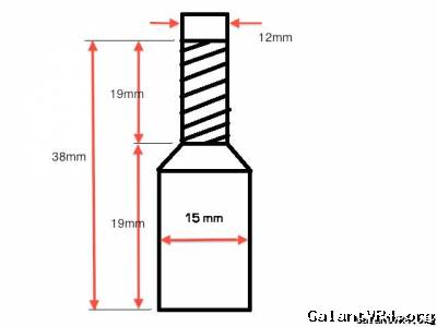

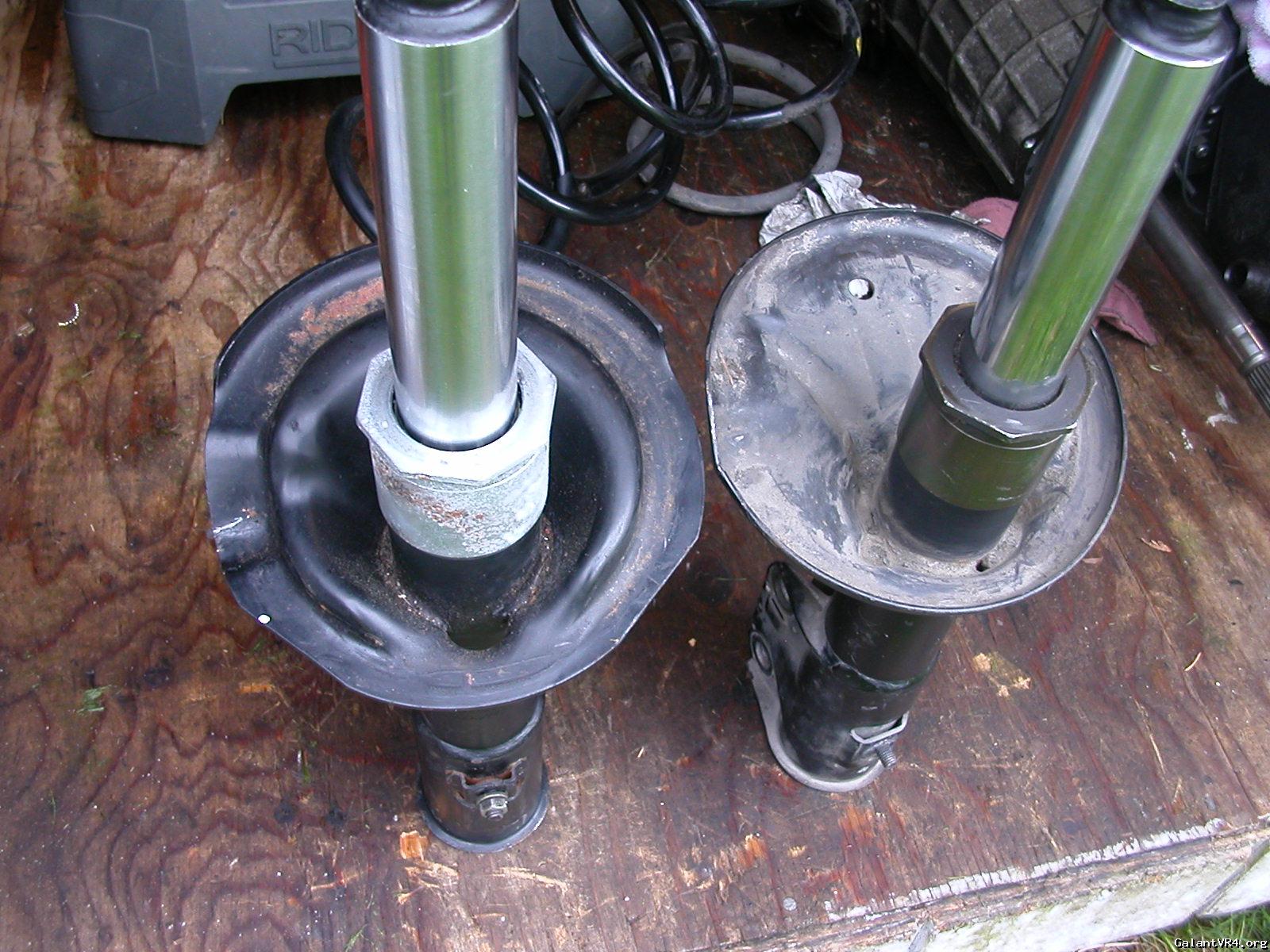

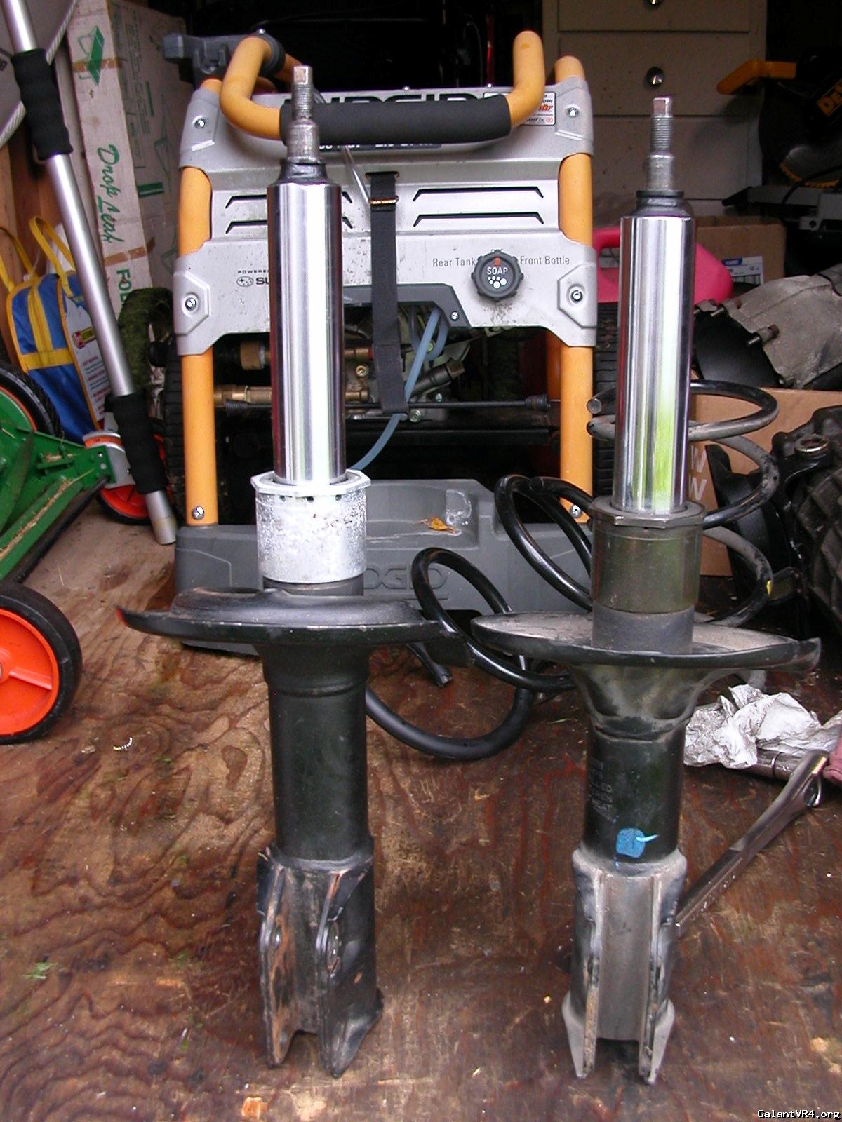

As for some pictures of what I am working with, here's why I don't just use the evo 8/9 springs and top perch with the evo X struts I have...
As you can see, they are nearly identical (X on the left 8/9 on the right), except for the X strut being an inch or so taller.
As for other differences, the lower perches are pretty much the same. The X has a hump on the inside to locate the spring and the 8/9 has a lip on the outside.

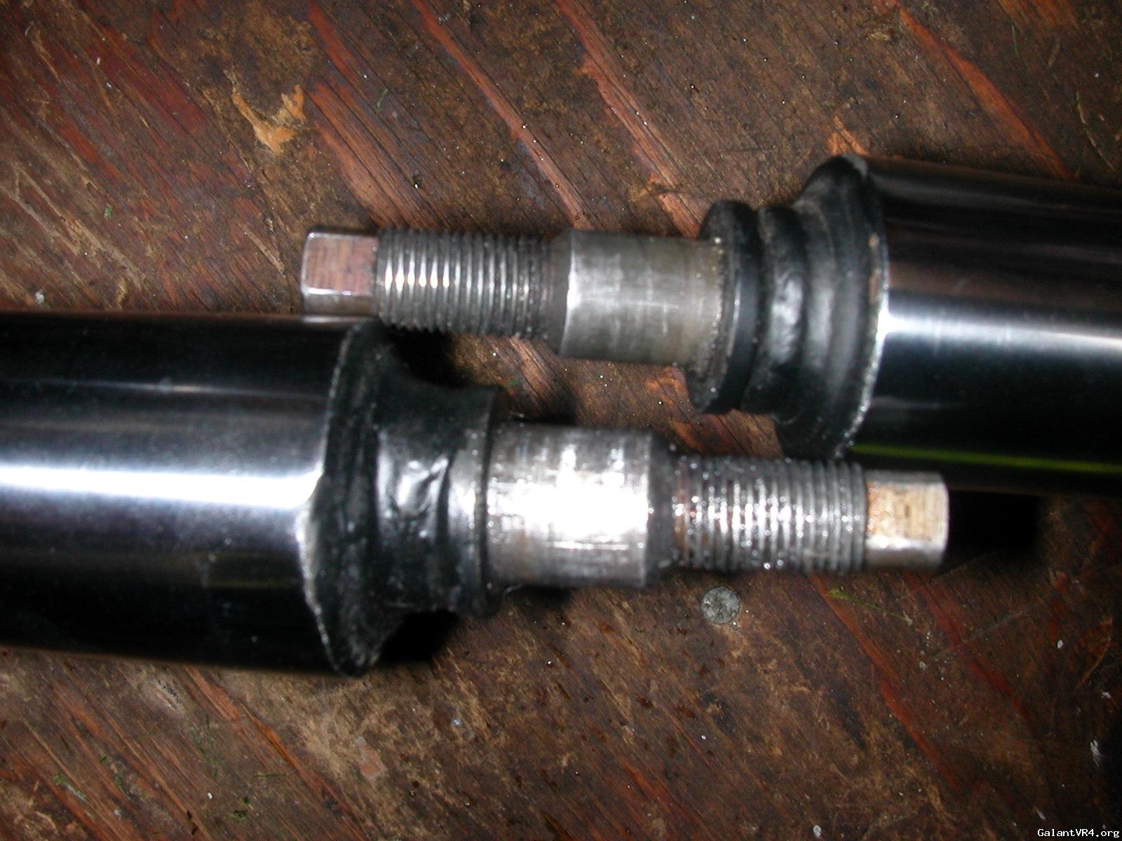

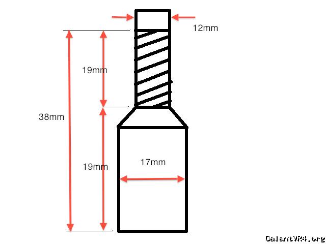

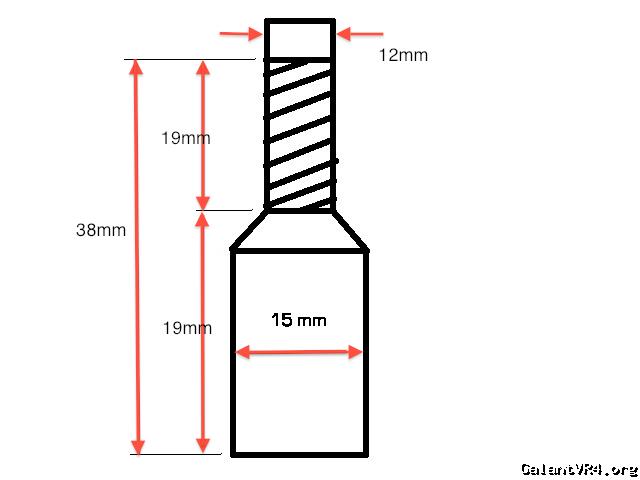

As I had mentioned above, the shoulder just below the top threads is 2mm bigger on the X than the 8/9. (X is below 8/9: 17mm and 15mm respectively)

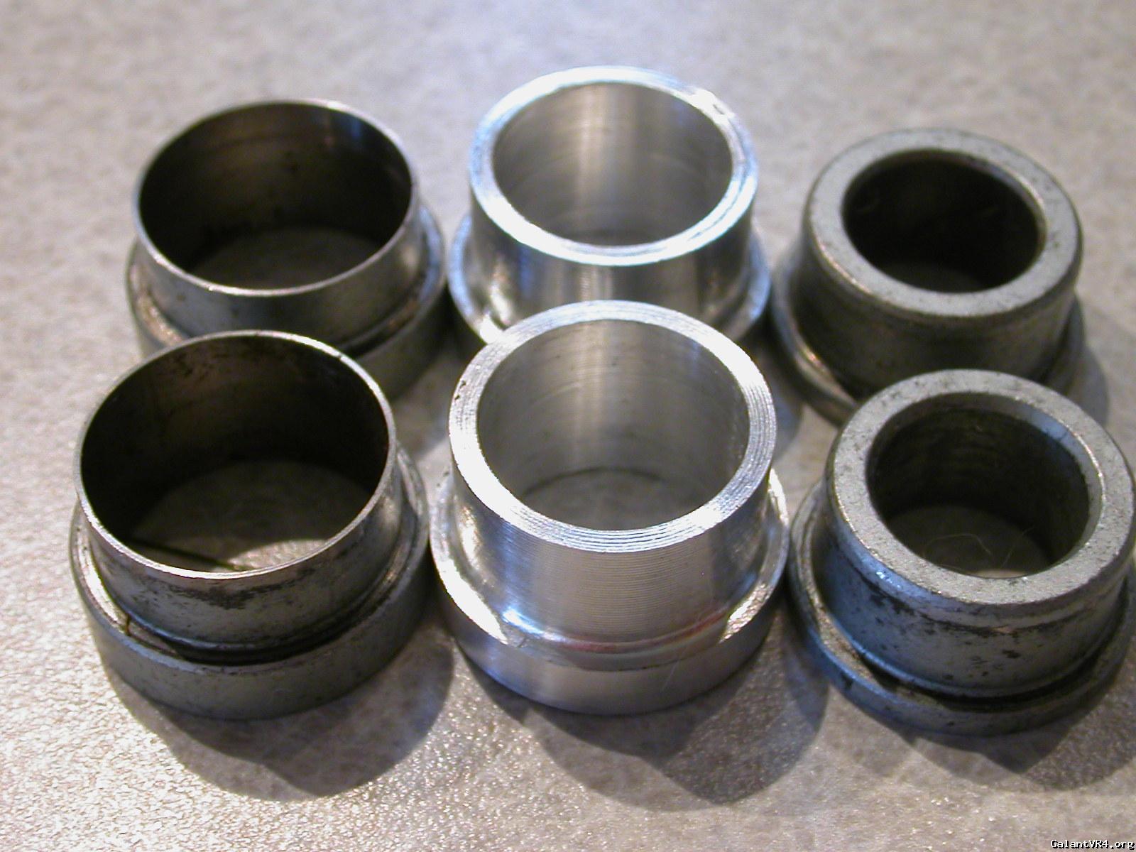

So, I made some new bushings for the bottom with a smaller ID. I could reuse the top ones because its the same 12mmx1.25 thread.

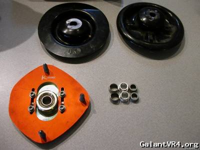

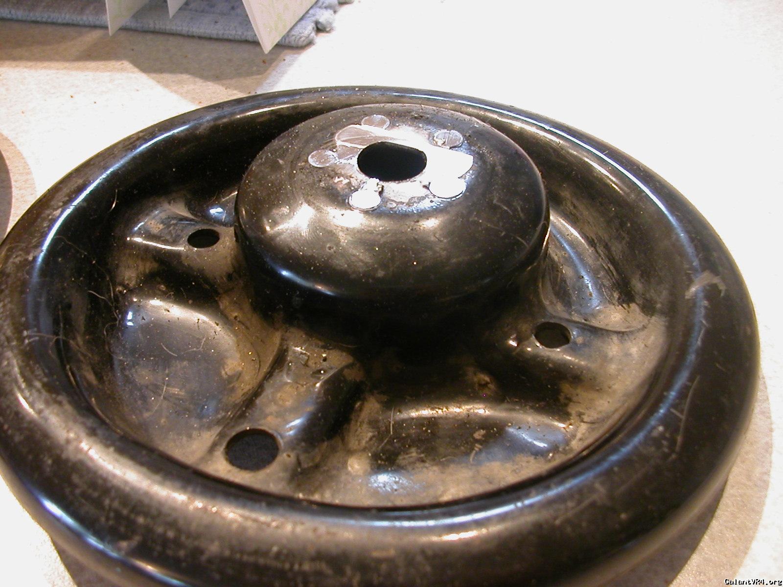

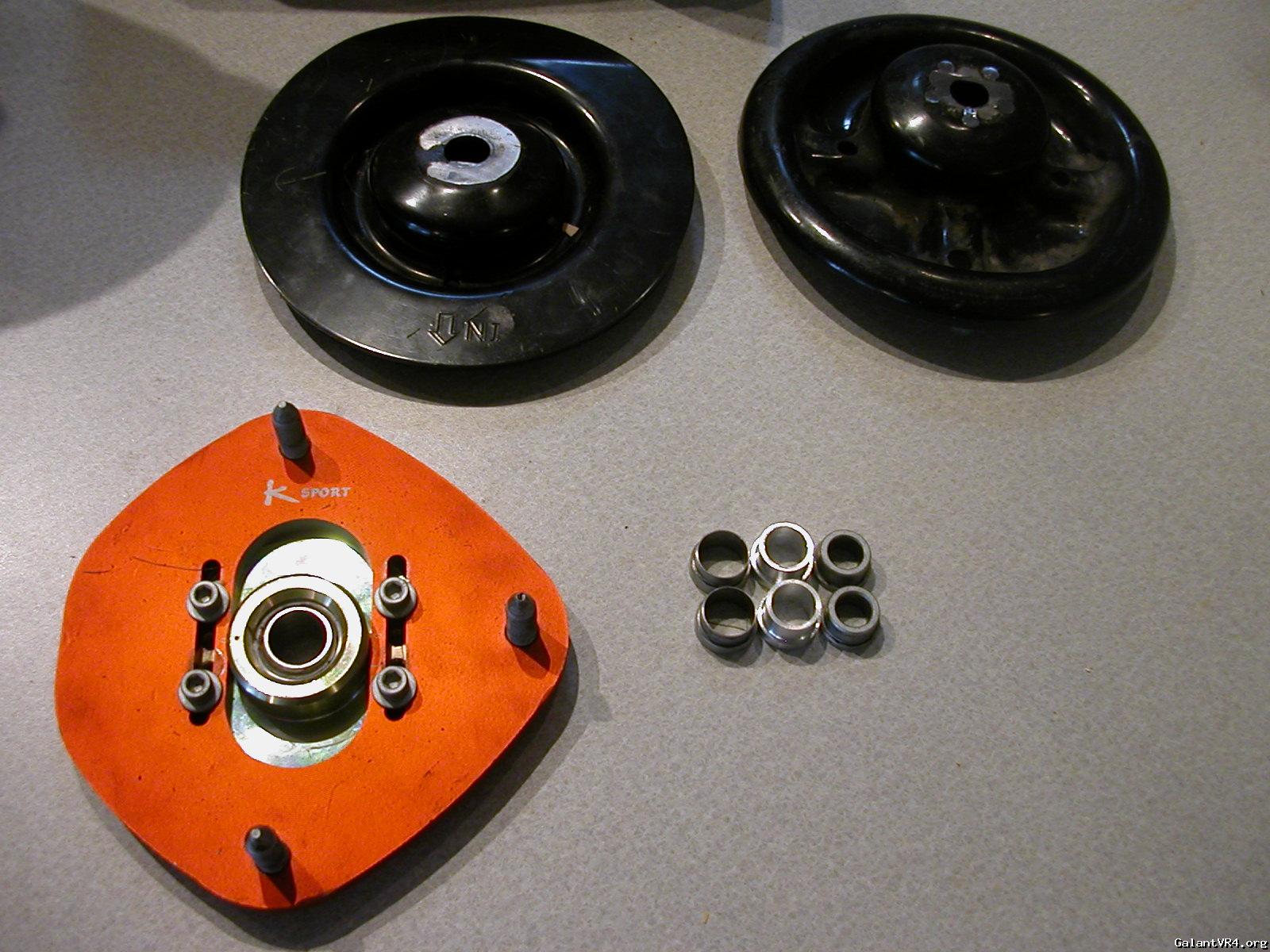

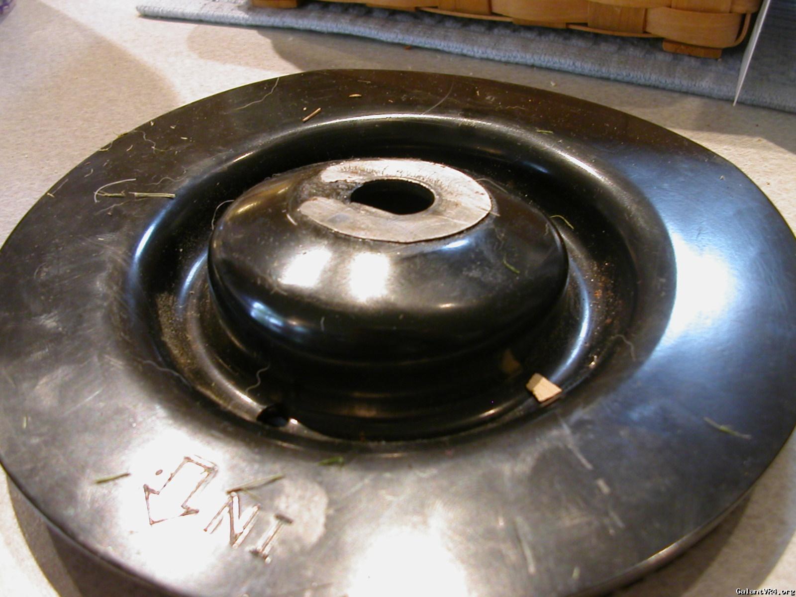

This isn't the best shot, but here's all the different pieces that go on top. Once again the X spring perch is on the left.

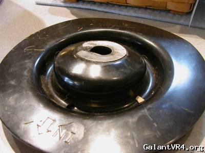

Here's some better pics of the spring perches. X first
And 8/9
And finally, the reason why the lower bushing needs a shoulder on it is so the spherical bearing has room to pivot for camber changes.

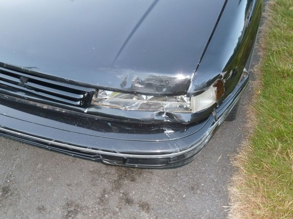

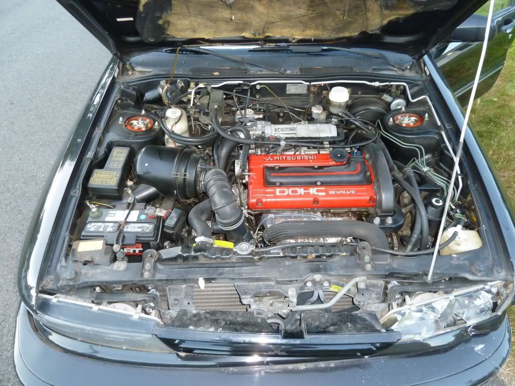

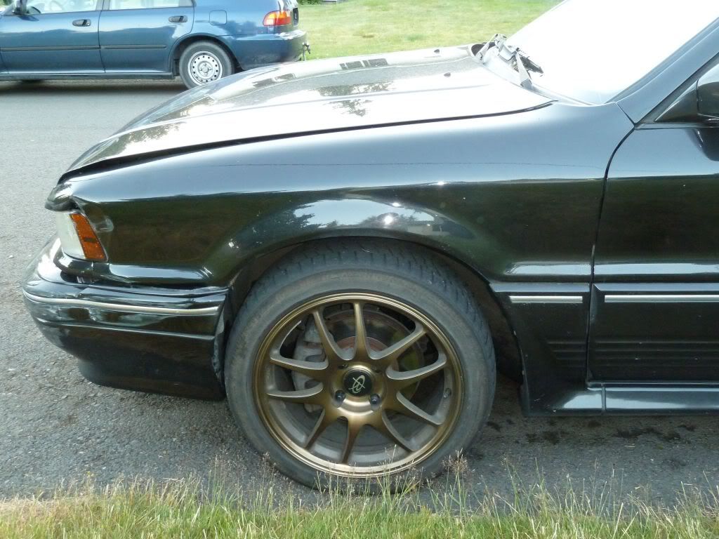

Well, a couple days ago the galant saw the broad side of another vehicle. Damage doesn't look too bad, there are no leaks, and it still drives ok. I'll probably be looking around for all the parts needing replacement and from what I can see I'll be needing to get the following bits and pieces:
Hood
Fender
Headlight
Bumper
Bumper support
Foglight
Pics:
Bummer, but everyone was ok and I think its all body damage, nothing that can't be fixed.
