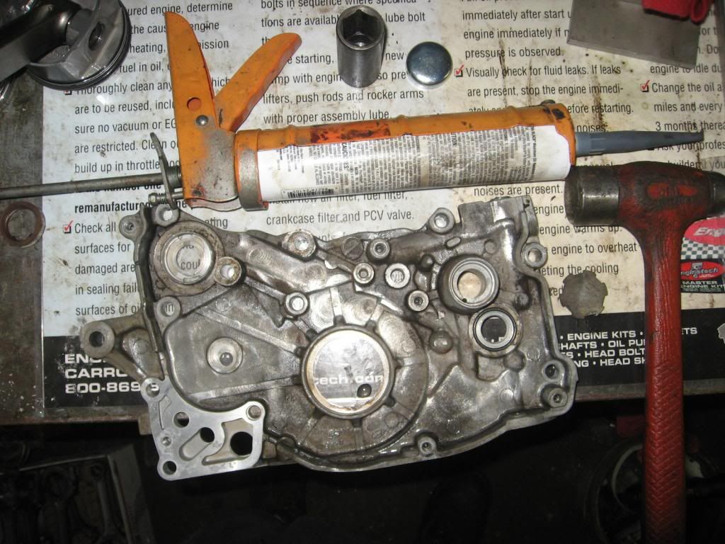

The basics needed
*Front case, cleaned
*Hammer
*Socket
*35mm cup style freeze plug
*RTV

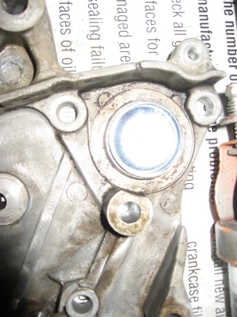

To start, remove the seals from the front case.

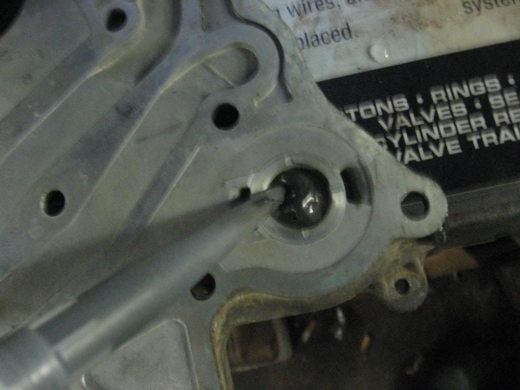

Next will be to plug the front BS hole in the front case.

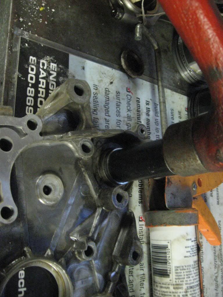

Tap the freeze plug in with the socket and hammer.
Caution needs to be used not to crack the housing bore of the front case.

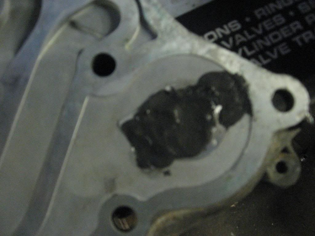

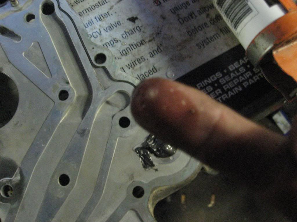

Next take the front case and flip it over, and pack the backside of the front case where the freeze plug was installed with RTV.
A bit of oil or spit will allow you to smooth the RTV with out it sticking to your finger.
Use a bit of care to keep the RTV of the gasket surface.
