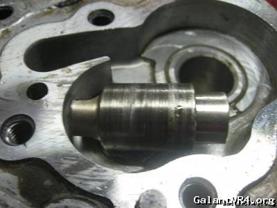

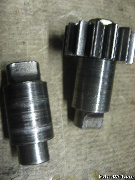

STAY AWAY from the ungrooved stubby shaft!!!!

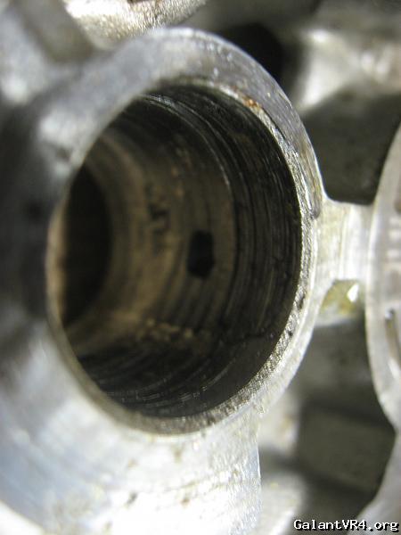

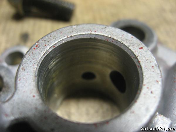

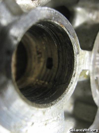

This one had to be beat out with a hammer.OMG
The damage caused to the oil pump housing. :sosad:

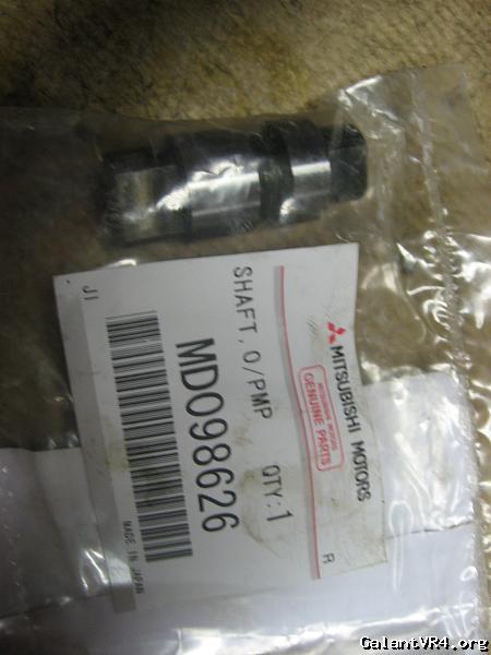

So make sure the BSE Kit you buy has the OE Mitsubishi stubby shaft. Unless you just want to spend the cash on a new front case/oil pump.
