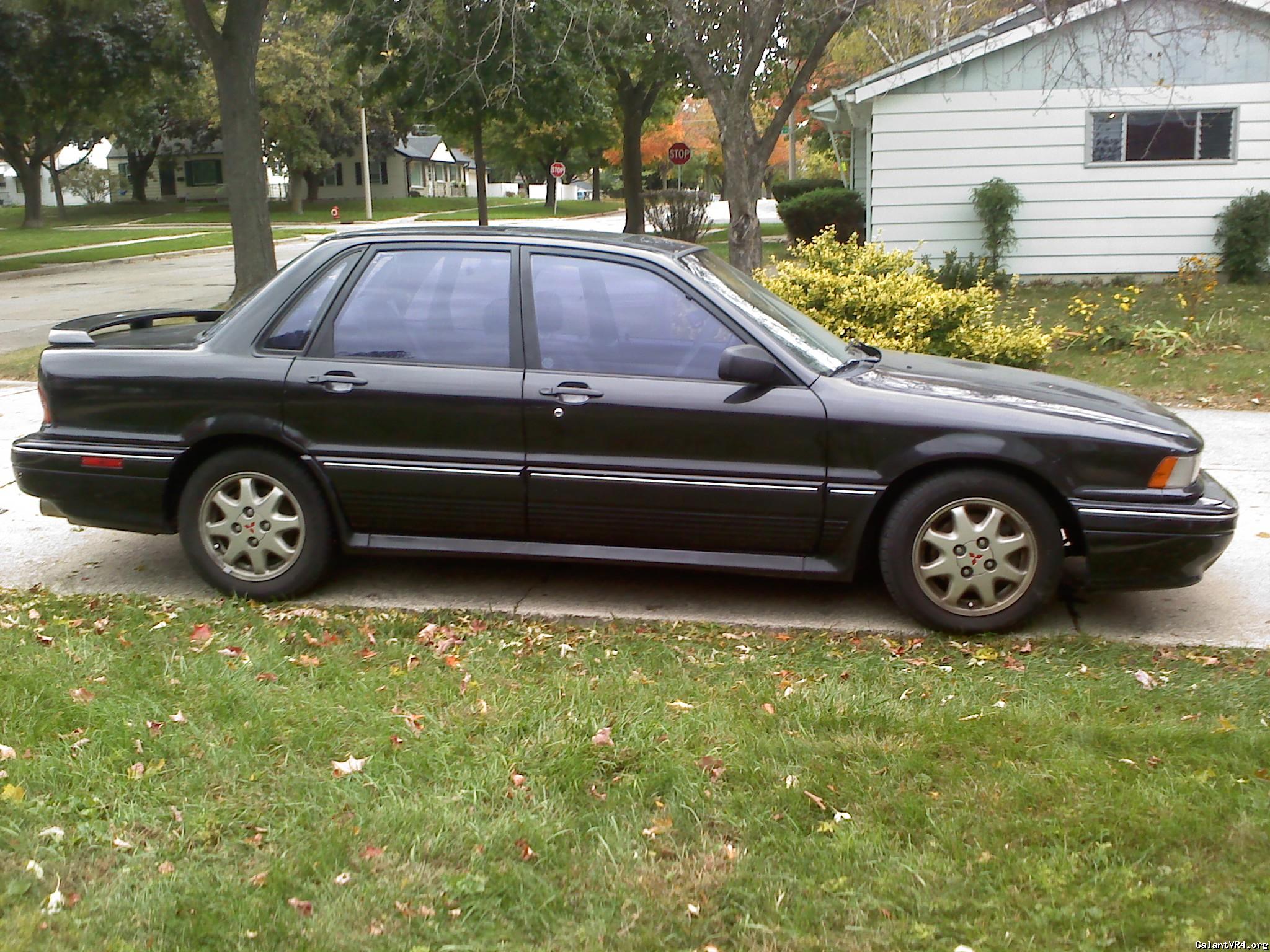

I start this project in Oct of 2010 when I found this car on a local forum. I left work the minute I saw it and bought it for $700. I have been in the DSM game for around 5 years now so I knew it was a once in a life time find. I pick it up a hour after it was posted. Sadly it was sitting for some time and it would not start, the battery was on life support. I had it towed back and that's where the fun started. I had two options, keep the car and add another project to my list or part out the car and double or even triple my money. I have always loved vr4's so this is where the journey begins.

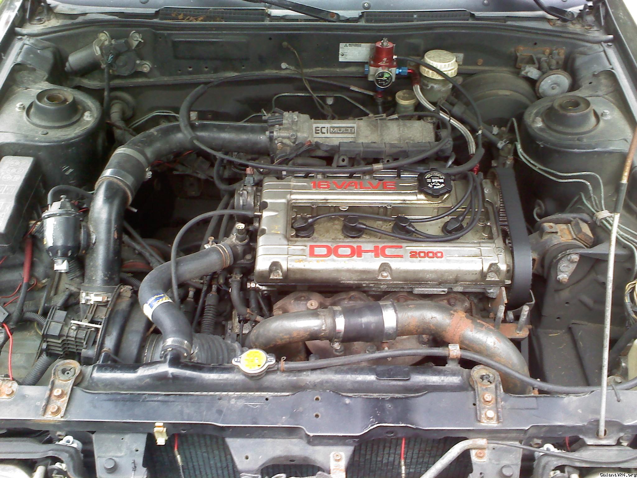

Performance Mod that the car came with .
3" turbo back exhaust
Aeromotive FPR
XTD stage 2 clutch
Auto meter boost and volt gauges
HKS turbo timer
SAFC-2
rewired 255 fuel pump
Battery relocated to truck
550cc injectors
Socketed and chipped ecu
SS brake lines with new pads and rotors
AGX KYB adjustable shocks front and back
FMIC with HKS bov

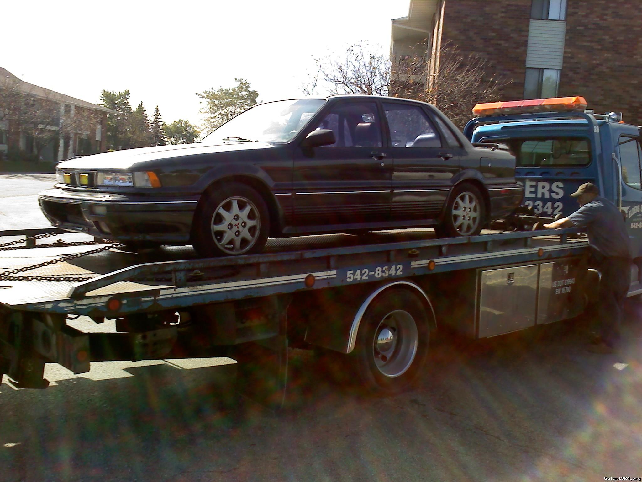

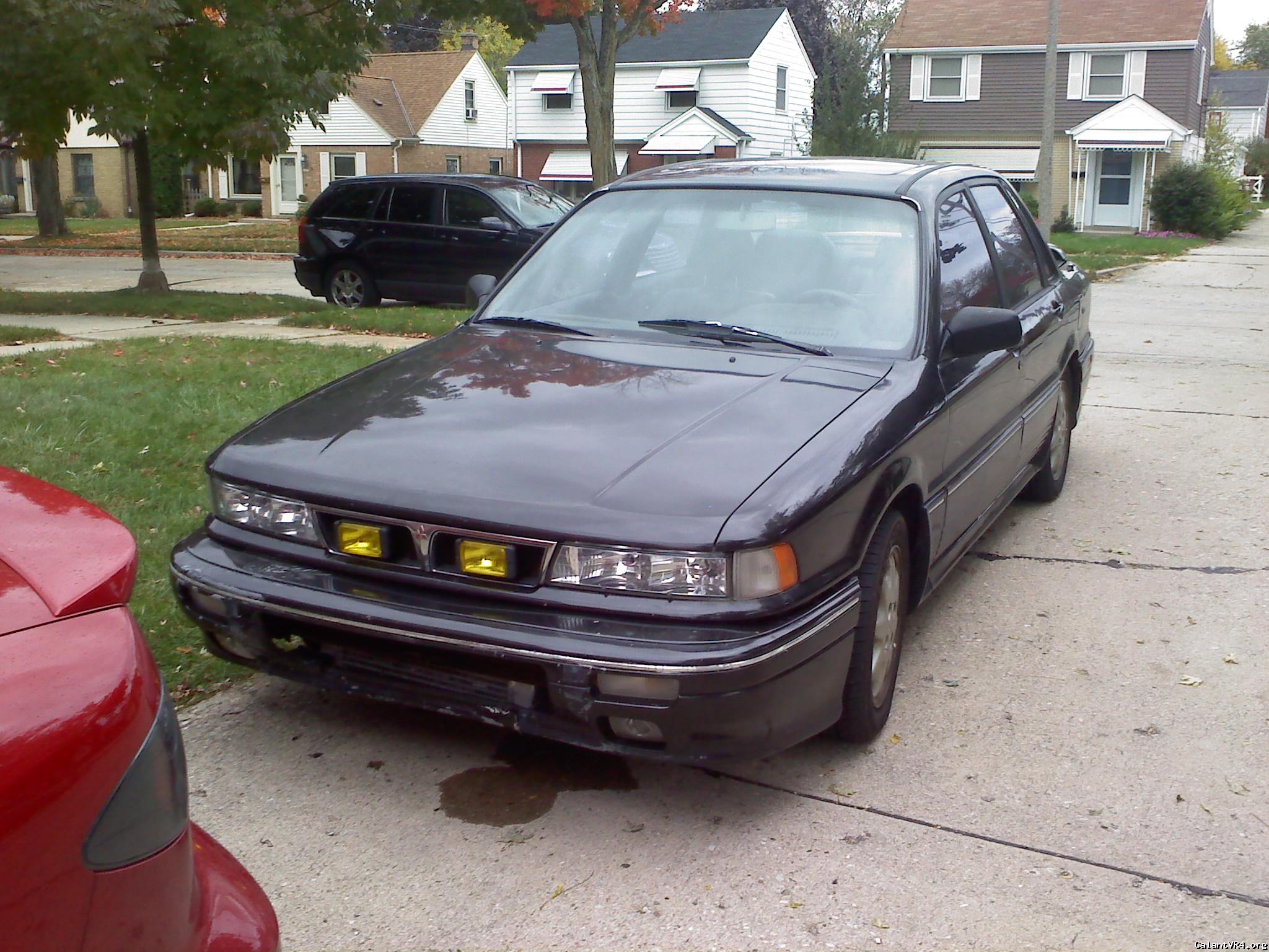

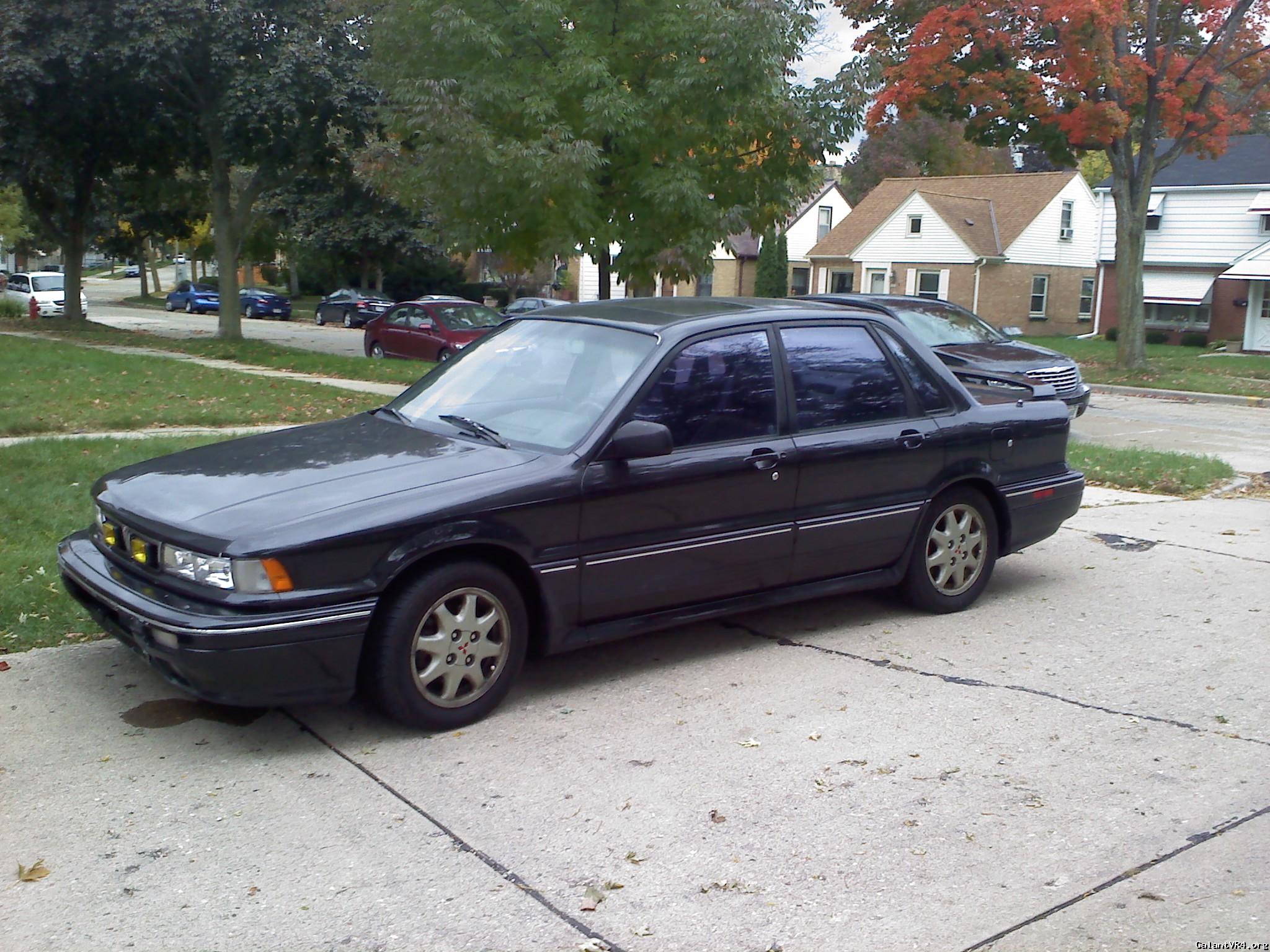

The Day I picked it up

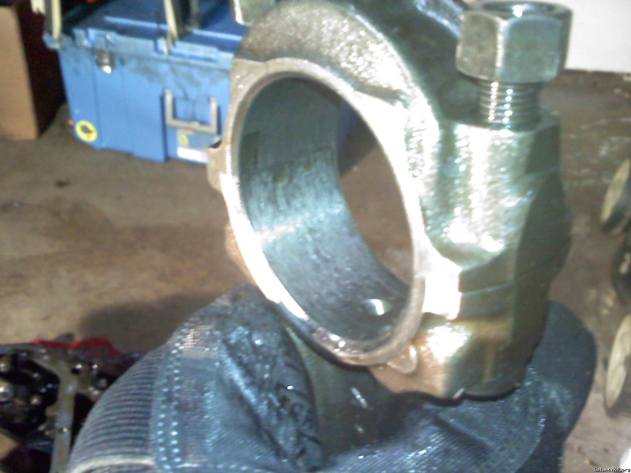

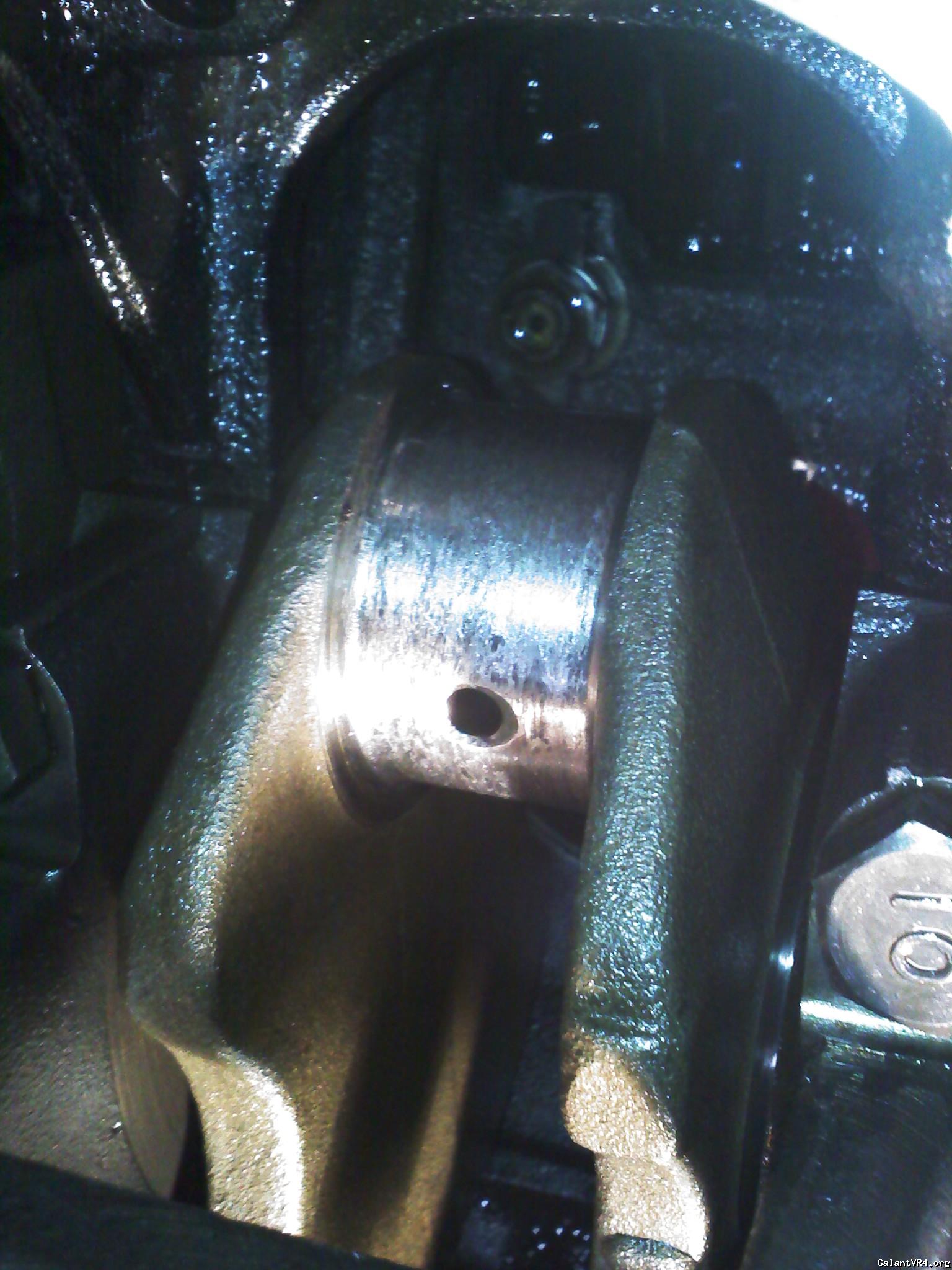

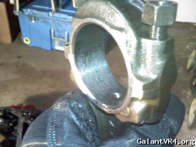

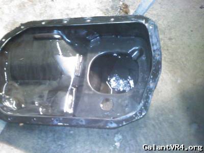

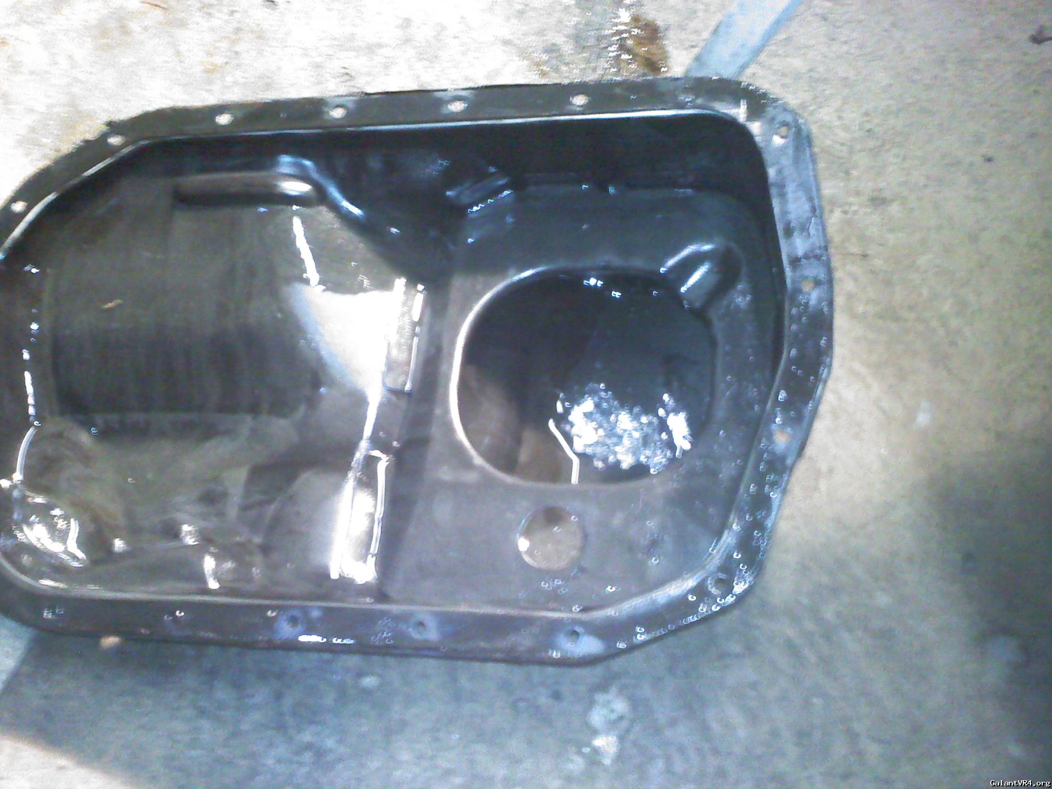

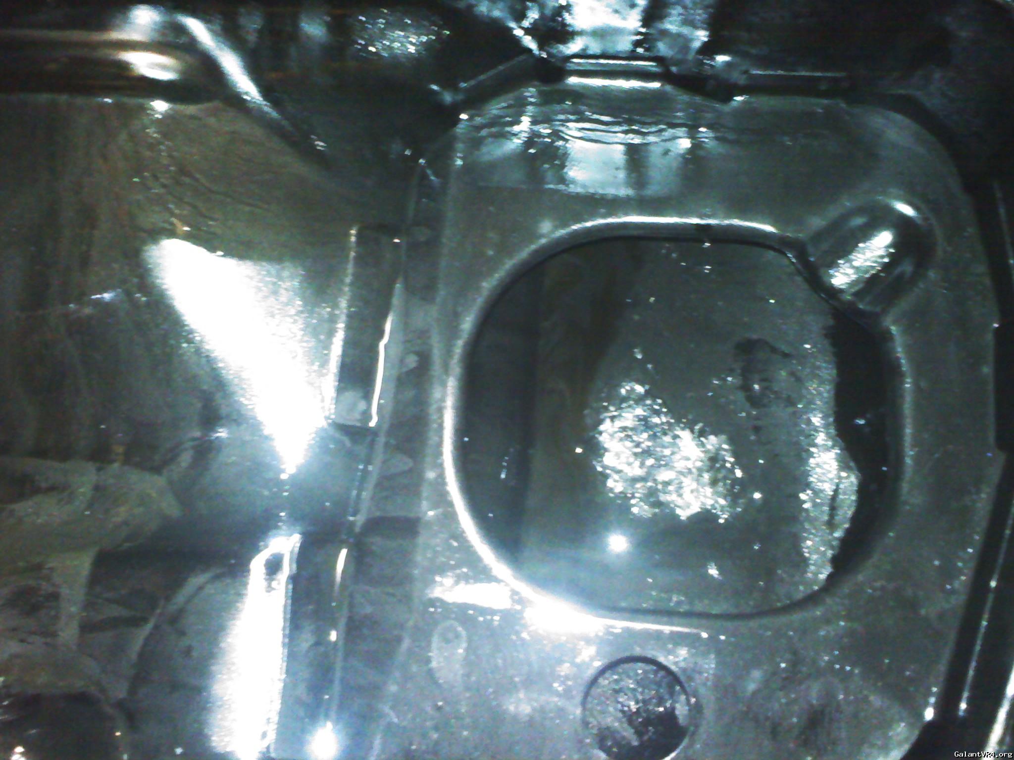

Got the car started, it was a combo of dead battery and failing head gasket. After starting there was some loud knocking, so ripped the engine apart to find this.
The remains of the bearing for cylinder one
Some nice scoring on the rod and crank.

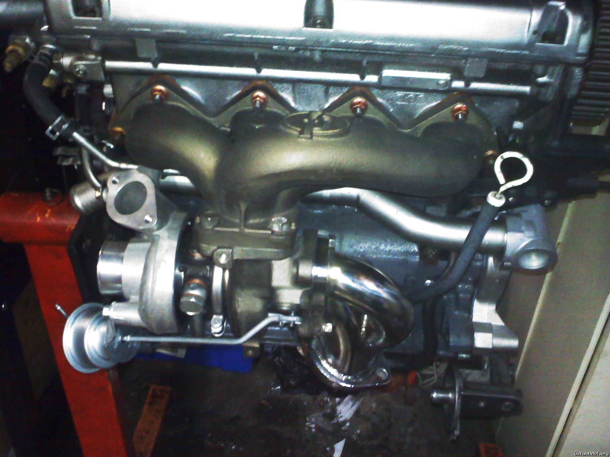

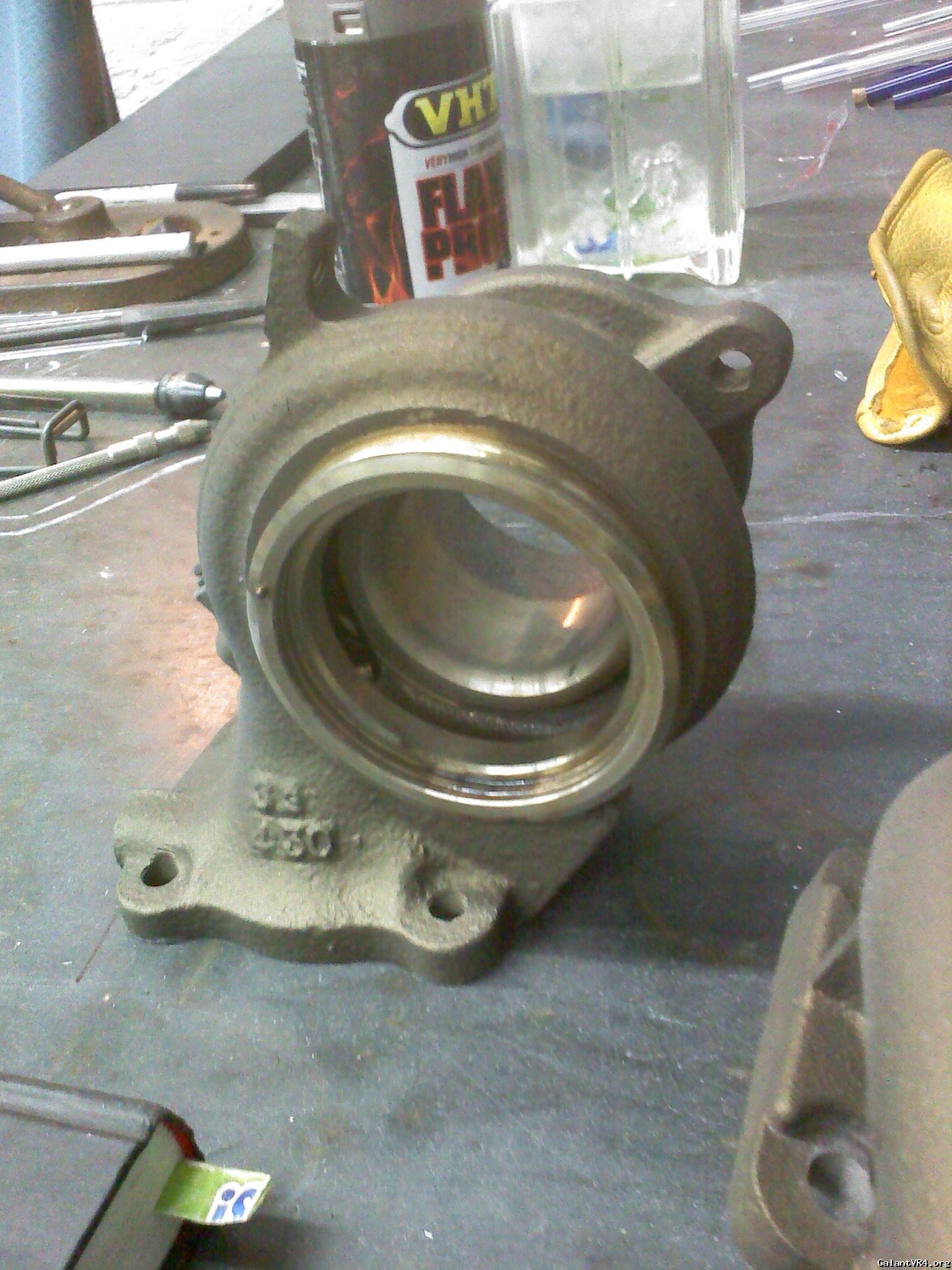

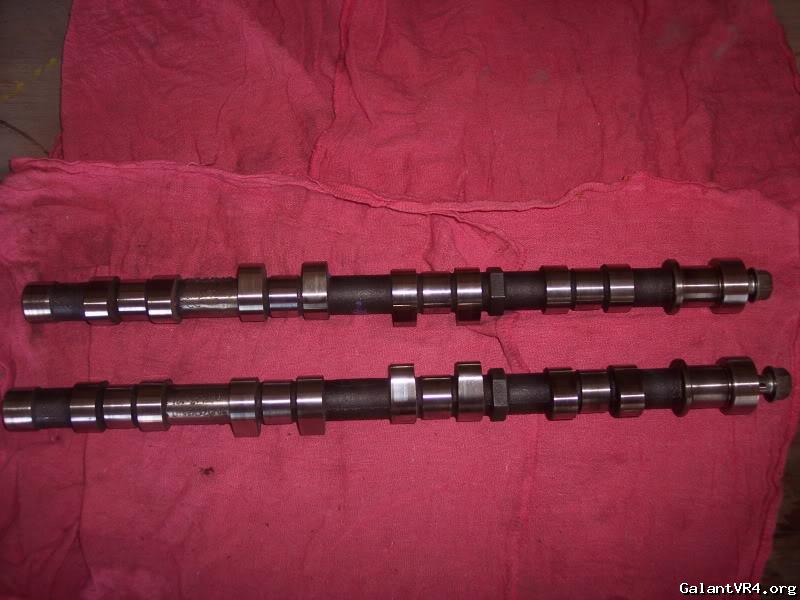

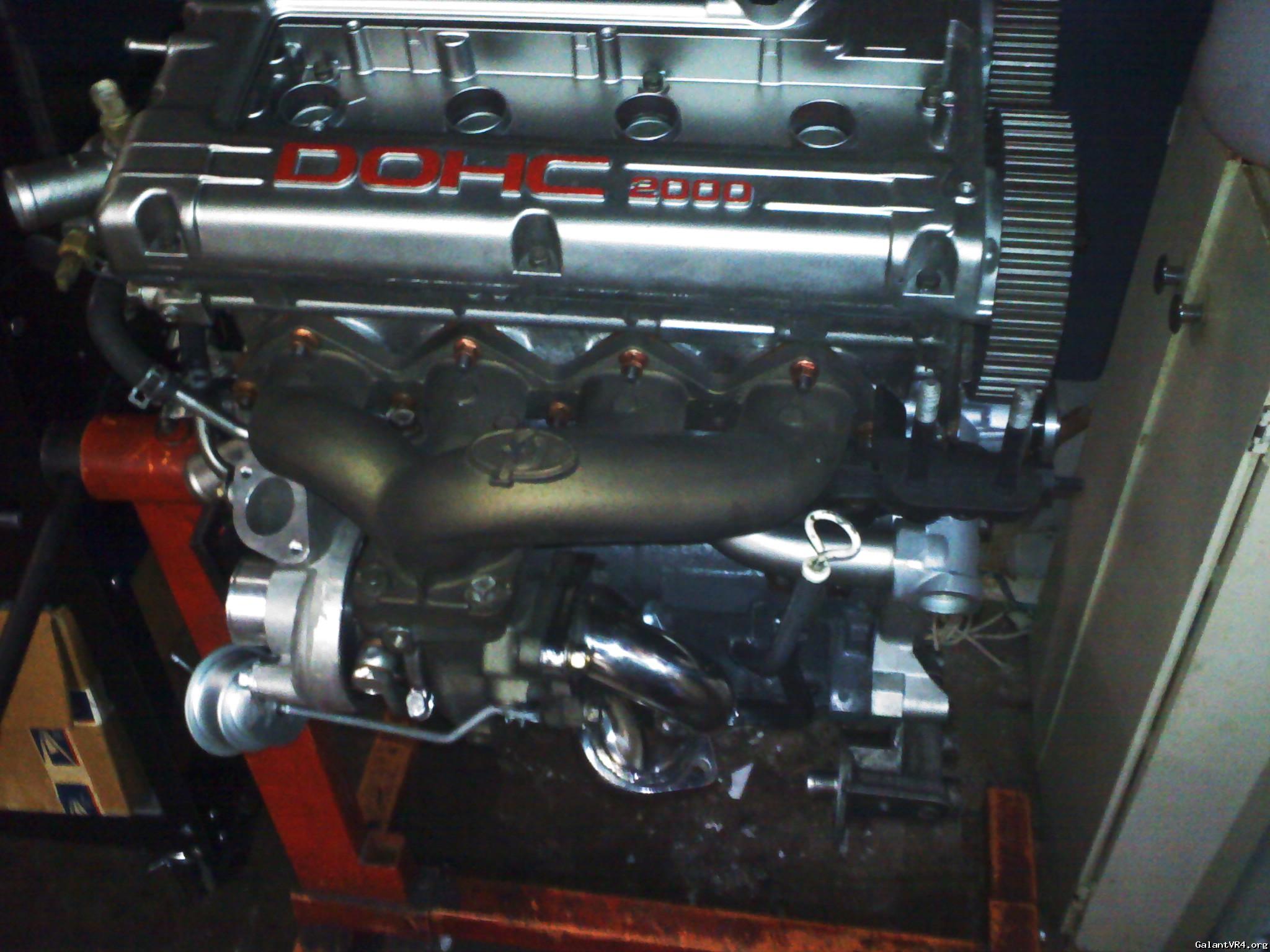

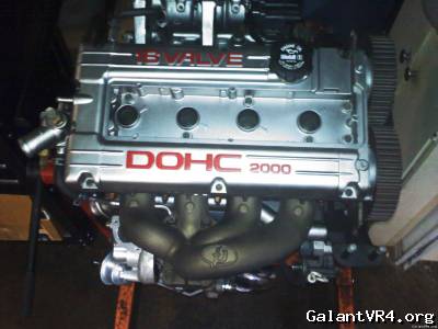

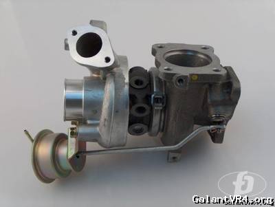

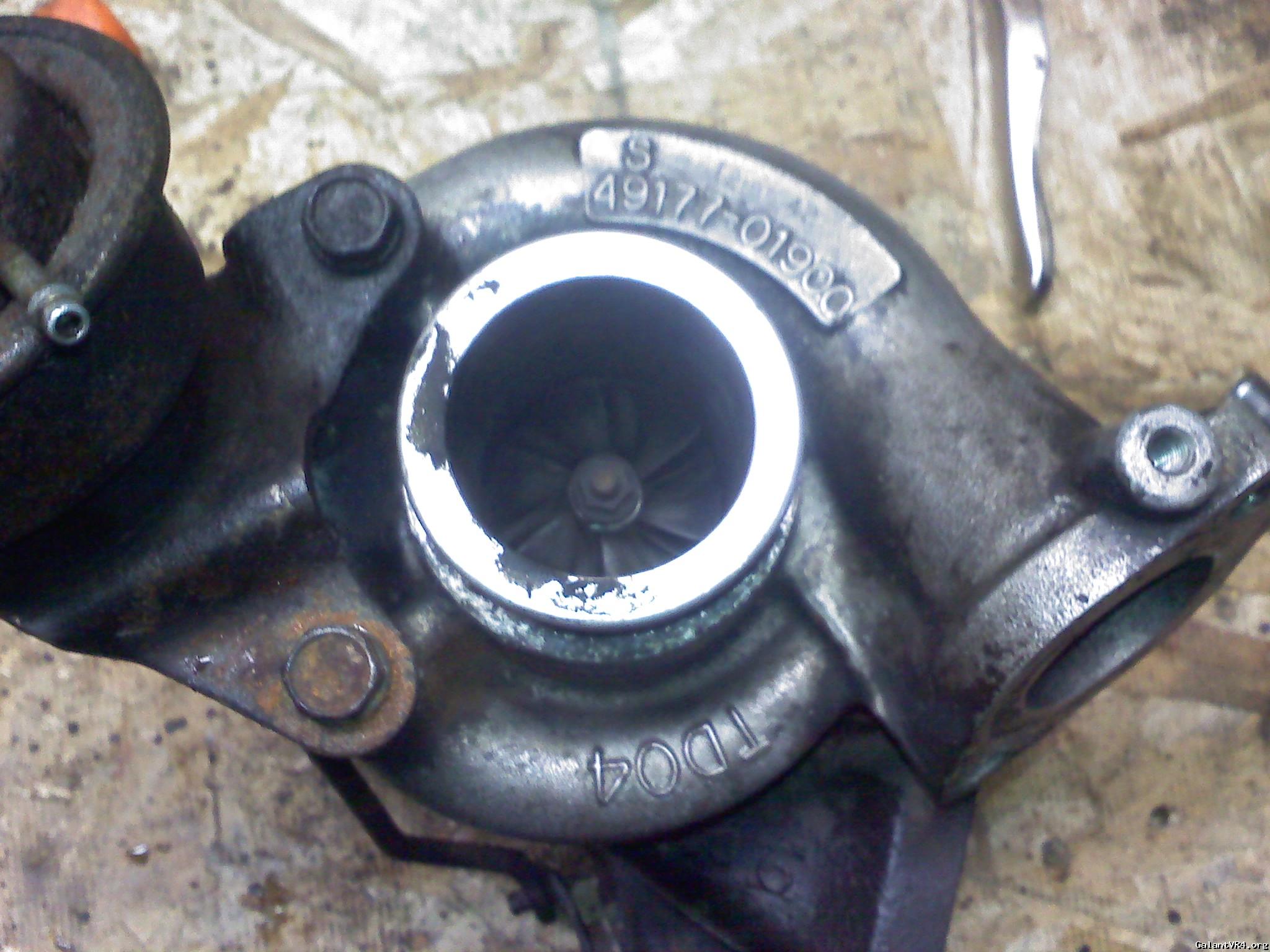

out with the old and in with the new

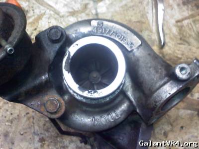

For some reason there was a 13g on the car, a bit small so it needed to go

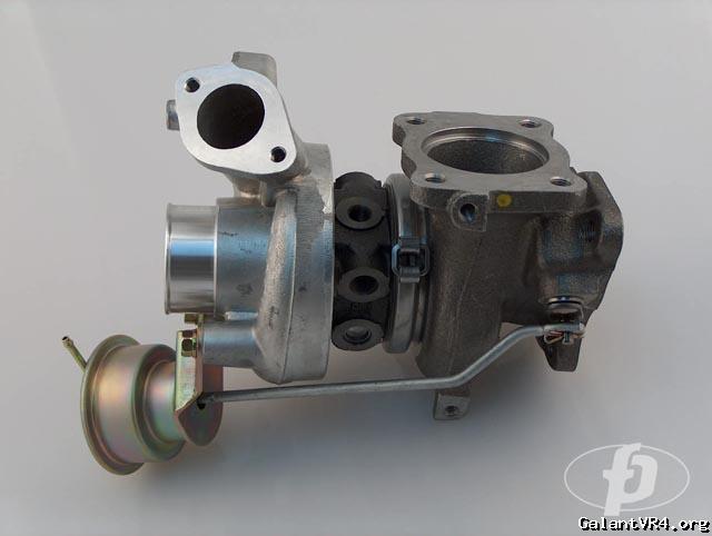

New evo3 16g ported and polished

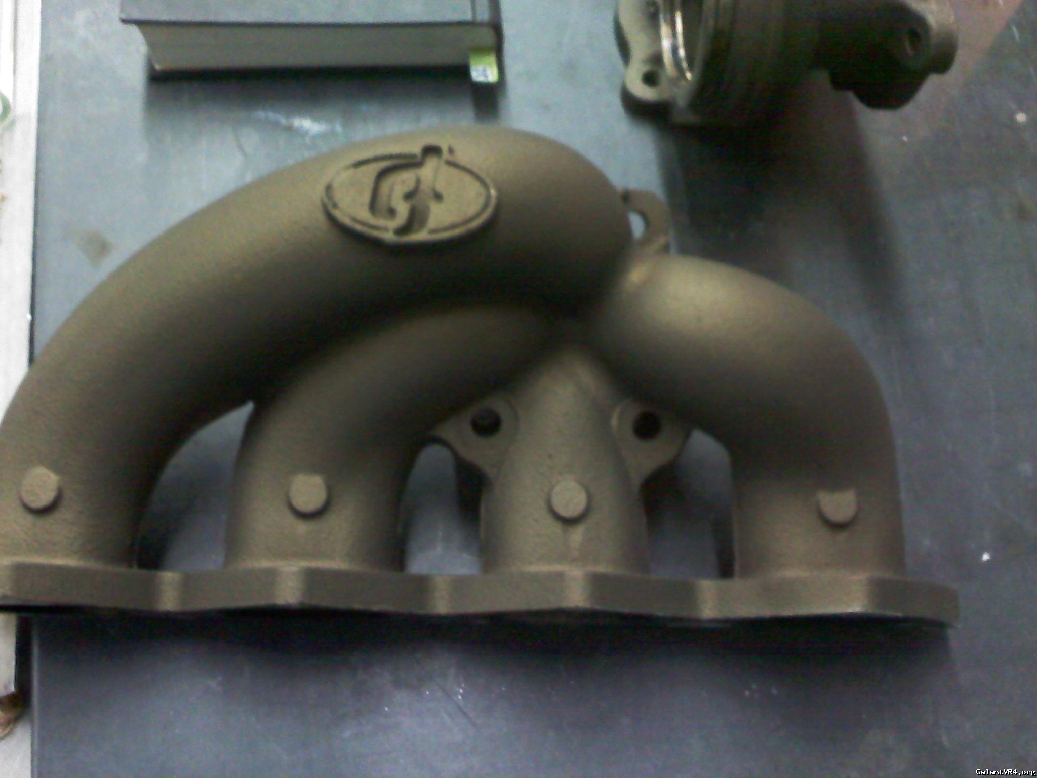

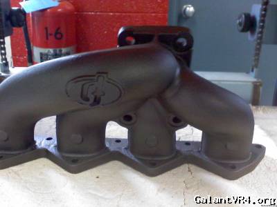

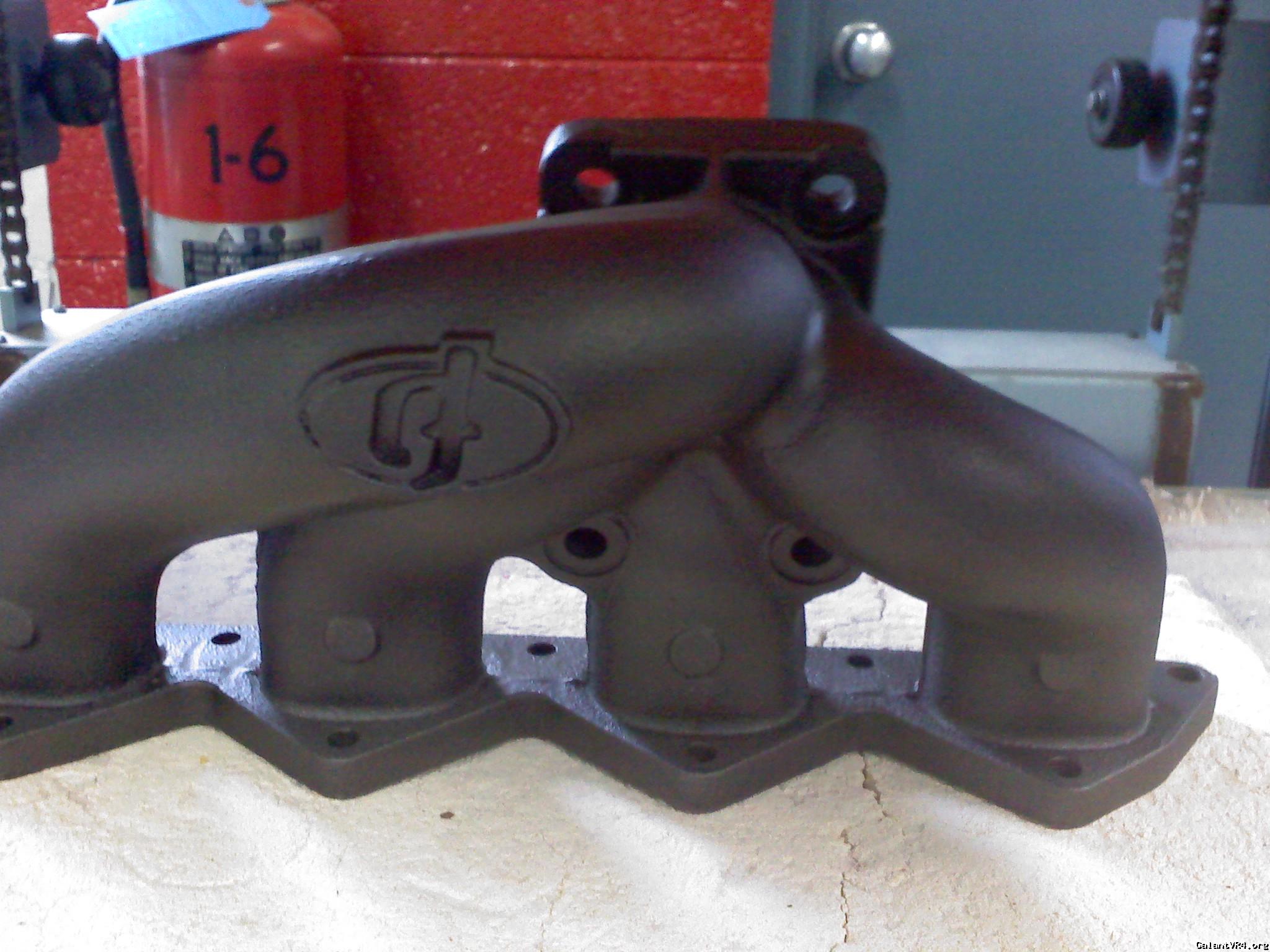

VHT coated hot side

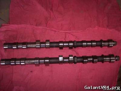

FP2 cams
FP race manifold before baking the VHT coating
After

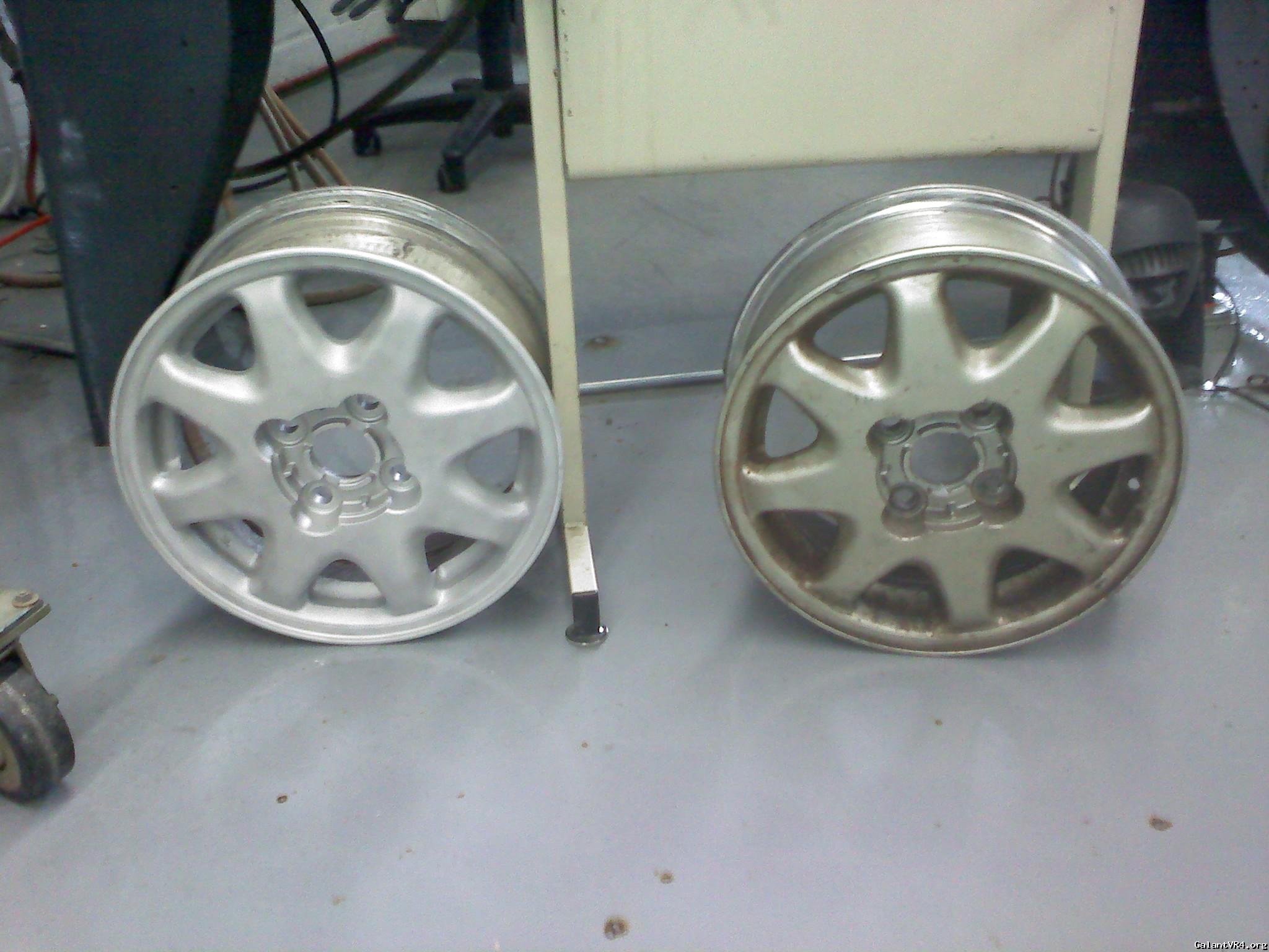

Bead blasting the stock rims

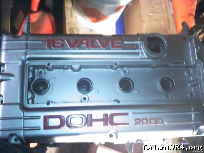

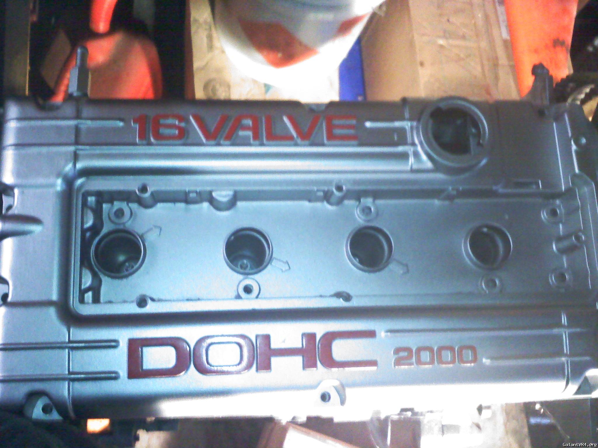

Cleaned up the valve cover and laid down some new paint. I'm a fan of the stock look.

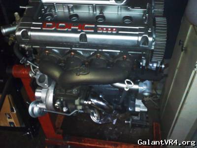

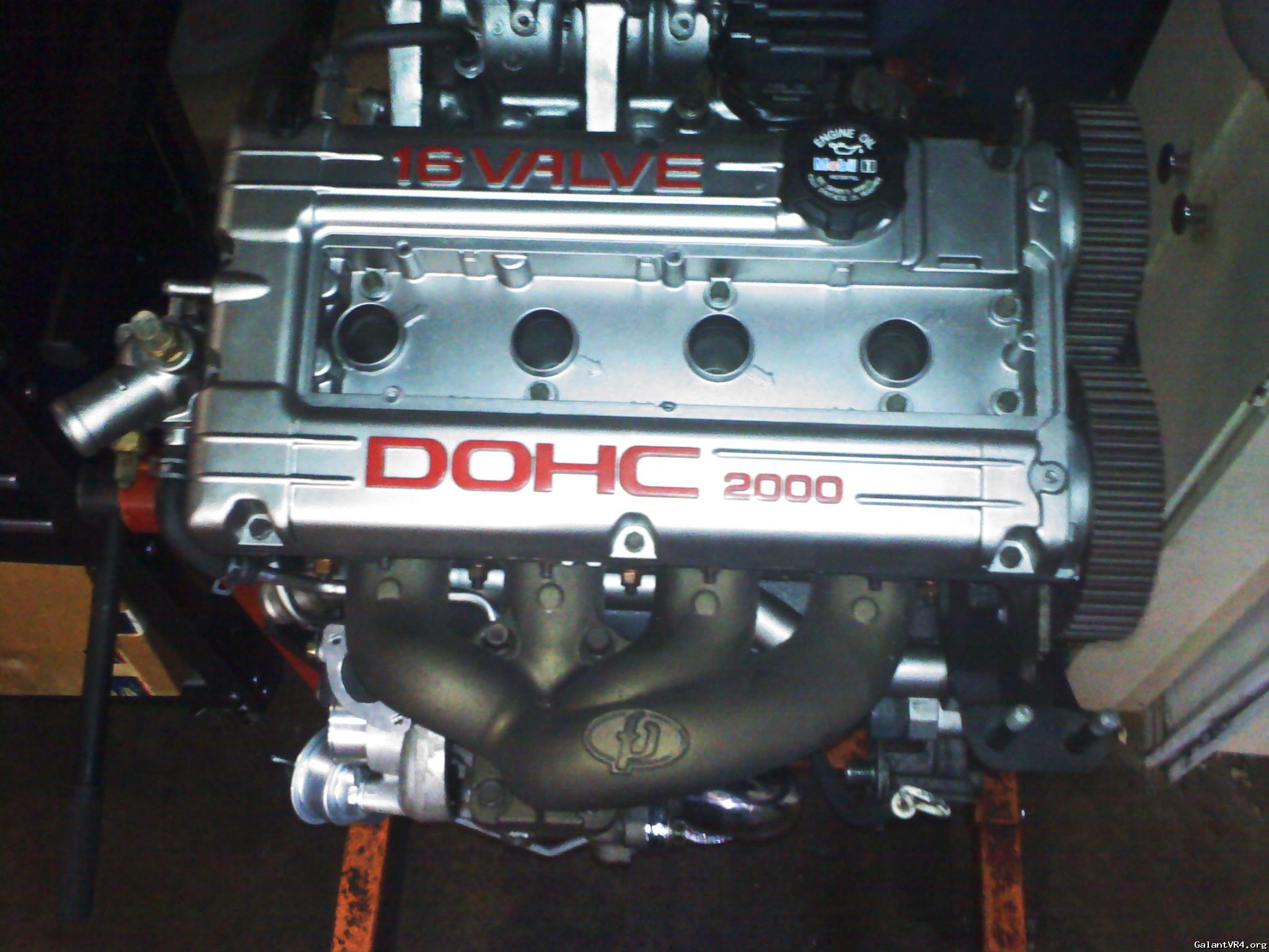

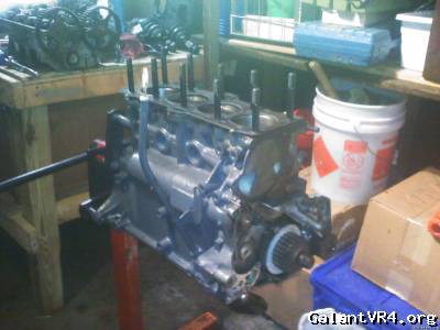

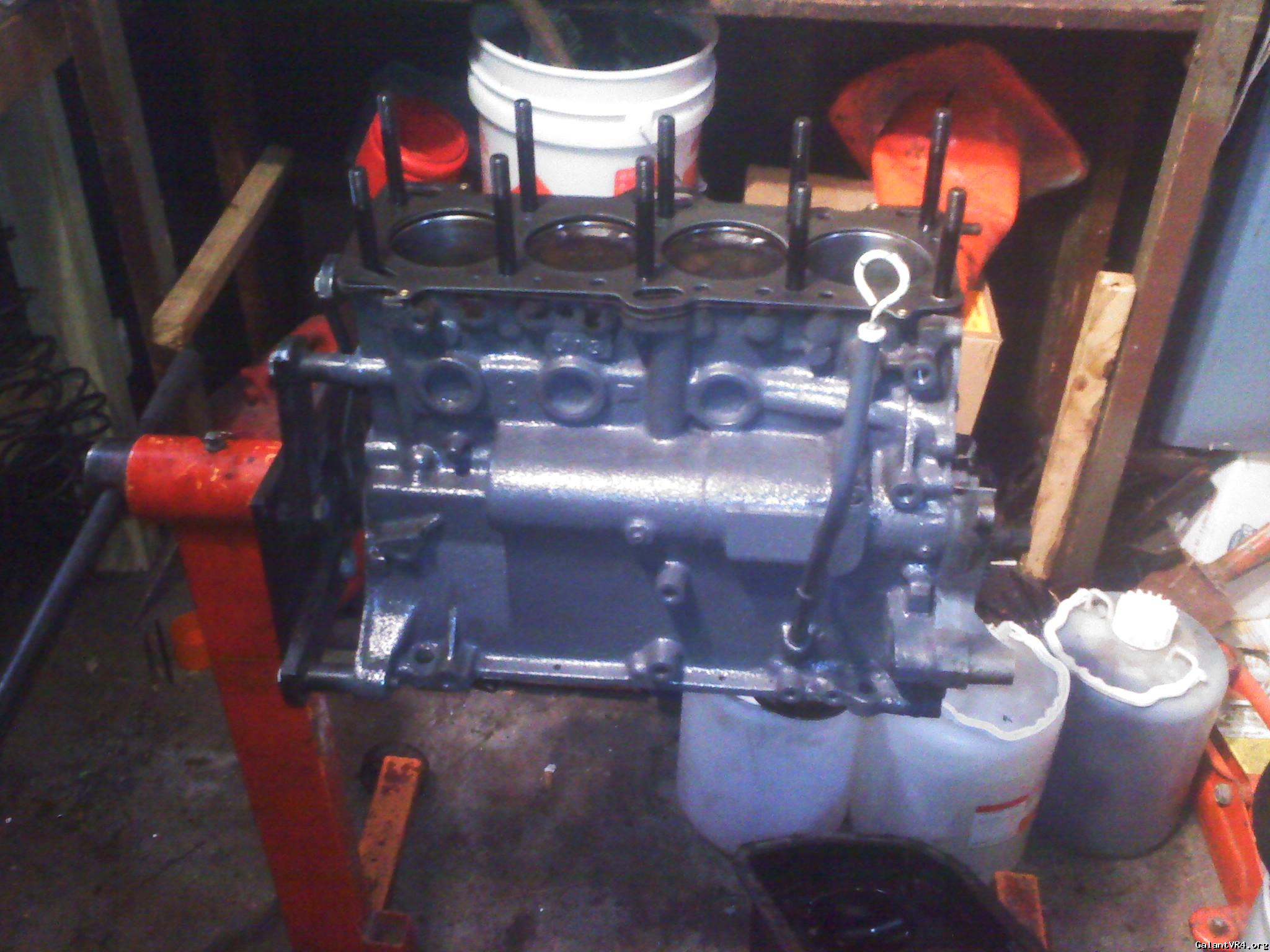

so it begins....
I had an extra 6-bolt laying around, it was meant for the 2g, but I ended up using it for the galant build.

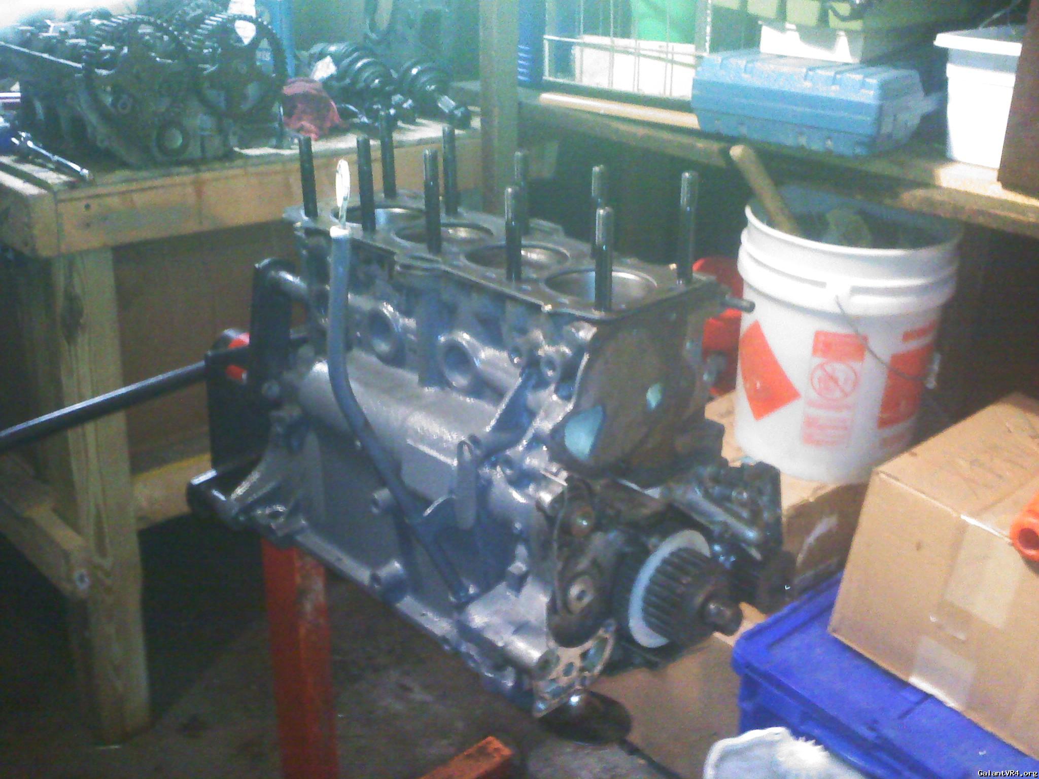

Added ARP head studs, and cometic head gasket

Most of the parts I found used for good prices and reused many parts. I have access to a bead blaster so alot of stuff is cleaned up and painted. This is what I have spent up to date.

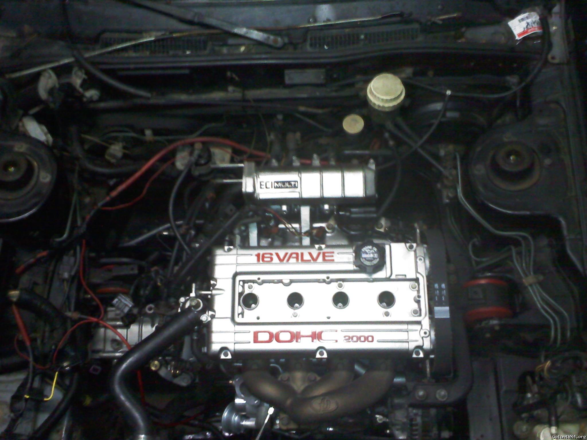

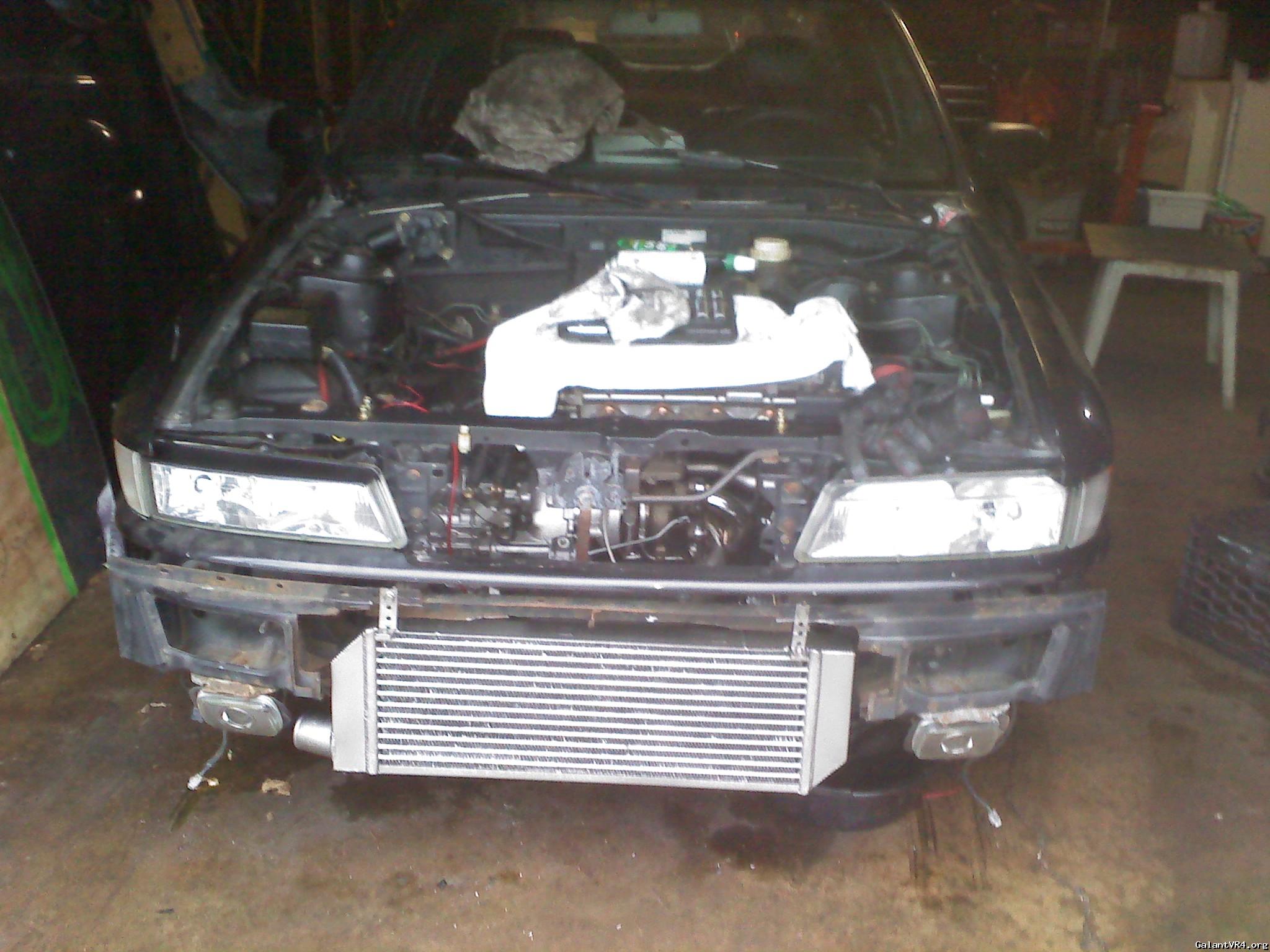

just a few new pics

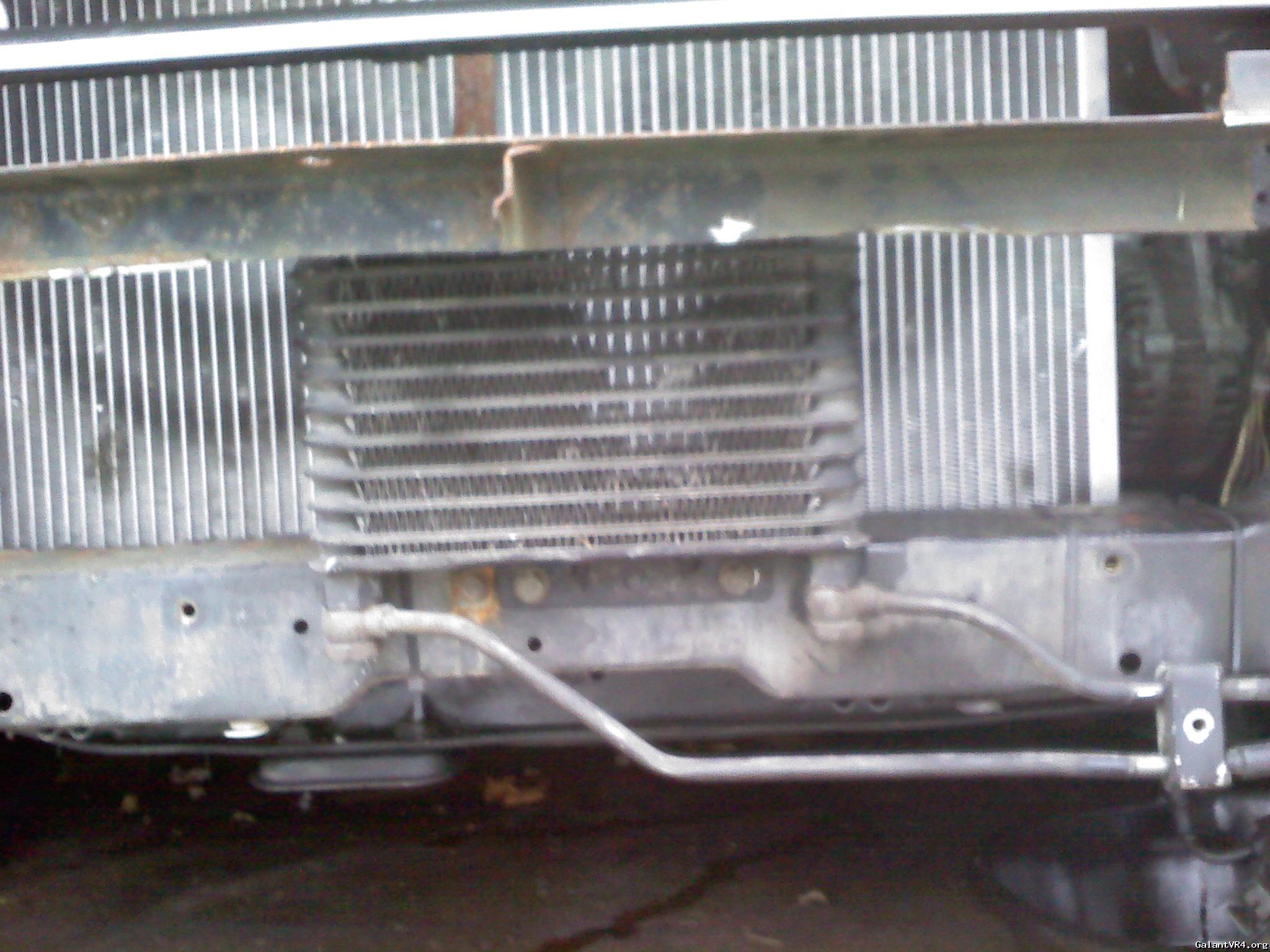

drop the heart into the car, alot of clean up left to do
installed oil cooler

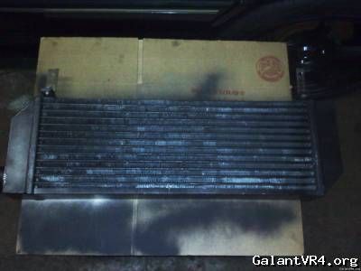

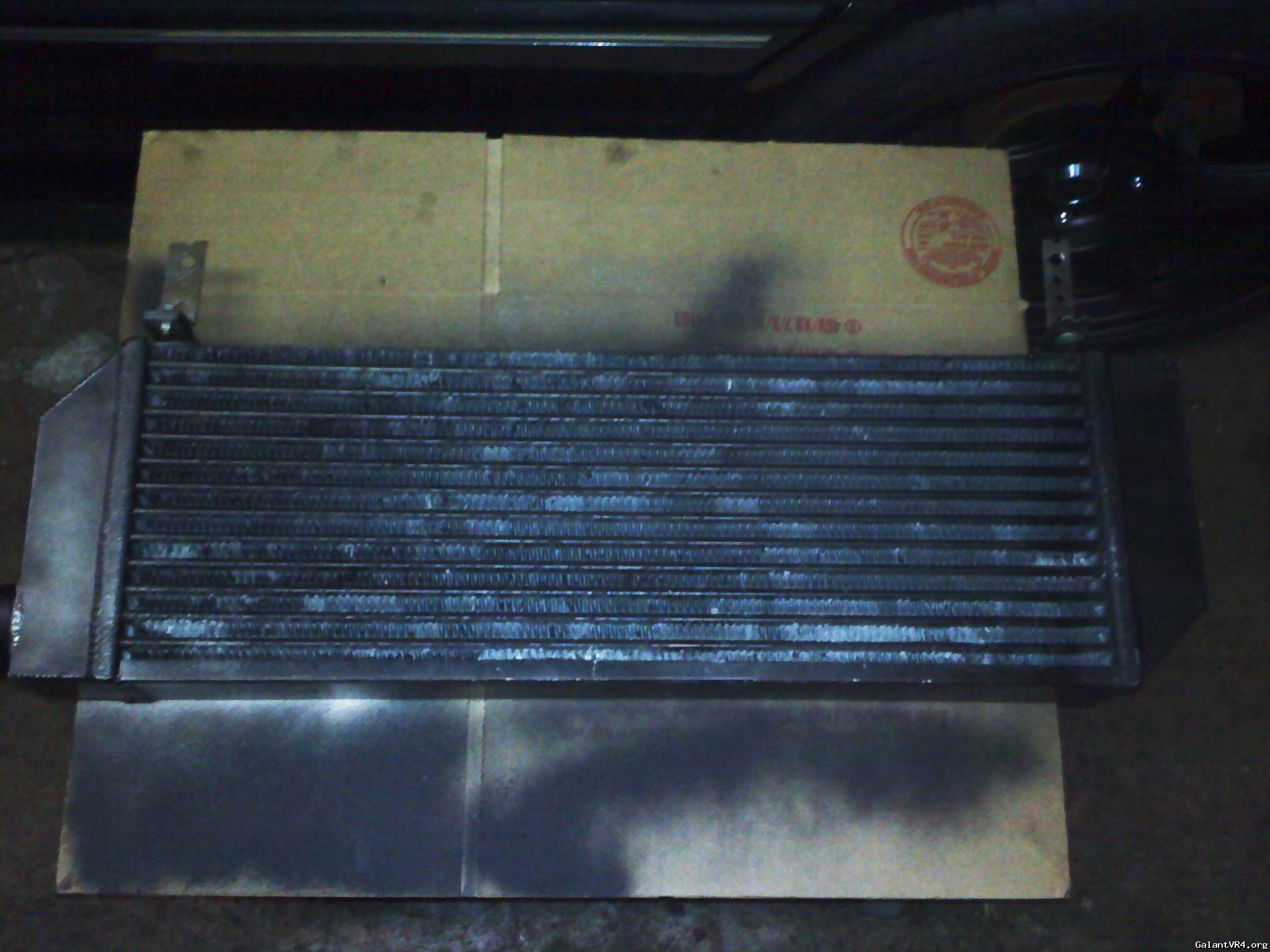

ets intercooler before being cleaned up

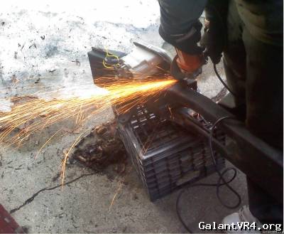

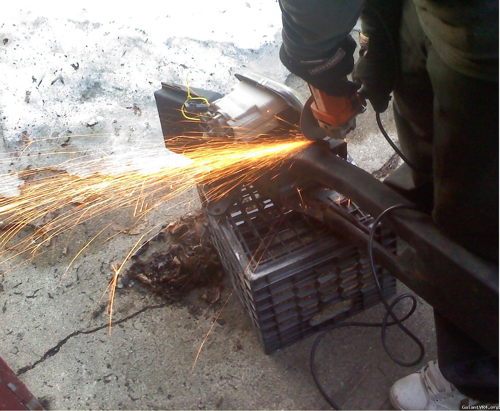

cutting the reinforcement bar to fit intercooler
test fitting

What paint did you use on the manifold and hot side. I wasn't aware they made a rattle can that would he up under the temps a turbo see's. I know the high temp I sprayed 1947's manifold lasted all of 2 seconds before it just fell off.
snohacking
Mar 16, 2010
233
Menomonee Falls, Wi
VHT FlameProof Paint, it can withstands temperatures up to 2,000°F. It must be baked on in a oven. It's sold at most car part stores now. I have a friend that painted his hotside and manifold almost a year ago and it is still holding strong.

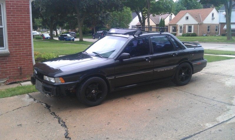

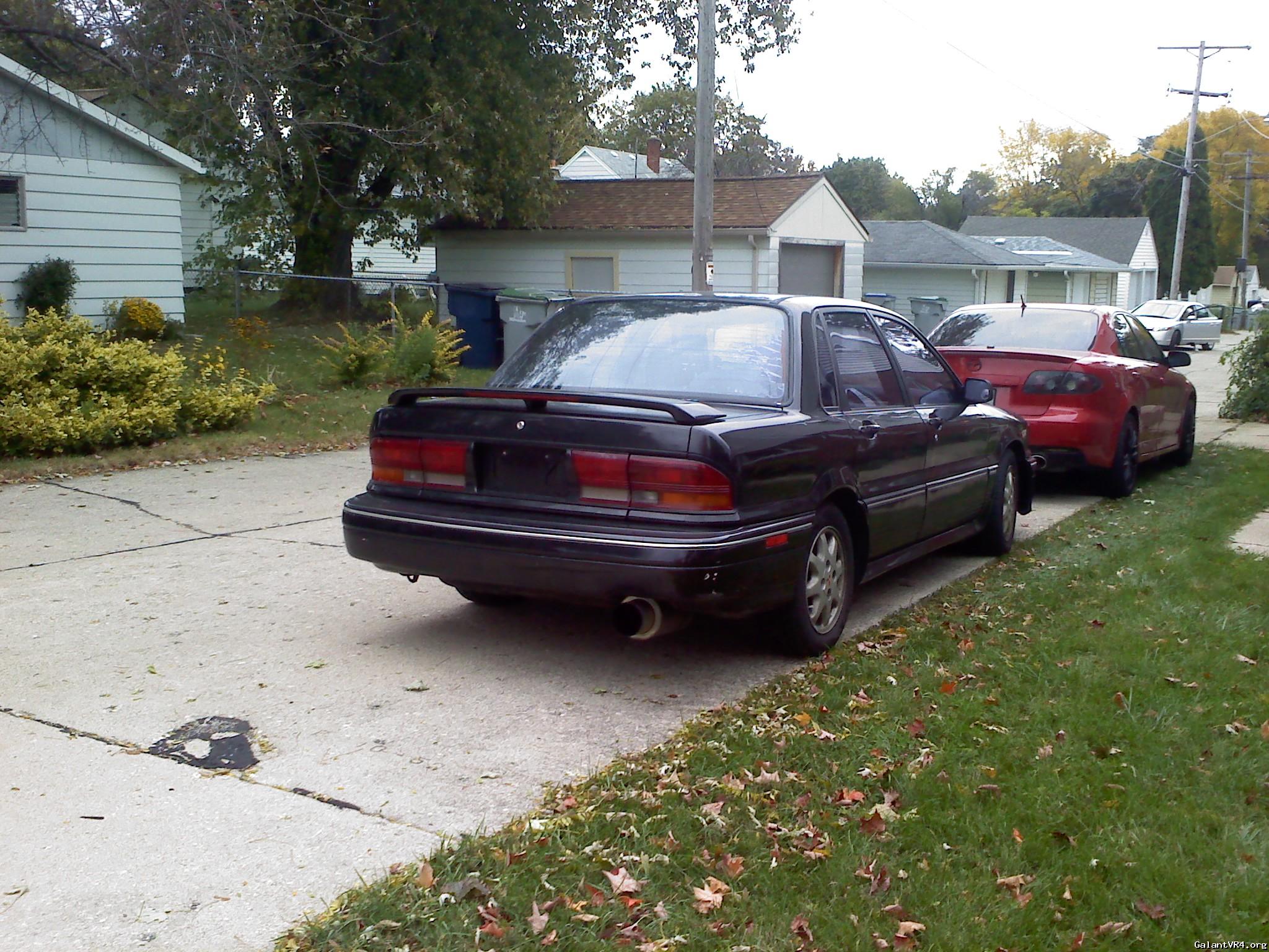

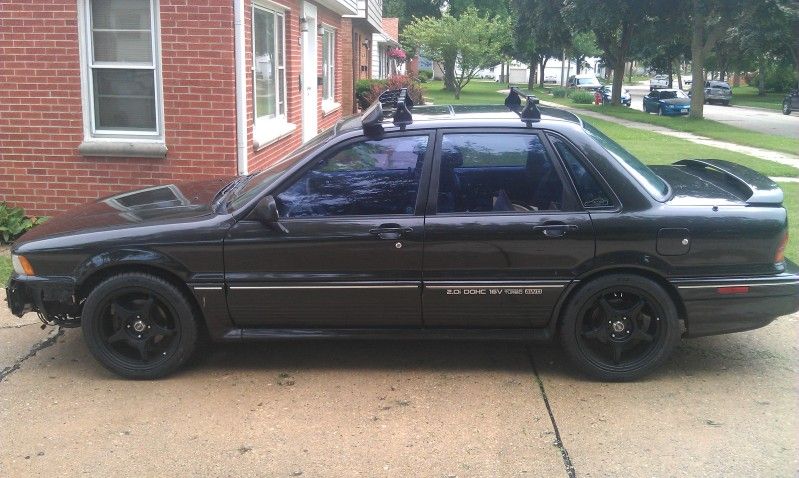

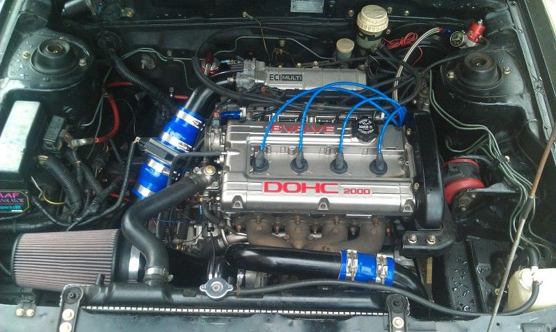

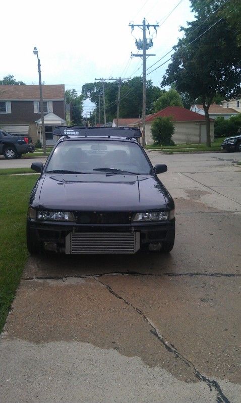

Got it running, cleaned it up, and pulled it out of the garage. Added new parts 5zigen fn01r-c rims, thule roof rack, and door decals.
