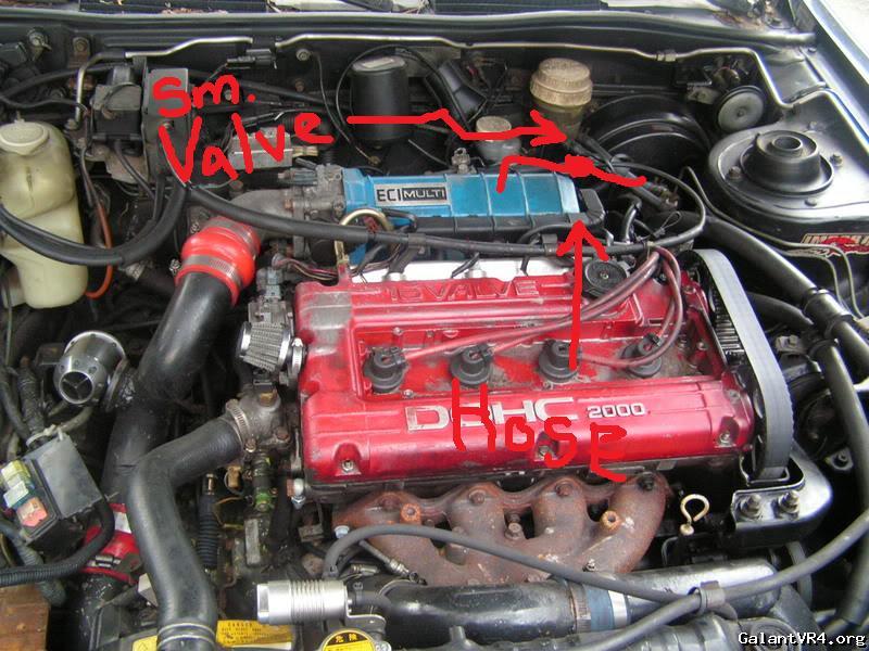

im going to go out on a limb here.. But have you checked the big hose that go's from the middle of your brake booster,to the back of the intake mani?
That big hose has a small one way valve inside the hose, and if it go's bad you can get the same brake syptoms.I know cause toybreaker helped me with this same problem and pointed out the valve inside the hose. As soon as i put in a replacement my brakes felt brand new and i could stop on a dime...
hope my crude pic helps what im trying to say..
Gary.
