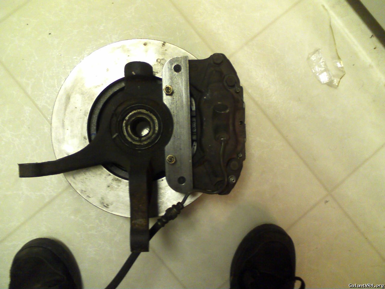

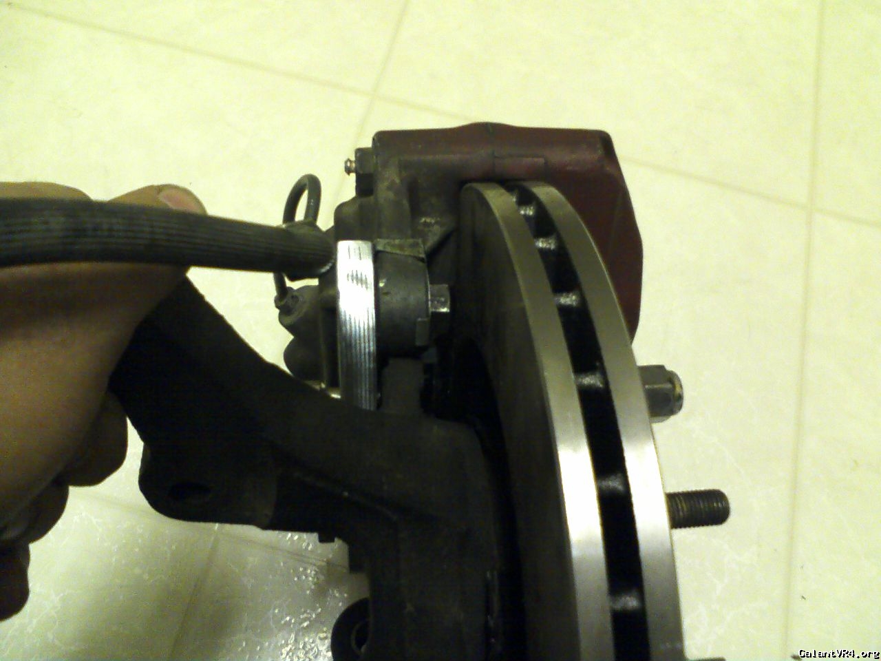

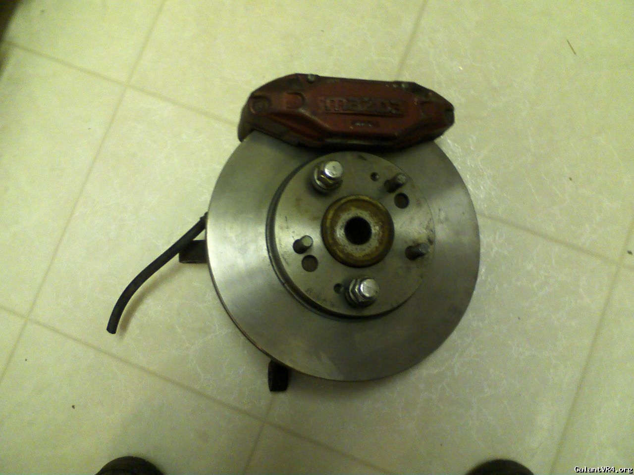

i just got my brackets from the machine shop
basically all i got here is 3rd gen rx-7 calipers custom brackets and factory size rotors everything fits under factory wheels next is to tackle the rears. my plan for that it late 3000gt vr4 2 pot rear calipers matched with early 3000gt vr4 rotor which 10mm larger than the fronts overall but with the built in drums should have roughly the same swept area as the fronts.

Why not stick with the stock calipers then? Are the calipers lighter or something? Just wondering why the switch to the rx7 calipers but sticking with the stock rotors over the stock big brakes which work really well?
Looks good though clean them up and paint them real nice. Clear the stock wheels too? Would love to see pics of the whole setup on the car.

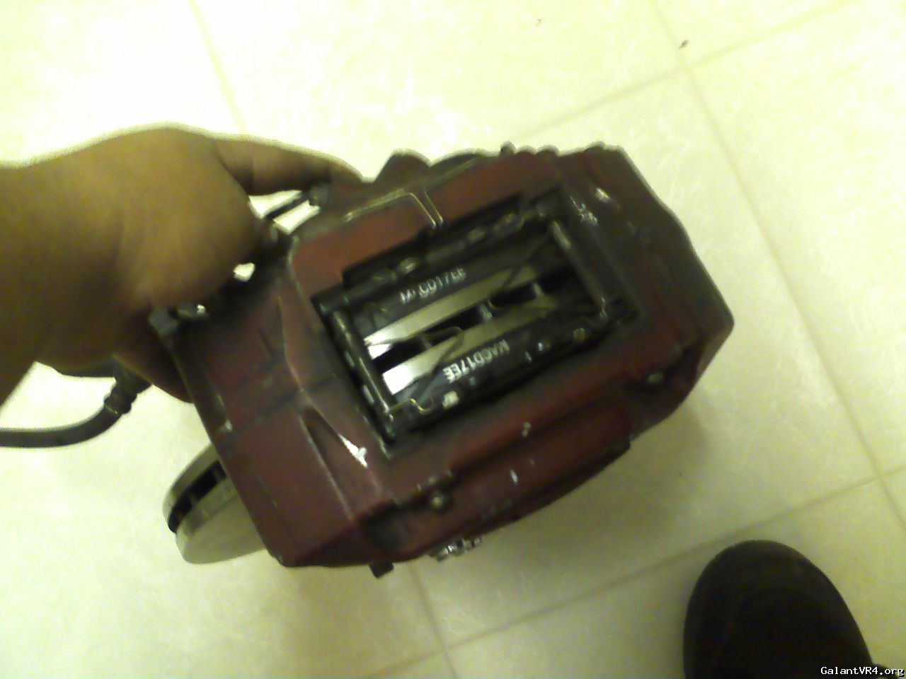

yes these are a more rigid caliper and aluminum also a little more pad selections available. also its a stab at something that may be a great improvement or a total flop but i only have about 150 dollars in the setup.
Nice! Did you happen to take weights of it or can you before you put it on the car?

ill get the weights its gonna be a little while befor the go on holiday shopping and all gonna replace everything on the knuckles while im there but ill be sure to give weights and impressions as soon as i do the install

Ok so the calipers are much larger than stock, or just the place it mounts is in the place of the steering knuckle?

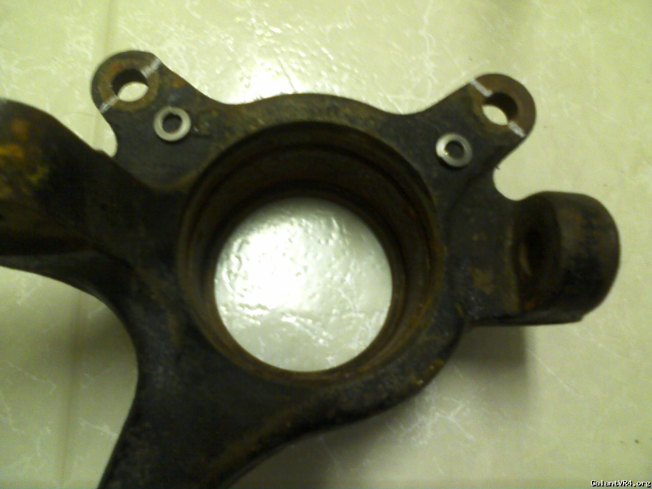

the factory caliper mounting holes are actually in the way of getting the caliper onto the rotor so half the oe mounting ears have to be whacked of and new caliper mounting holes drilled into the knuckle itself. mine are also tapped to accept a 10mm bracket mounting bolt. i had a spare set of knuckles to use as a tester to make sure all will work the way i intend it to befor i start sing any praises or cry wolf and go back to stock.

basically cut on the white line and drill where the washers are to allow the caliper to slide all the way down onto the rotor and then attach the bracket
Eh that isn't too bad... getting a spare set of steering knuckles wouldn't be the end of the world..
