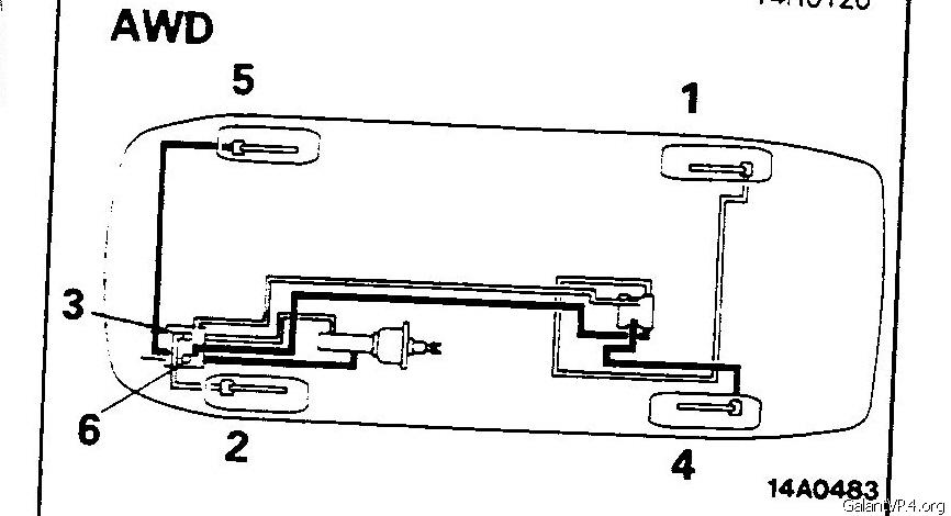

there are two main types of braking systems. front rear split & diagonal. our cars use the diagonal type. when you bleed u will start at the right rear, move to the left front, then left rear & lastly right front.
If you do front to rear as you would with say a Chevy nova 70's, you will pitch the proportioning valve to one side & get what your describing. try re-bleading the system first.
CP

Never had this problem bleeding from the farthest from the reservoir to the closest: RR, LR, RF, LF. I've done it this way with and without the ABS in this car and there's no difference.
