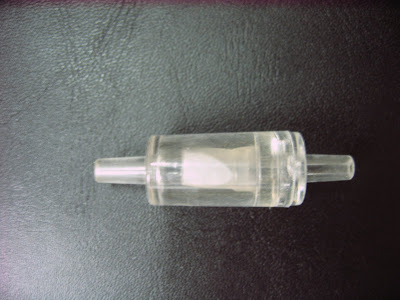

Would one of these work?
It's a anti siphon valve for fish tank air pumps, Air can only pass one way through it.
prove_it
Jul 3, 2008
4,201
Sioux Falls, SD
I'd try to find the right piece rather than hacking it with a fish tank piece. Not sure how well that would take boost pressures. The seams might crack or leak.
What about a PCV valve? Does same thing, holds up to boost, and more readily available?
