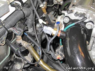

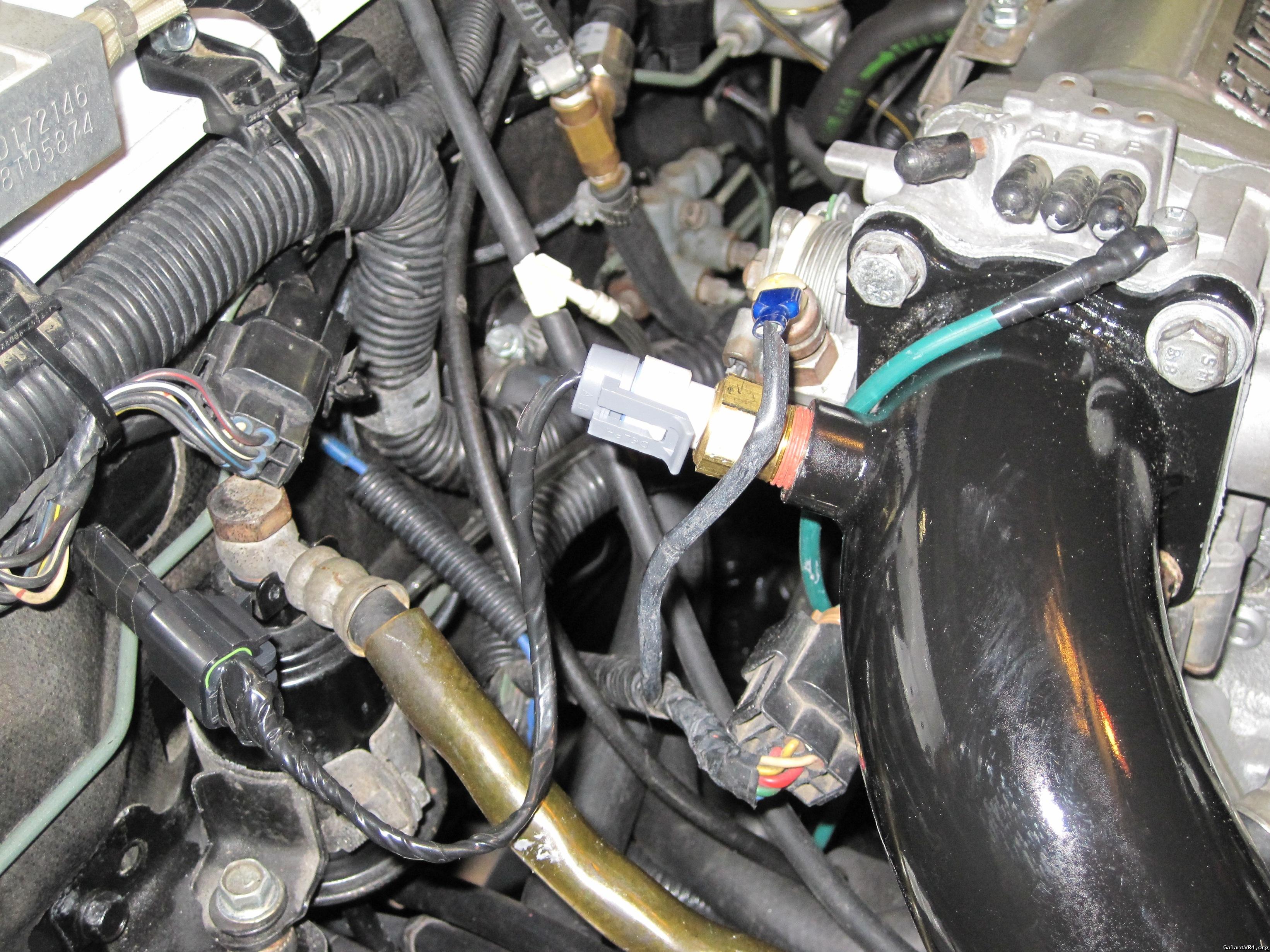

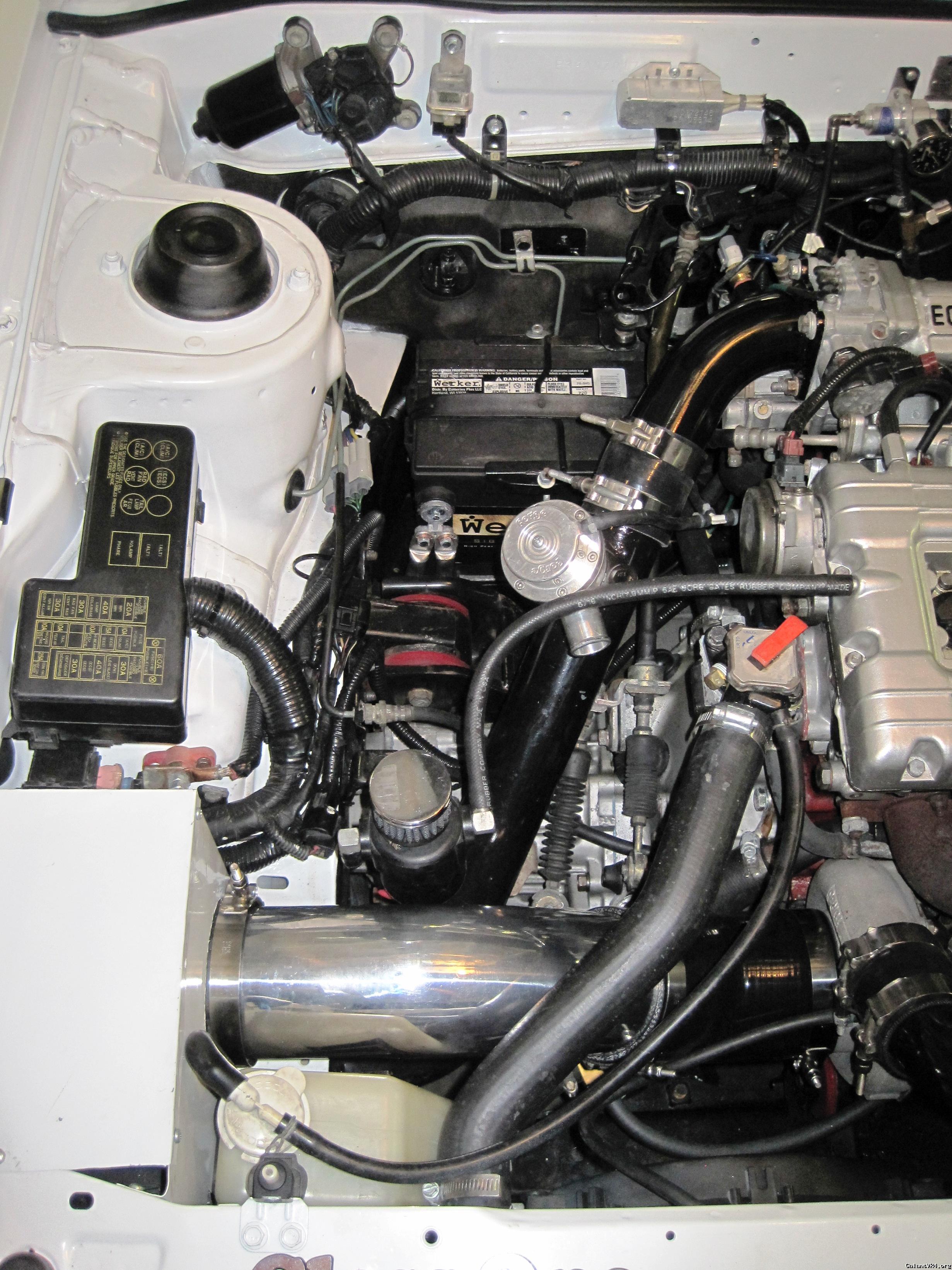

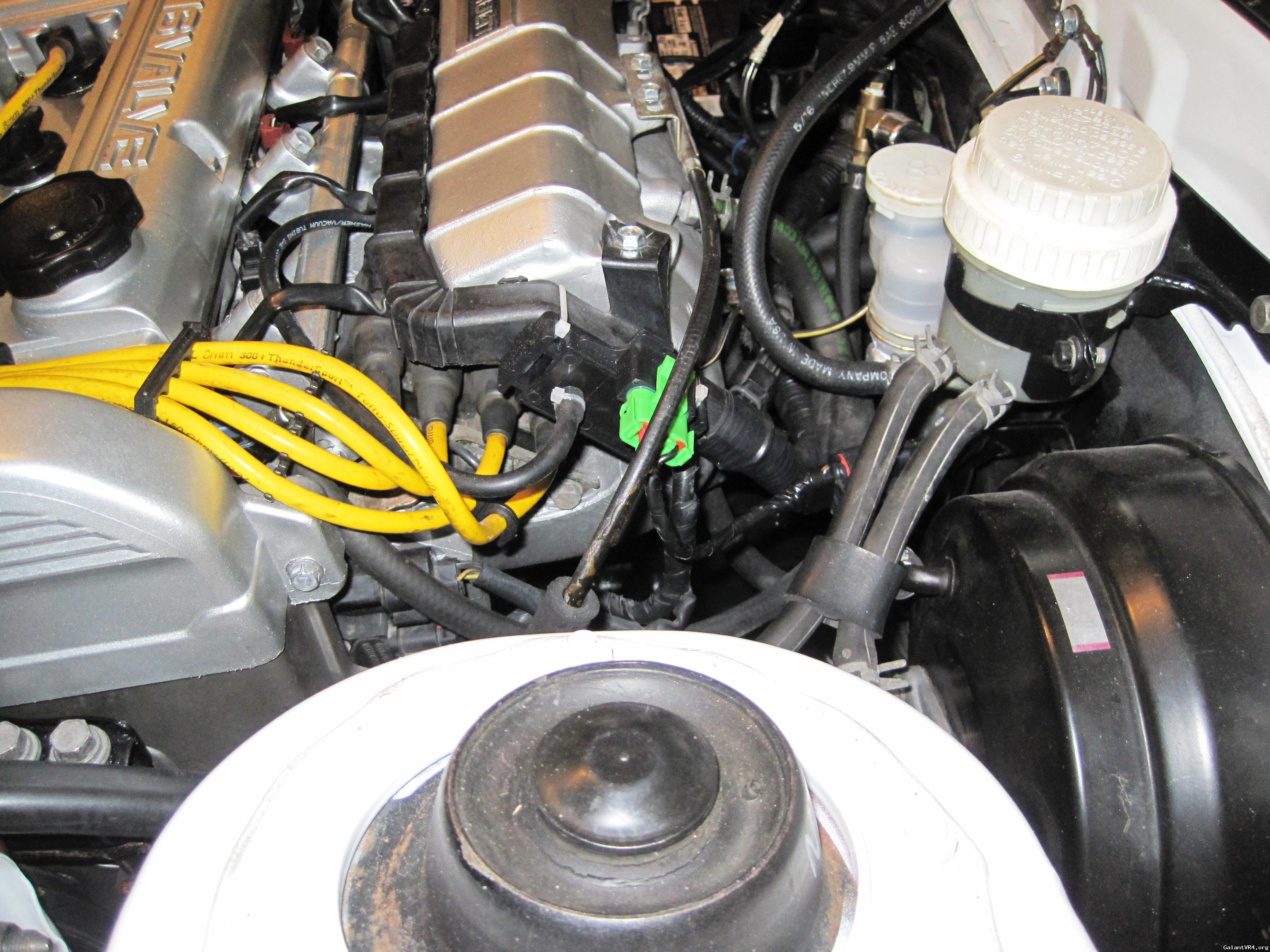

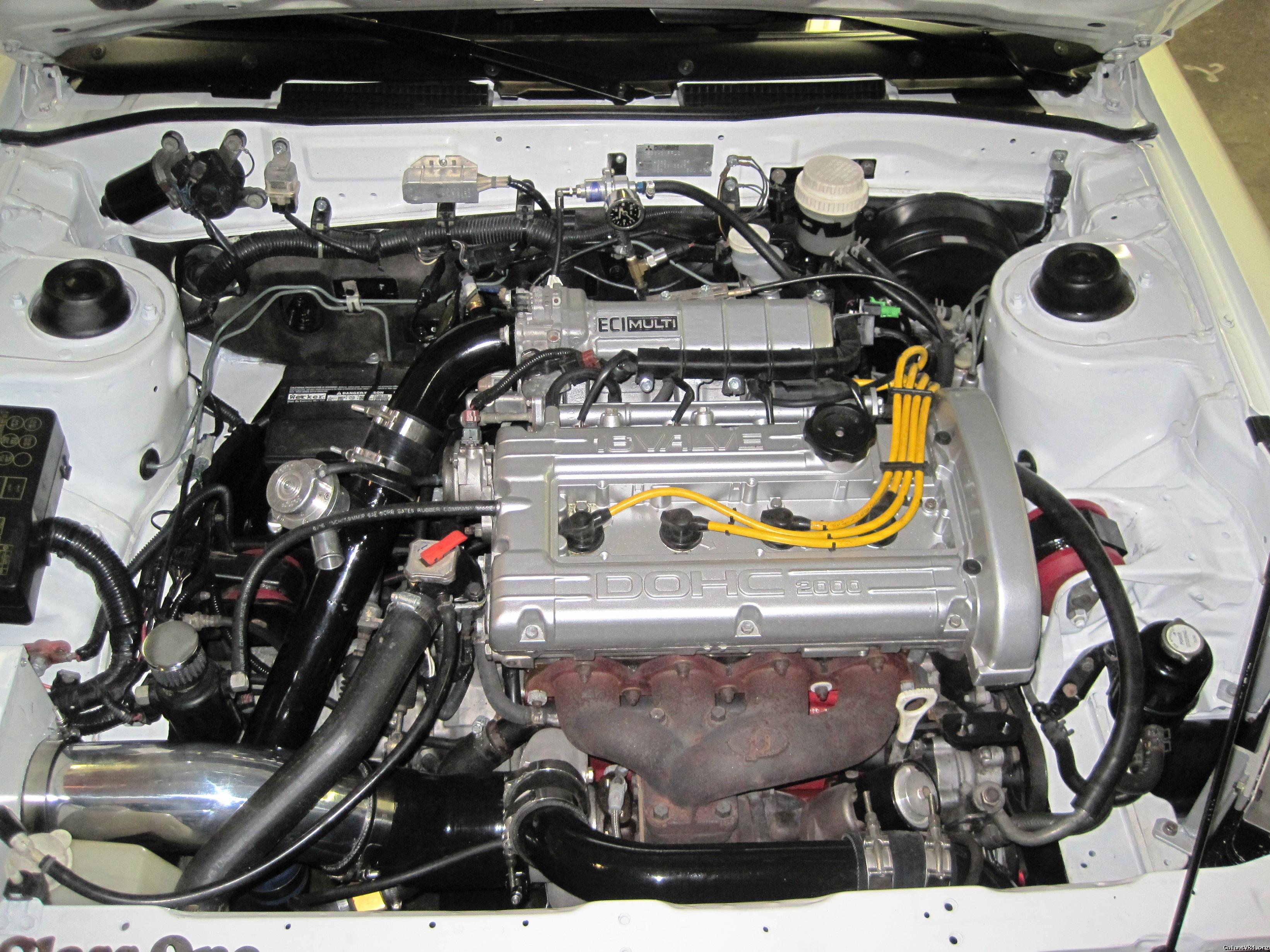

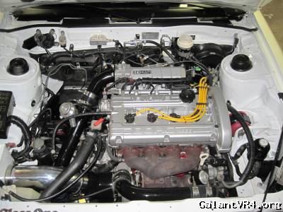

Here are some new pics of what my car has turned into.

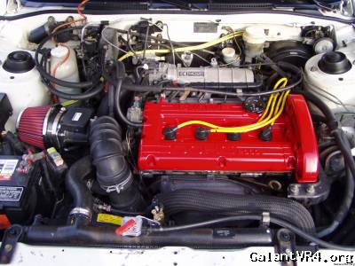

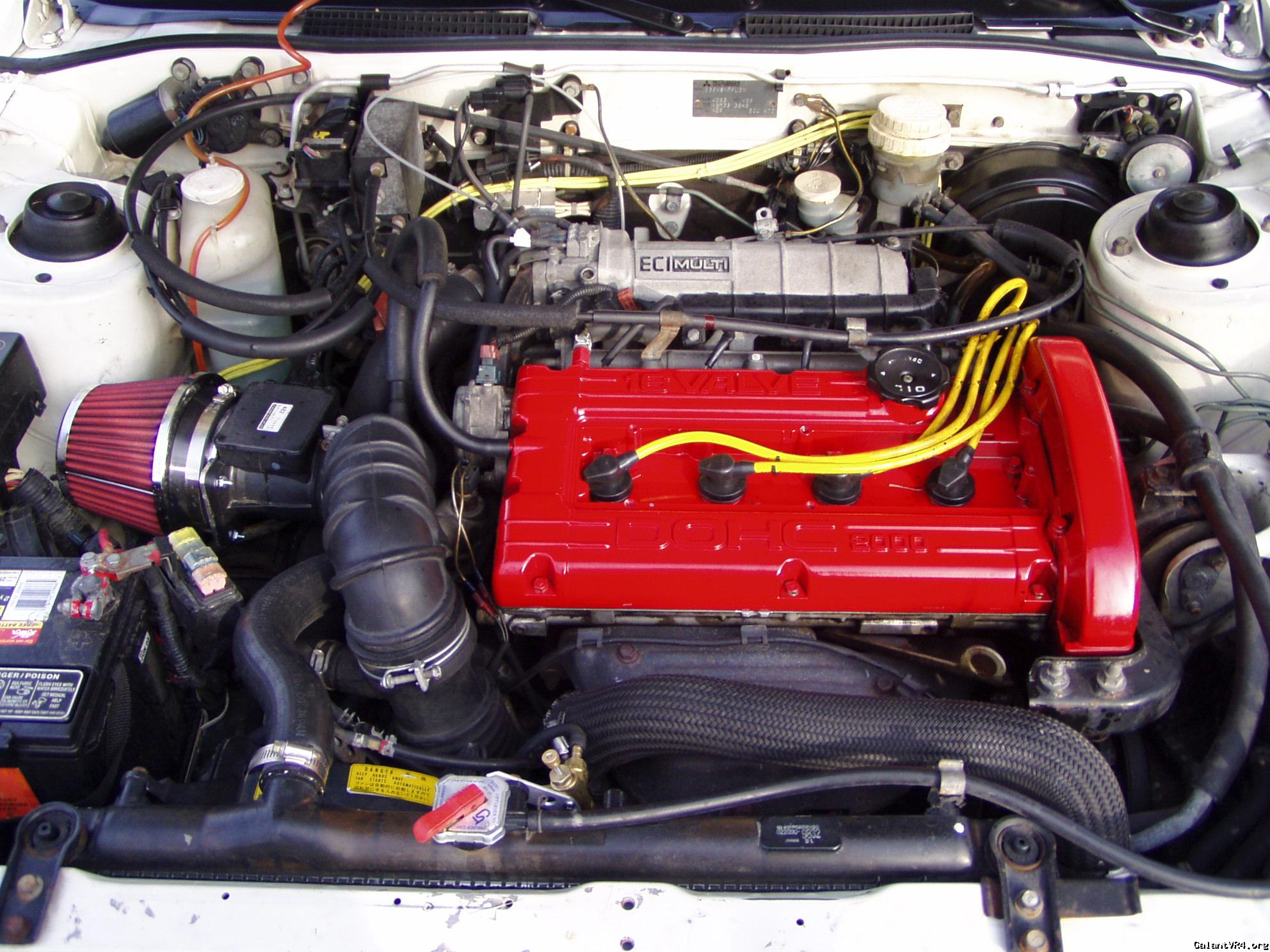

1st, lets show the very first picture of the engine bay I took:
This was right after I did the Keydiver 3G MAS upgrade
Here is how it sits today:
