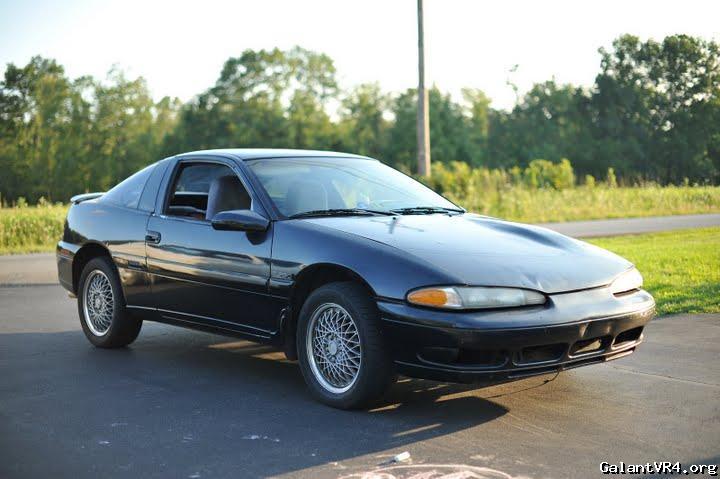

Stock 1992 Laser from Richmond, VA - 150k w/ rebuilt motor. $1100. Couple new stock parts, good tires, brakes, body, smooth tranny, etc. Tore it down in the last day with no major surprises. No rust anywhere. LSD 4 bolt rear end, 6 bolt block, non abs, 5 lug - anything else this car is good for??? Lotsa parts coming - strip, rebuild & rape underway...
Gonna drive it for a bit - looking for a clean Kensington roller...

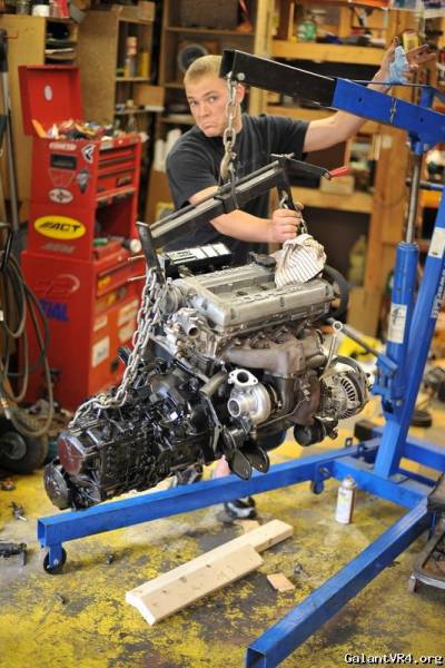

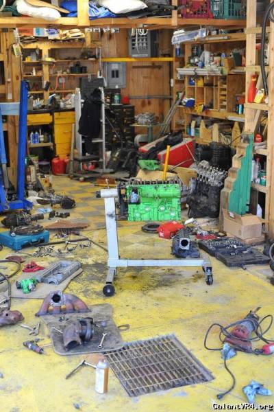

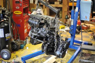

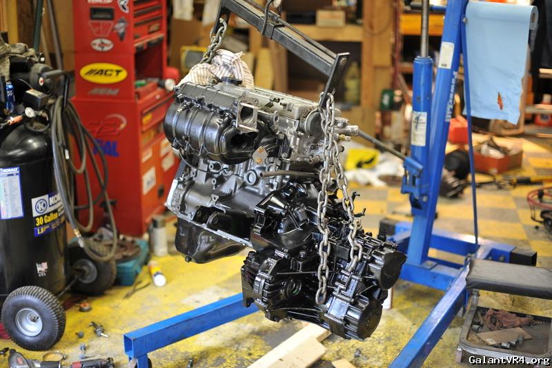

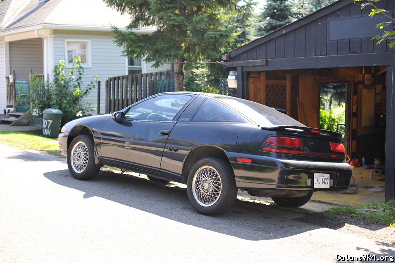

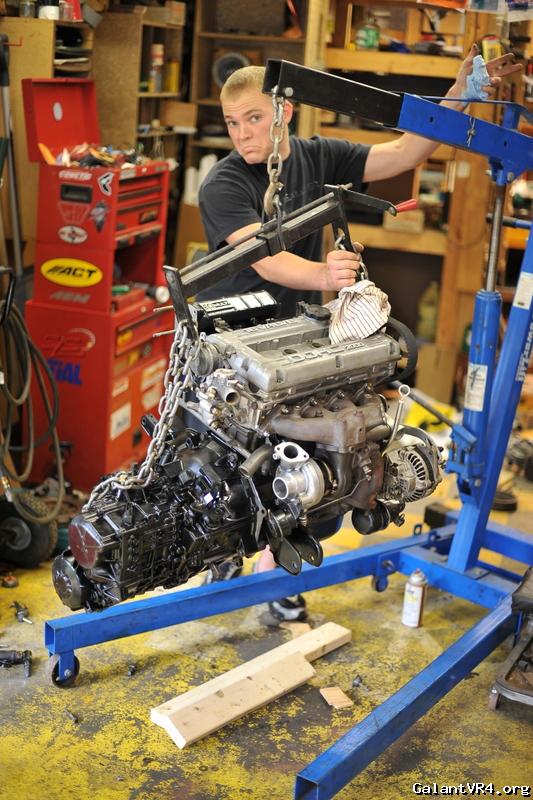

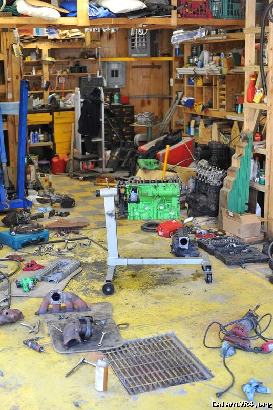

ok - dismembering began a few days ago. most of the work thus far has been pressure washing, wire wheeling and sandblasting. A/C removed, PS removed, cruise removed, emissions, f&r bumpers, lotsa interior crap, all seatbelts except front lap belts, rear wiper, lotsa plastickey stuff, brackets, misc unnecessary...
* interior still looks like an interior
* driveshaft filled in with silicon goop
* rear end full of Redline shockproof (more to come for x-frcase and fancy juice for tranny too)
* all old painted green parts now black or shiny metal (wtf the old owner was thinking bleh...)
* head off to machine shop for cleaning, check, and new valve stem seals
* clutch, flywheel and t/o bearing are great shape
* bov sandblasted and crushed
* b-shafts removed
* bottom end in FANTASTIC shape - pistons perfect, crosshatch in sidewall
* complete engine overhaul gasket kit arriving tomorrow
* crap on TB eliminated and blocked, new seals, semi polished

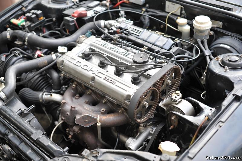

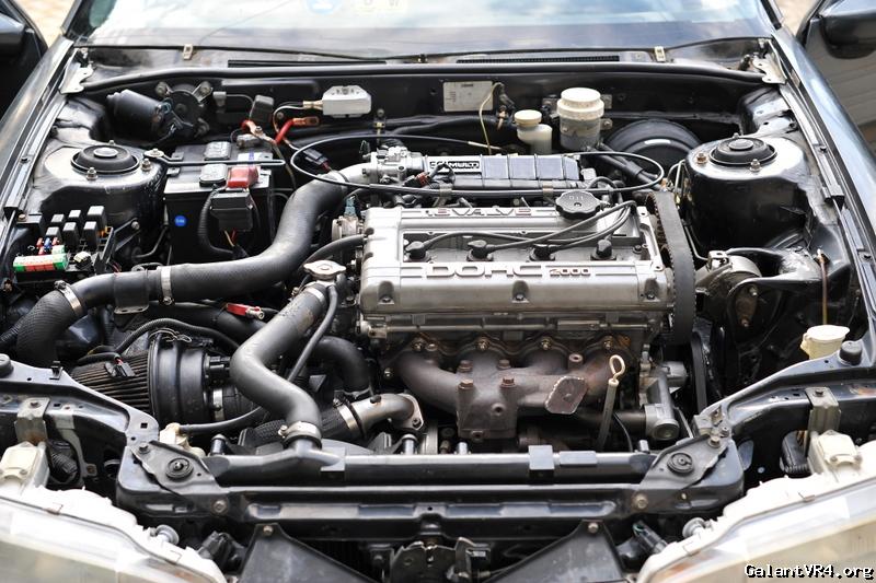

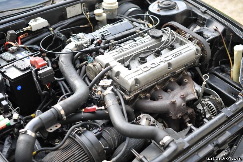

first pics:
3" FP downpipe and custom 3" exhaust installed today. No leaks. Car is kinda hard to drive (no PS) sounds like the 4 horsemen of the apocalypse coming down the road. Needs 93 octane, boost gauge, logged, fuel pump rewire, etc etc etc...
meh.
Looks pretty nice. Just curious as to what part of the driveshaft and why you filled with "GOOP"? /ubbthreads/images/graemlins/confused.gif
sleepyvr4
Dec 25, 2003
2,359
Key West
Quoting AutoX_VR4:
the rubber mammer jammers that house the carrier bearings -
