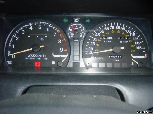

Just thought I would finally post this pic of my gauge install. It took far too much work for what it is but at least I am very happy with it. And it works perfectly (after many hours of tinkering). Sure hope someone else appreciates it.

that is so badass man, too bad I have 2 gauges I need, otherwise for just one that is killer.
definitly looks great
l have to ask because l`m constantly diving into detail oriented jobs that end up taking waaaay too long (but look cool)....just how long did it take? don`t lie either.l bet the next one will be a breeze though.

Awesome install. Isn't it harder to look down there than to the A-Pillar to see how much you are boosting though? Although if you're just going for a stealth, clean look, you hit the nail on the head. I just don't know if that's as easy to read as a 60mm gauge on the A-pillar right in your face.

I appreciate the amount of work since I did the same thing a while back. Knowing exactly where it's going before cutting and breaking plastic was key. I lucked out with mine and was able to mount it right through one of the existing auto transmission indicator bulb holes which also put the gauge flush with the existing ones without any shimming. Having a blank spot on the flex circuit board directly behind where the hose needed to go through didn't hurt either.

The stock boost gauge isn't really a boost gauge. It "predicts" what the boost should be based on a number of inputs such as air flow and throttle position. It's really only useful for determining if you have a boost leak (stock gauge shows boost, aftermarket shows none) or if you have a Keydiver ECU.
Very, very nice install job. Me like.

And even if it was accurate, its 5 blinking lights. You wouldn't be able to tell what psi you were at anyway.
It probably took me 24 hours total time or more, but I did it over a couple of times. All kinds of issues I had with it. Where I had the hose going the first time made the gauge want to rotate to the left. I didn't support it well enough the first time and it tore through some of the connections on the circuit board. Fixed those, then had the fixes break. Got another board from a local guy thats been very nice. Also had the gauge parts hitting the trip meter mechanicals and reading inaccurately. And yes it is harder to read where it is than a pillar pod, but I didn't want everyone that pulls up beside to see a gauge or two sitting right there. And Mark I didn't really understand what your post meant. thanks again, Micah.
that looks totally steath ! great job .. has anyone tried mounting a boost gauge off the "hood"
of the intrument panel, it would hang right between the tach and the speedo ?

I had the same initial problem with the gauge mechanical coil bumping into the odometer and not reading above a certain psi. Also mine isn't backlit since I used an old HKS gauge which was supposed to be sidelit. Was planning on installing a small led to light it but never got around to it.
The cool thing is seeing all three needles turn together when you floor it and the goal is to have all of them parallel to each other pointing somewhere to the right
uno. i have a lot of respect for you now. that looks amazing. i don't care if its a little more work to look at than on the a pillar... it just seems to be at home there. very nice. so clean its just amazing. if you spend that much time with you car on the installs and it turns out that nice, i'd have to see more of it. post more pics.
