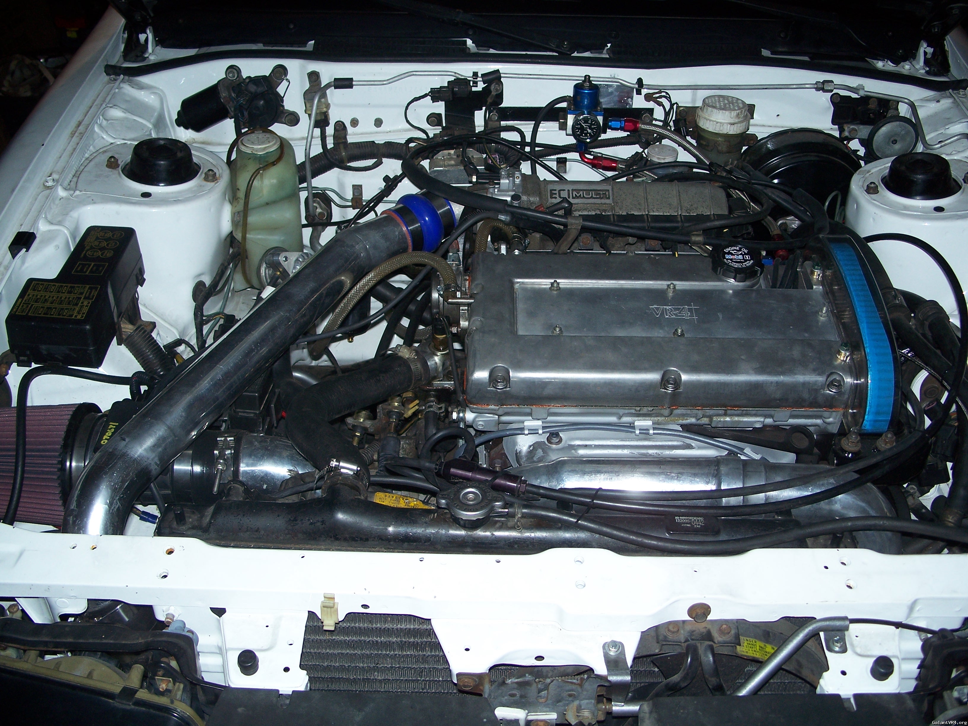

Tried everything Nate. Took it apart, everything looks fine. I now have the vacuum line for the boost controller tapped into the brake booster line, but the vacuum line from the BC to the brake booster is really long. I'm about to try another BC.
You can see in the pic the boost controller is down by the radiator cap and the vacuum line follows the control cable for the controller back to the brake booster.

Definitely try a new MBC. It sounds like its just that simple of a problem. What happens when you totally disconnect the mbc and hook the wastegate line to a vacuum source?
