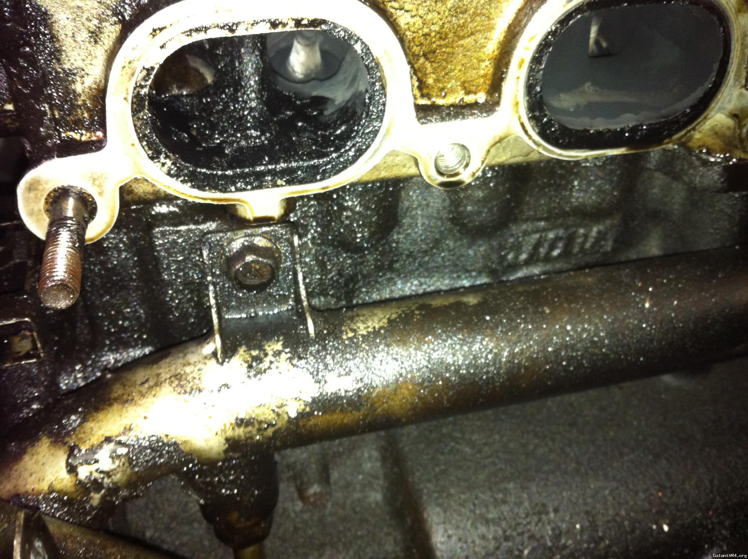

update, i've got oil squirting out of the exhaust manifold when you rev it up. we pulled the spark plugs and they look clean. I can take a picture of where its leaking oil out tomorrow in the daylight. my friend looked at it and thinks I need a new turbo that the seals are probably shot

Oil squirting out the exhaust manifold? I wouldn't think that to be a turbo issue, unless the oil were coming out below it. I wonder if you have a really bad valve seal. My plugs always looked clean when I had issues with them as well. You can really tell when it's valve seals if you pull the exhaust manifold and the exhaust ports in the head are almost wet with oil.

I pulled my turbo tonight and this is what I see in one exhaust port, the other 3 look fine. looks not good =( any help with this one?

My exhaust ports pretty much looked like that when I had bad exhaust valve seals and exhaust valve guides. You *could* change the valve seals with the cylinder still on the head, and see if that fixes it. However, if you do that and it still smokes, it's probably the guides.
Also, are any of your plugs oily looking?
