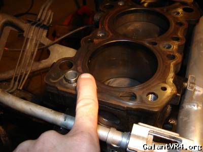

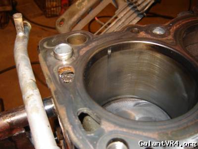

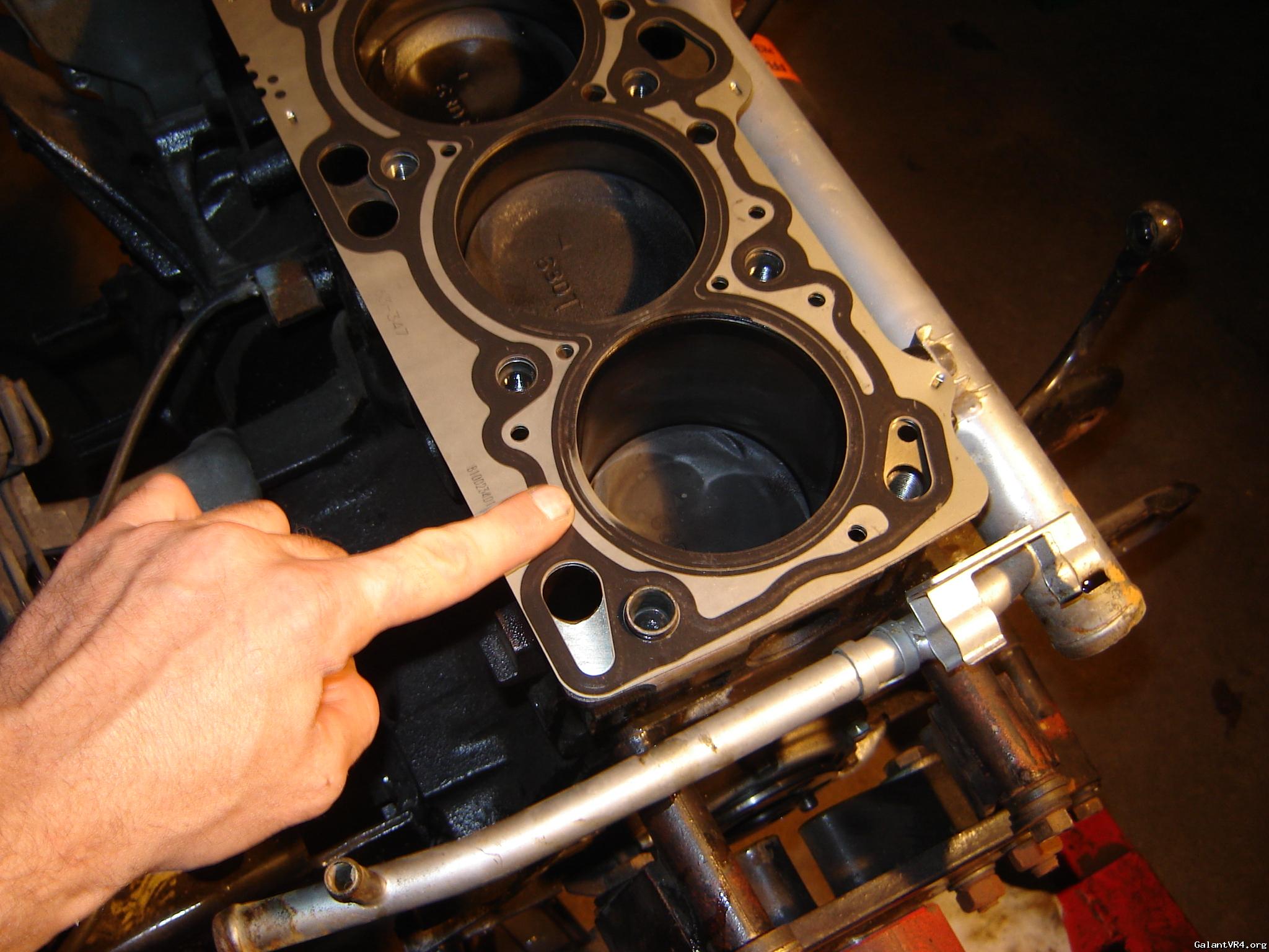

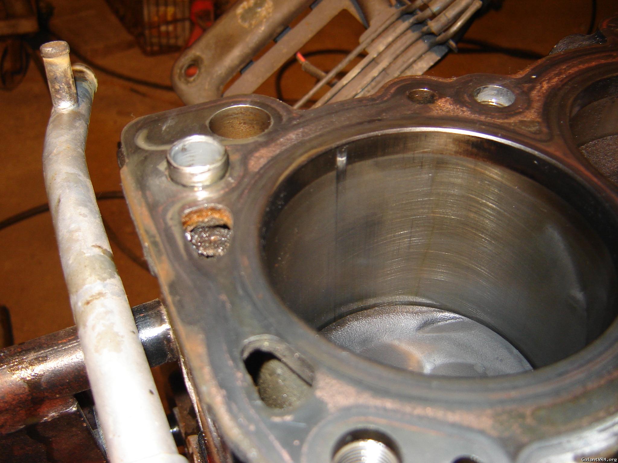

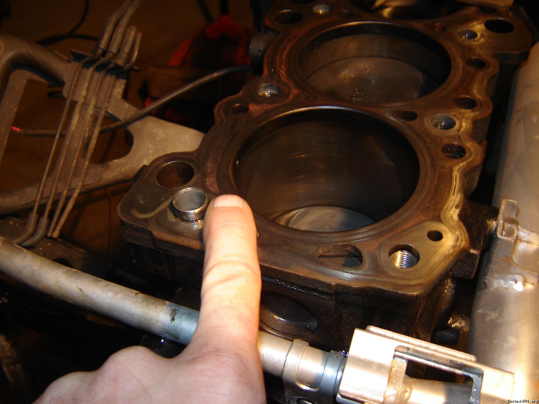

Well after tearing the motor down today hopeing to find just a couple of melted pistons, I find out that I need to kick the machinest, and myself in the NUTZ. If you look at the pictures, you can see where the gasket lifted because of the dip in the cylinder wall that I did not notice until now.
Here is the Original Post of the repair I did on the #1 cylinder because of the D-Bag that cleaned the block surface with a grinder. Well it turns out that he also dipped the #4 and it should have been welded before it was decked aswell. I didnt look close enough after I got the block back from the shop.

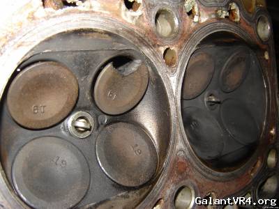

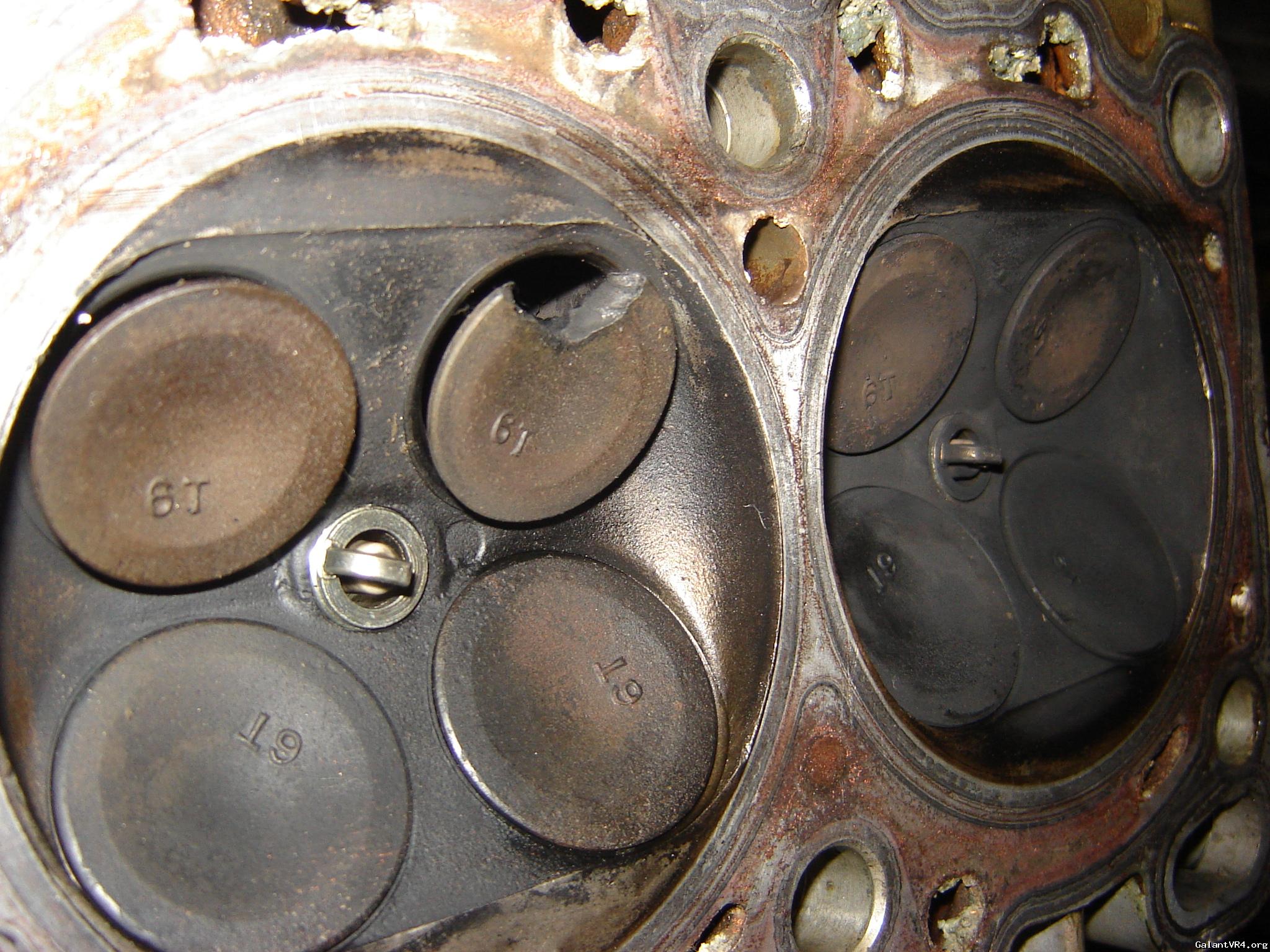

Sadly, this wasnt the only issue that lead to the demise of the motor though. The fuel pump that I bought also had issues and was malfunctioning which created fuel cut, and detonation because it ended up leaning out. Mix that all together with enormous boost creep/spike, and you have the #2 cylinder going dead because the spark plug detonated along with the valve burning. #4 Spark plug was toasted also. you can see the reminace of it on the cylinder wall just below the gouge in the edge of the cylinder.

Looks more like you popped a ring land and burned a valve. /ubbthreads/images/graemlins/dunno.gif

Yeah that dip in the block looks like an after the fact thing. They are going to make sure that is flat before it comes back to you.

It wasnt an after fact. It's so shallow that you could barley see it it just looks deeper since the block surface is dirty. You can see the grinder marks in it that go the opposite way of the machine surface marks.

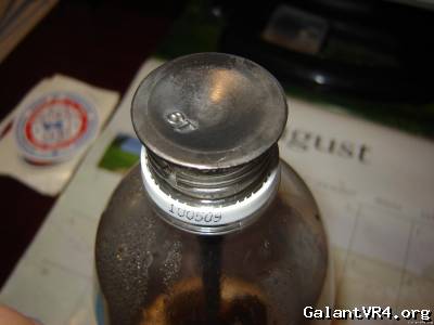

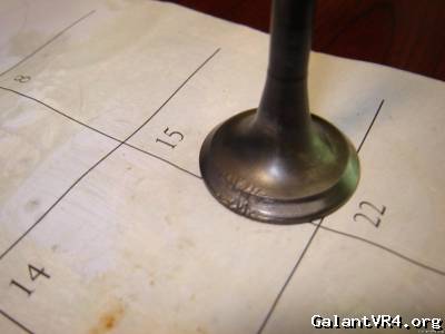

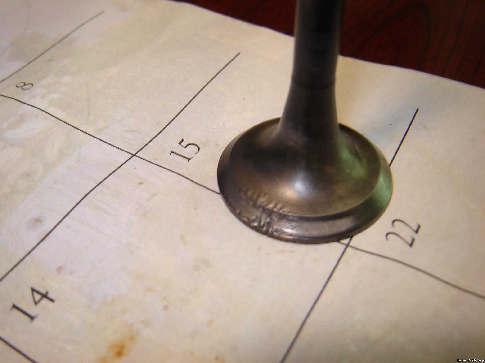

The valve wasn't cracked, Thats what happens when you burn a valve. It basiclly torches a hole through your valve. If you look at your valve you won't see any cracks, you will notice it looks like someone cut it with a torch.

I also think you need to pull the #4 piston out to make sure the rings and ring land is still one one piece. Because looking at the pic makes me think you popped a ring land.

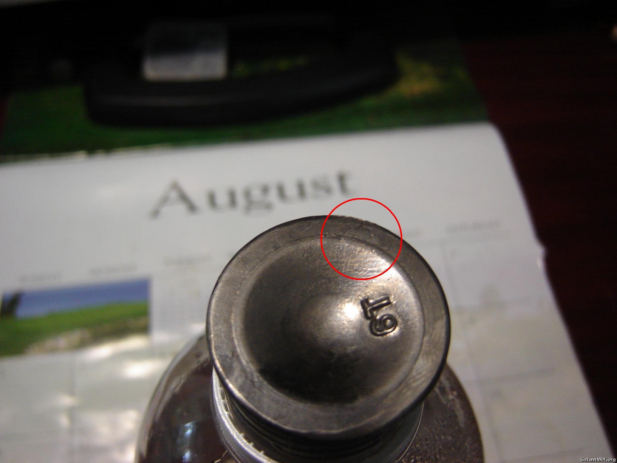

I have seen hundreds of burnt valves in the last 20 years, they are not that hard to identify, and yes this valve did burn out, I am just trying to say that the burn most likely had to start from a point and there might have been a crack in the valve prior to it going in the head. The reason I am thinking that is because several of the valves came from a head that was severly warped. Basically I am just speculating. I just figure it was my luck because out of the 20+ heads that are sitting on the shelves, I would get lucky enough to pick the one that had an issue.

The motor on the other hand will be dissasembled, and gone through to see what parts will be able to be salvaged. I still belive that the ring-lands are going to be torched, which was my first assumption before I even tore the head off. Will I use it though? That depends on how much money I want to spend, and how anal I am going to be. I have 5 other blocks sitting in the garage right now that all could be the donor for the next build, I just havent decided which way I want to go. I also have a fully built motor with the Eagle/Wiseco combination in it, but I bought it for #27's build.

Sorry to say but in the last 10 years I have been playing and working on 4g motors I have never ever once seen one with a cracked valve. And I have seen some really fucked up heads.

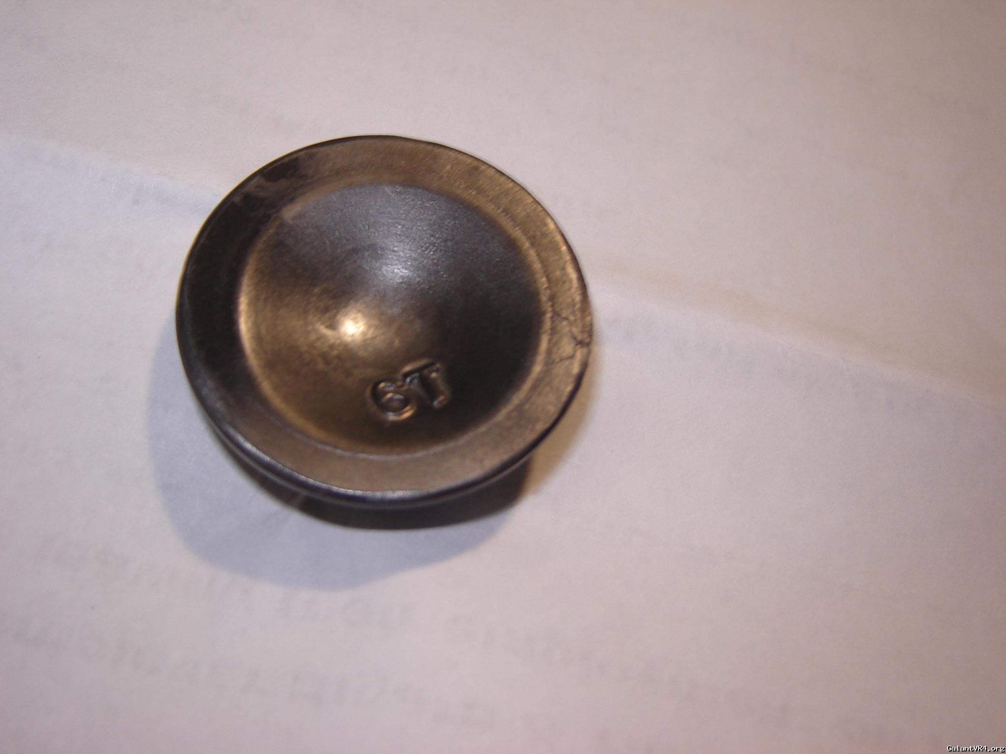

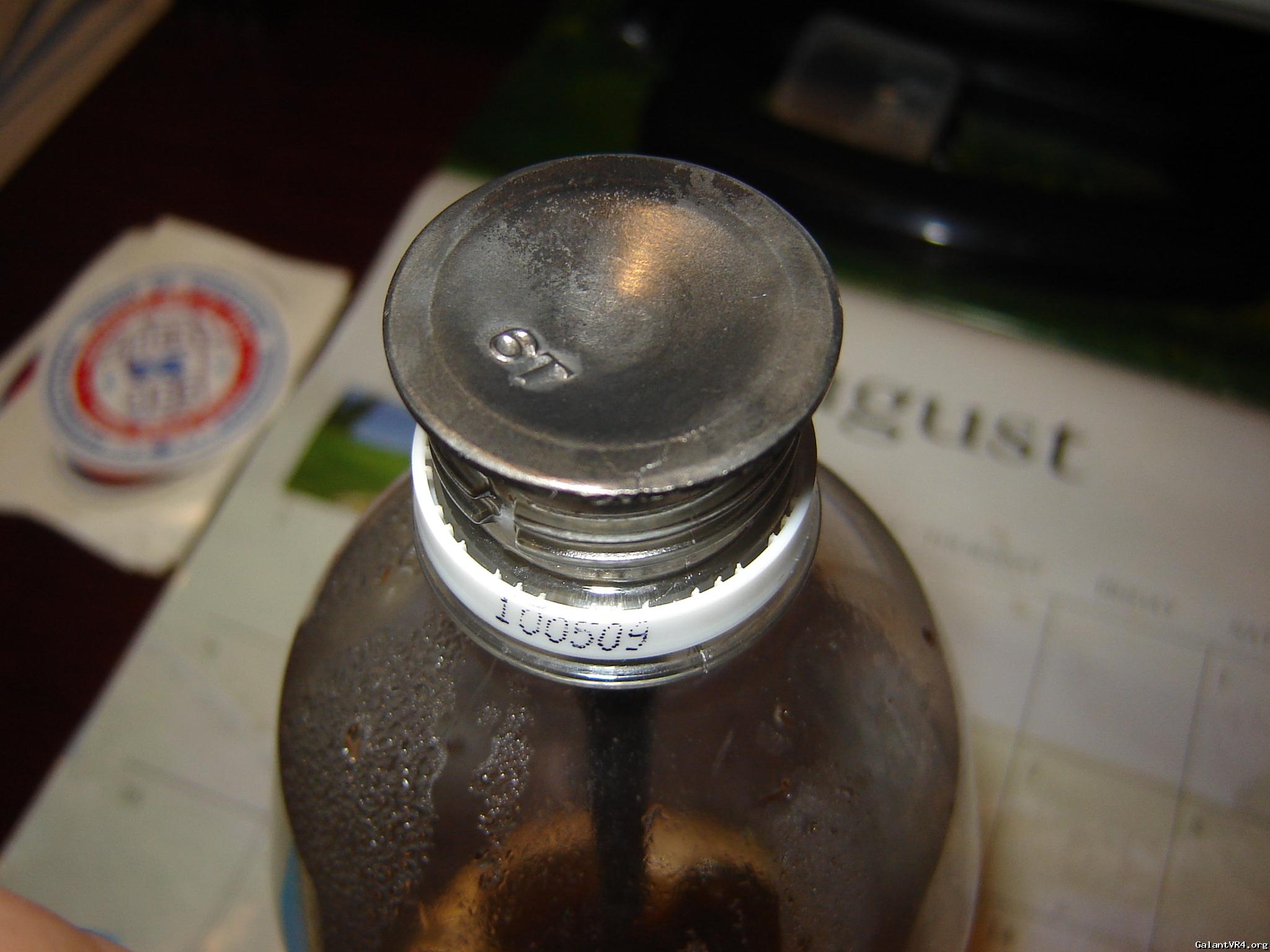

My camera dosent take the best pictures up close, but if you zoom in on these, you can see it well enough.
On the last picture, you can see that the valve had started to burn. I would say that the head hadnt been run very long with this valve, or it would indeed look like the one in my head.
