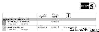

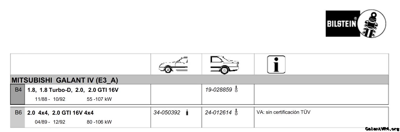

Part Number: 24-012614
Old Part Number: F4-B46-1261-H0
Looks like rear only for what ever reason.
Edit: I got a part number for the front ! BILSTEIN 34-050392
I just cant find a site selling it that's written in English?

What does the "IV" refer to? I hope they just got the numerals the wrong way round since the other details 'seem' accurate. If you get any confirmation on this please post up. I really don't have the fabrication skills to attempt something on this level myself, but I'd like to build some front struts/coilovers with narrower coilover springs to give me room for the camber adjustment I need up front.
