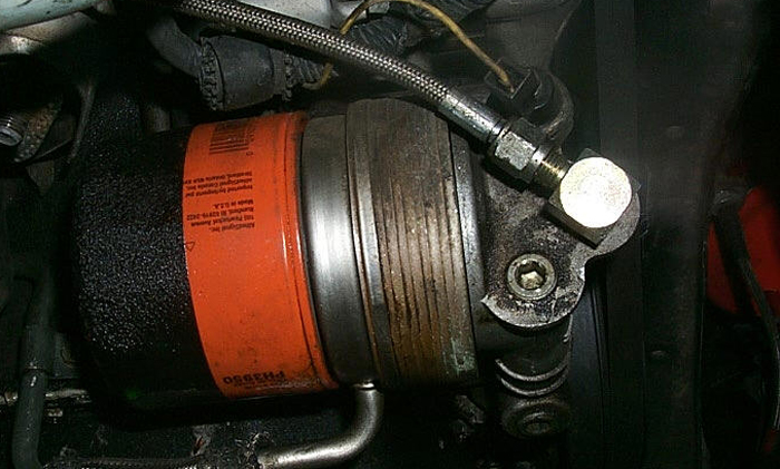

Here's a pic from RRE of the stock water cooled oil cooler. You should be able to use either the port where they have the extra oil line attached or the bottom plugged port (the bottom one is unfiltered). Not sure though whether they're 1/8" or 3/8". Most aftermarket pressure senders are 1/8 NPST. It seems from other posts that the stock 1/8" ports are BSPT which has 1 thread difference per inch. You can find BSPT to NPST adapters at www.mcmaster.com (it's amazing the things you can find there).

I have my 1/8"NPT sender tapped right into the 90 Oil filter housing on my Talon, been working for 15k with no problems, it has never come loose.
