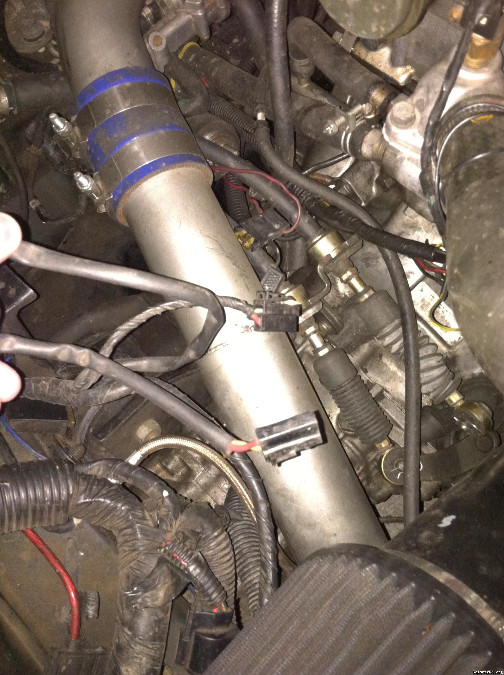

I'm trying to wire in an aftermarket 3 port valve to utilize the ECMLink ECU controlled boost. The stock BCS solenoid was thrown out a long time ago. I have 2 connections in the same vicinity and am having a tough time figuring out which connection to use, here is a photo I just took.
I have the 2 plugs in question in front of the UICP. They both come from the same part of the harness, one has a shorter set of wires taped together, the other wires are a good amount longer which kind of snake around in the picture in a sleeve.
Which connection is for the factory BCS?
Barnes
Feb 9, 2003
6,249
Richland, WA
Can you manually trigger the fuel pressure solenoid with the ECMlink like you can on a stock ECU with a logger? That's one way to tell. Plug in a solenoid, use the logger to turn the FP solenoid on, and check which one clicked.
4thStroke
Oct 22, 2007
1,864
Vancouver, WA
I didn't realize the other was for the FPS.
I was able to plug in the solenoid and power the BCS itself. It was the longer set of wires, for future reference.
