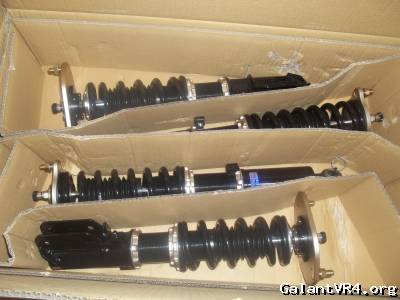

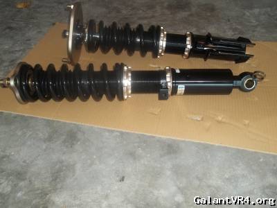

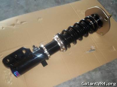

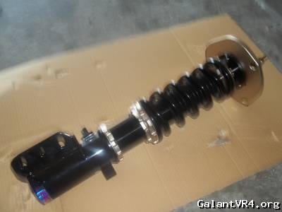

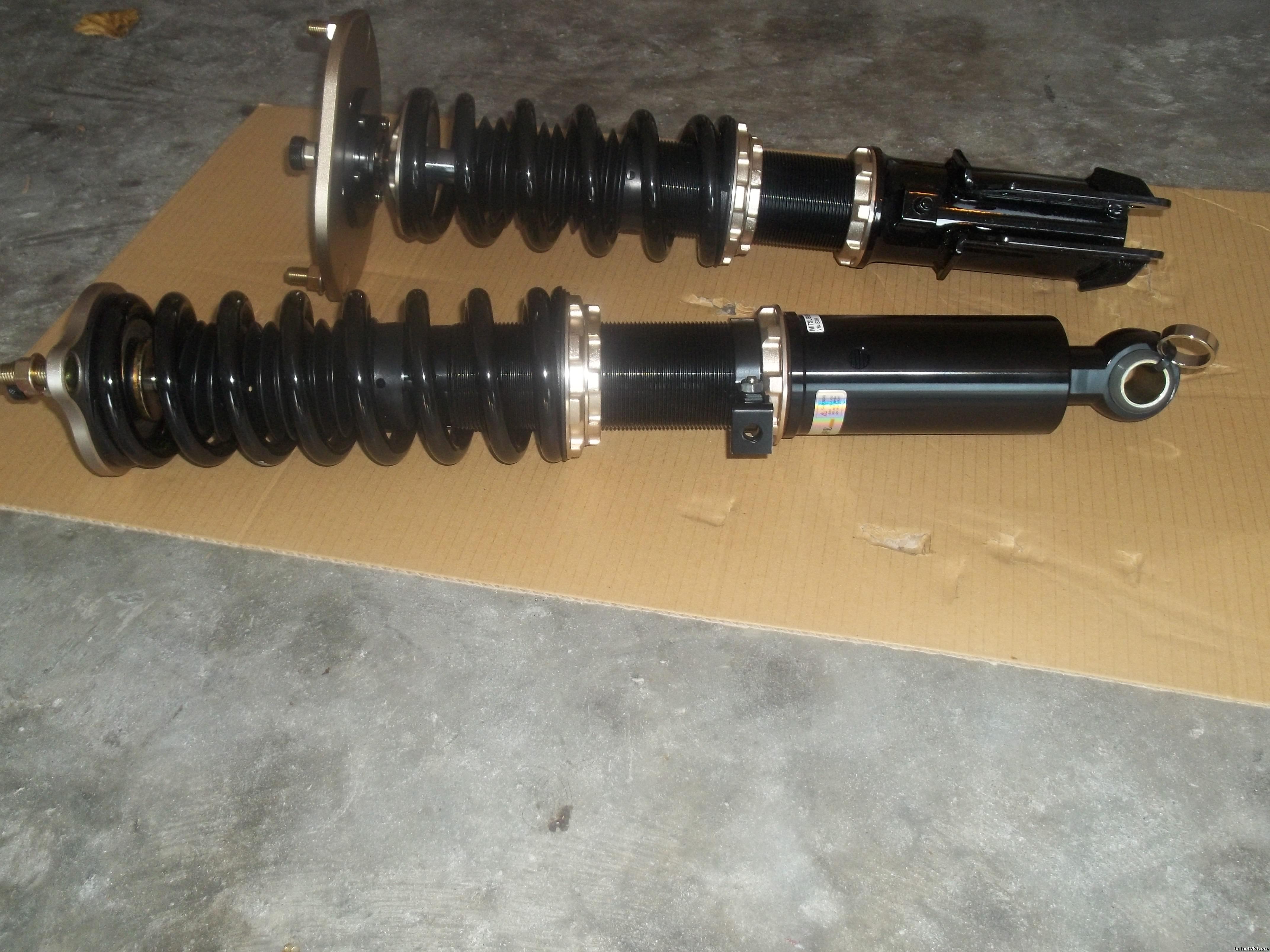

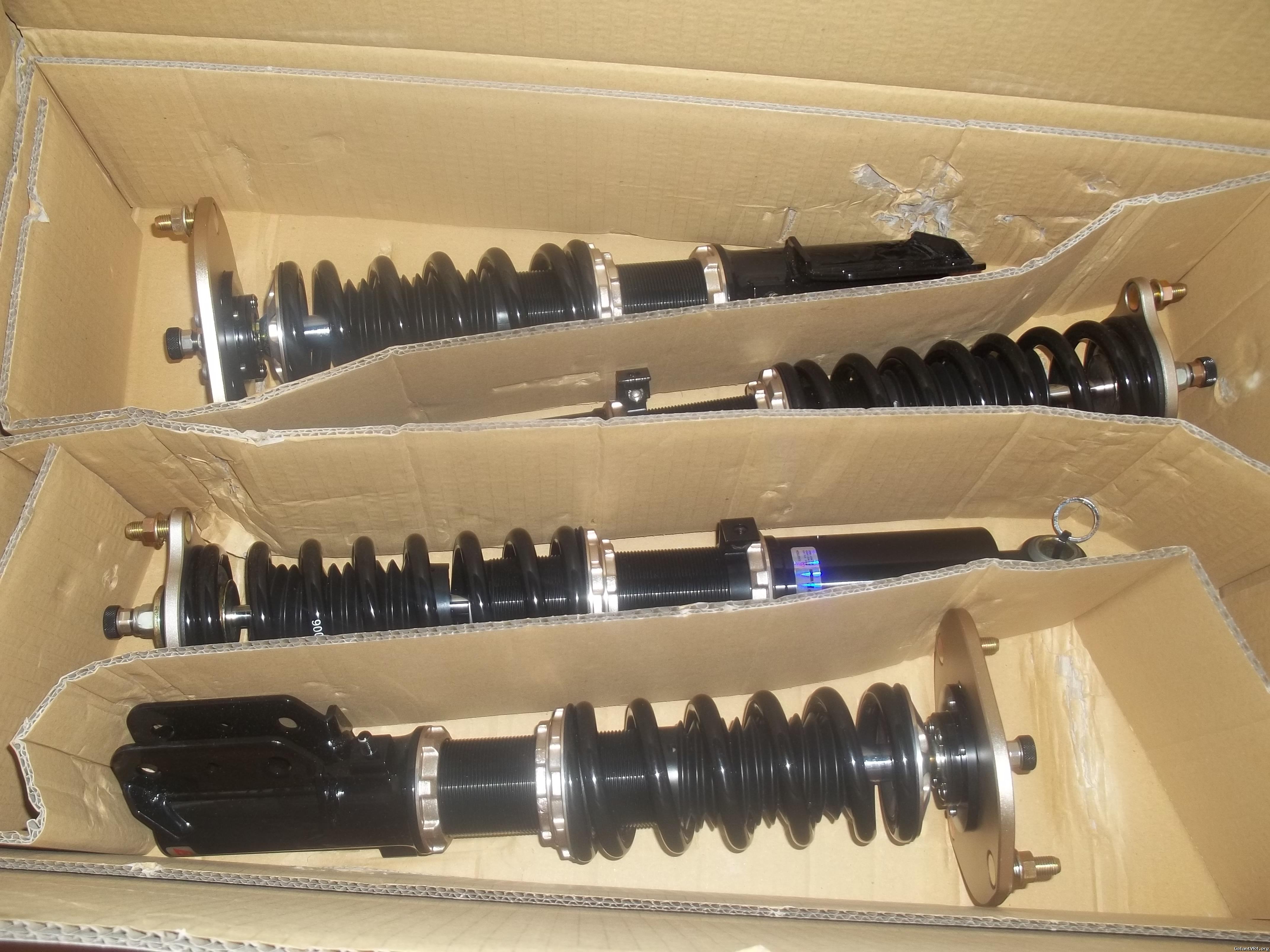

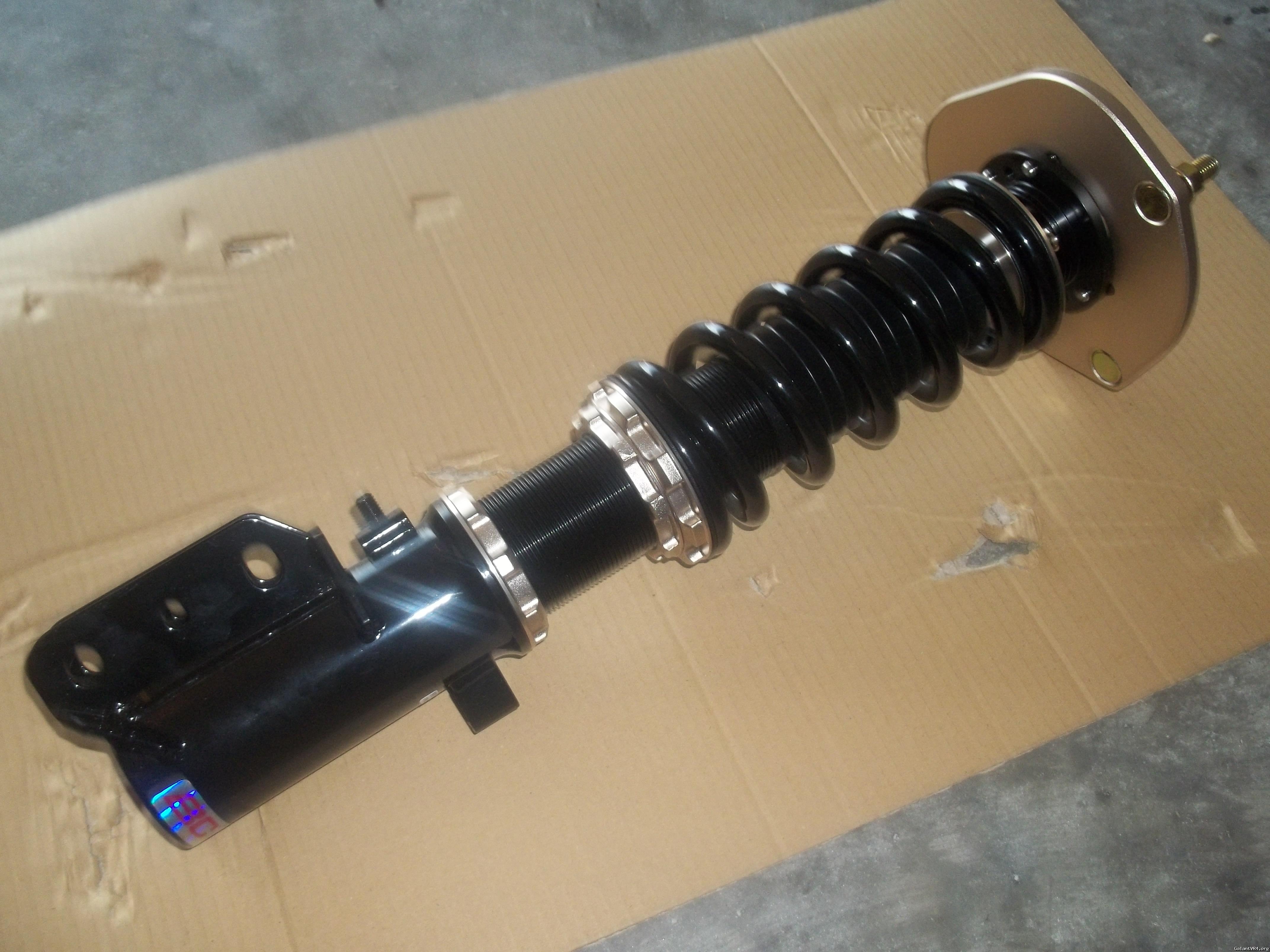

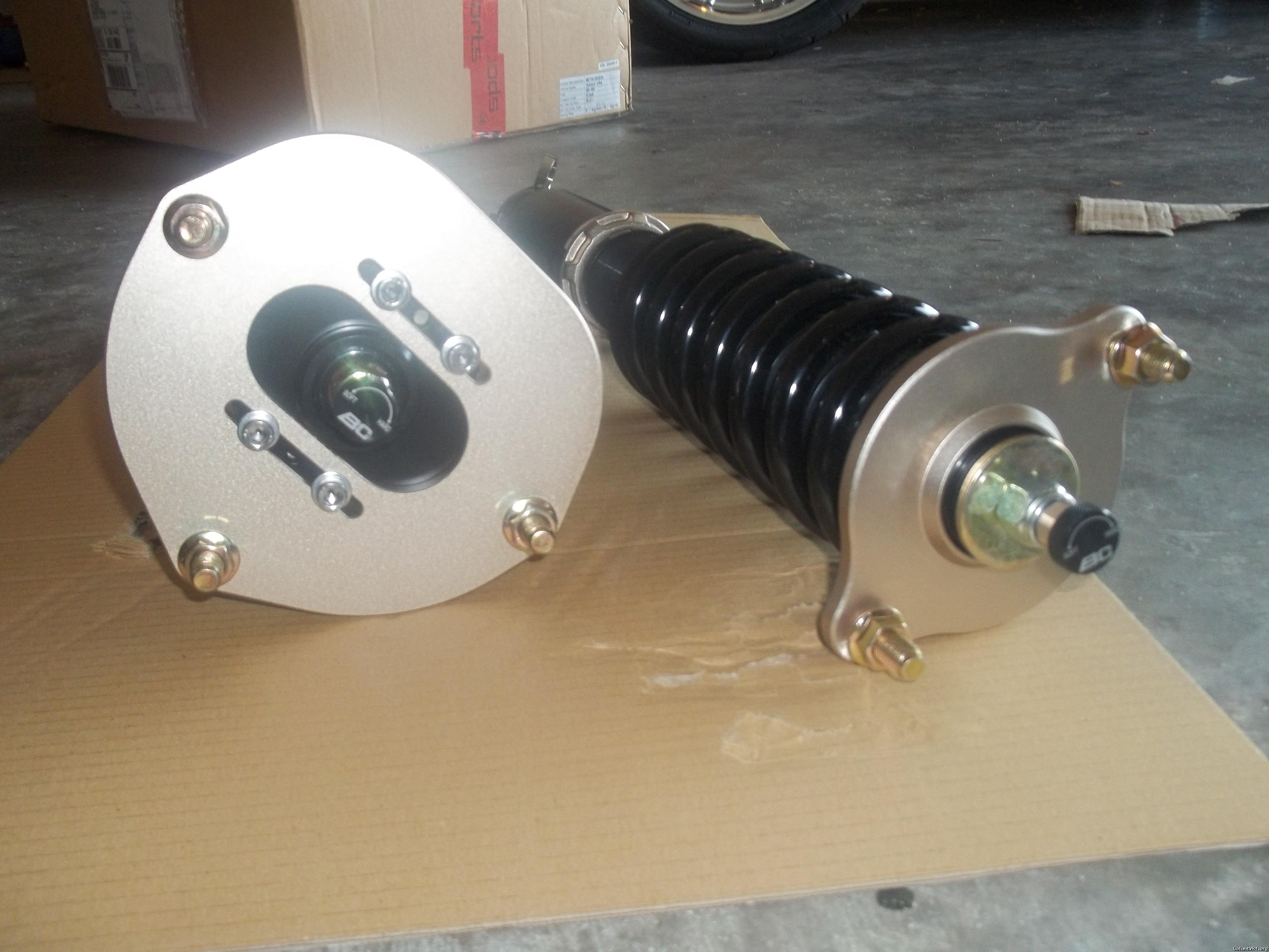

I purchased a set from Garfield and I am very pleased at the quality of construction. All bolts /studs and brackets for both the brake and abs lines are in the right locations to make these an easy bolt on affair. Also comes with dust boots to protect the shock shaft. Here are some pics.

Are there markings on the camber plates up front? Hard to tell from the pic?
Are these re-buildable? If, so is it in the USA?
Are spring rates upgradable? What is the warranty for upgrading springs. Megan allows to upgrade upto + 2K in front and rear and warranty remains.
Any shock dyno information provided with coilovers? Fortune-Auto makes coilovers and they provide shock dyno figures...

Yes there are markings engraved , lighting was way to bright for pics. . BC USA is located right in the Orlando area about 20 mins from my house Replacement inserts from what I understand run $95 to 125 and yes springs rates are upgradable. You would probably need to contact BC USA for specific shock dyno figures.

BC is a better quality product over Megan & KSport. As a result the price is a little higher. The nice thing is that all the mounting points are there for the brake lines & ABS (for those that still have it) so that's a big plus. I don't think KSport comes with the mounting points & I'm not sure about Megan's. You can order custom spring rates but I'm not sure how that affects the warranty, I'll have to double check.

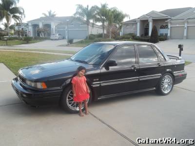

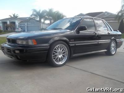

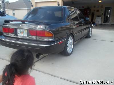

Installed coilovers and new wheels and tires today car now rides firm, not harsh at all . I will beat on it tomorrow and see how it performs
kickin myself self for not going the extra mile to get these. went with kyb gr2's and custom made springs, hope my car sits that pretty. of course the ride is what counts.

Ok here is the full review as for now .As for installation On the rears I had to flip the brake line brackets and run the brake lines behind the coilover due to it being wider in diameter. The Fronts were an easy bolt on with brake lines in stock location but the bolt for the abs line on one side was a tad to low about 2mm no problem just enlarge the hole in the bracket The other side bolted on no problem. Now the fun part I drove about 15 miles and I am honestly impressed no floating or bouncing, car does not nose dive during hard braking, really stable in corners and very little leaning in extremely tight turns ,firm and composed on rough broken pavement. The car feels like a modern sports car, very tight. This review is subjective as I have not tried other coilovers some may like them some may not but I am extremely pleased ,I think I shall go for another drive, I need to test them on some brick streets. Only time will tell how they hold up as the miles rack up . I will post pics on install over the weekend.
