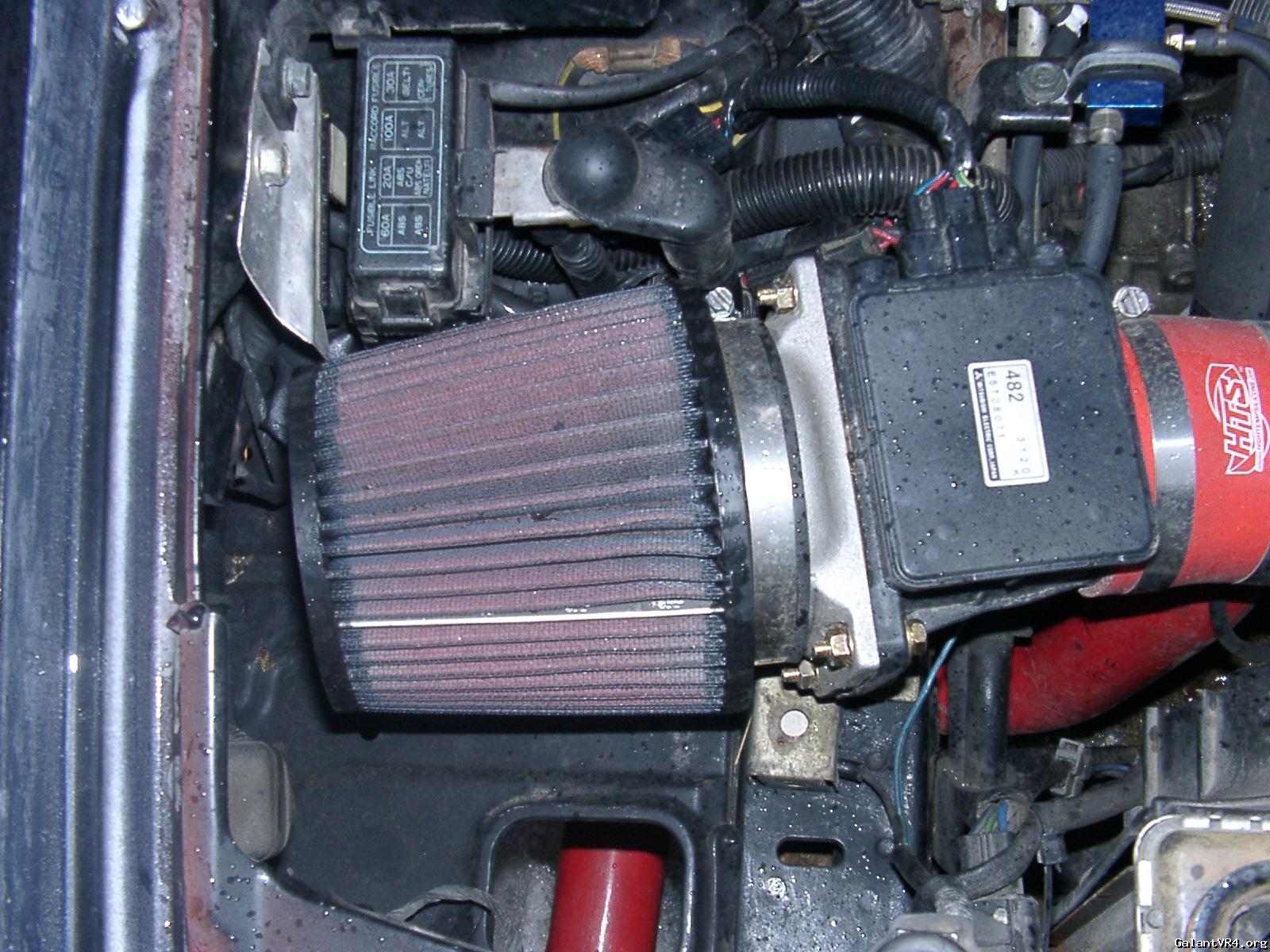

I made a little bracket to hold that fuse box next to the larger fuse box. Maybe can't see the details, but here it is.
