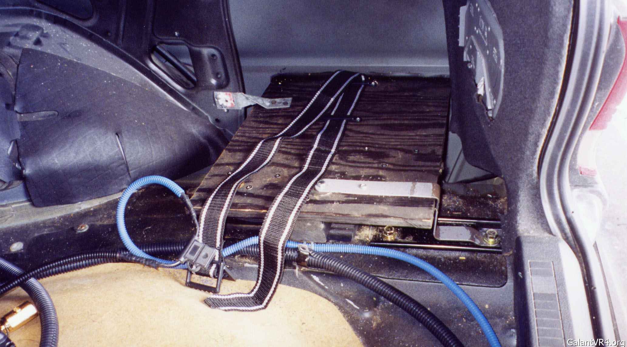

Mounting platform tucked back to the fender wall. Lots of screws, bolts and wood.

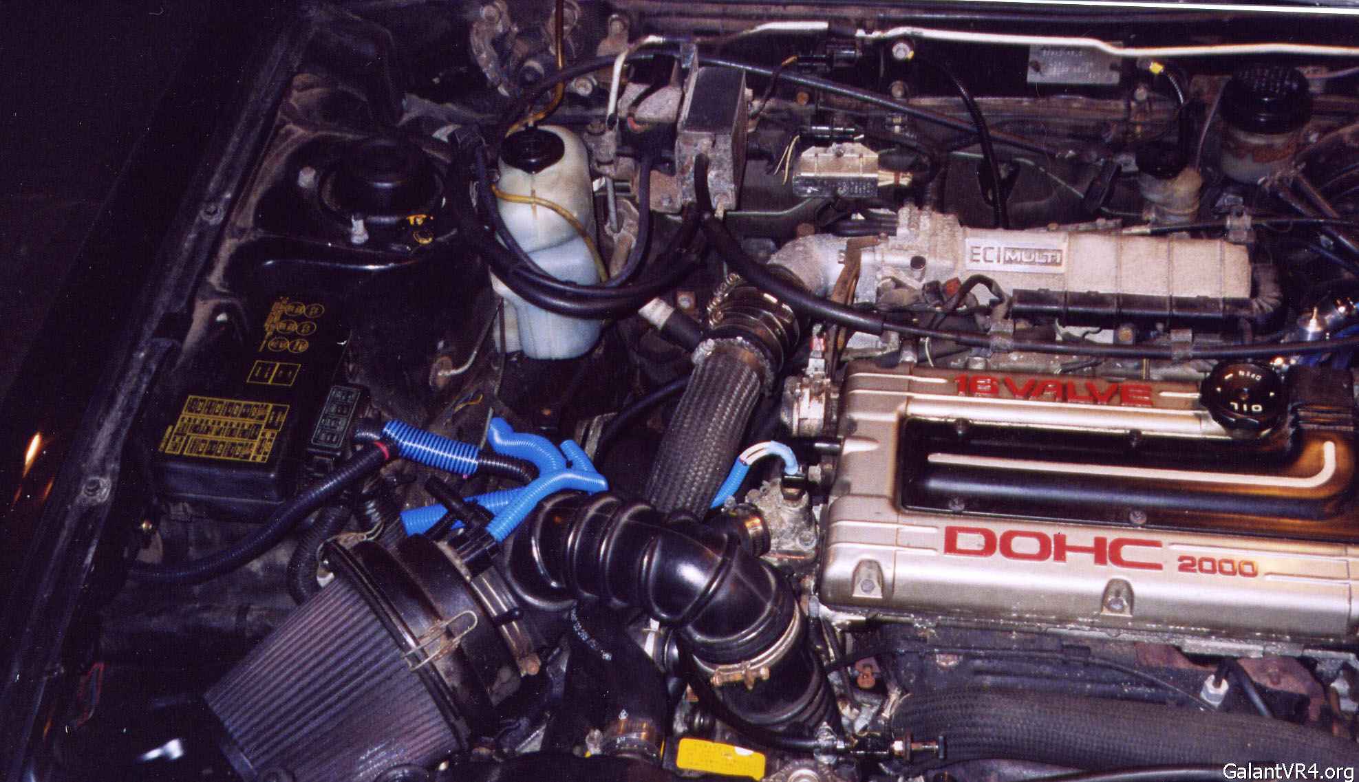

underhood wiring and some fresh paint. Ignore the MAFT, I decided to wait for my upgrade chip and may wire it in-cabin.

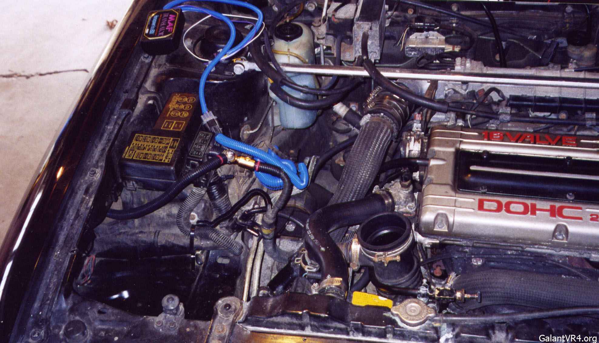

Put together in a semi-stock configuration. (Note the rewire on the coolant temp sensor plug!)

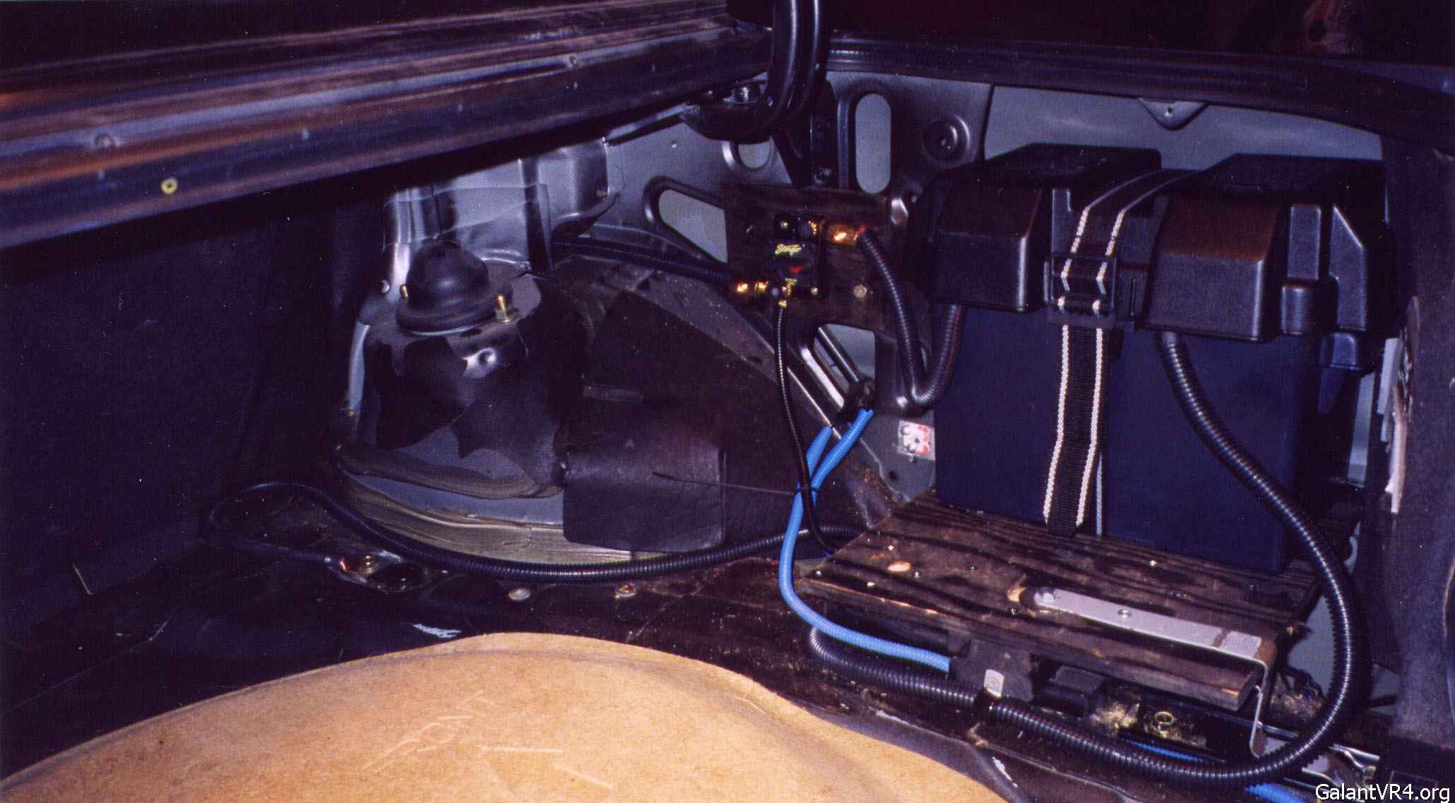

Circuit breaker mounted and ground attached, fuel pump wire attached, battery in box and strapped in.

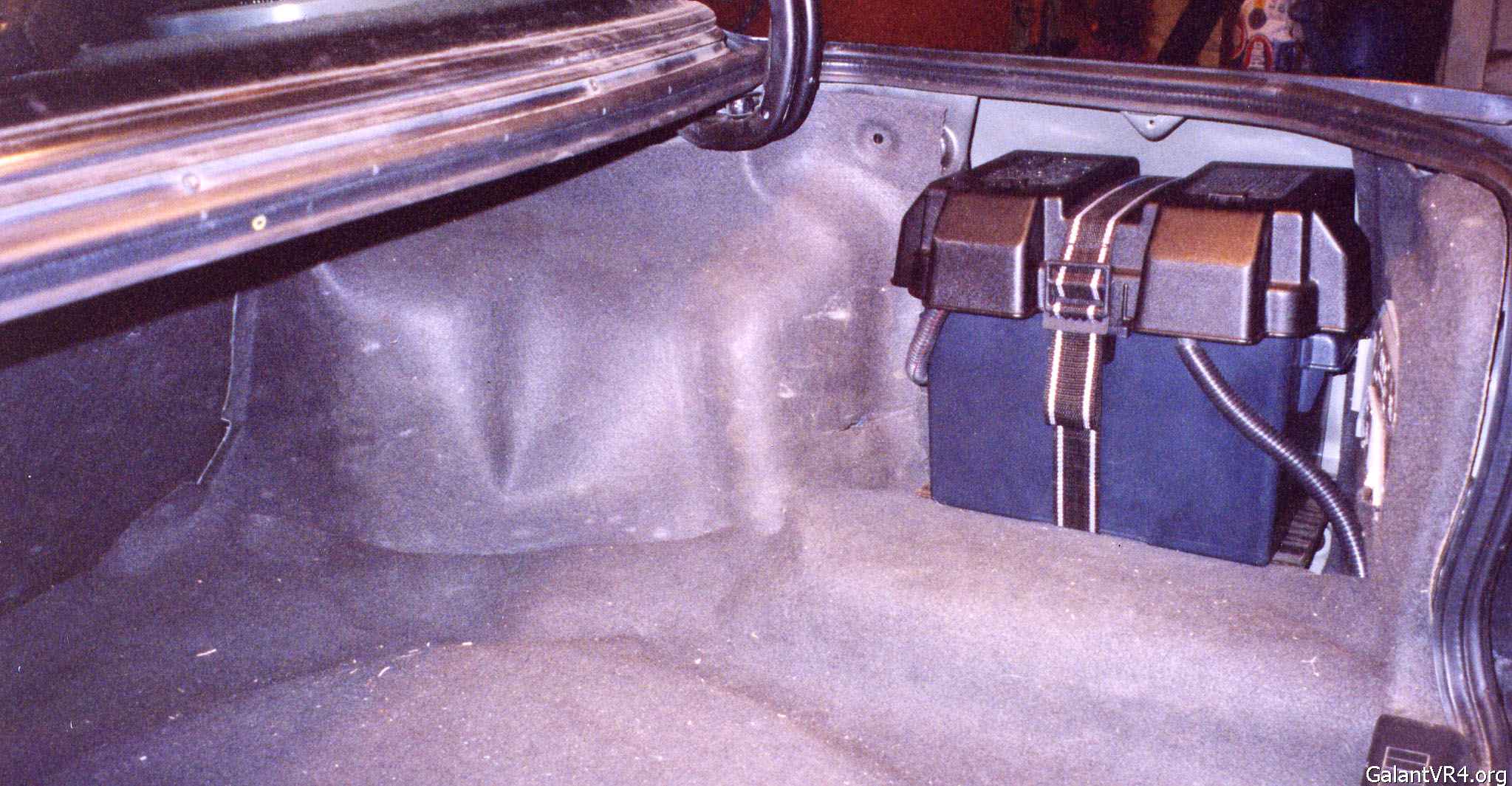

All tucked in, carpet and panel are held in place with velcro.
