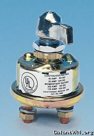

This is the switch I have, It's from summit. It's currently in the trunk, which you can see the problem because it is not outside the car.

That switch you have is just like the Moroso one I have. Go to jegs and get the push pull disconnect kit here

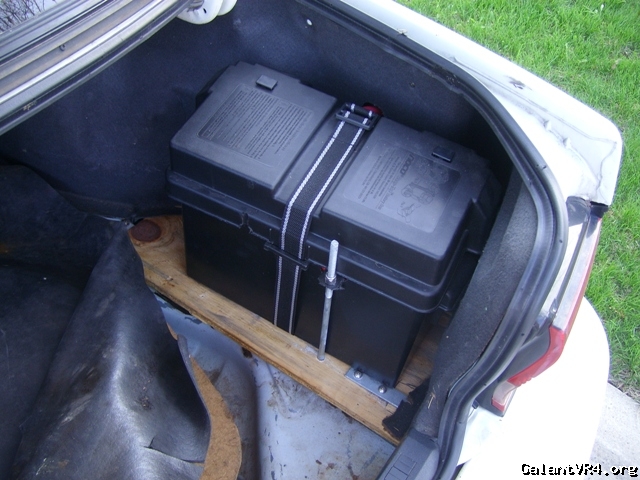

This is how my battery and switch are currently set up. I am thinking about the way things are set up and if all else fails I can just move it back to the engine bay. let me know what you think.

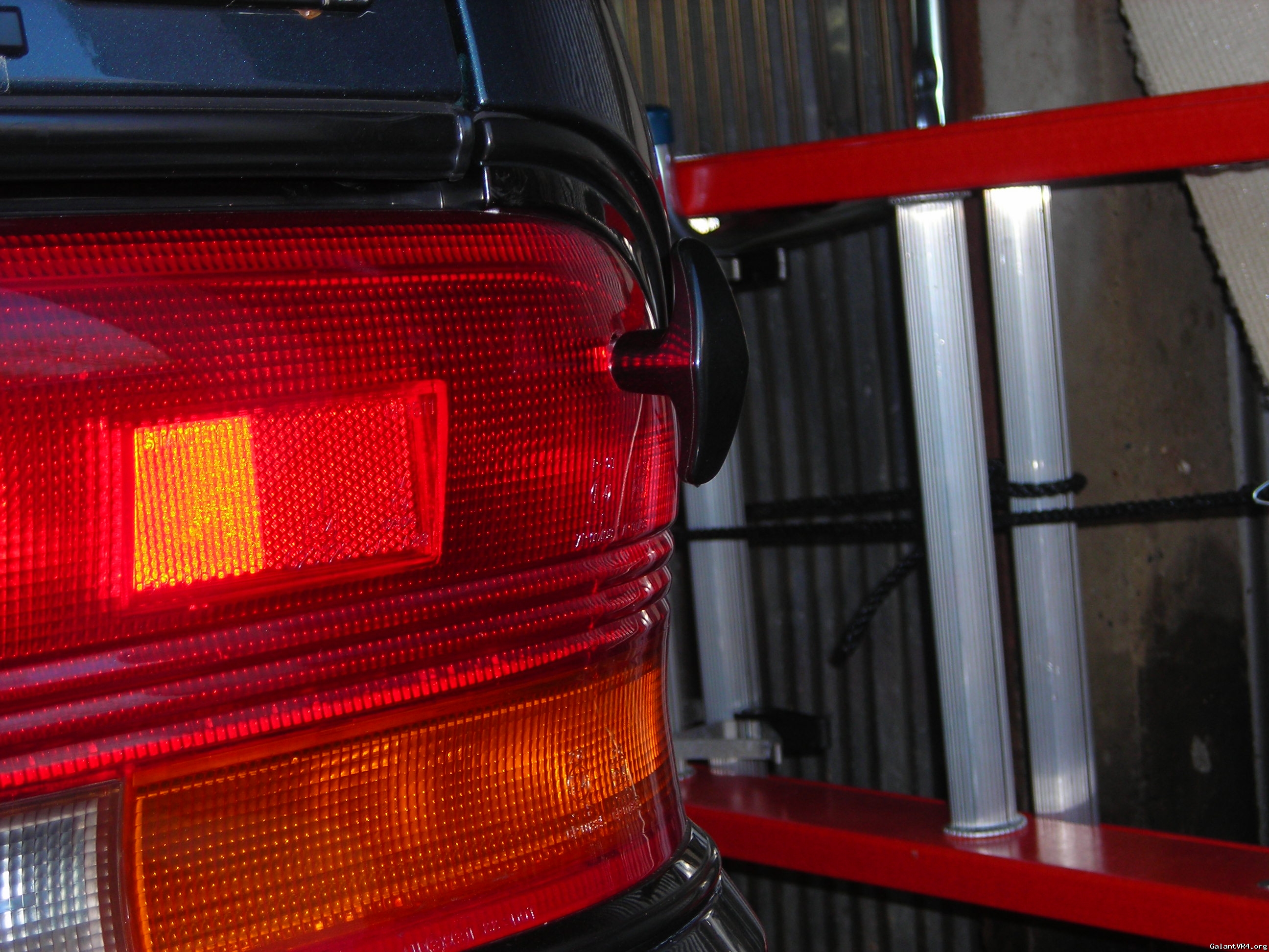

u can get the handle(like greensleves) by itself and use the switch you already have.its difficult to mount the switch u have on galant unless you drill rear bumper maybe.

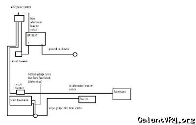

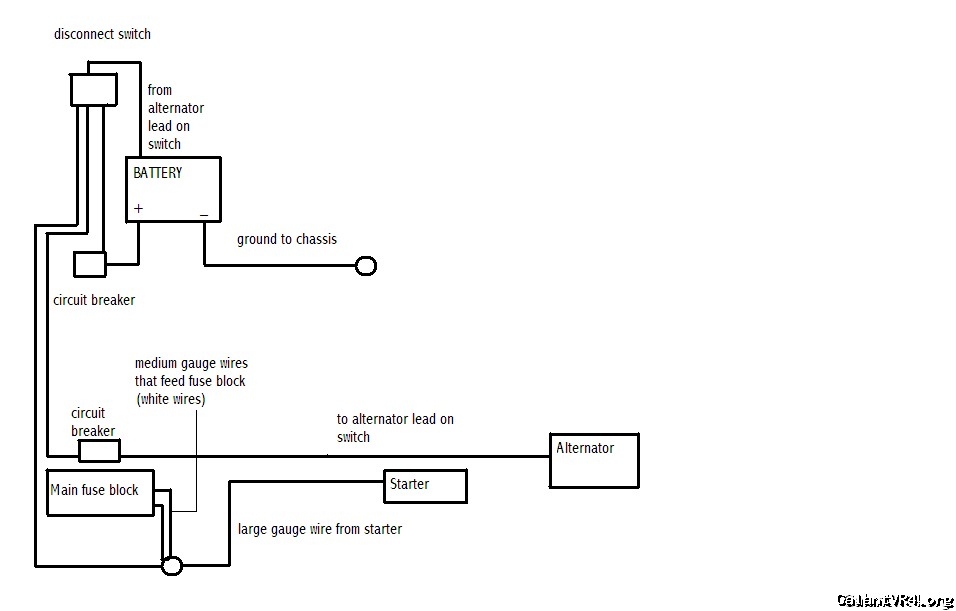

I got this diagram seaarching and found kcpaz made a thread on how he did his. I figured I'd post it here incase it could help anyone else.

do you have this in higher resolution, can't make out the words??
I have that above cutoff switch and looks like a kit is in order!
