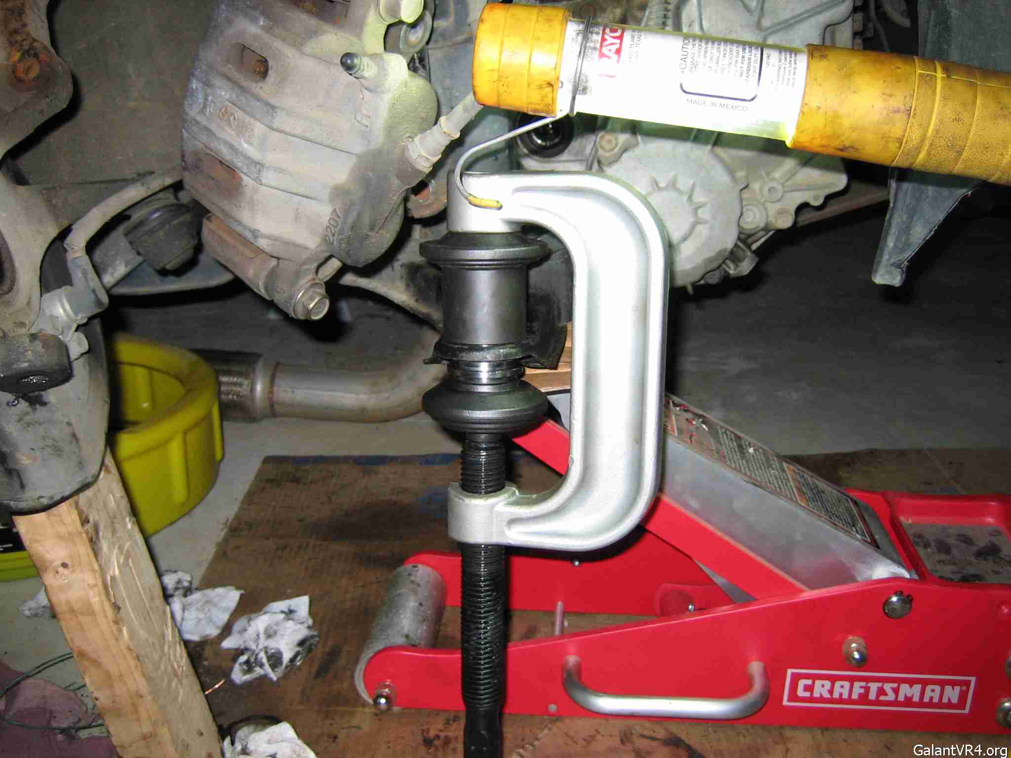

Then, after removing the lock ring, I worked with the ball joint press to push it out. The only problem was, none of the rings they give you really fit very well. I ended up rigging the press so that the shaft presses directly on the side of the top of the case, which initially pushed it out crooked. I backed off, then tried again by pushing on the other side of the top of the case. I used an impact wrench on 1/2 power to gently press it some more, but it would not budge. So I backed it out, and POP, the whole thing just flew out the bottom of the control arm. Score!

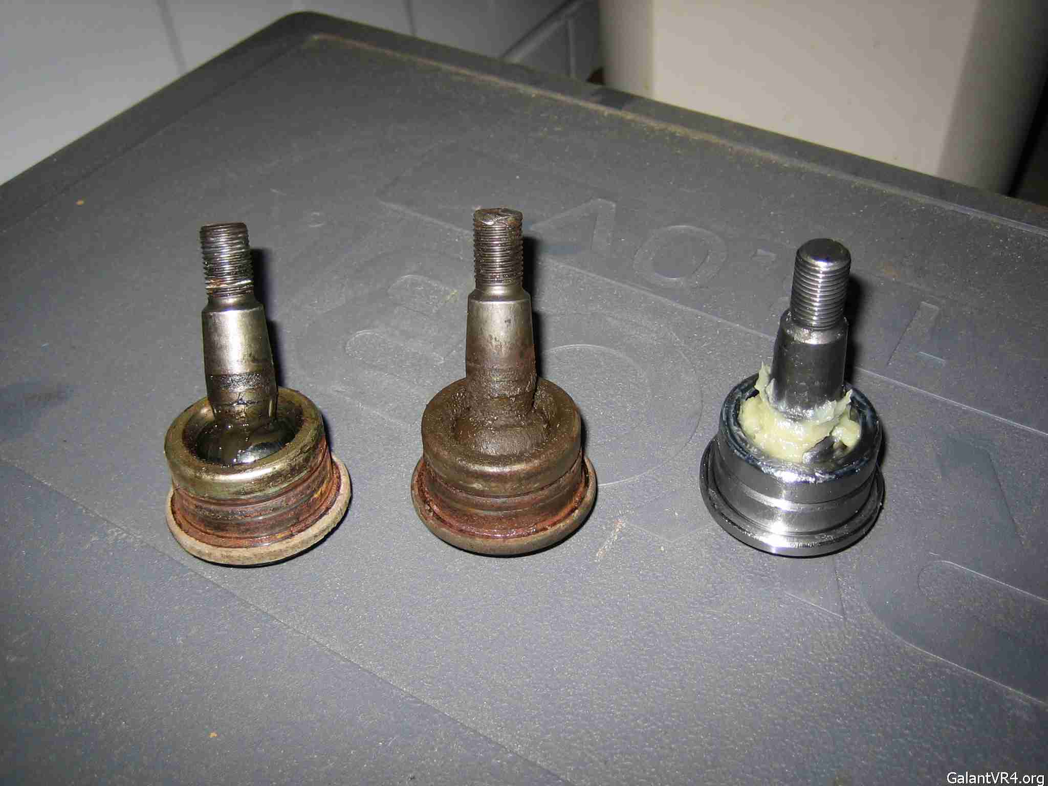

So one side is done. I'll post old/new pictures of the ball joints. The old one looks atrocious.

left to right: pass side, driver side, new
As you can see, the driver side is toast. Water somehow got in and replaced the grease with rust around the ball.
Just demonstrating the use of the ball joint press when installing a new one.

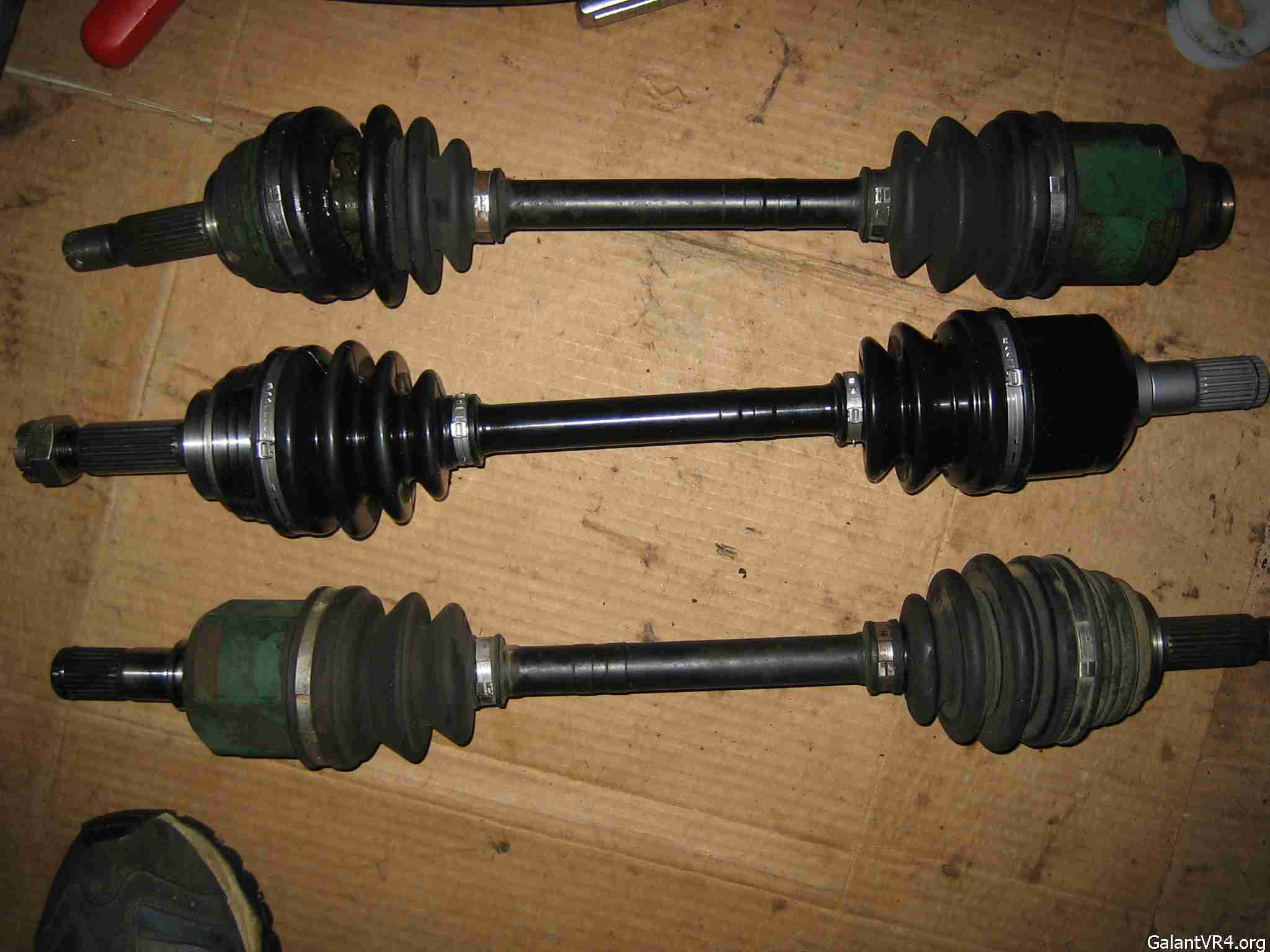

This is a familiar sight to many. Front axles being replaced with Raxles.

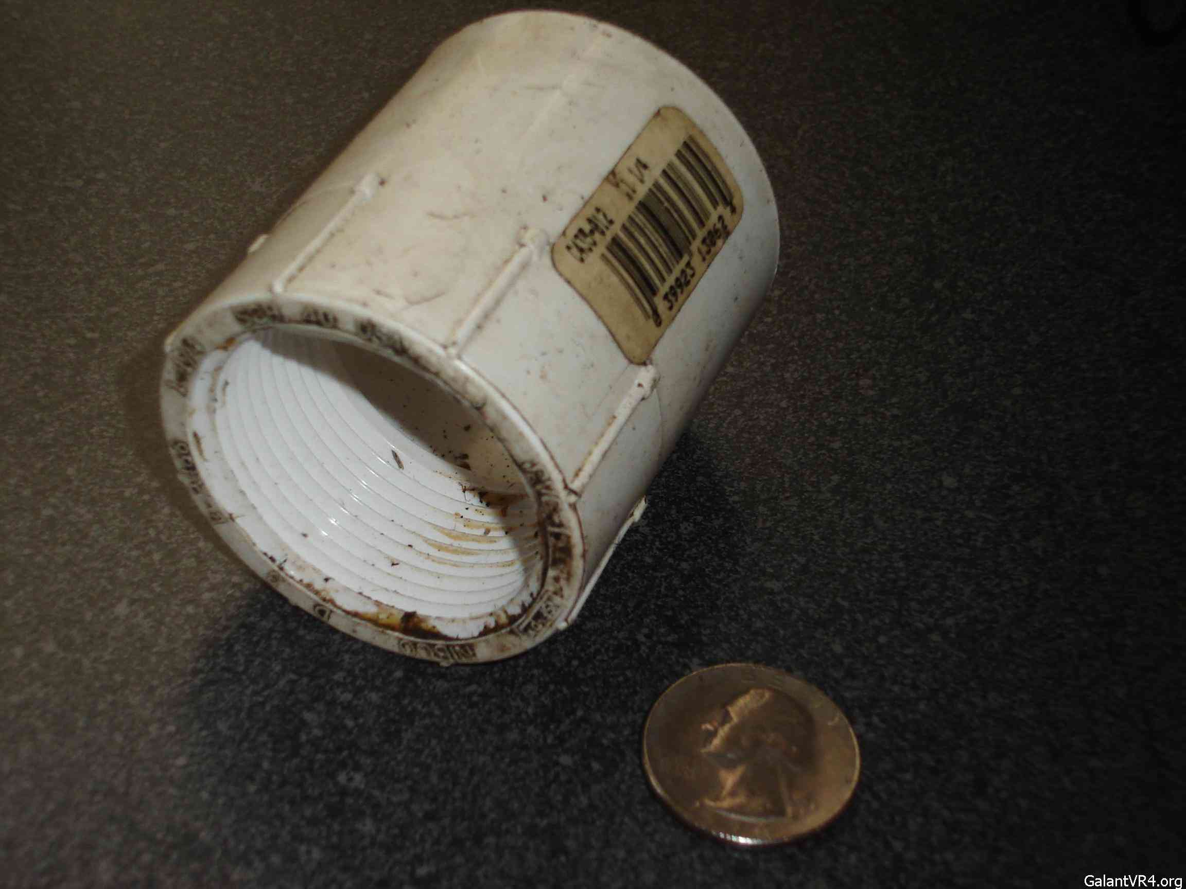

I used a plastic "cylinder" that I found at Home Depot. I think it was actually some sort of attachment for a whole house vacuum system. Just brought the dust boot to the store and looked around for sections of pipe that would just fit over the boot. I think it cost about a dollar and is made of hard, white plastic. Fit perfectly over the dust boot and I just hammered the top edge lightly until it was seated (don't forget to fill the boot with grease).
The cylinder is threaded on the inside on one end, smooth on the other. The label on it says "C435-012 1 1/4". Barcode 0 39923 13062

The ball joint press is what you want for the ball joint. I found that the rings they give you are not a perfect size for pressing the joint out of the arm, but however one fits well for pressing the joint into the arm. I found that when removing, use the ring that seems to fit best. Try pressing it anyway, even if it looks like it's going a little crooked. Then release, readjust so it's pressing on the other side of the joint to straighten it out. After doing this, it shot clean out the bottom of the arm.
