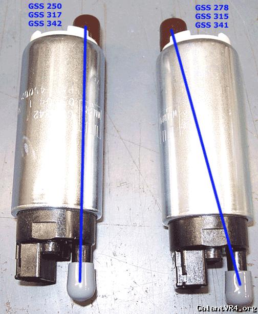

Now the task is to find a fuel pump. The car is completely stock and I'd rather not cut up the sending unit. Looking at pumps on RockAuto, it seems like a bunch of them are generic pumps and they send out hose clamps and hose and expect you to cut up the sending unit anyways. Does anyone have stock pictures of a VR4 sending unit vs. a DSM unit or 2g DSM unit? Or any experience buying a pump from any of the suppliers that bolted right in with the o-ring an all? I'm looking over this thread and recalling what I'm mentioning there, but I'd like pictures or other proof if there is any.
