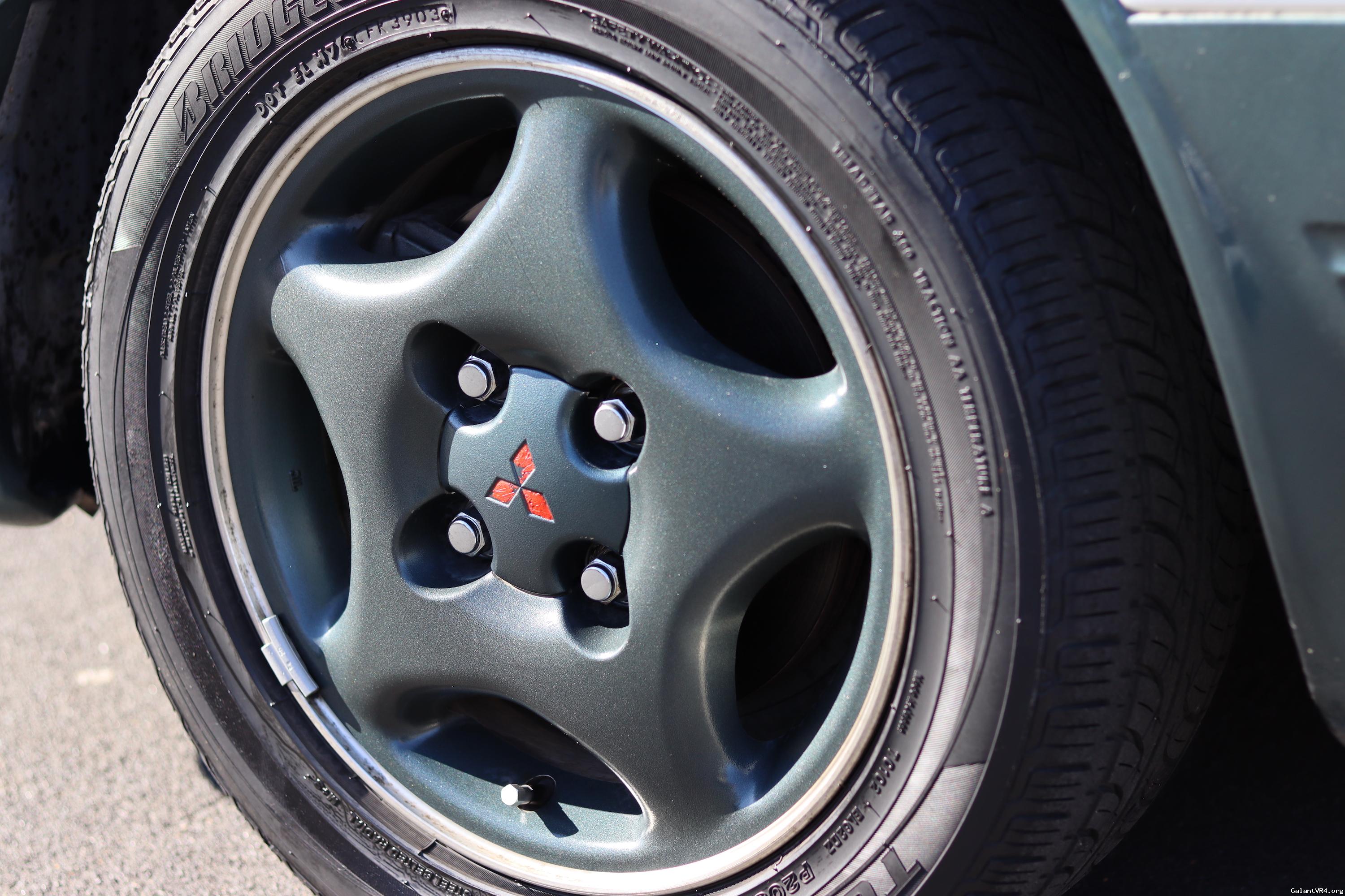

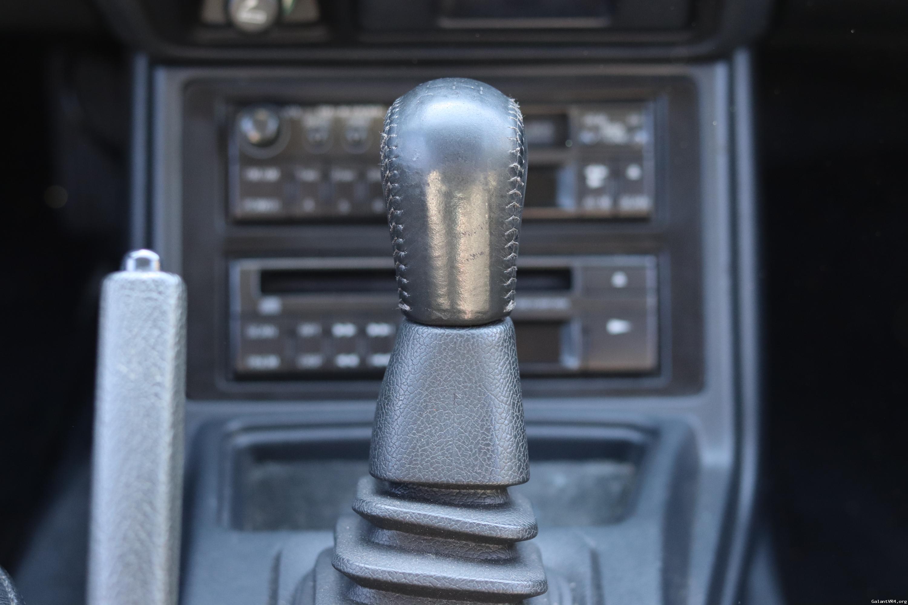

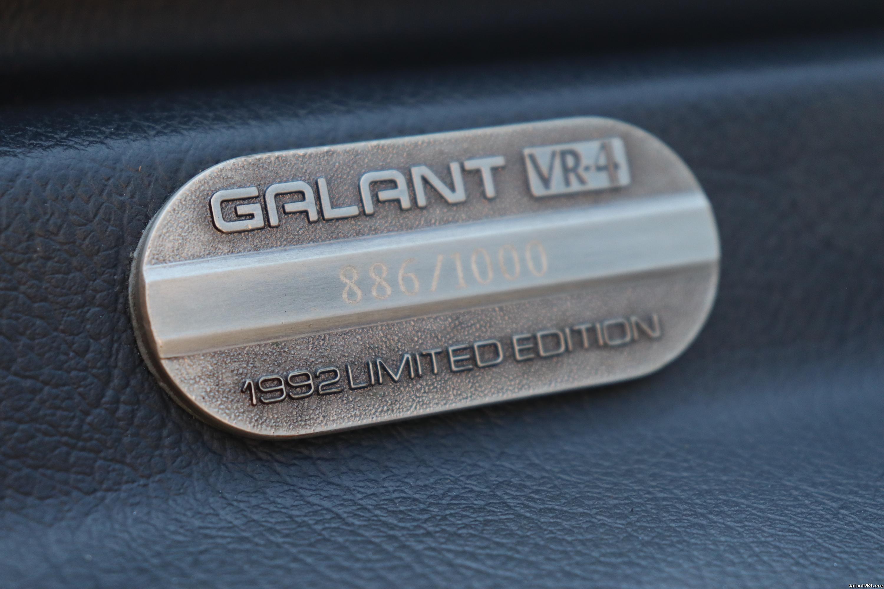

Hi again everyone,

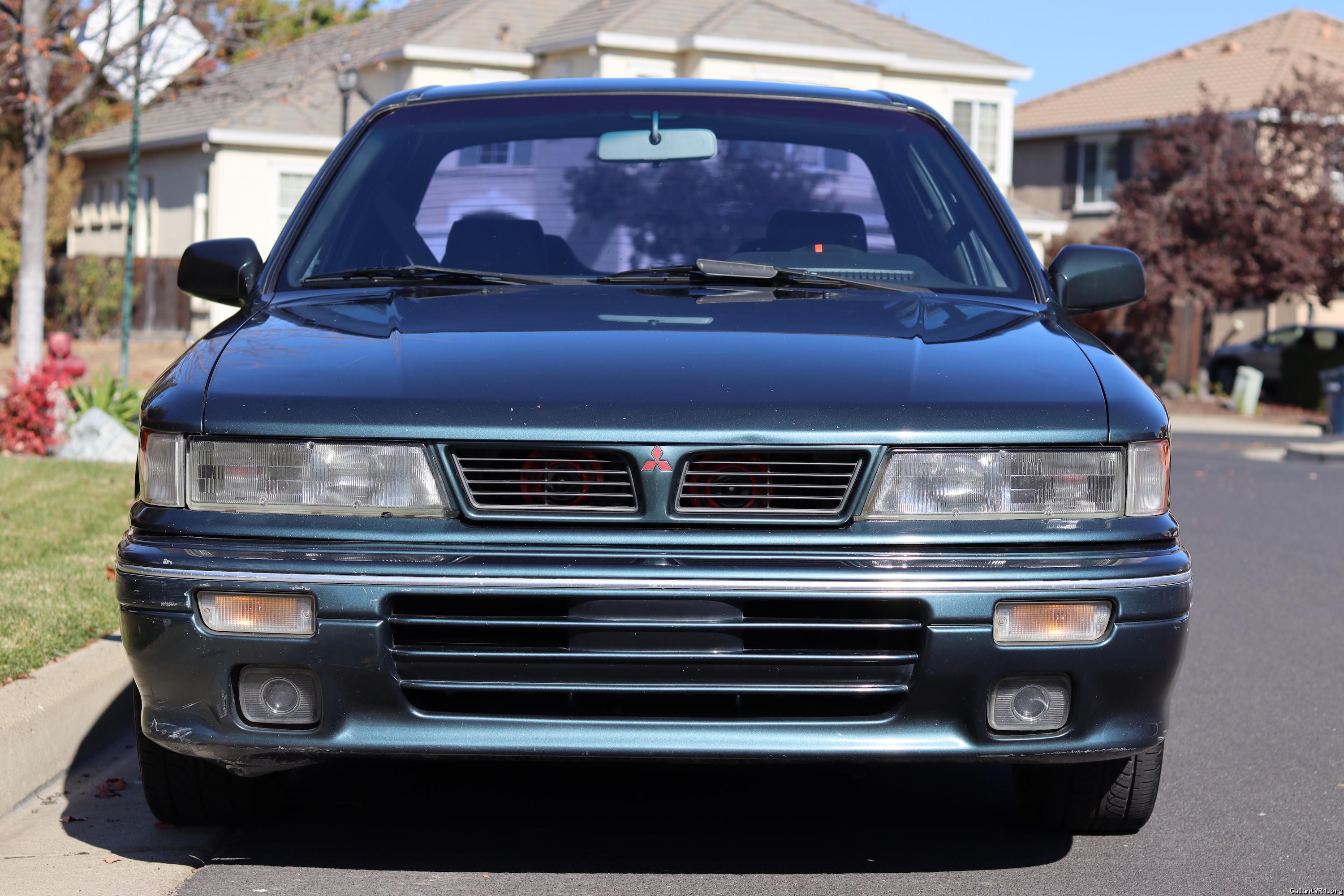

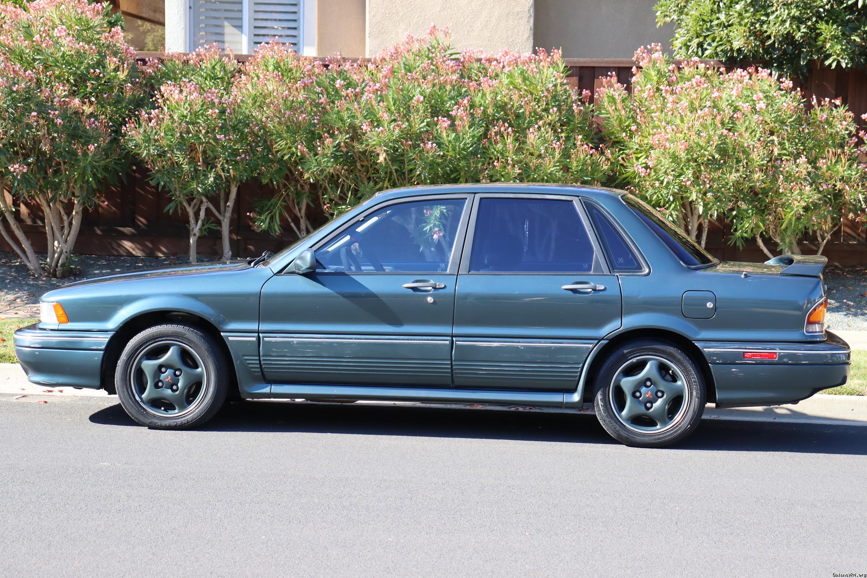

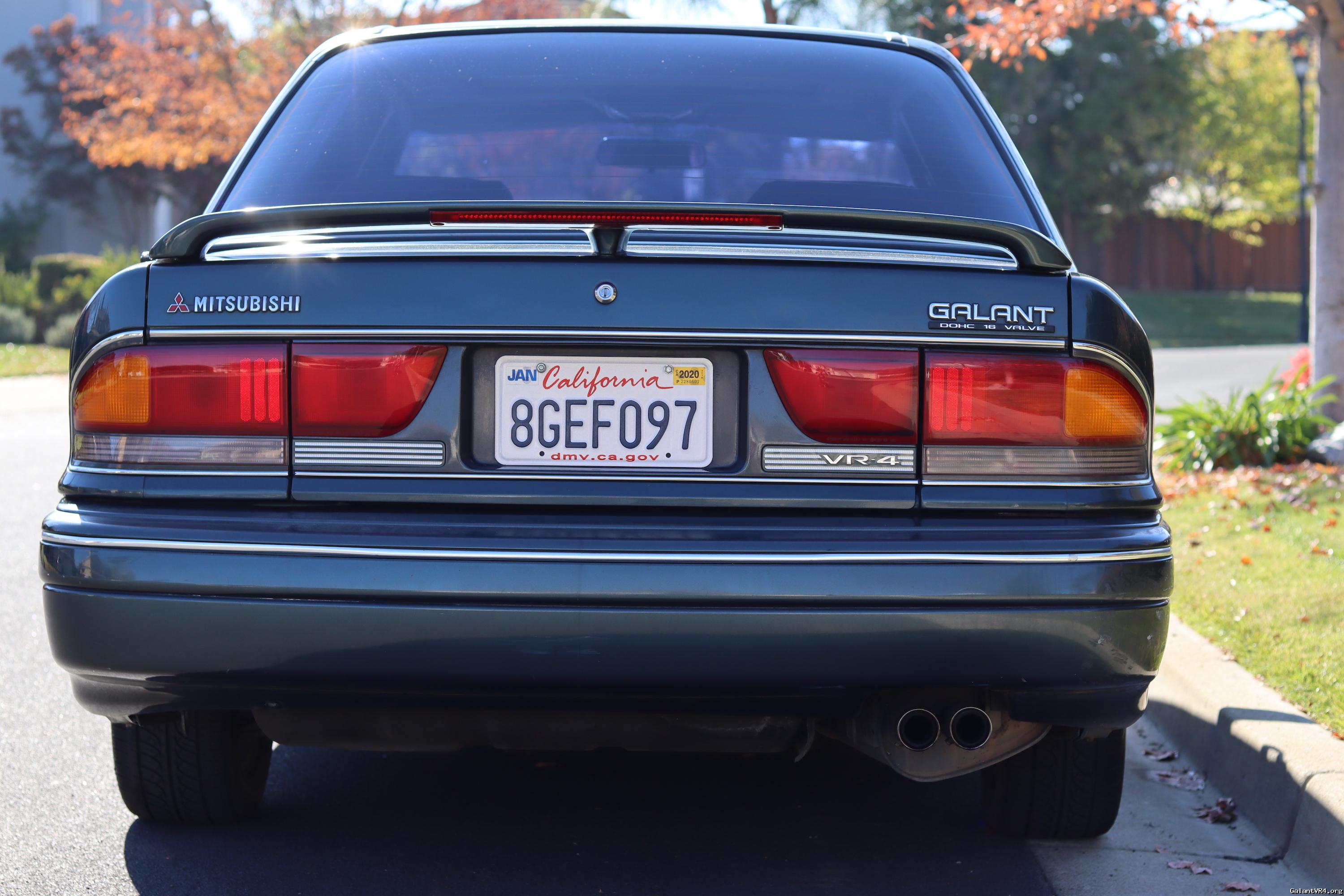

After selling my moderately modified 141/1000, I vowed to return with a more stock example. After months of searching I landed 886/1000, a Belize Green 1992 w/ sunroof option in absolutely stock factory condition. Not everything is perfect, but that's how I like them.
The Good:
-"Only" 158k miles
-Completely stock w/ dealership window sticker
-Drives wonderfully
The Bad:
-Every (and I mean every) body panel has some ding or deep scratch
-Competition clutch that is super chattery and way too stiff for a stock GVR-4
-Differed maintenance to the max and hunting idle
The plan is to restore the car back to its former glory and factory specs. Body work is going to be a major cost factor here. I plan to take care of all the maintenance...TB + WP, all seals, gaskets, etc. Super pumped to be back into a Galant VR-4 and can't wait to start wrenching on it.

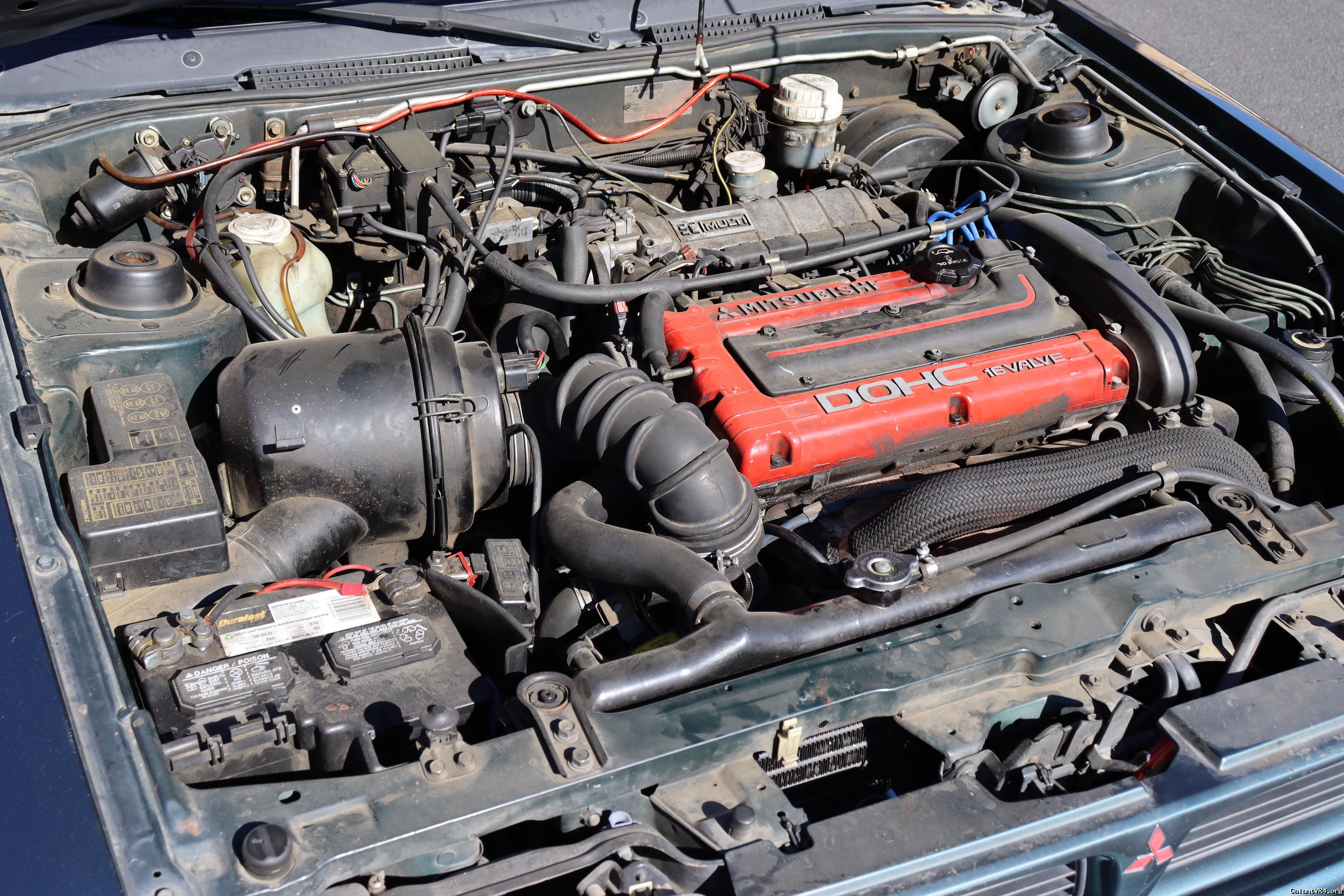

Finally got around to starting this project. The first objective was boost leaking the car to to see if a vacuum leak may be causing the idle surge. Sure enough the BISS was blowing bubbles like no one's business. Removed the screw to find no o-ring in place...hmmmmm...
Of course I then removed the entire throttle body to give it a solid cleaning....I have no self control.
Quick question, I'm aiming to keep this project a completely stock build. Does anyone know where to source a factory air filter? Is there another way to get a similar filter. I know all the sneaky ways to get a 2G MAF in there...so don't offer that idea...I know you guys too well. Just looking to stay stock.
