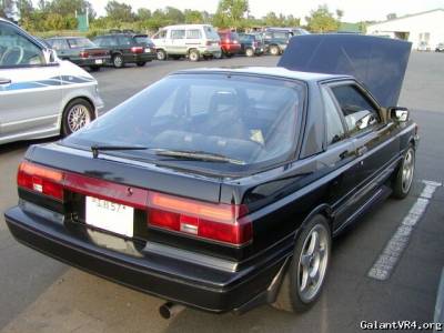

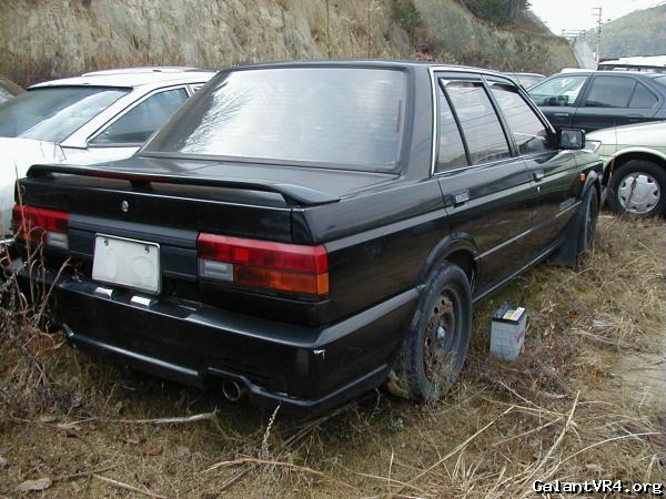

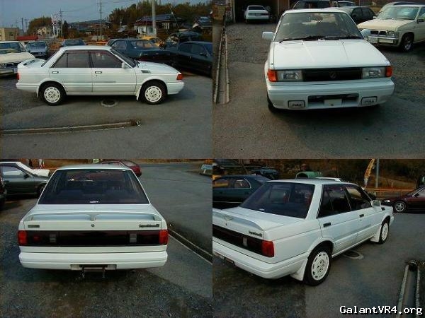

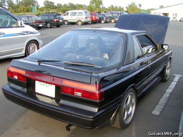

misterfixit
Aug 4, 2004
1,596
Midlands, UK
Like that, but the stanley (maker of sentra lights) ones are black. I always just go to the you pull and clip the wires out.
Either this:
this:
or this:
I think they are used on pretty much all nissans. Best to take your corner light with you..
