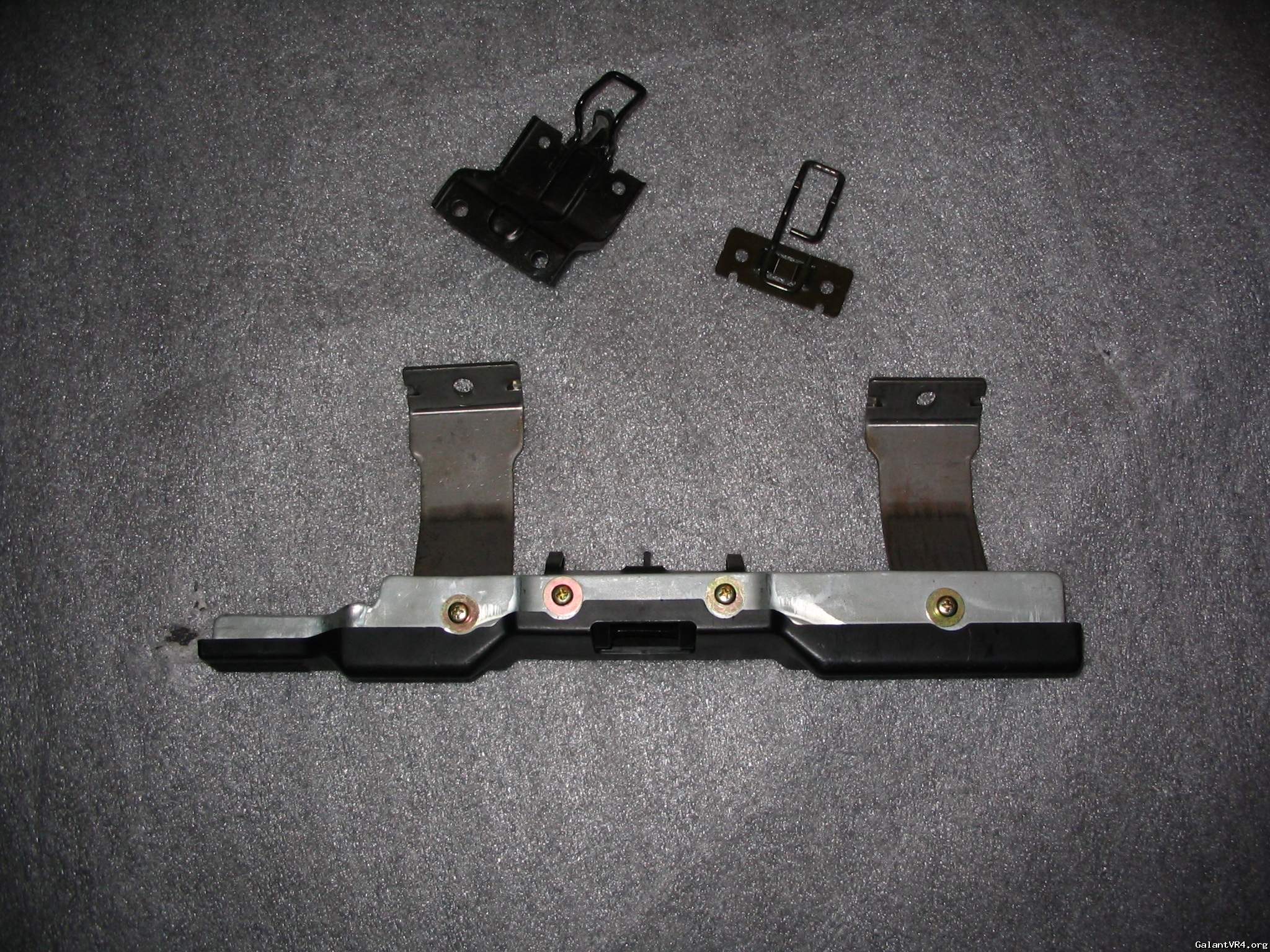

In the above pic, the stock dashboard-side latch and bracket is on the bottom, and on the top are two of the brackets that I hoped would fit but didn't (they fit the '89 latch sort of ok, but not the dash at all).

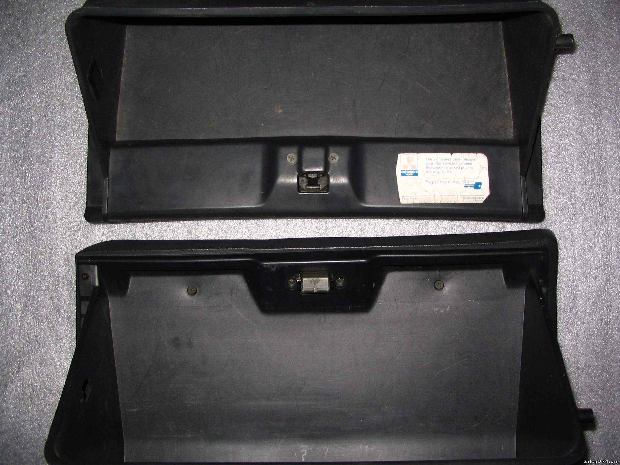

In the above pic, the '89 glove box is on the top and the stock 'box is on the bottom. You can see that the stock 'box's latch goes into the dashboard half, whereas on the '89 the dashboard half goes into the glovebox.
It's quite a bit lighter, on the order of several pounds, and it also frees up about 1.5" of leg room.

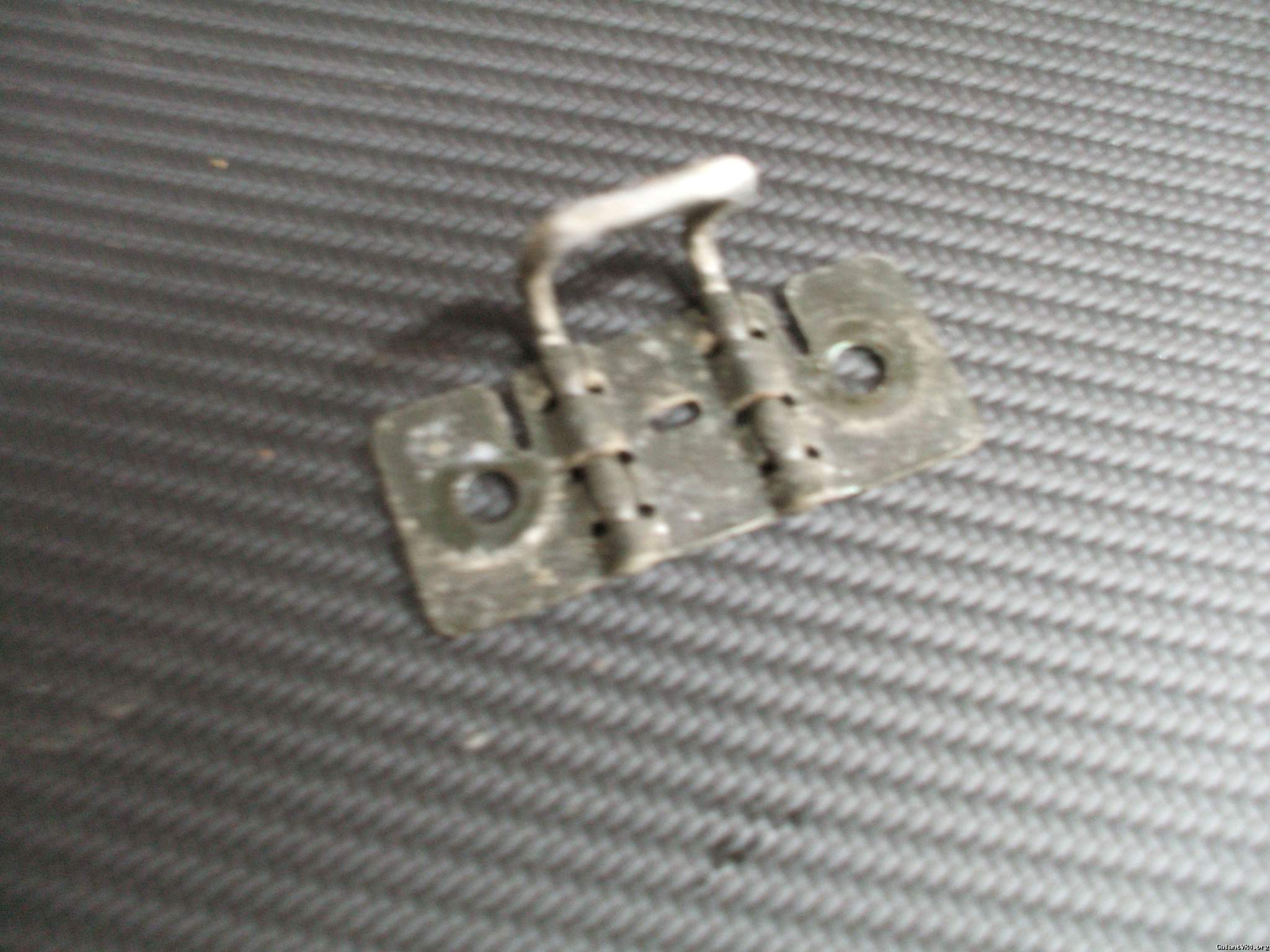

I have one with latch going on ebay and yes it happened to me also. Forgot it in the yard. I'll get you a picture later today. It would be easy to make its just a flat piece of metal with the ring. all the stuff inside the factory dash comes off.

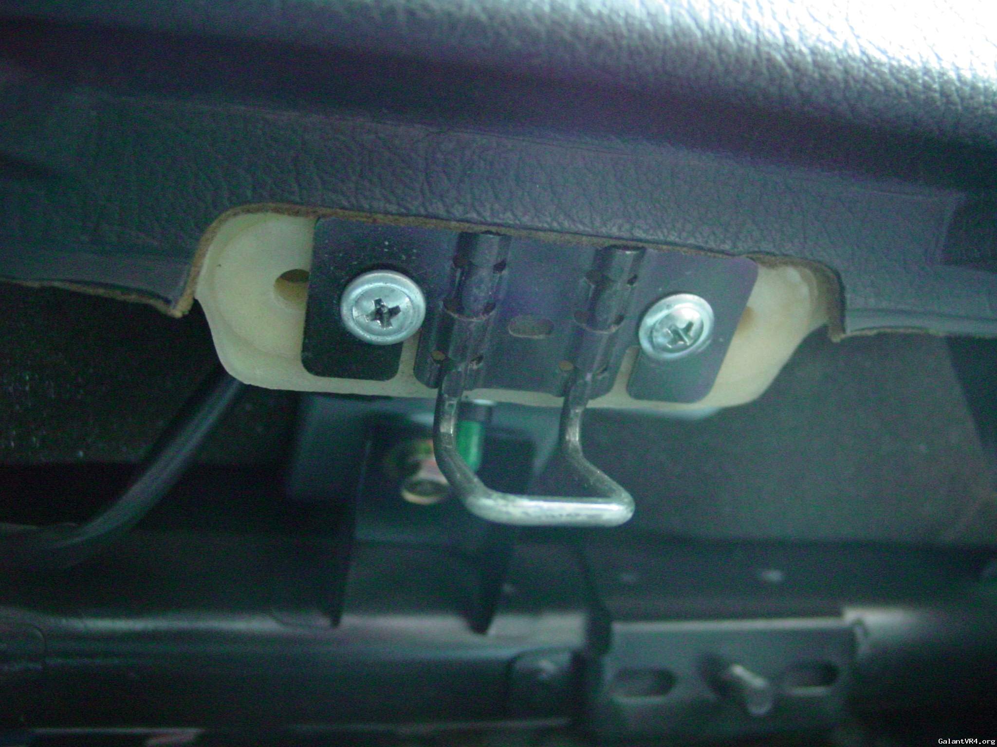

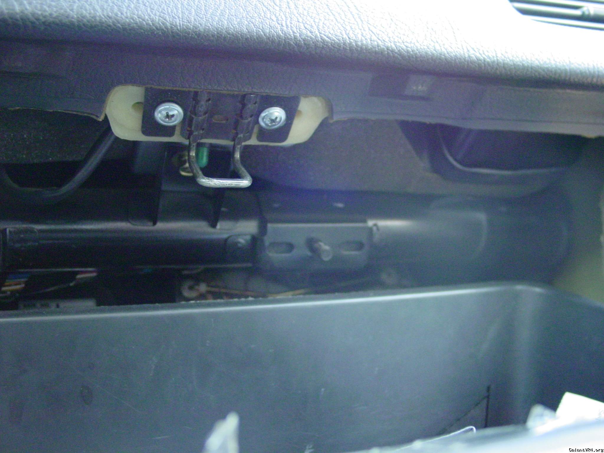

On mine I just screwed the bracket into the plastic on the dash. Admittedly it's not that strong but it holds OK so long as I avoid carrying bricks in the glovebox.

/ubbthreads/images/graemlins/worthy.gif /ubbthreads/images/graemlins/worthy.gif Thanks you guys! That is EXACTLY what I wanted to see. /ubbthreads/images/graemlins/applause.gif And yes, I do keep gloves in the glovebox. /ubbthreads/images/graemlins/smirk.gif
