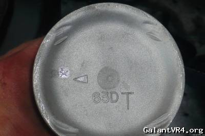

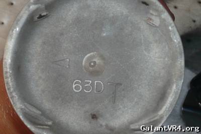

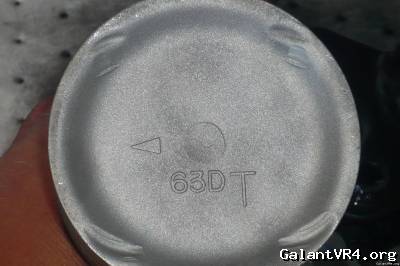

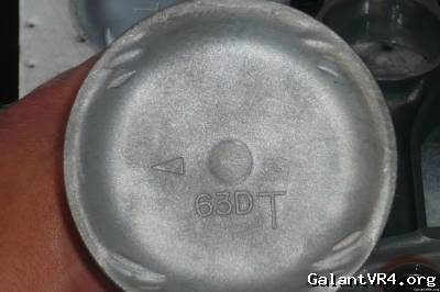

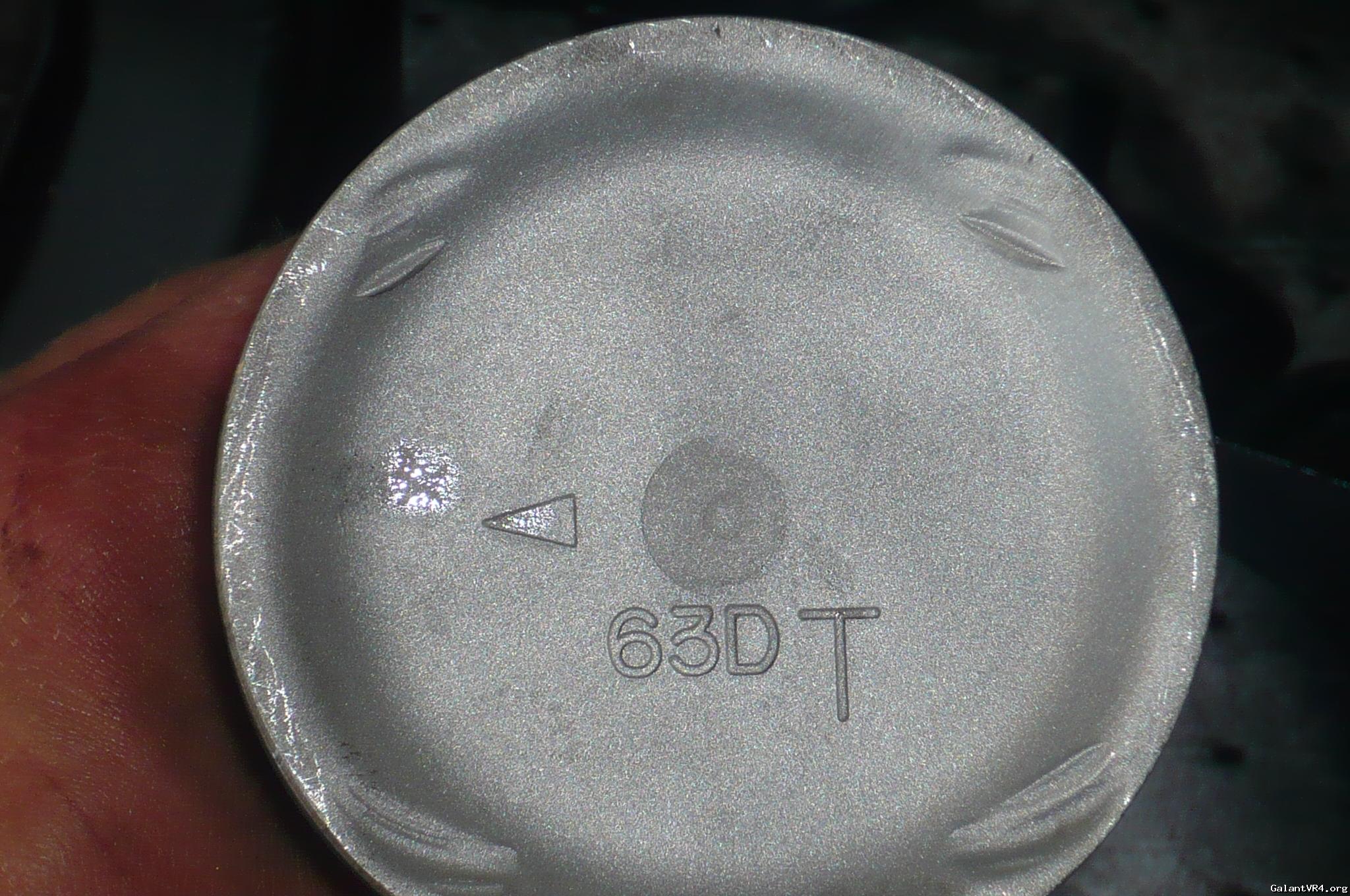

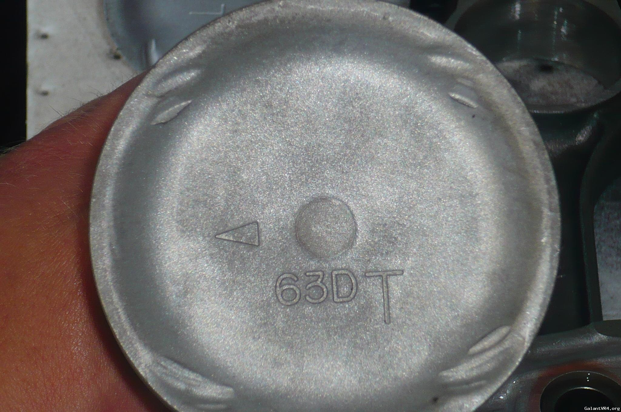

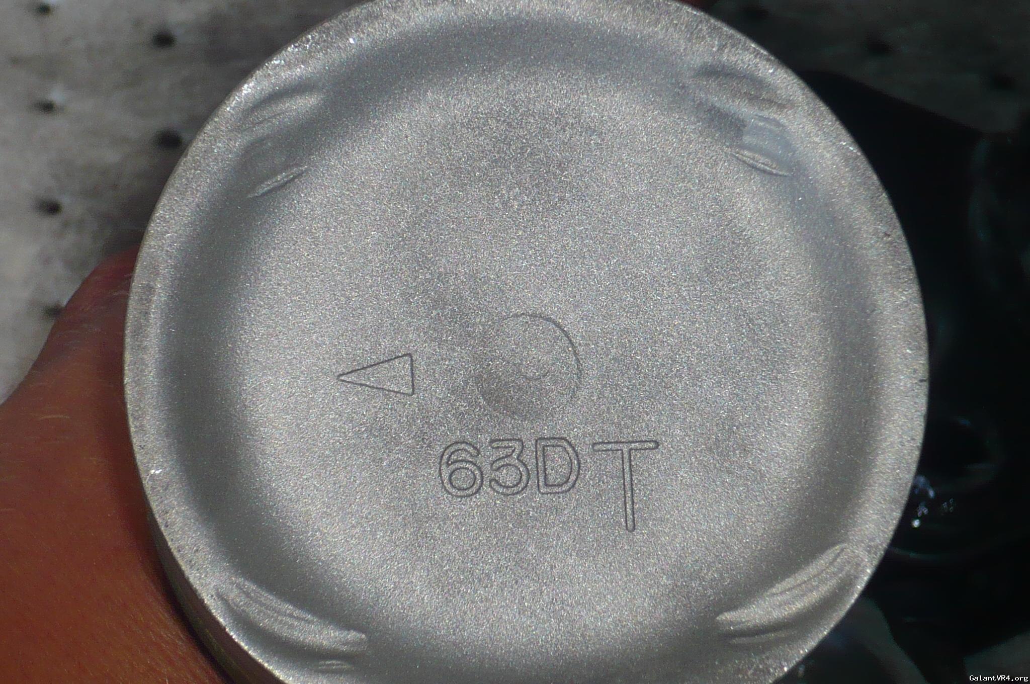

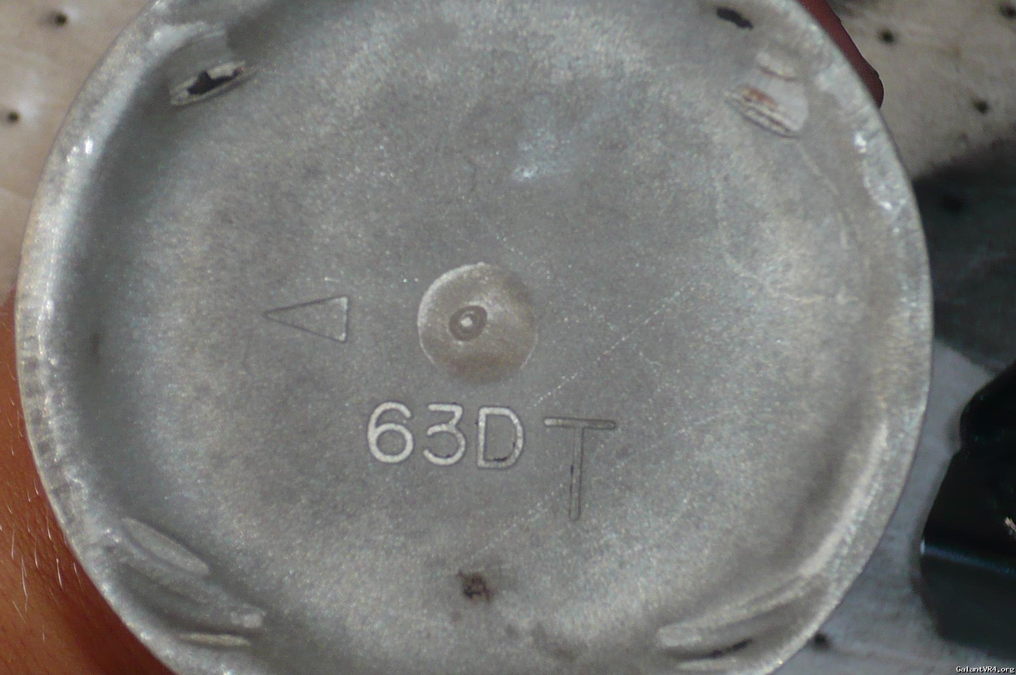

Starting to get to the reassembly of my motor now that its back from being machined and I am a little hesitant to use these. Would like some second opinions because my machinist said nothing about them and the other people I've asked haven't worked on 4g63s or anthing remotely close, they just said if they're not cracked to use them... This true?? Someone did a valve job before I purchased the car and used valves fifty thousands too long I think my machinist said. Anyway please let me know what you think if I should go after some standard bore Wisecos or something? TIA -Alan

If you can afford pistons, upgrade to a higher compression for performance however if you're on a budget then you'll be fine with those. just make sure there are no burrs on it and you'll be fine. We made roughly 600whp on a stock block motor that had kissed the valves and been reused. Motor still runs strong to this day.

Those are useable if you smooth out the ridges however you could just get some evo 8-9 pistons which are 9 to 1 and much much stronger than those you have.

I've had my pistons hit my valves 2 different times, I just smoothed out the notch they made best i could and i've never had any problems. my 2 cents... i would run them.

Infamous 4g63 timing belt failure at some point in its life. I haven't seen many 4g63s with mileage on them where the pistons haven't looked like that.
Deburr the nicks with a die grinder and a sanding roll and they'll be fine.

Thanks guys for all the response. Yes the black areas on the last piston is just some carbon build up.
I think I am just going to stick w going w these if a buddy can show me how to de-burr them since the internet isn't friendly to my searches (or I don't know what to search correctly)
I should just go w some forged ones but I just got the block matched honed to these exact pistons, so thats why I haven't even looked into some stock pistons replacements. Yes I should've looked more into these pistons or you would have thought the machiniest would have warned me about this but thats my pure n00bie-ness coming thru once again. Oh well live and learn, sometime spending more money while you're at it, lol.
