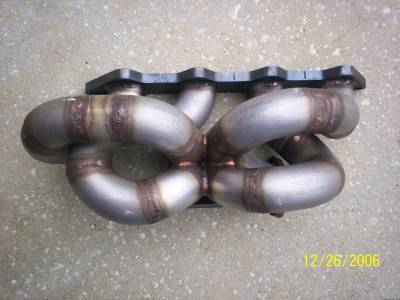

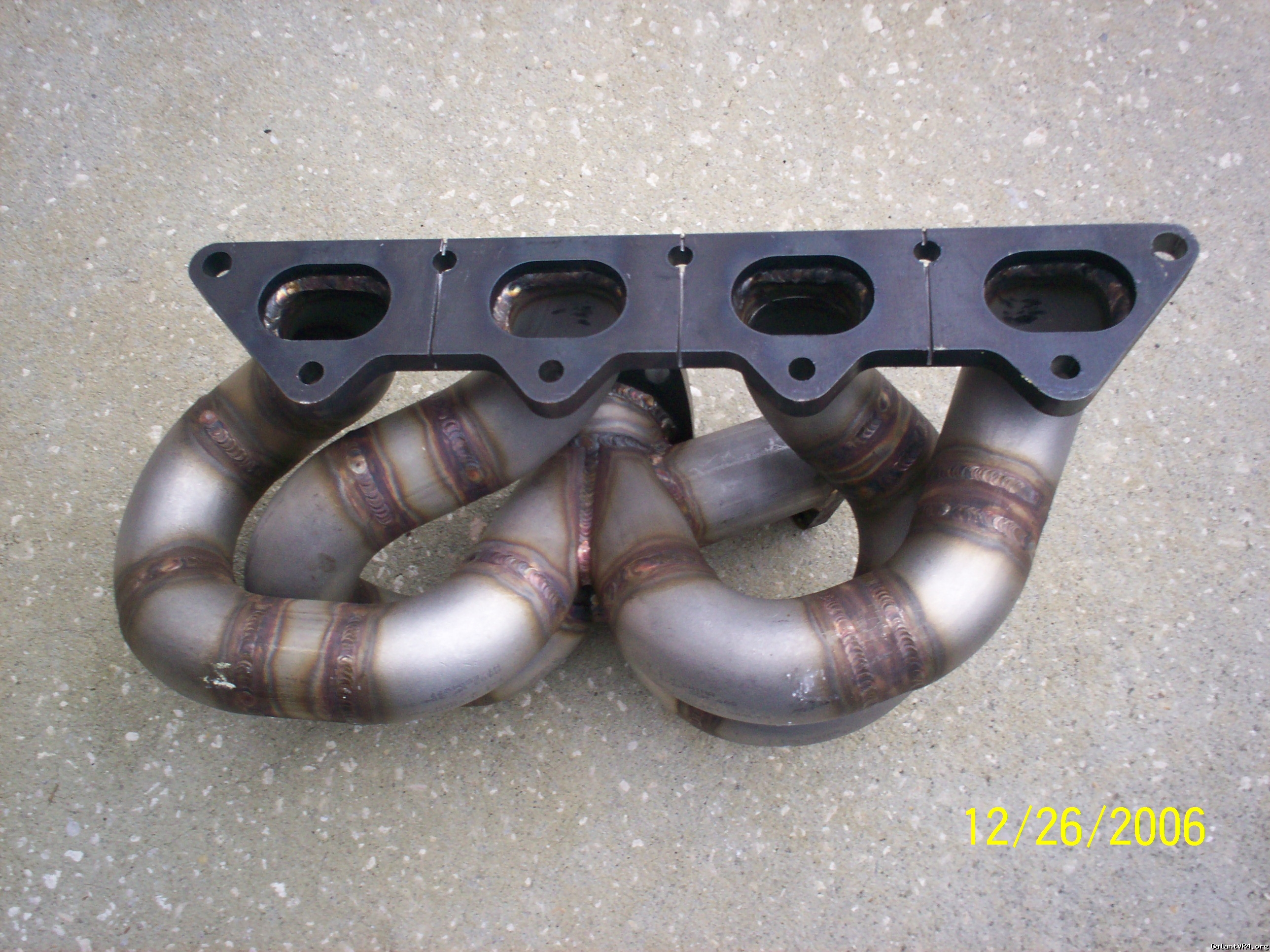

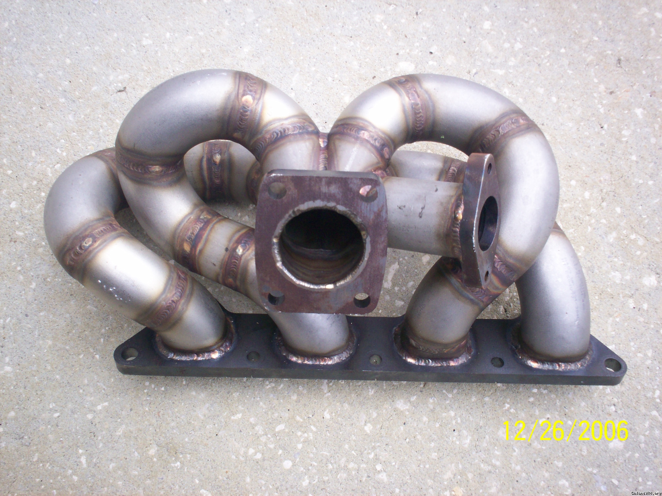

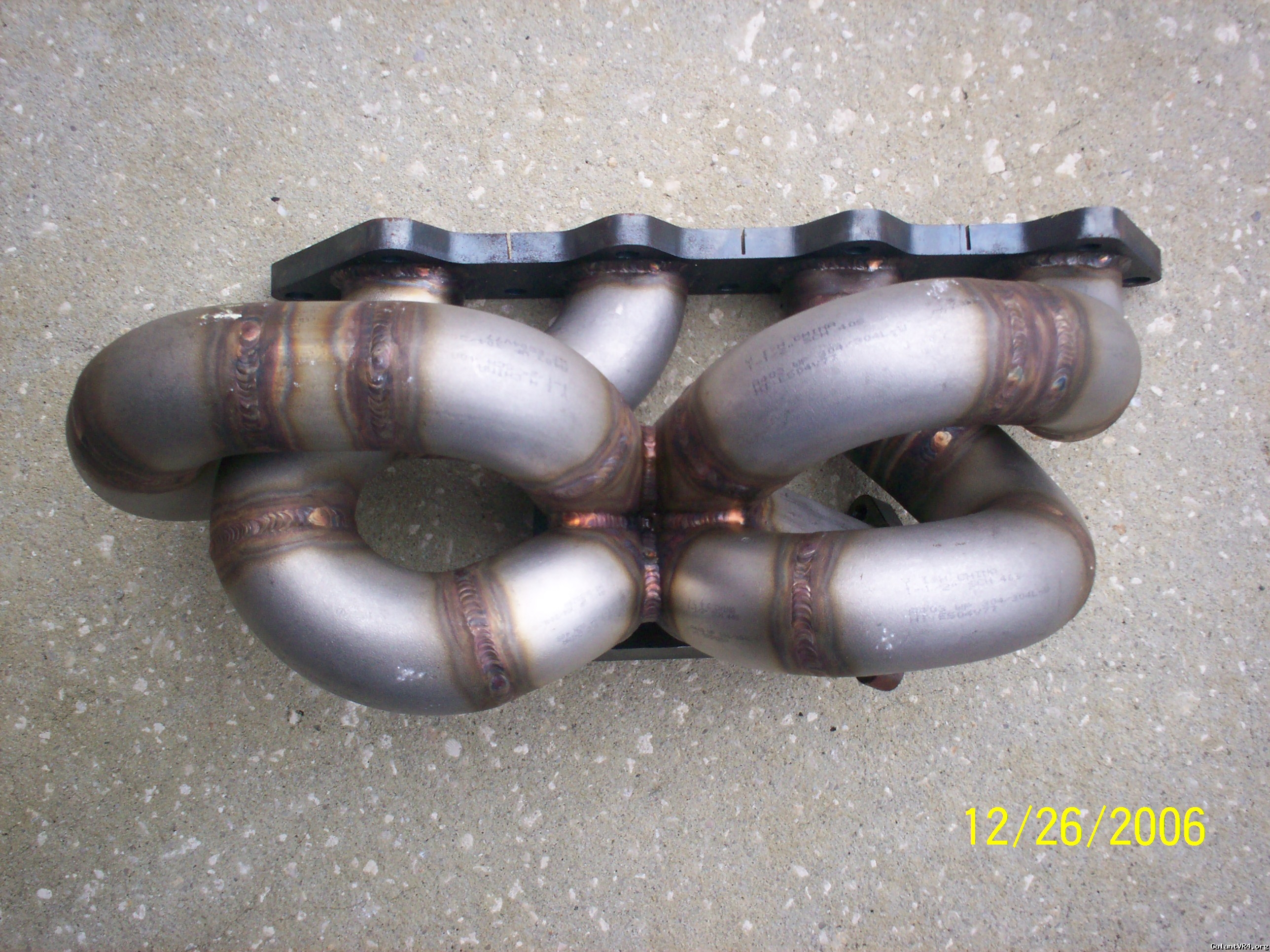

i've got a custom punishment. I reccomend him. i gave him the measurements (because shearer said thier manifold will not work on a vr4) and i think his name was tim at punishment made me one!!! Give him a call. Don't go cheap with the dnp they have cracked on a lot of people. Plus punishment has a lifetime warranty!!
I REALY don't like the collector of the dnp exhaust manifold. I can't see how the exhaust pulses won't become incredibly turbulent. One runner shoots the pulse in nearly sideways and the gases have to exit the wide open collector in a direction 90degrees to that. This can't be good for maintaining velocity.
A t3 manifold that collects the pulses more like the FP manifold is what I'd be looking for.
