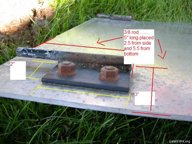

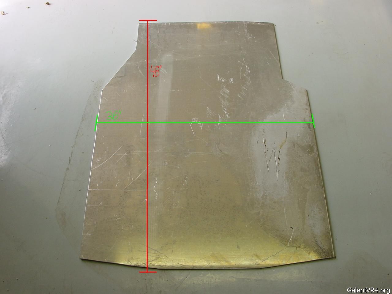

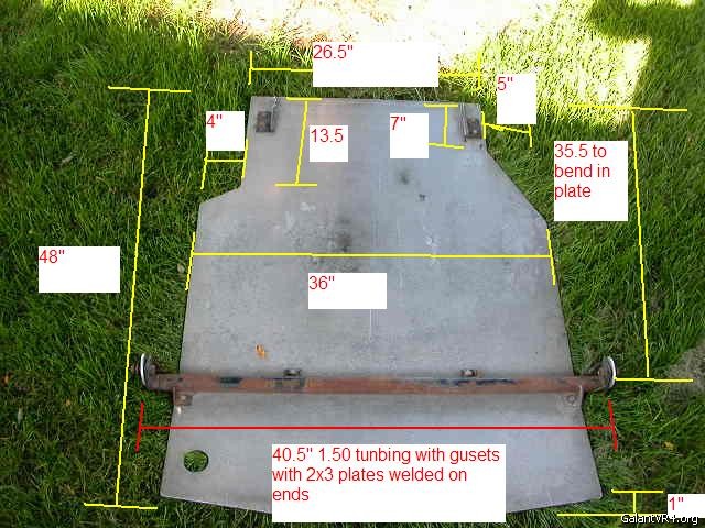

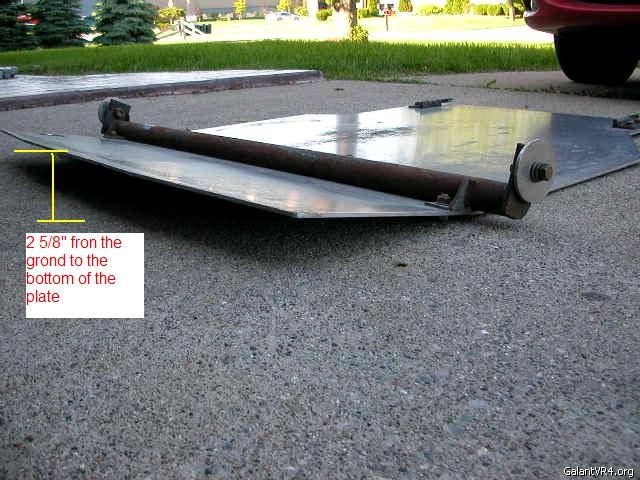

I have a TAD plate on my talon which should be the same size as the VR4 unit.... and in fact I have a spare blank plate in my van right NOW!!! Ill go take a few pics......
I have a real good run down of the plate thats on my car including all angles, measurements and mounting points at home...... Ill post it tonight.....

Thanks for the pic Larry. No, I do not intend to make this car a full rally car, just a little stronger then the normal Galant. Mostly I want the skid plate up front to keep the drifts from packing my engine with snow in the winter /ubbthreads/images/graemlins/grin.gif. I also take the occasional dirt road trip and don't want to worry about oil pans and gas tanks and such. If you could get a few more mesurements on your plate for me. I would like to know how wide the front is and at what distance the tapers start from the front of the plate. Also does that plate have any bends to it? It looks like the front would have to bend up to match the frames on the car. Thanks for all your help. I may contact Vermont Sports Car and see if they still have drawings for the Galant.

WOW! /ubbthreads/images/graemlins/shocked.gif Very impressive Larry, much more info then I expected. That should be enough for me to make a front skid, possibly with some small changes depending on the car. Now I just have to source some scrap parts to make it with. Thankfully I work in the aircraft biz so there is lots of scrap aluminum around. Thanks again for the great pics and mesuremnts.
