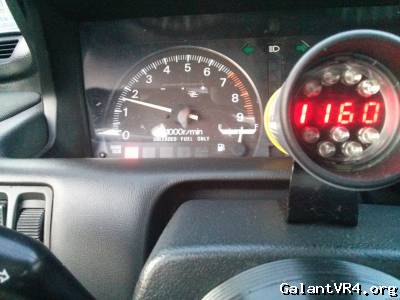

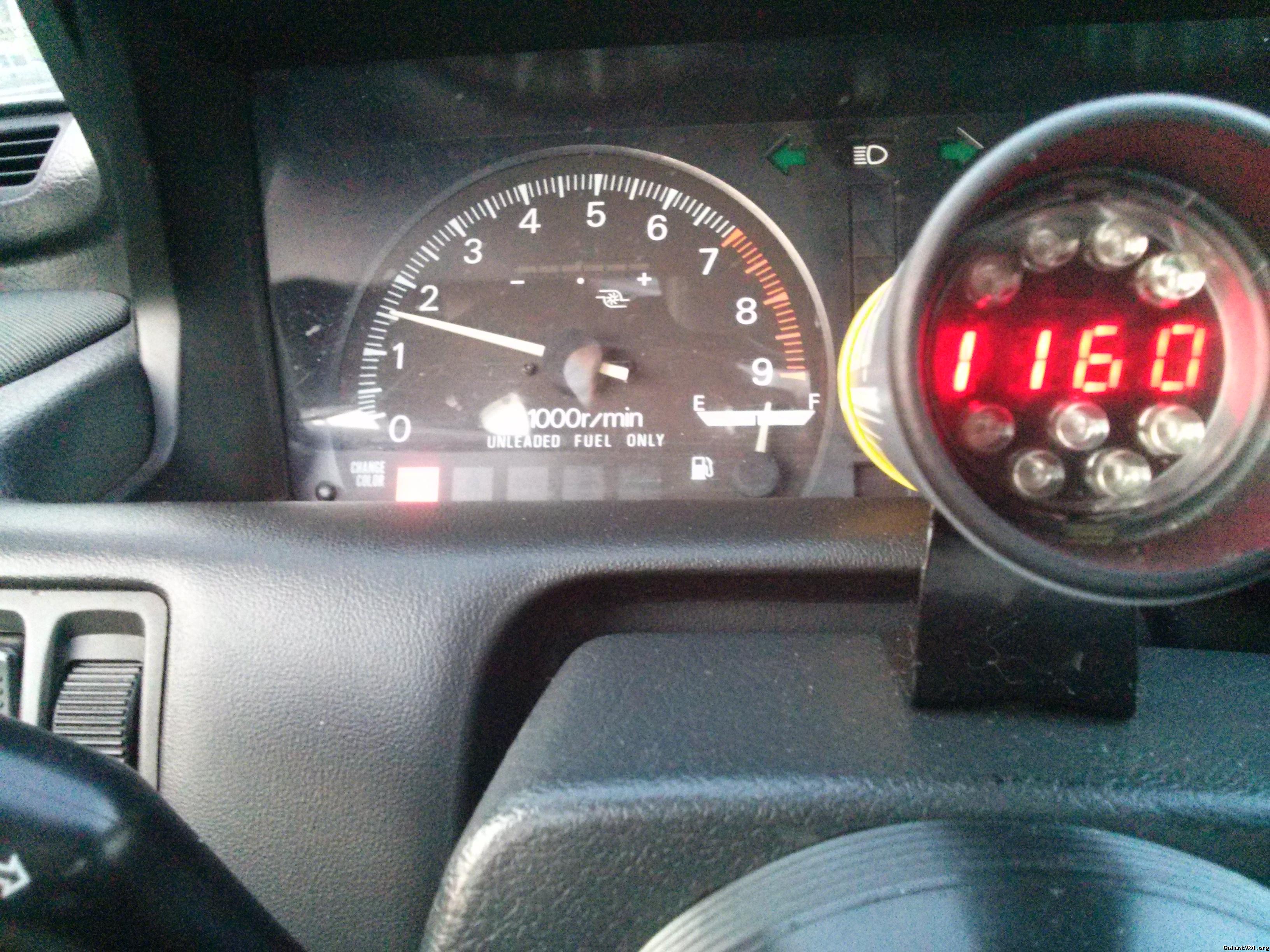

so drove it to work this morning and idled around 100-1100 will check it again this afternoon and it was plenty up to temp. I'm posting a pick because you can see the factory tach reading a higher number then my a/m tach which hooked up to the ecu on the correct wire. my question there is, is the factory tach just not accurate? /ubbthreads/images/graemlins/dunno.gif

yes one of the visors are green, it still has a shifting issue at anything other then just babying it into 2nd it grinds. I'm going to rebuild the front diff & make it awd again and going through the rear diff cause it leaks, also did the FIAV bypass, fixed the oil cooler bypass leaks, replacing the oil return line because the flex part of the tube leaks, cleaned up his or someone's vacuum line capped off with screws in the end of a cut off piece of line, & I'm still trying to figure my way out through this high idle issue some times it will idle around 890-980, but usually it idles like the pic, and then I can't find anyone to tell me if the factory tach is rated high as you can see 2 different readings. I've gotten rid of some of the green under the hood left the copper color though I like that look. hmm let see what else. fixed the fuel line leak into the rail(wrong size and tore gasket) and then I am also changing out the factory rail for a AEM rail to get the flow there better, the chipped ECU doesn't work for sh-t so it is out I'm going to buy a DSMLink v3 for it. And then rebuild the 16g evo turbo to put it back on the car, I got to have the exhaust welded up solid it is all hacked together and leaks like crazy! I would love any input or help
