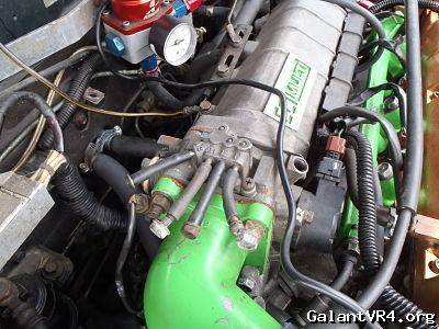

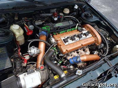

seeing the colors and the vacuum hoses plugged up just sucked all the energy out of me. /ubbthreads/images/graemlins/uhh.gif
it's got some goodies on her though- the afpr, cruise eliminated, coil on plug, tial bov...i just don't understand with all that effort invested, how the colors would be the way they are, and the the tb hoses plugged like that (looks like stitches that haven't been trimmed). also what is that red horn looking thing next to the washer fluid tank?

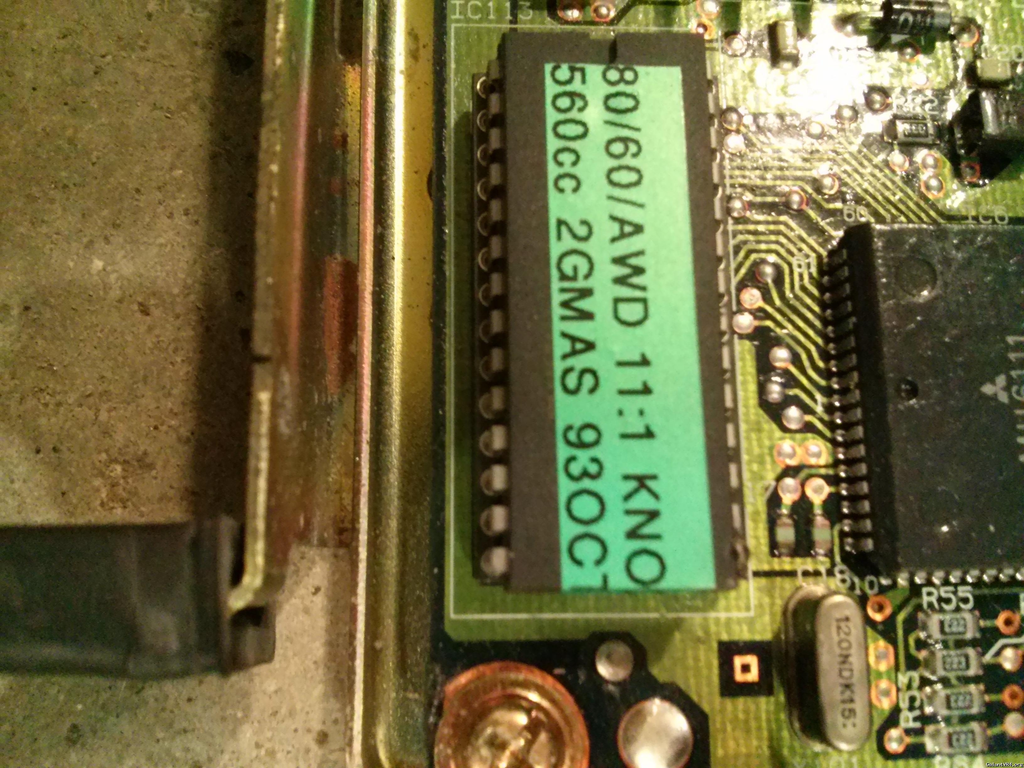

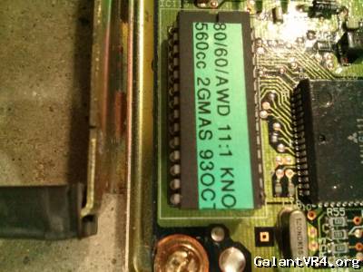

does the AMS chip have a label on it, saying what it's tune for? also yea, the boost leak test is a good first step in finding out about your high idle.
