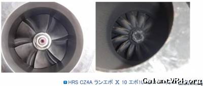

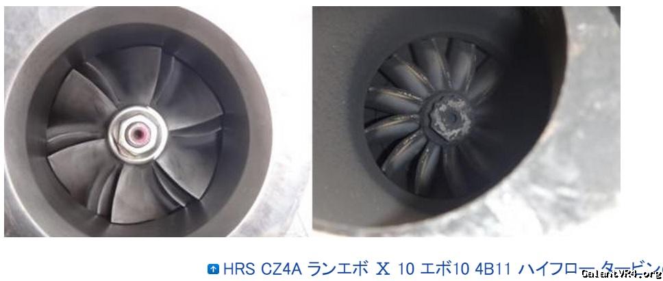

Been thinking about clipping the turbing as well. Justin on tooners has made comments that it doesn't really help that much, is this true? I know spool is slowed, but no concern there.

Even EvoX's in Japan clip it with a 20G (?) compressor... /ubbthreads/images/graemlins/worthy.gif

I didn't notice much difference in spool to be honest, perhaps 100-300rpms depending on which gear you're in. But the extra mid-range and top end punch were well worth it!

Not sure on clipping anymore. Found a 9 blade td05 turbine wheel no. I think that would outflow a clipped wheel. Been researching and running math on possibly opening up the turbine housing and changing the A/R ratio some to allow more flow.
