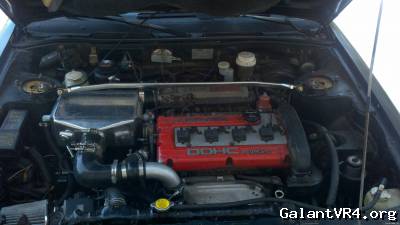

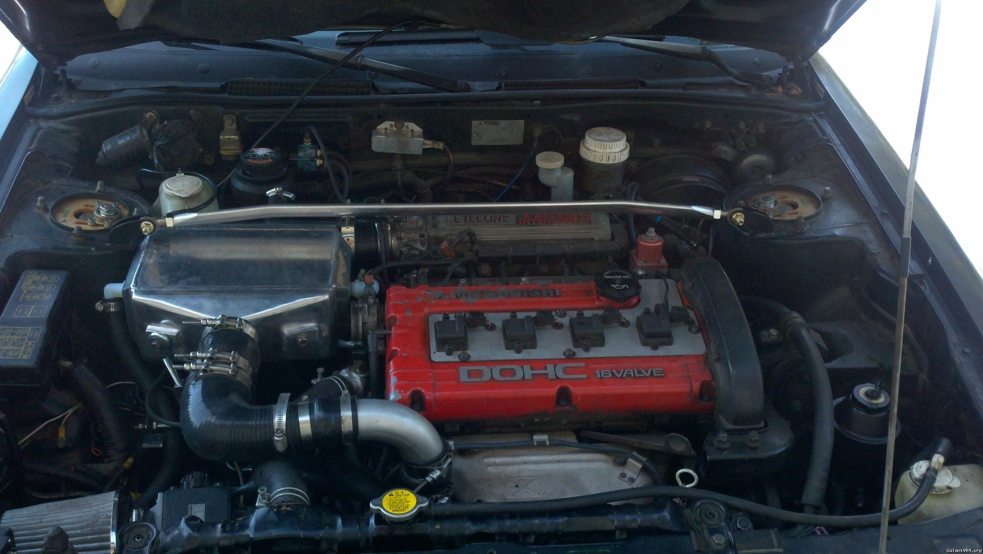

belize1334
Nov 18, 2003
3,316
Bozeman, MT
Quoting vr4junkie:
Anybody know who's car this is I was looking in the members show case randomly getting pictures and now I can't find the link need to ask him a few question about his setup.
That's me. It works but it's no bolt in affair. You have to do a fair bit of head-scratching to get it all in there. And that's not from FrozenBoost. That core is like 4.5x6x11 instead of the 4.5x4.5x10 that you get on FrozenBoost. I think I got it here...
The pump is from a Ford Lightning. The reservoir is from a Saleen Mustang. And the heat exchanger is one of these.
I have the heat exchanger mounted in front of the radiator where my AC condenser used to be.

belize1334
Nov 18, 2003
3,316
Bozeman, MT
My water pump runs anytime the ignition is on. I have a pair of 7" fans on the front of the heat exchanger which are wired off of the AC fan relay so they come on either by hitting the A/C switch in the cabin or as a response to the coolant temp exceeding 210F. Water circulates from the front heat exchanger to the intercooler and back. A little reflective tape on the surface of the intercooler keeps it from heat-soaking in the engine bay. I daily drive it and also autocross. It sees temps from -20F to 100F. 20psi on my 14b with no knock and no heat-soaking that I'm aware of. I'd say that this exact setup should be good enough for 400+whp. It could take more if you put ice in the water but I'm not a fan of "temporary" power gains. The only downside is that the system is more complex than a FMIC. Other than that I'd say it's fine for DD.

Quoting vr4junkie:
All in all how difficult was it to install any welding,cutting, making brackets, any thing have to go in order for it to work?
As for performance, the long and short is that you want the two cores (intercooler and heat-exchanger) to be "roughly" the same volume, with an emphasis on the intercooler which should be as big as you can fit in order to instantly transfer heat into the water. The front heat exchanger can then radiate that heat over a prolonged period so it doesn't have to be as big. When people say they're not good for DD, they're usually thinking of running a big ice-bath and no front heat exchanger. That's not what we're doing here.
Installation is a pain in terms of the tetris aspect, but simpler than fabbing an FMIC and, if you put the HE where your AC condensor used to be, requires less cutting than an FMIC job. And you get the benefit of an ULTRA-SHORT intake path which makes for fantastic tip-in throttle response.
Total investment, if you do it right the first time /ubbthreads/images/graemlins/banghead.gif is going to be about the same as a prebuilt kit. Figure $300 for the two intercoolers, $200 for the pump and reservoir of your choosing, $100 for turbo outlet pipe (either custom or modified prefab), and then $1,000,000 for couplers and miscellaneous fittings. You'll also need a bracket to support the intercooler (mine is an ACE turnbuckle mounted to the transmission) and a bracket to hold the HE in place (mine is a pair of aluminum sheets with holes drilled that go to the front cross-member and hood latch bracket). I'll take some pics when I get home tonight.
