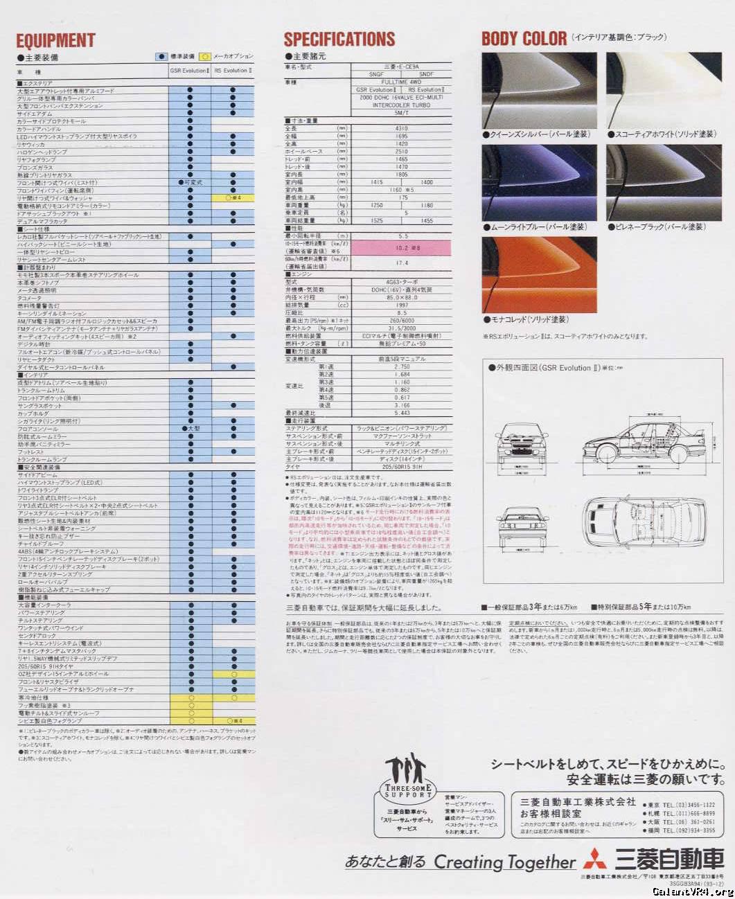

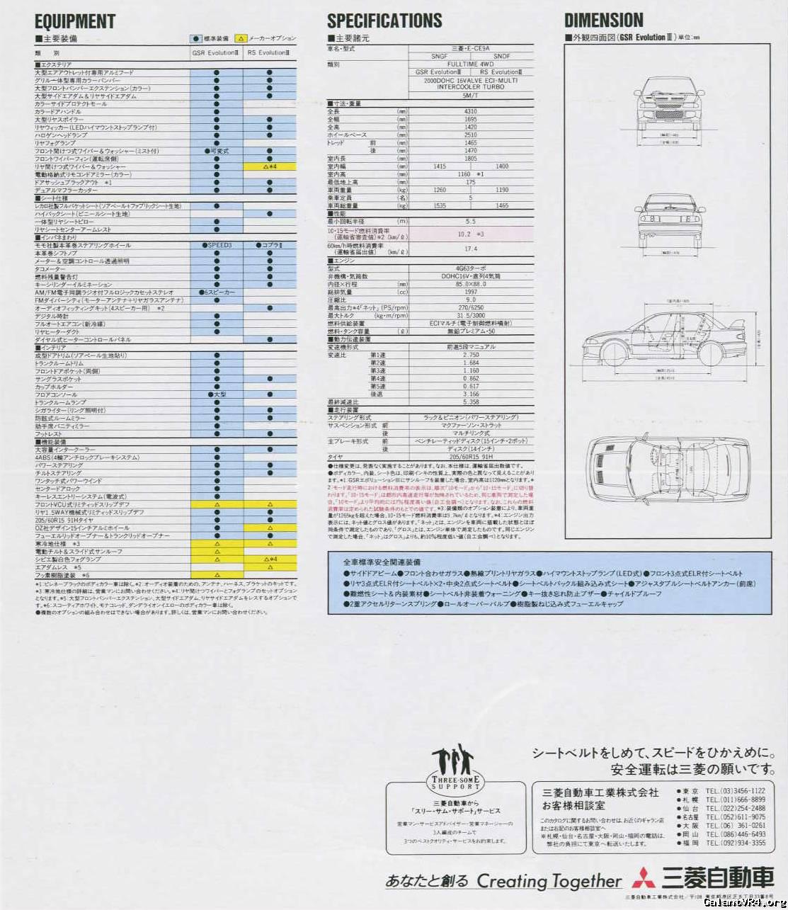

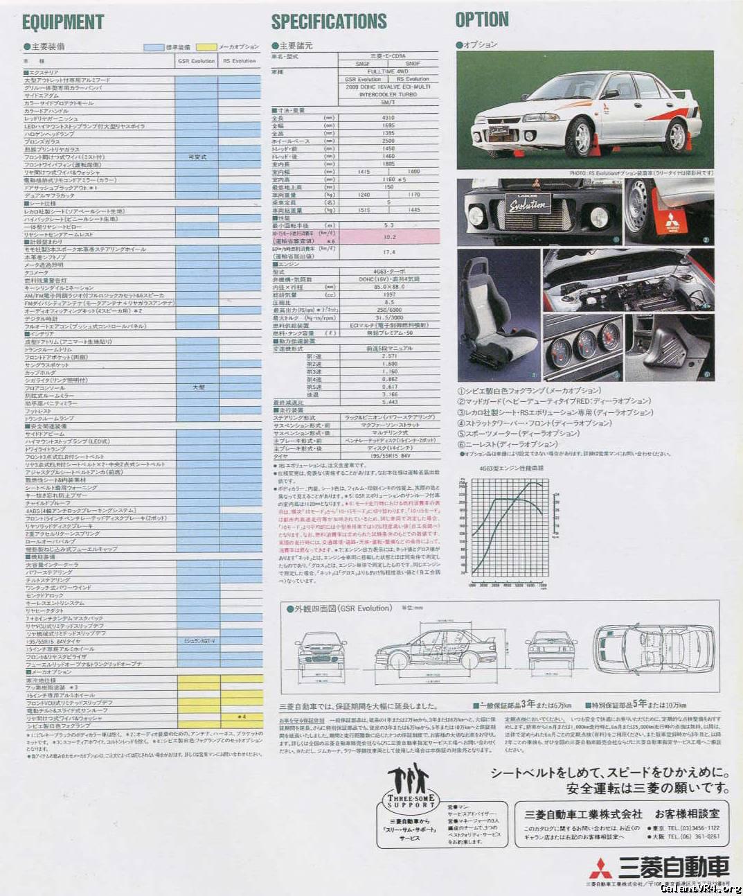

Not sure if this has been posted before, so I hope all is readable. I have the rest of these if required. (sould be readable), I don't have them any higher res.
Evo 1:
Evo 2:
Evo 3:
Rich
