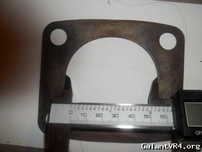

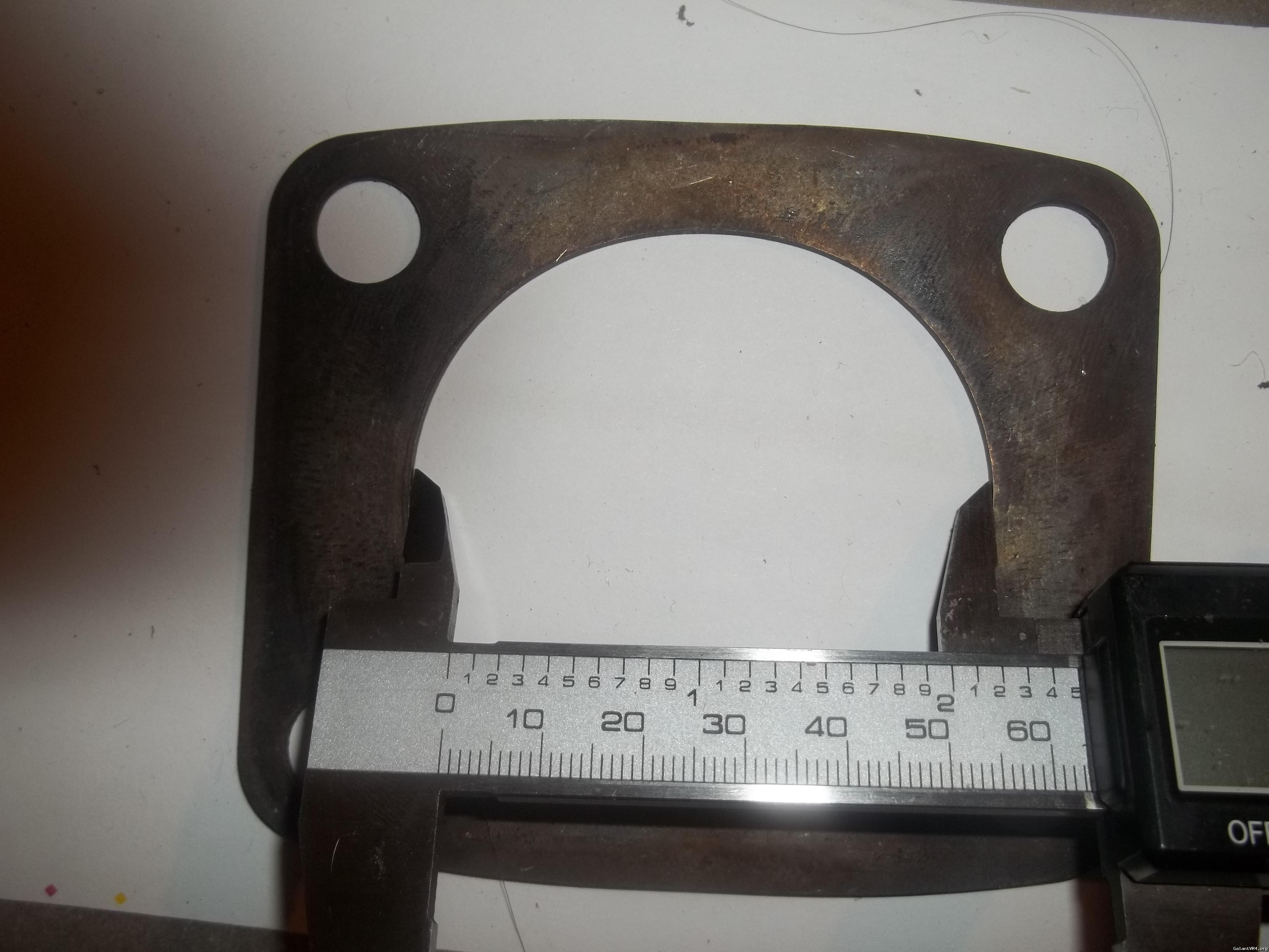

I purchased a turbo install kit including new oem bolts from a very reputable vendor and one of their salesmen recommended the stainless steel exhaust manifold to turbo gasket. Needless to say less than 700 miles later I get a severe leak. Upon removing the manifold and turbo I have 2 broken bolts. the cause is the supposedly indestructable gasket had elongated into an oval shape and put tension on the bolts. I had torqued the bolts to factory specs. Any one else had this problem?

That gasket probably failed due to loose bolts. Did you use anti-seize when you torqued down the stock bolts? Did you use the cone washers that keep them from backing out and if you did were they installed properly?

And you should always retighten any exhaust bolts every few heat cycles. Ask anyone that has put headers on a sbc.

New bolts and washers with antiseize. I retorqued only once though after running the car about 20 mins..I have always used oem gaskets using the same procedure and never had one fail.Oem for life /ubbthreads/images/graemlins/idea.gif

You have both surfaces flat and true?
